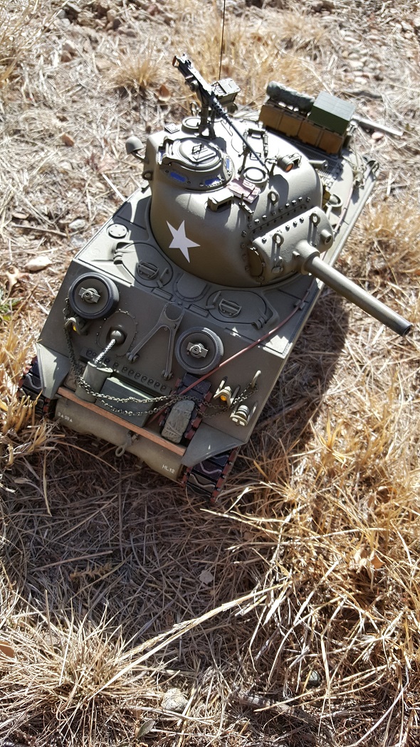

The Sherman M4A3 105mm Houwitser is done! Spent the last weeks getting her ready, with paint, weathering, a healthy slathering of Magic Grime (Yeah, magic indeed... love it!) and the likes. Quite pleased with the results for my first go at painting and weathering armour, and the Magic Grime works as advertised. Did some chipping with some acrylics, mainly rust colours and some gun metals. Most of the larger markings were masked and painted, altho I did use some of the Heng Long decals and some scraps from my decal leftovers.
I blackened the metal tracks with two rounds of Birchwood Casey Perma Blue paste. Man, that stuff is awesome! First round turned the tracks a dark brown, second round turned them a nice weathered black. A quick tour of the wilderness that is my garden gave the tracks just the right pattern of wear...
Anyway... time for some glamour shots!
Still want to do some stowage, but not sure what. I have plenty of options tho. Also might have a crew, at least a commander and a loader. But that means painting figures...

Rob,
Shermans are coming out fantastic. Go crazy on your 105 M4A3. They look so great when tricked out with detail and are solid runners.
