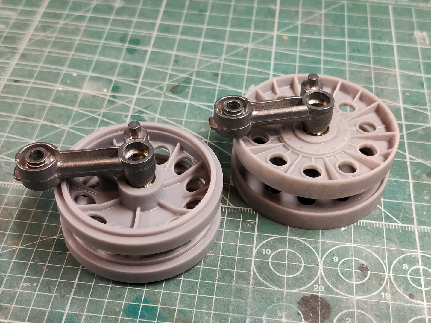

HERMAN BIX wrote:What about the flat disc inserts like the link to Hagen miniatures ? could that be a simpler option ?
It could work as a plan B for the HL plastic wheels, where you could cut or grind the ribs out. Like the General said, I think you'd need to machine the metal wheels to get them flat enough. I'll see if I can work something out.
General Jumbo01 wrote:You guys really are a bad influence! I've just bought a Trumpeter T34/76 43 model. It has 2 pairs of the later tyred wheels and 3 sets (inner axles, as discussed above) with the metal wheels.
Sounds like you're going to need a set of these, my friend:

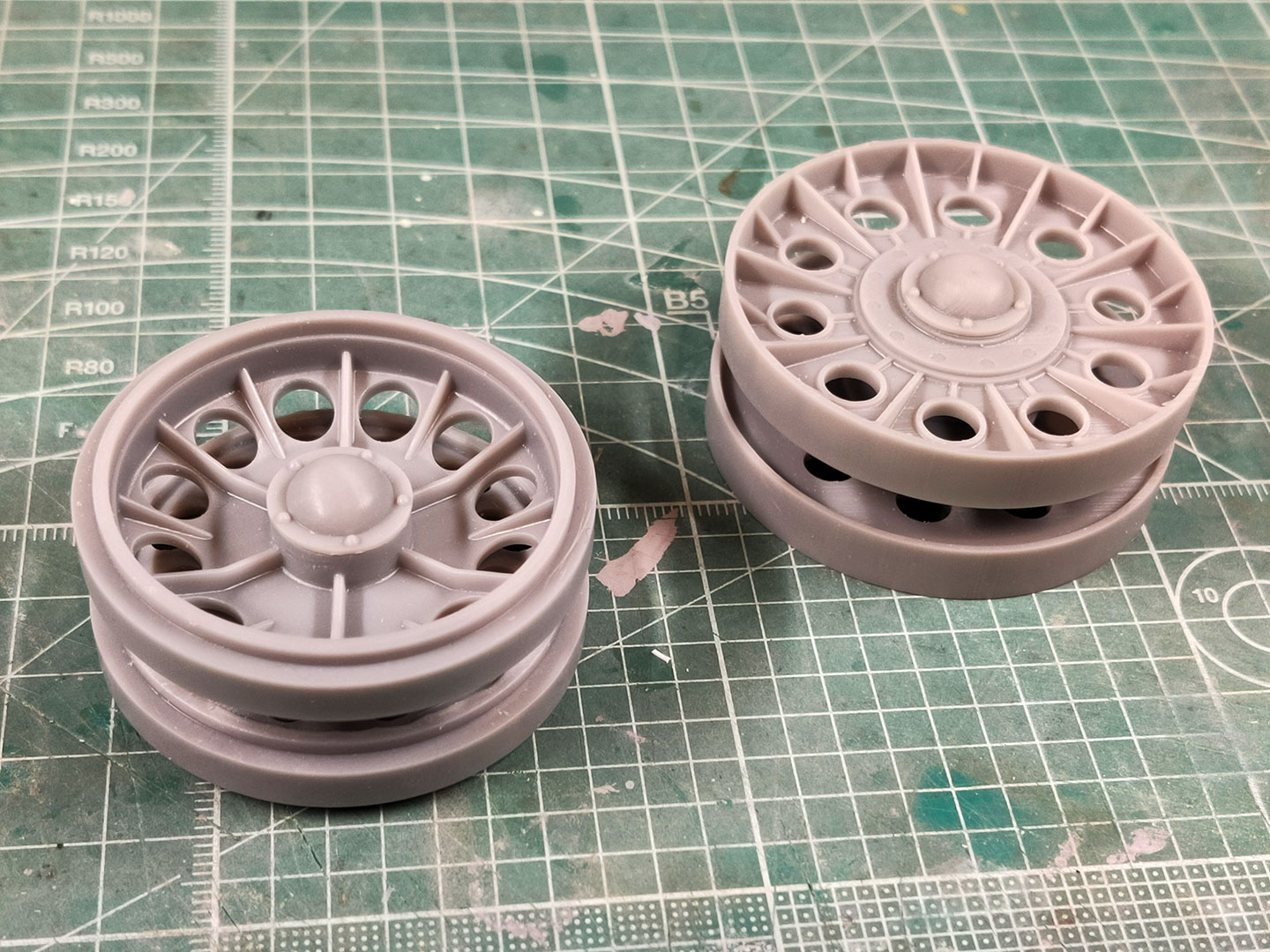

Still mucking about trying to work out the best settings for supports and orientation. My heater is on the way, so hopefully next week I should be able to start printing in the super-strong stuff. This grey ABS-like resin is too brittle for RC use, but the clear Blu is pretty much bulletproof; I couldn't break the 2 mm thick test prints by hand.
tankme wrote:The SU-122-54 has the wheel spacing between the 3rd and 4th wheels so that is the only real issue I see with building it from a Hooben kit.
Would a back-to-front T-34 hull work, do you think? The roadwheel spacing would be closer. Maybe you could cut the ends off a plastic T-34 lower, rotate the centre 180­° and reattach.
EDIT: Of course not, the swing arms would be pointing in the wrong direction. :{

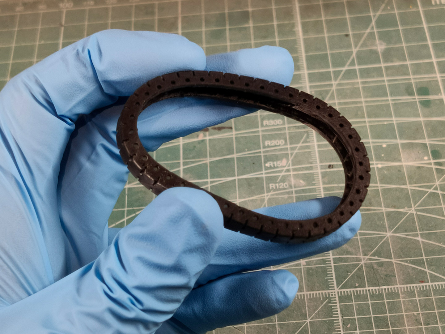

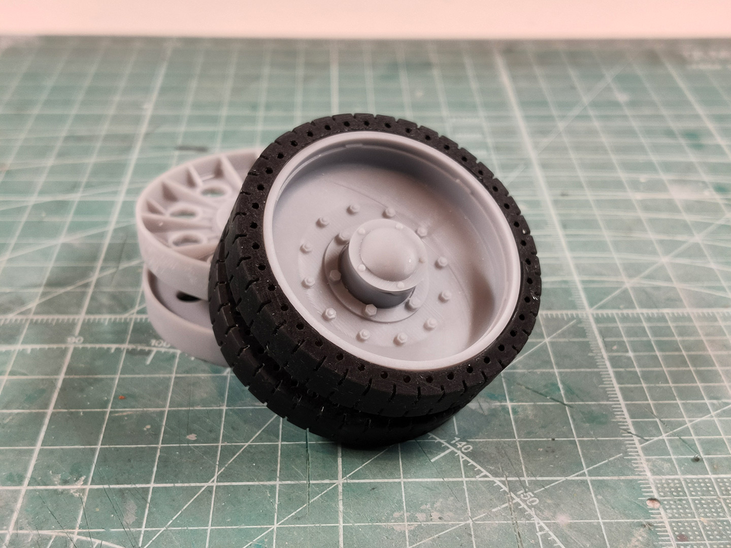

Spent the last few days trying to print with flexible resin; all of my exposure calibrations and test prints came out perfectly, but every model print would detach itself and stick to the vat. I had three attempts where nothing but supports came out. I was just about to give up and try something else but then:
Could do with some tweaking, but I'm really pleased with how these went. The surface is a little shiny and partially translucent; maybe more fitting for high fashion or fetish clothing than a war machine, but gentle sanding with 360-grit gives a nice opaque matte finish.
