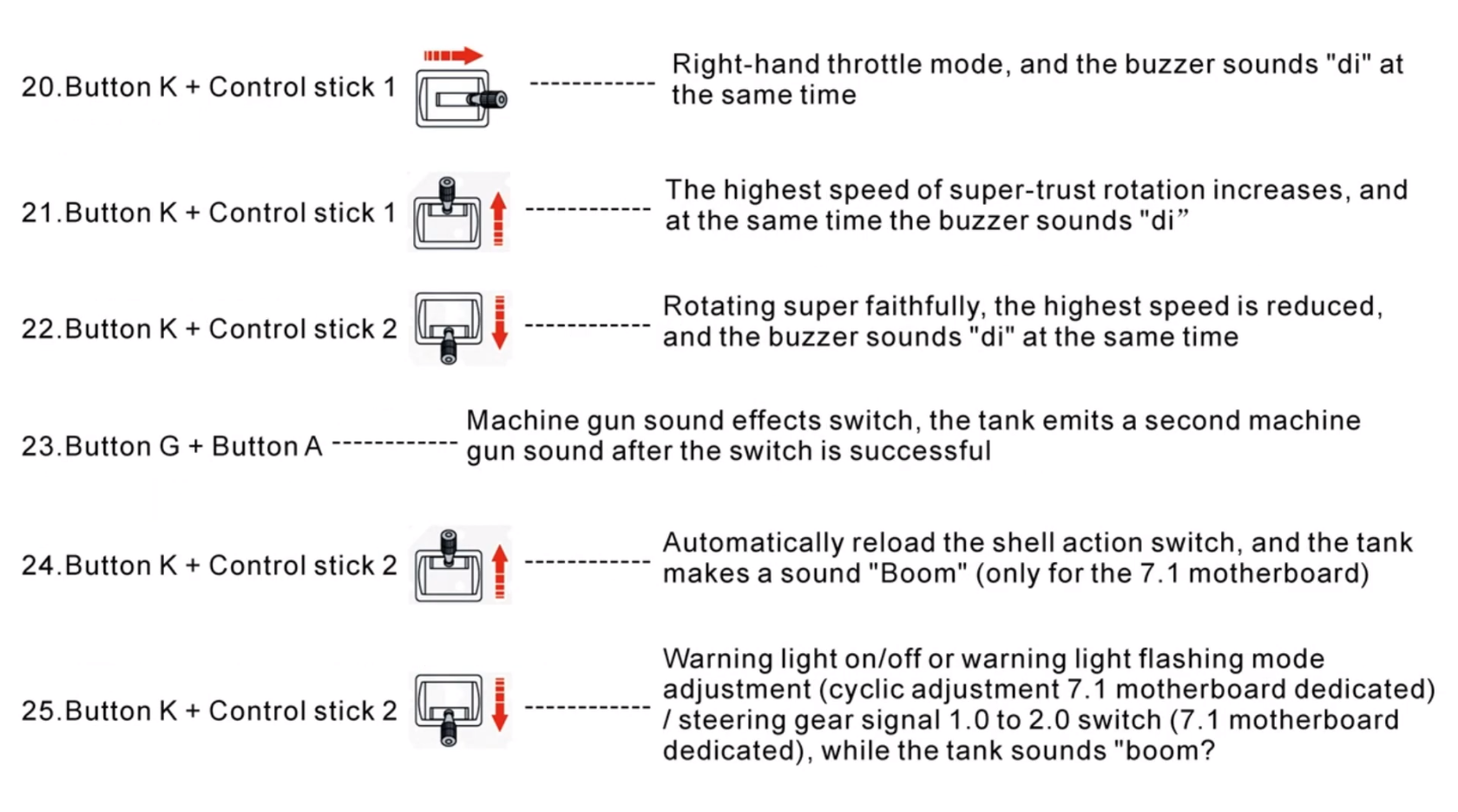

G'day folks, just got a 7.1 down here. Has Tiger and T90 sound set.
My question is...................on firing the main gun the thing seems to find an auto-loader default breach return function regardless of the sound set chosen.
Great if you have a modern MBT with an autoloader like a T90, but not cool if you want it in a Tiger 1.
Is there a way of disabling this function and if so, how??

HERMAN BIX wrote: Sun Aug 27, 2023 10:31 am G'day folks, just got a 7.1 down here. Has Tiger and T90 sound set.
If I remember correctly, it's the Button K + Control stick 2 pushed upward to activate/deactivate that function
HL TK 7.1_Manual_11.png (695.23 KiB) Viewed 45534 times

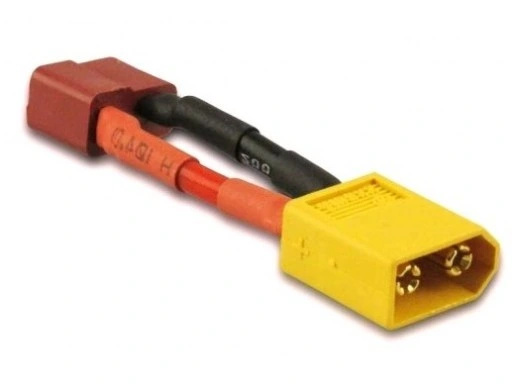

Anyone know why they switched to a Deans connector on the 7.1? I am trying to find the best way to connect an xt60 connector. Should I change the connector, or is there an adaptor to use?

fullysemiautomatic wrote: Wed Jan 10, 2024 2:47 am Anyone know why they switched to a Deans connector on the 7.1? I am trying to find the best way to connect an xt60 connector. Should I change the connector, or is there an adaptor to use?
I assume the reason they changed to a Deans is because it's a much better connector than those old Tamiya style ones. Personally, I changed all my batteries to use Deans connectors. I also have an adaptor, but that was a DIY.

Just buy (or solder youself) one of those:

by tankme
I prefer the one piece molded XT60 to Deans if I need a converter. I bought a kit off Ebay a while back that had Tamiya to XT60, Deans to XT60, and a few others all in one using the overmolded type like these:
https://alofthobbies.com/products/xt60- ... erter-plug
