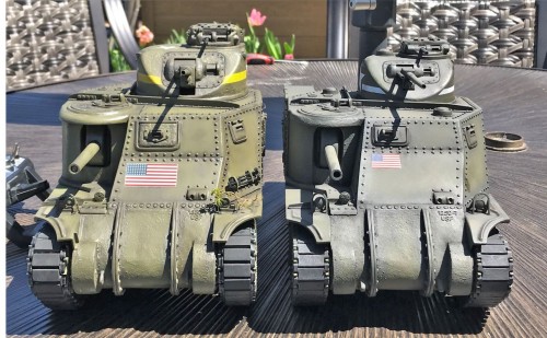

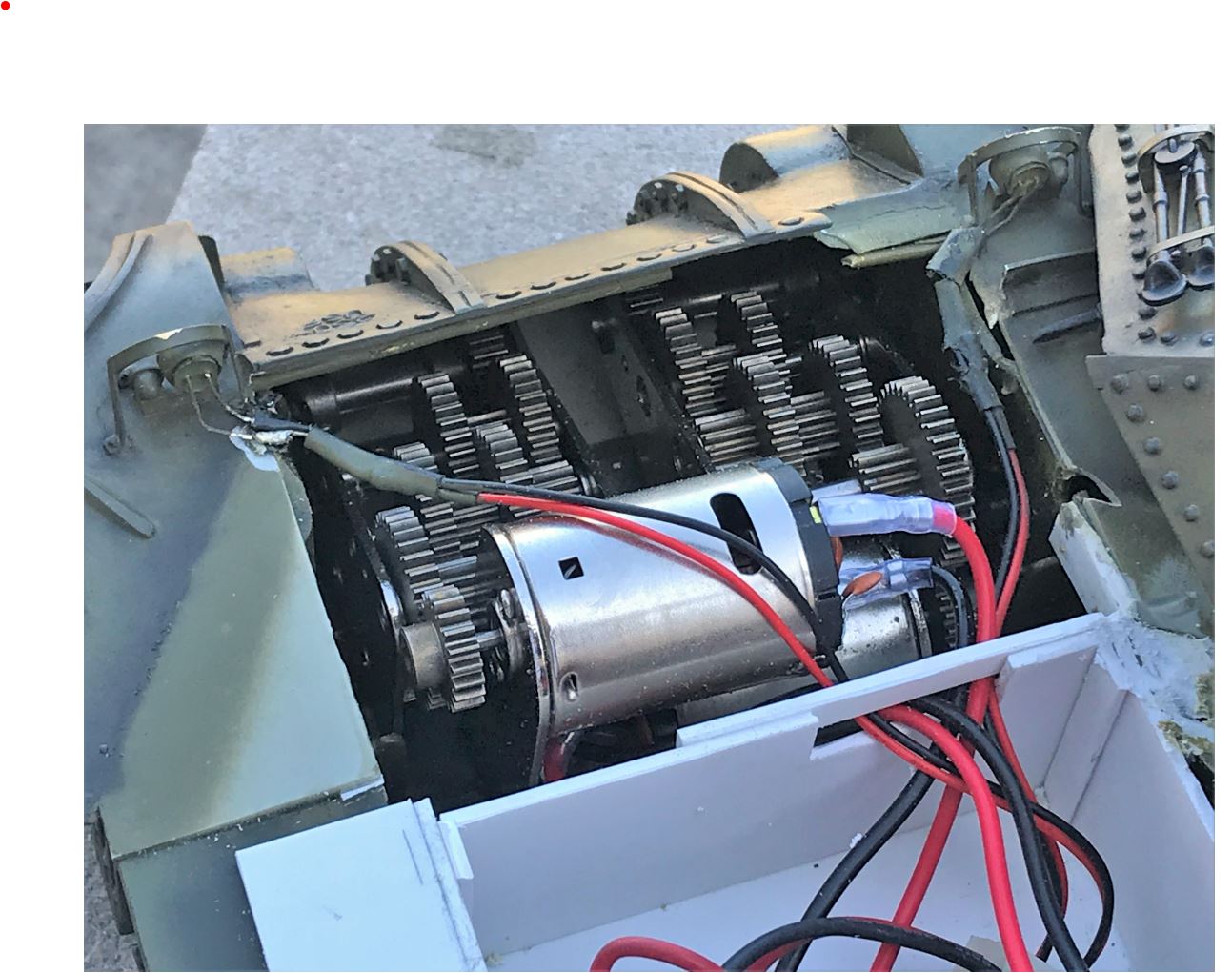

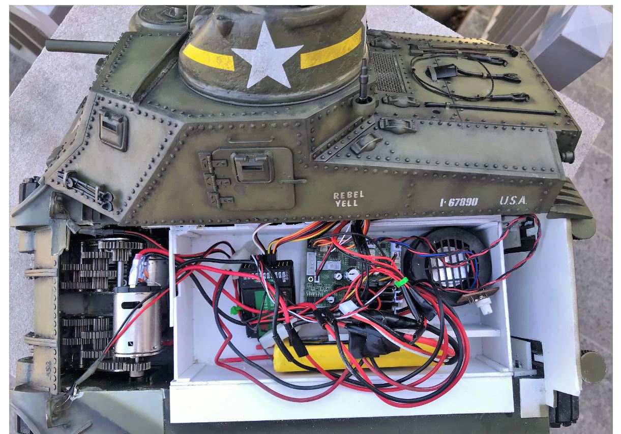

Hi, i was not happy with the way my new M3 runs so i gave it a new metal Mato MT217 gearbox.
Here is the M3 Lee in action in the bush. Its much better with the new gearbox.

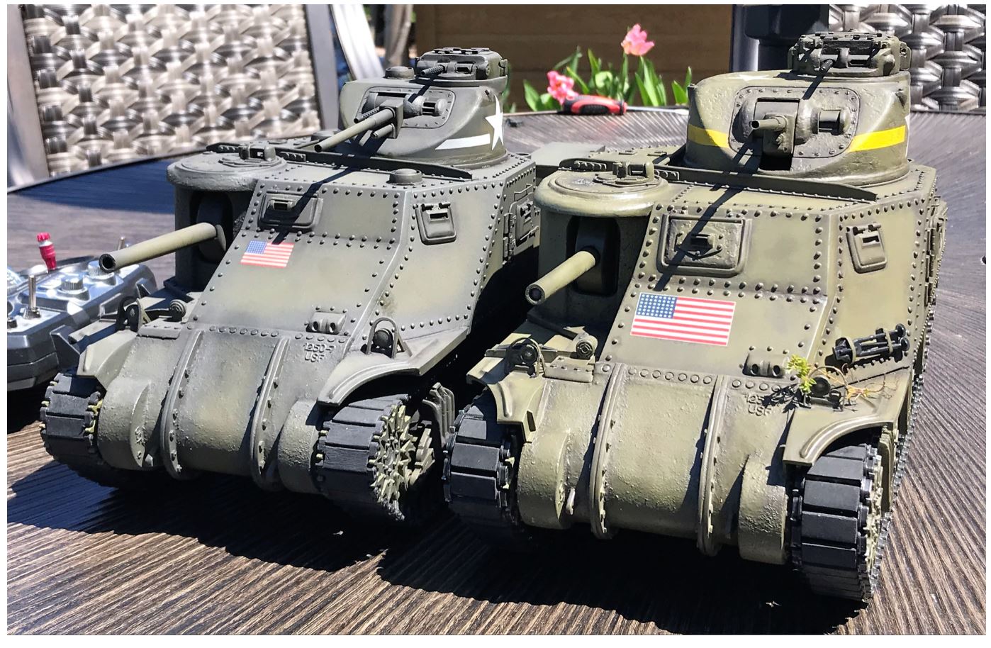

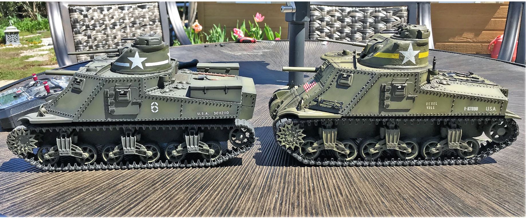

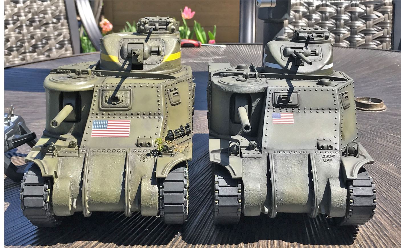

Here are a few pictures to compare my latest M3 with my first attempt 5 years ago. You can see the new turret that replaced the undersized Vandra kit turret that i had beefed up, enlarged upper hull top where the turret sits, corrected front plate and driver's hatch, and some improvements in the early suspension. It also used modified Mato M4A1 chassis and tracks instead of modified Heng Long M4A3 and tracks.
Regards,
Louis
Regards,
Louis

i like Vandra because he is producing kits of rare tanks, but i am spending half the builds correcting dimensional mistakes that could have been easily avoided. Instead of using blue prints or a good 1/35 kit to extrapolate dimensions to 1/16, he must be only eyeballing pictures. Mistakes are piling up on top of each other and he is compensating by doing more mistakes in order for the thing to come together. The case of the M3 Lee is dramatic as both Vandra and Haya somehow seem to be quite satisfied with an unrealistically undersized turret ring and turret. No one would dare doing this to a Panther or Tiger turret...
