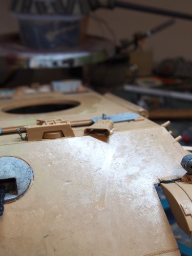

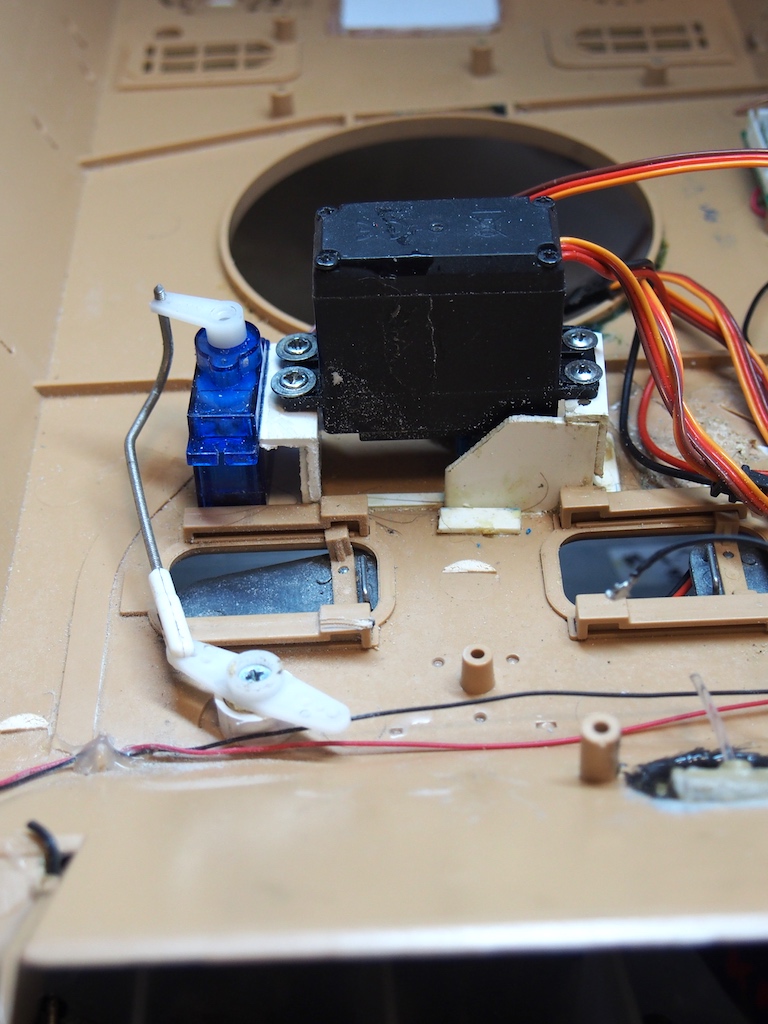

Thanks for looking . They have delivered all the brass bar the stuff for the track hangers , so a little mod on the drivers periscope., just used Plastic weld to secure the servo as not much of a strain on the servo.

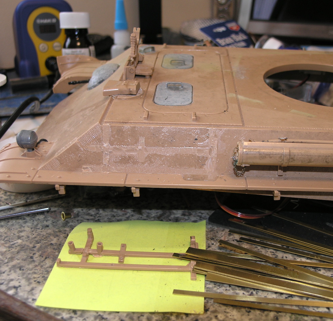

Brass has arrived and its the correct sizes, better get a move on with the F before i forget what colours i used for the turret.

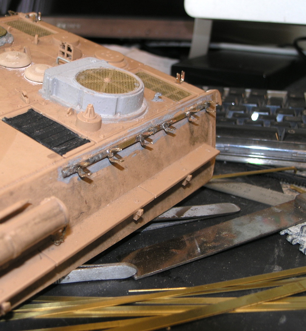

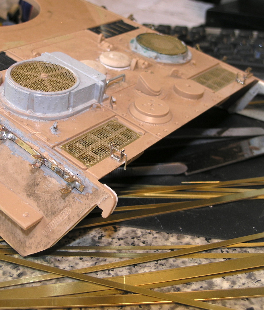

Removed tool holders ,track hangers and rear tow cable eyelet holders.
Taigen seem to think that Victorian cast iron was used for all the accessorie fixings on tanks
Re: Panther F
ronnie42 wrote:Brass has arrived and its the correct sizes, better get a move on with the F before i forget what colours i used for the turret.
Taigen seem to think that Victorian cast iron was used for all the accessorie fixings on tanks![]()
Your hangers look great, if I might say so. What size are they?
Re: Panther F
Hi Soeren The brass strip for the hangers is 2.5mm by 0.8mm and 3.0mm by 1.0.mm for the long strip they are soldered onto. Have spare track links from the Trumpeter Panther, going to use them as the detail is superb and the slot in the track link is wider. The taigen metal track links are 2.5mm wide across the slots, would be very difficult to line up .
