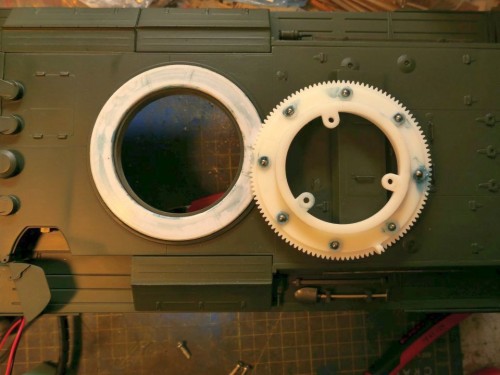

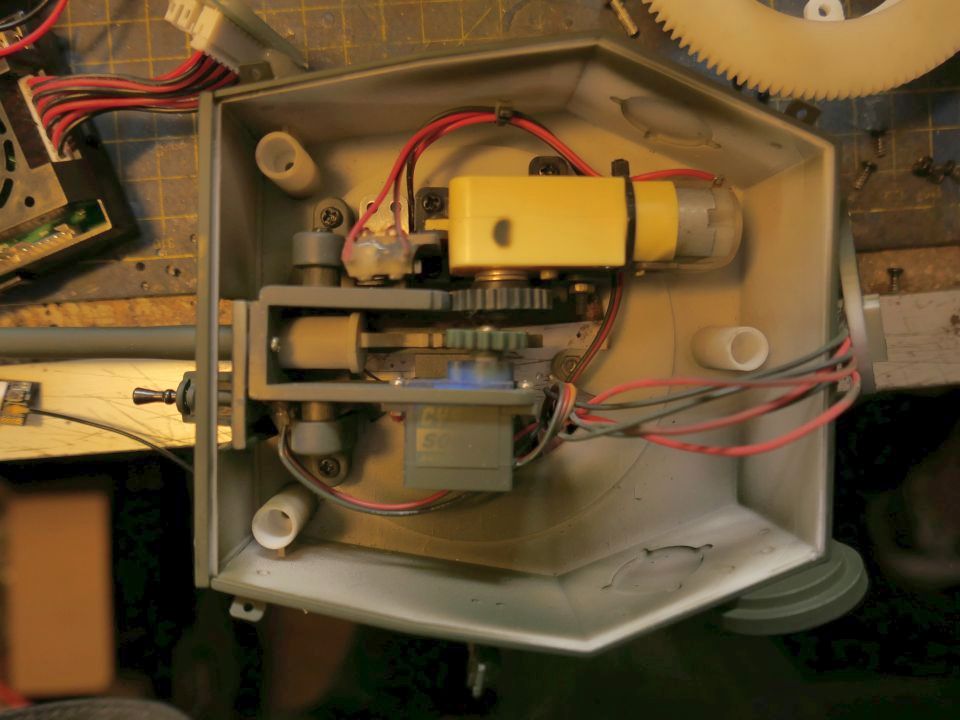

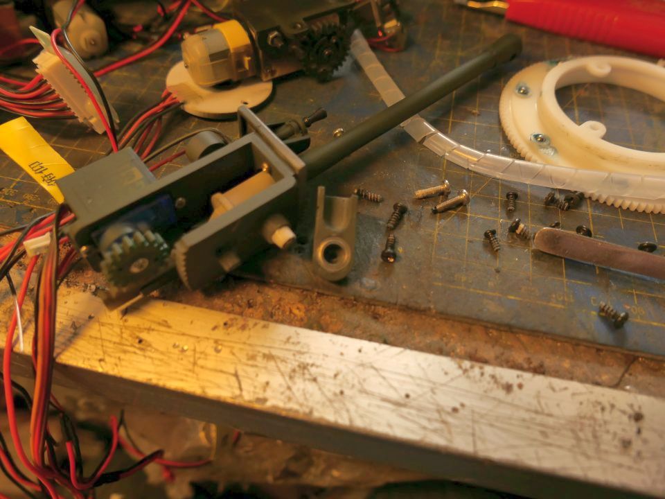

Recoil by servo, elevation by geared motor:
the turret is on a PTFE-Ring, held on the underside with balls :
ball bearings at the gun:

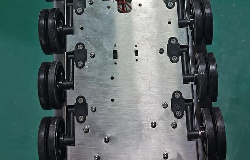

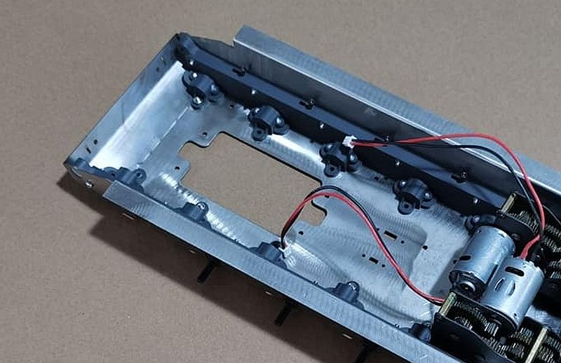

Would love to see some close ups of the suspension as well confirmation on materials used. Thanks! 8)
jhamm
Posts: 1119
Location: Germany
Re: Cromwell from Hooben
Post by jhamm »
Xiaoshan_Sailor wrote:Would love to see some close ups of the suspension as well confirmation on materials used. Thanks! 8)
I can't take better pictures than Hooben, at my tank all parts looks similar.
It look like a Christies suspension, but it isn´t.
Above the suspensionarm is a spring centered by a screw.
This screw also limits the spring travel.
when the tank is normally on flat ground, the screws are at the stop, in my opinion this is due to springs that are too tight.
The suspension can only compress.
