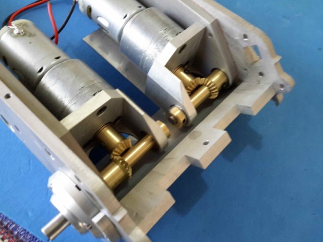

Seeing Kostyanchik making a planetary gear box, inspired me again having a go making my own gear box on the bevel gear principal.
I already found 4 bevel gears with modul 1 and 15 teeth for a shaft diameter of 6mm on the internet for $ 14.40 AUD.
Also 2 geared motors 30 rpm for 6 to 12 volt for $ 20.60 AUD .Will post a building report when finished.
Walter

Here are my latest gear boxes installed

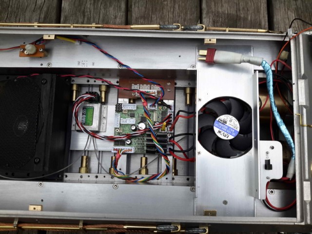

I moved the speakers to the back of the tank. I found it increases the sound quite a bit.

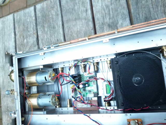

And the battery is now up font.
