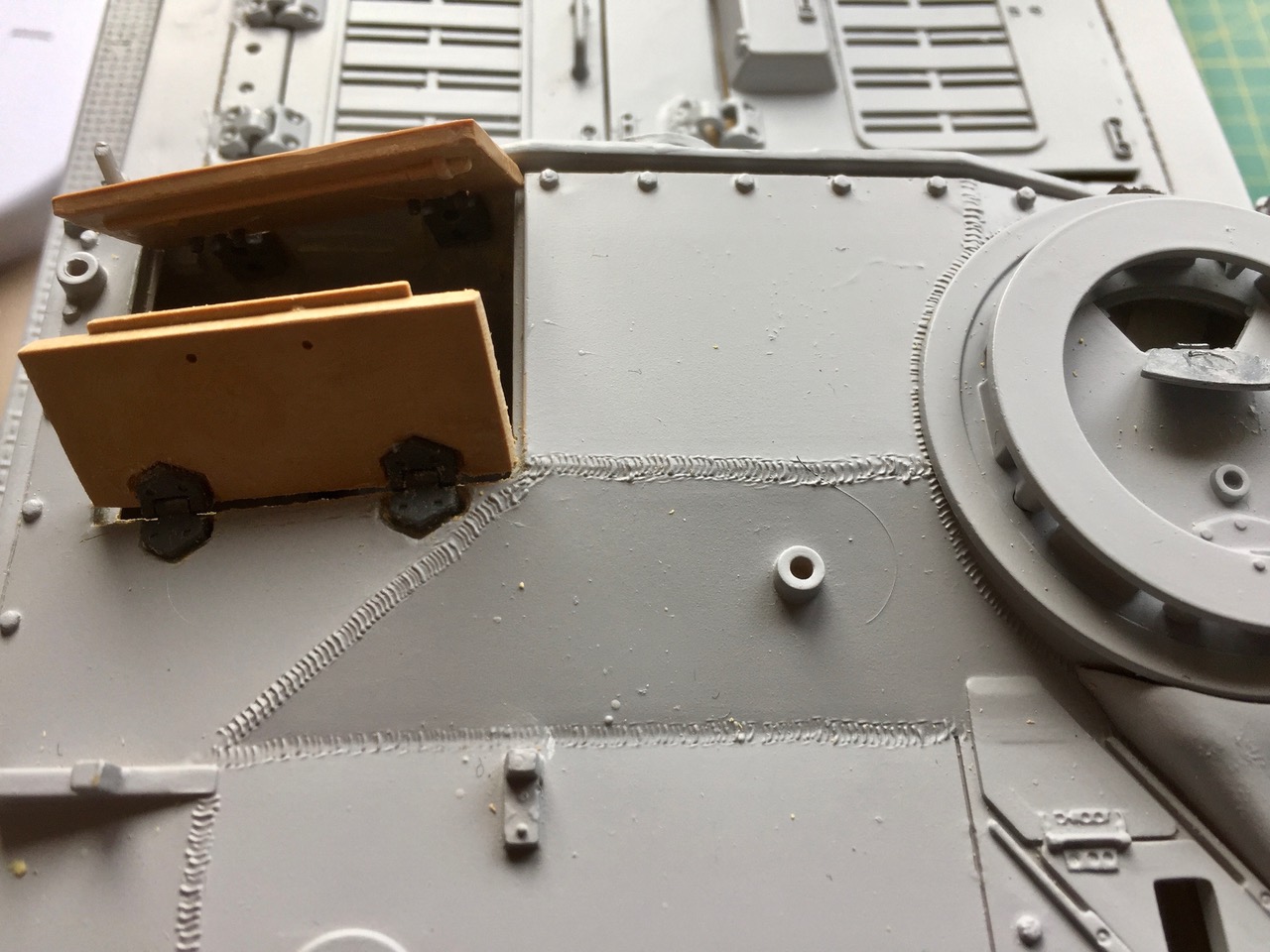

Ok, it's time to correct that wonky hinge arrangement on the Machine Gunner's/Loader's hatch.
Challenge of fitting hatch hinge..
You can see what a mismatch we have here, notwithstanding the slightly blurry quality of the pic.. :lolno:

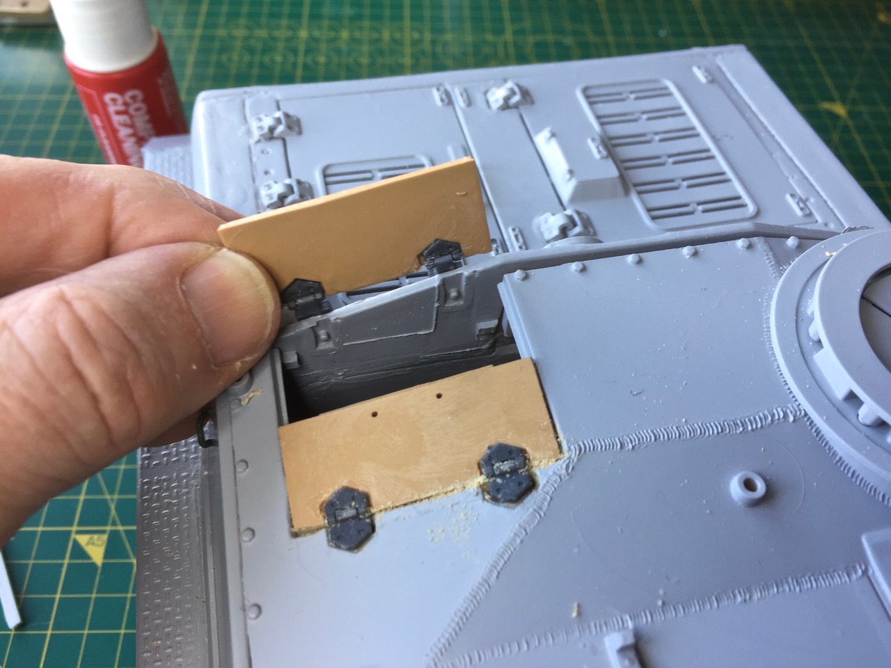

Another angle on the hinge challenge

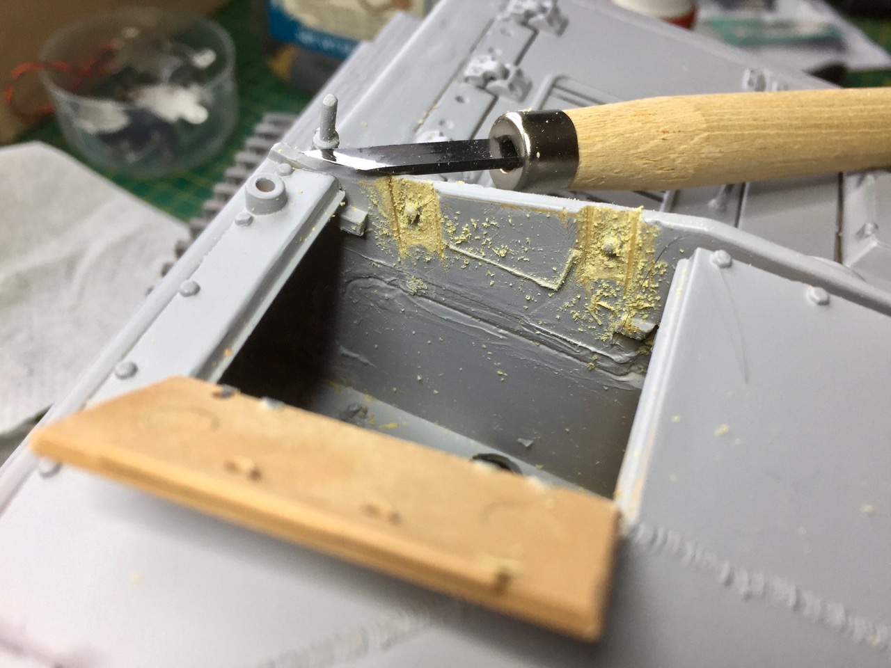

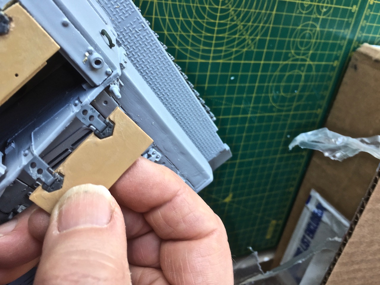

I have a set of modelling chisels that are very sharp.. :problem: .. and so the challenge was not to inadvertently remove the one locating stud, in the badly angled casemate hinge recess.. :shifty:
Tank trimming session..not for the likes of Sweeney Todd
Re: Asiatam StuG IV conversion kit...
Luckily, I don't yet suffer from age-related tremor ...yet :| :haha:
Here's the hinge fitted successfully..
Now to make an interior support frame from the electronics...but that's for another day

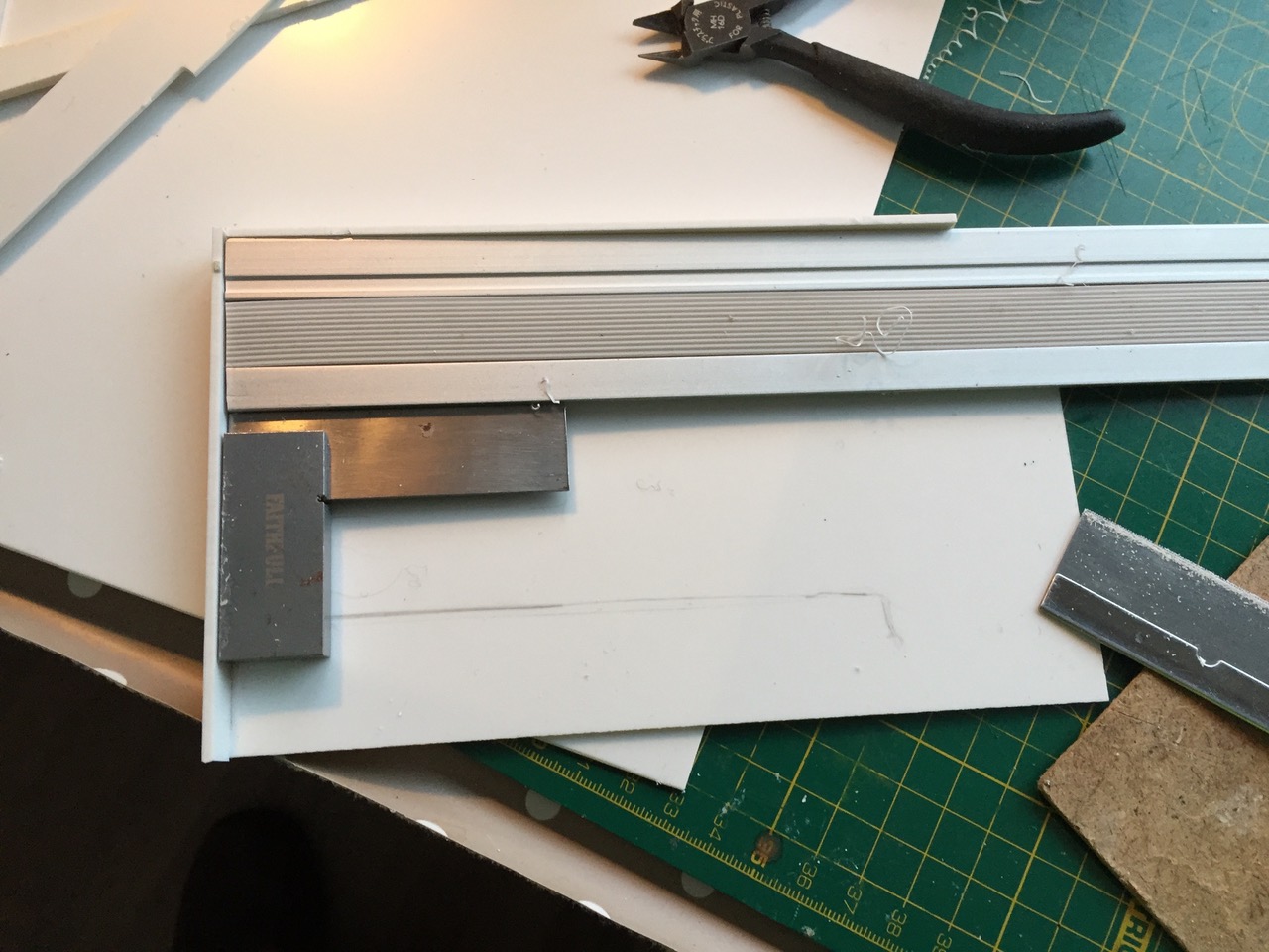

Since the exterior is progressing well, I thought I'd check to see what sort of problems- if any- I'd encounter when installing the electronics.

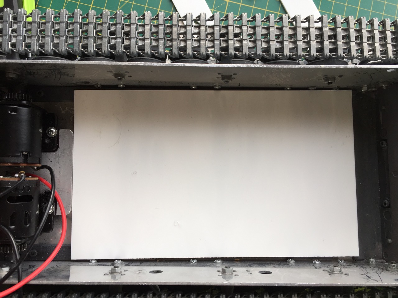

The first order of business, as it was with the Cromwell scratch build, is to build some manner of liner to hold the components securely. This approximates to Tamiya's 'Mechanism deck". It's also an exercise in component ergonomics: what goes where best..
Liner for Asiatam StuG IV- mechanism deck
Liner for Asiatam StuG IV- creating layout

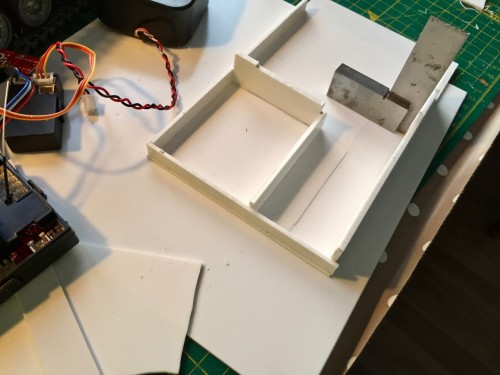

Dimensions of a typical 7.2v battery and the MFU have been marked in pencil
Liner for Asiatam StuG- MFU container bonded in
Having a 'mechanism deck' that can be easily removed, and yet remain secure when in place, is very useful. :thumbup:
So far, there is an enclosure for the MFU. This will also fit the TK22 or TK24 if that upgrade is ever called for..

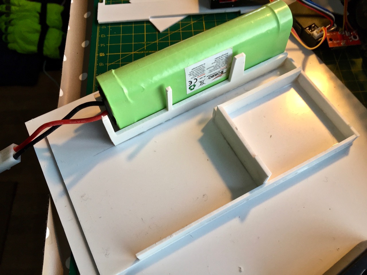

Now a support is needed for the battery:
Liner for Asiatam StuG IV- support brace for battery
Like most modellers, I expect, I have a stash of styrene sheets of varying sizes. This is what the deck came from. The rest is recycled styrene sprue from the Cromwell kit, and other projects. A good tip: never chuck any styrene bits away. Unlike other possessions (junk?) in the house that end up in anonymous boxes in the loft, or garage,..classified as 'could be useful someday'- styrene is likely to be useful, and likely to be used :thumbup:

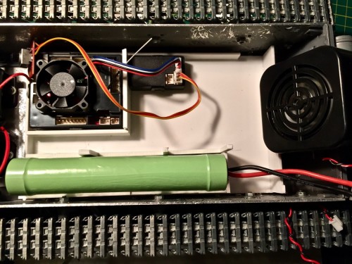

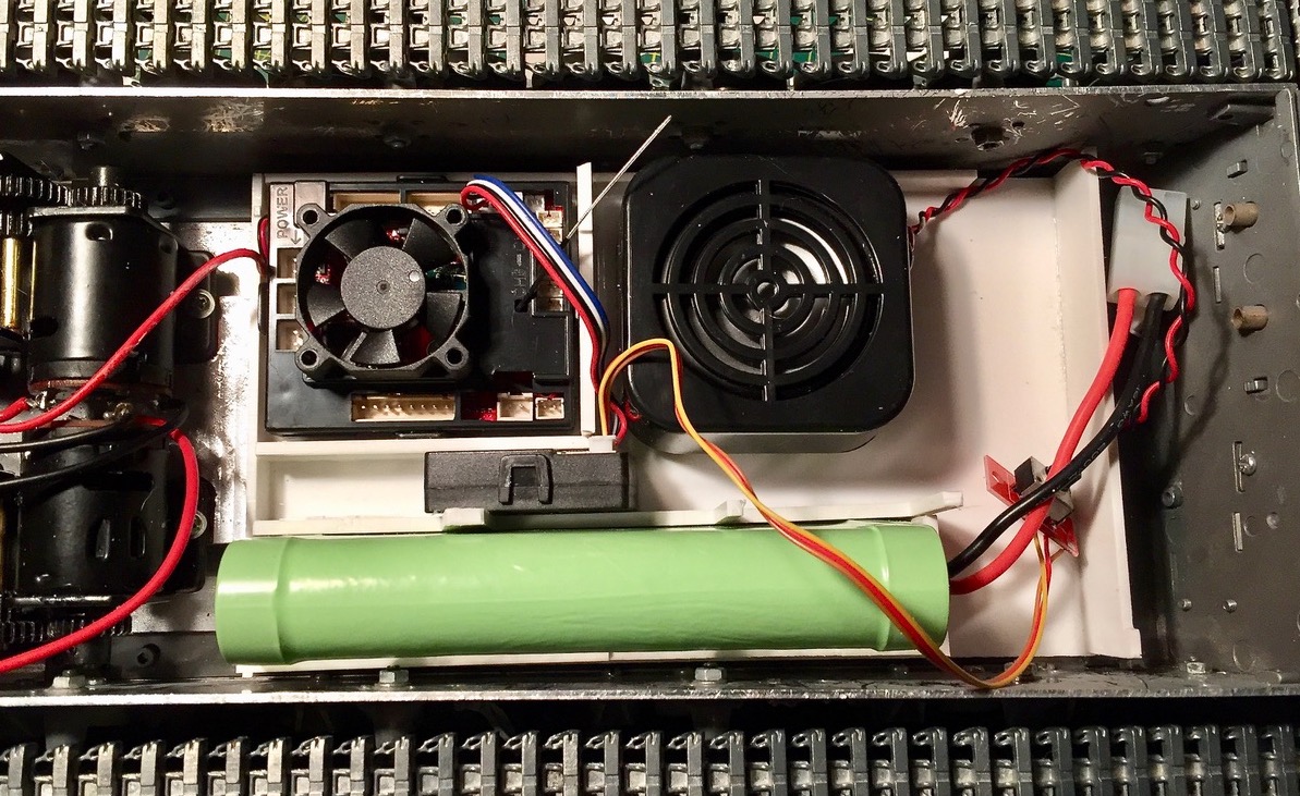

Here's one possible configuration. The battery and MFU positions are fixed. The new Taigen sound module can be fixed to the sidewall, the deck, or the upper hull with double sided tape. In the pic, it's wedged between the battery and MFU.The speaker can remain where it is. Horizontally or vertically.
If so, then there's room at the rear to mount a smoke unit. Two brass pipes are already in place, in the rear panel, for the smoker. Click to ENLARGE.
Asiatam StuG IV- electronics deck. One possible configuration

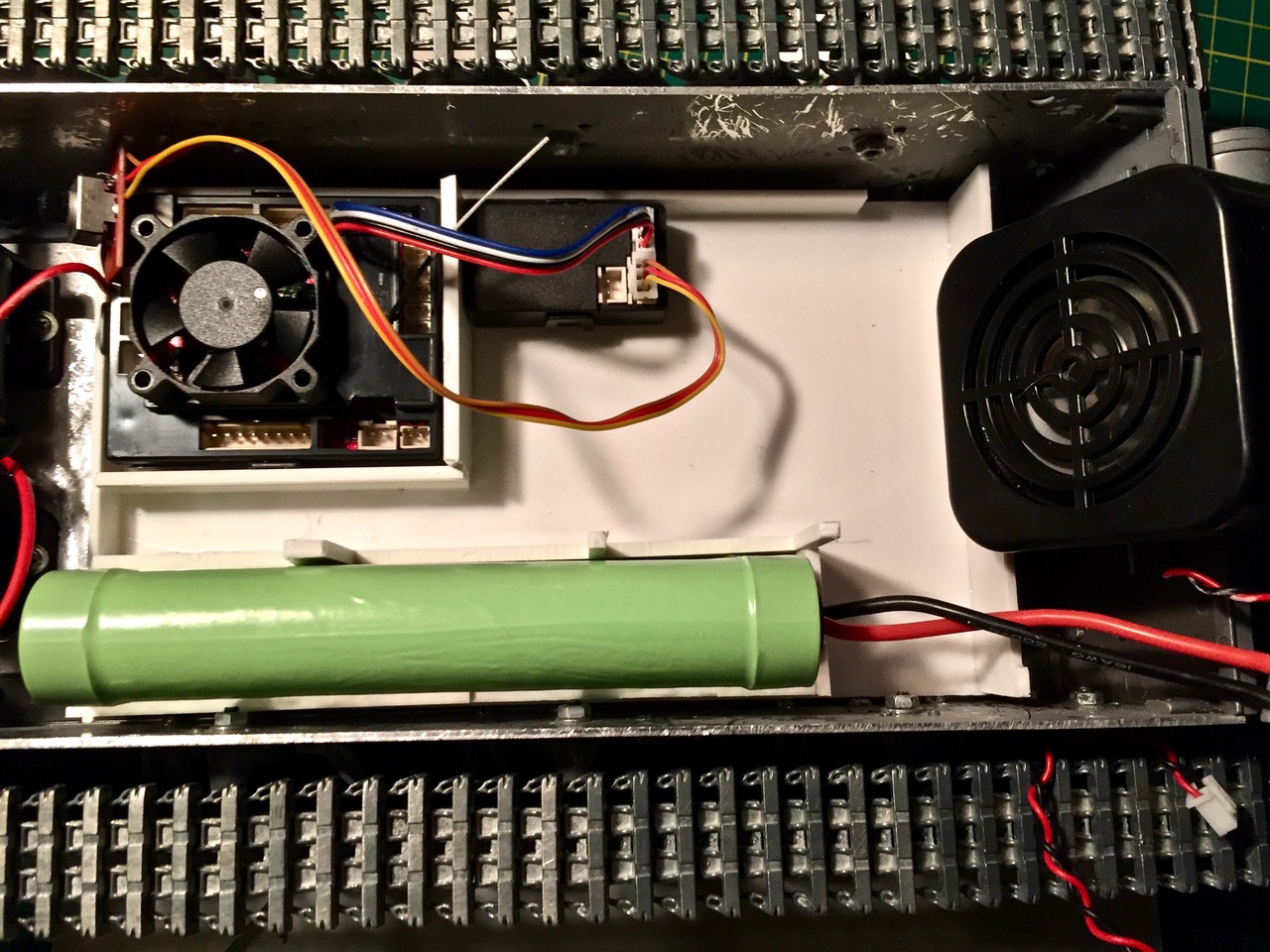

Alternative configuration for StuG IV electronics liner
Here's an alternative arrangement. Ideally, when a smoker is fitted, it ought to be roughly where the speaker is, in order to shorten the plastic pipes needed for the smoke. Long pipes appear to have an inhibiting, condensation effect, :think: on the smoke...
