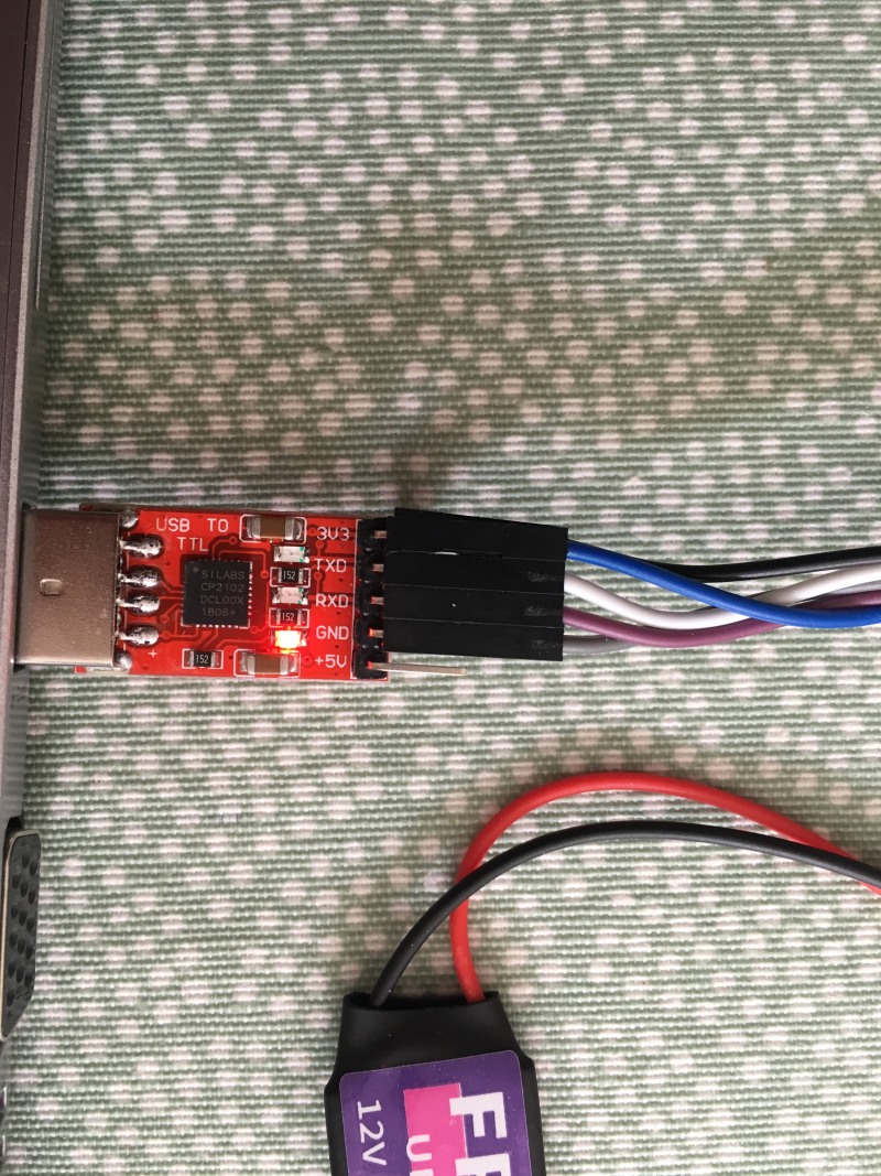

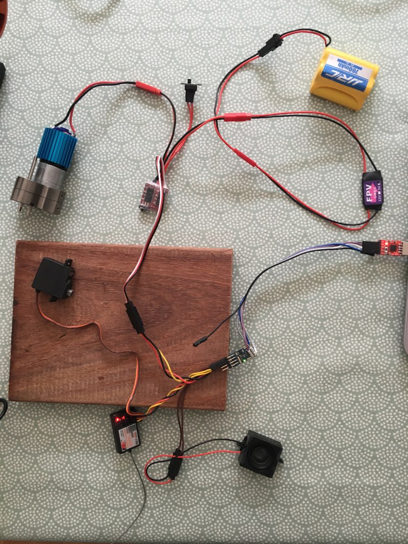

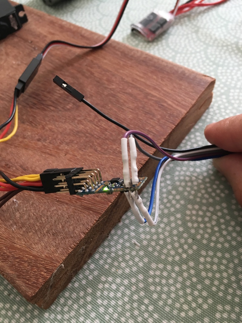

Re: Dasmikro (TBS Benedini clone)
Thanks, here are some pictures
the 3.3v are not necessary and why you don't put the battery directly to your esc
With this setup, I can test the unit with the transmitter. If the 3.3V is not connected, there is no light and the software says "modul does not answer". Thus the connection to the computer is not possible. If I only use 3.3V, I can connect to the software and make changes. I tried with both connections after it started not work without computer.
