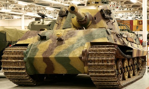

Some neat improvisations in the build (elevation unit etc.,), HB..and some real boldness with the Zimmerit. :thumbup:
When I bought my KT, it came with Tamiya's own zimmerit sheets, and I pondered long on hard as to whether to try them, or go for the Atak set many swear by ( and I would have sworn by them too, if I'd made a bad job of fitting them. They're not cheap... :problem: ) Once you fit the Tamiya sheets (Atak too, I imagine), removing them is practically impossible after a cock up, and since I wanted
my build to look neat like this:
Henschel-Krupp KT with zimmerit..
and not like the slightly out-of-scale picnic basket I'd pictured myself making; my build valour disappeared rapidly. :| I still have the Tamiya sheets, incidentally .., but prefer the cast finish that already exists on the stock turret, personally. :) All King Tigers produced after Oct 1944 didn't have Zimmerit anyway (phew), and that provided me with the precedent I needed not to be so bold. :D
Hope the buggered pedal extremity is allowing you to get as far as the drinks cabinet :wave: :D

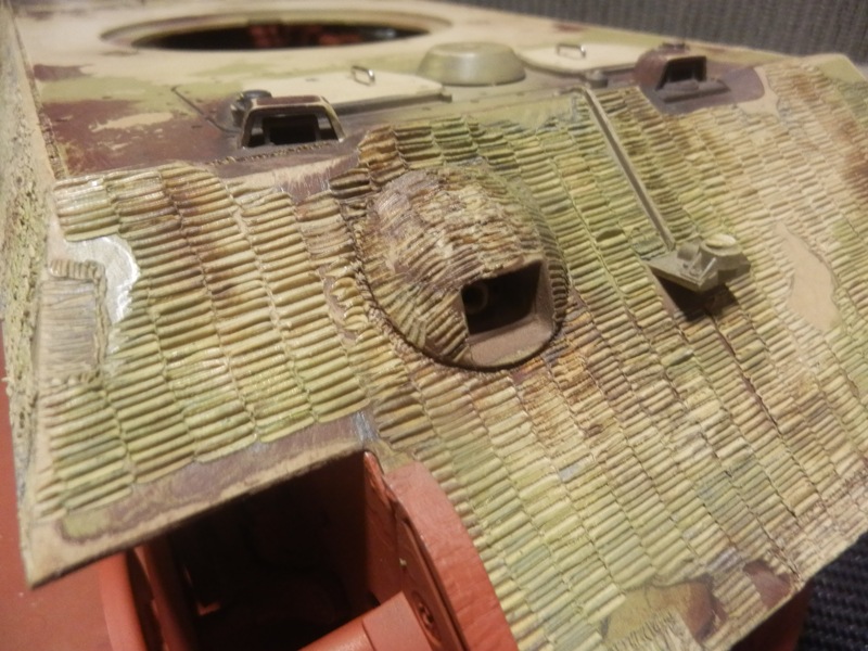

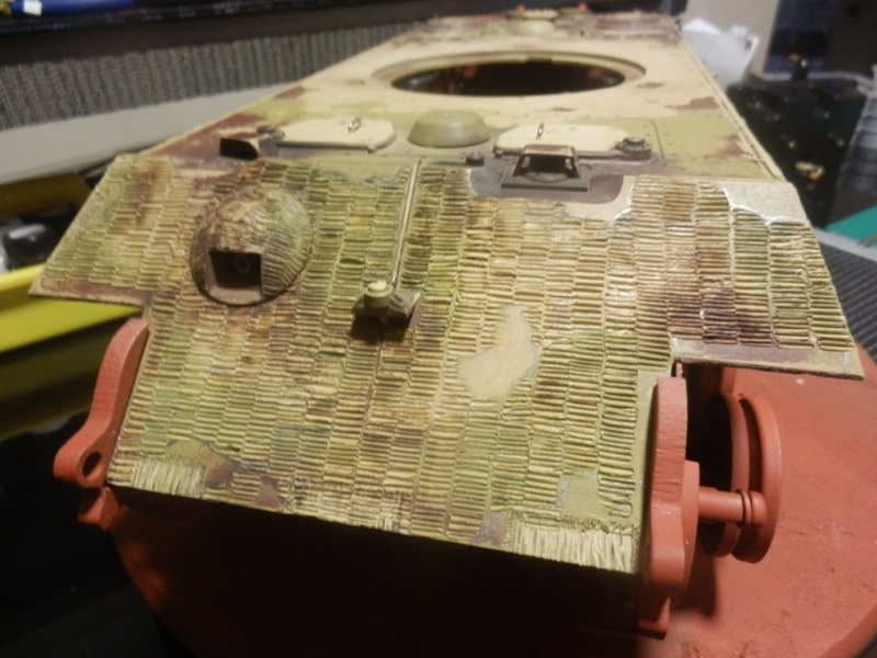

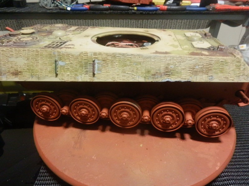

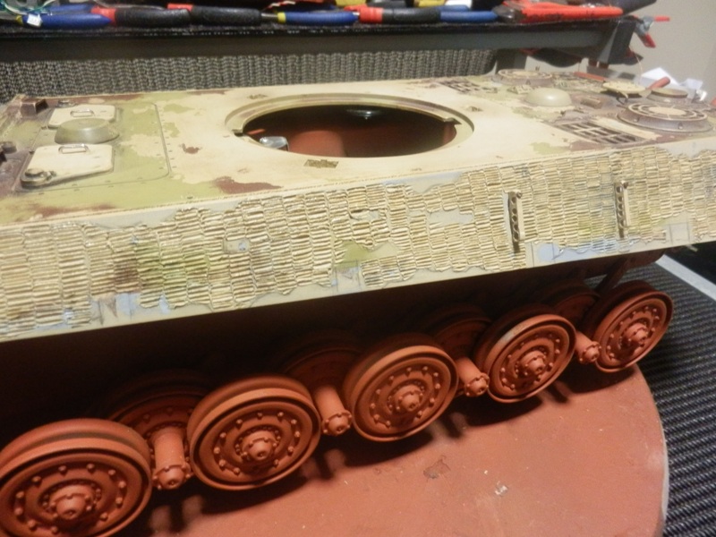

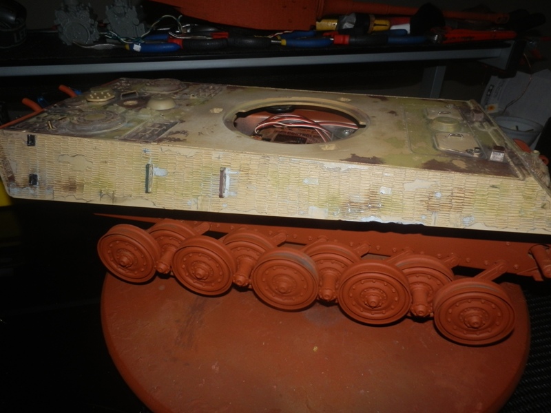

With the tank now located, and my space set up close to right, I was able to get a bit done this evening.
I am still missing a box with other vital gear in it, such as my Ryobi/dremel tool, all my razor saws , and airbrush etc. :/ :problem:
Im certain they are here but I'm over carting & unpacking boxes for now.
All the hull zimmerit is done, apart from bits left blank to allow the fitting of track pulling cables and towing cable clamps.
The turret is clean of damaged zimmerit, but the hull has a few bits missing, going to assume that tree branches dont tear the stuff off as much as Bocage, stone walls, and other robust objects do.
All the edges under the mudguards are missing zimmerit coating in places, this also helps in not bowing the plastic out towards the stress-relieved side.
The sides have a tiny bit of bowing, but for what it is, I can live with it.
Overall, the melt method of zimmerit application for me is the most reliable in its effect, and consistent in its thickness & finish.
I'm picking this as a September '44 production-right at the end of zimmerit application on King Tigers, which can explain its reasonably good condition before capture.
If I can get close to this, I will be very happy..........

Herman, that zimmerit looks awesome. :clap:
Hold on, if the Tamiya plastic is that thin, and you didn't apply the zimmerit, how the hell did you make the damaged patches look like the zimmerit has fallen off??? :think:
