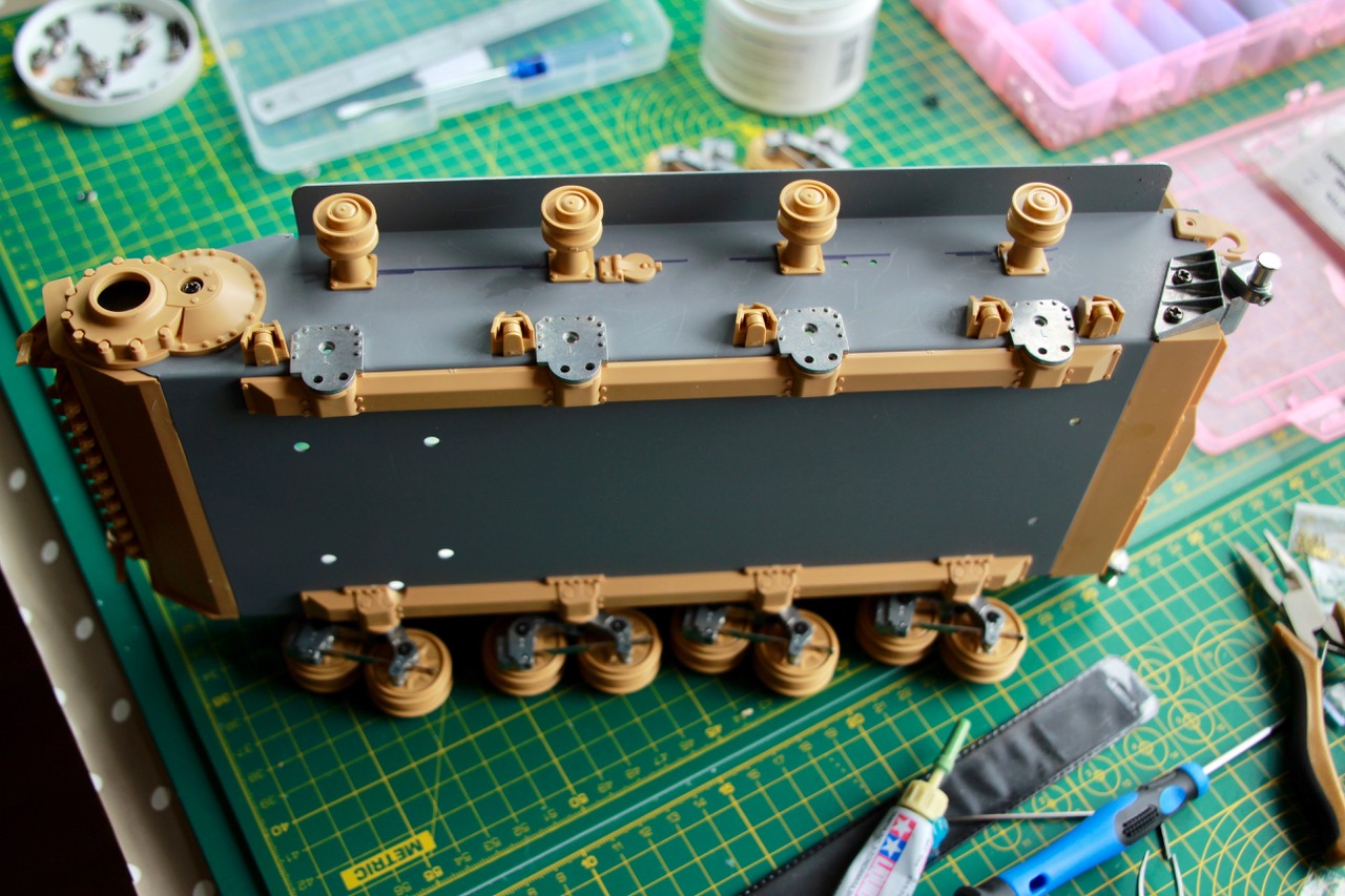

Fitting the Tamiya Pz IV suspension bogeys..
You need three hands to fit these units. But I found that binding the four baseplates to the hull with a little thread locker worked a treat for keeping them in place :thumbup:
Don't be deceived by the drive transmission housing. I only have one, and need another 'B" sprue to complete both sides. Thus far, though, and in keeping with the research brief, I haven't actually bought a Tamiya Pz IV kit! I've just been being bits piecemeal. More than that, MIke's input (donation) has helped to give the upper and lower hulls an almost complete look.

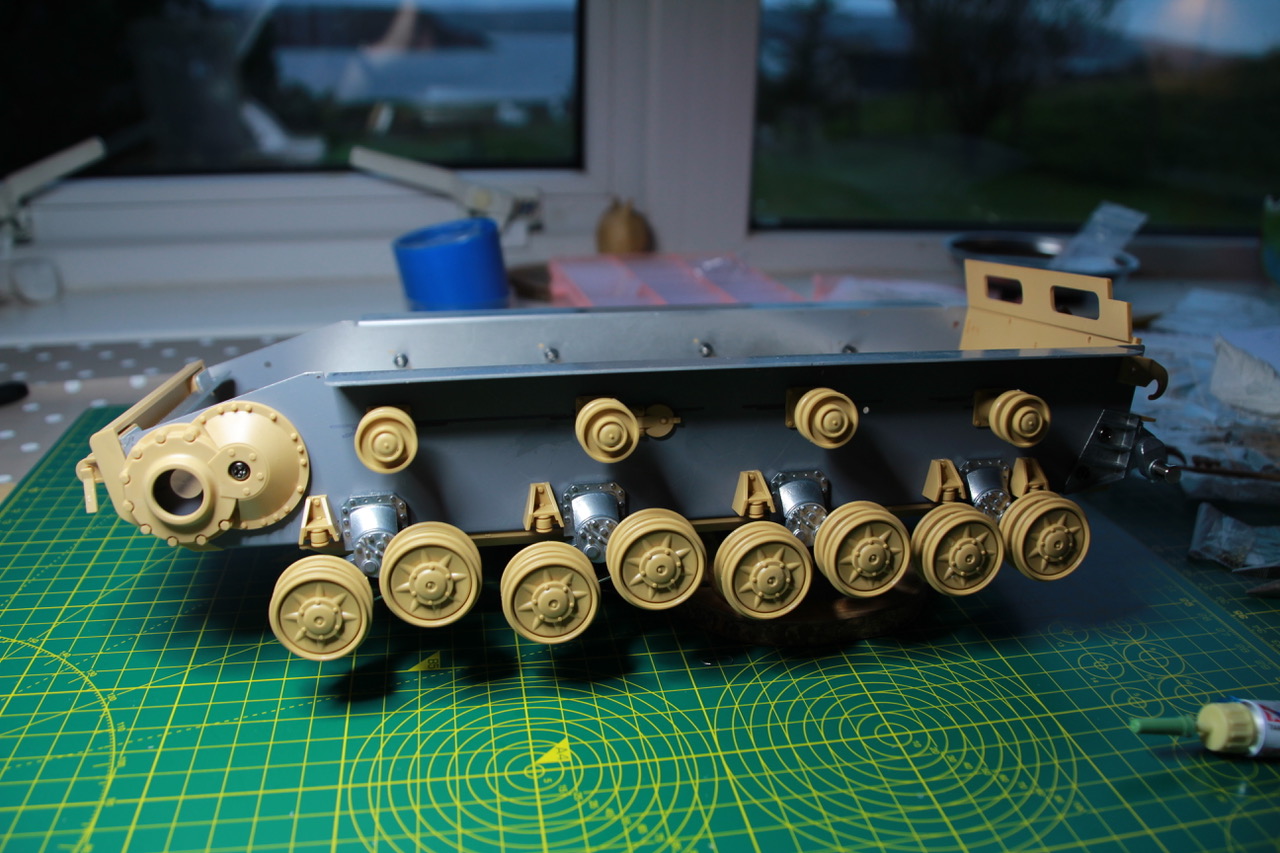

I've measured the Tamiya and Asiatam/Taigen roadwheels, and they're exactly the same size. So it occurred to me that Taigen tyres would probably fit Tamiya wheels. I noted that Dominique (rctank.de ) sells full replacements sets of tyres for Pz IV road wheels- and return rollers, and decided to take the plunge ( + minor financial risk) by ordering a set. I'm pretty sure they'll fit. If not, they may be of use to someone here. The process will be facilitated by the overly large tub of synthetic 'rubber cement' I ordered for the KT project...and didn't really need :problem:
Left side suspension in place.

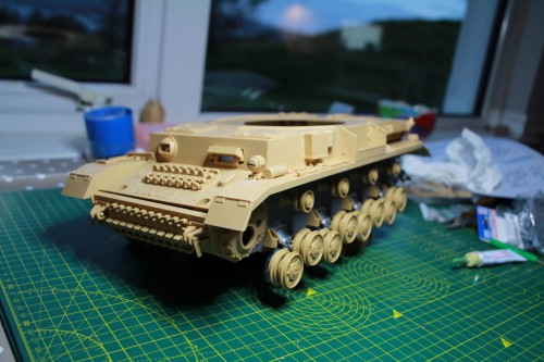

Right, well here's a snap of the almost fully adorned Upper hull, sitting loosely, atop the now almost rolling chassis. Too late to stop now! :haha: This building bug eats away at you, and can only be partially relieved by the arrival of the Postie, or a courier ( AKA the 'Candyman' :D ) with the next polystyrene 'fix'!
PzIV upper and lower hull meet for the first time..
