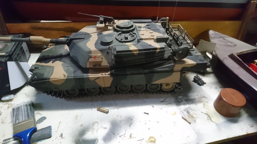

Here's a brief update till tomorrow night!

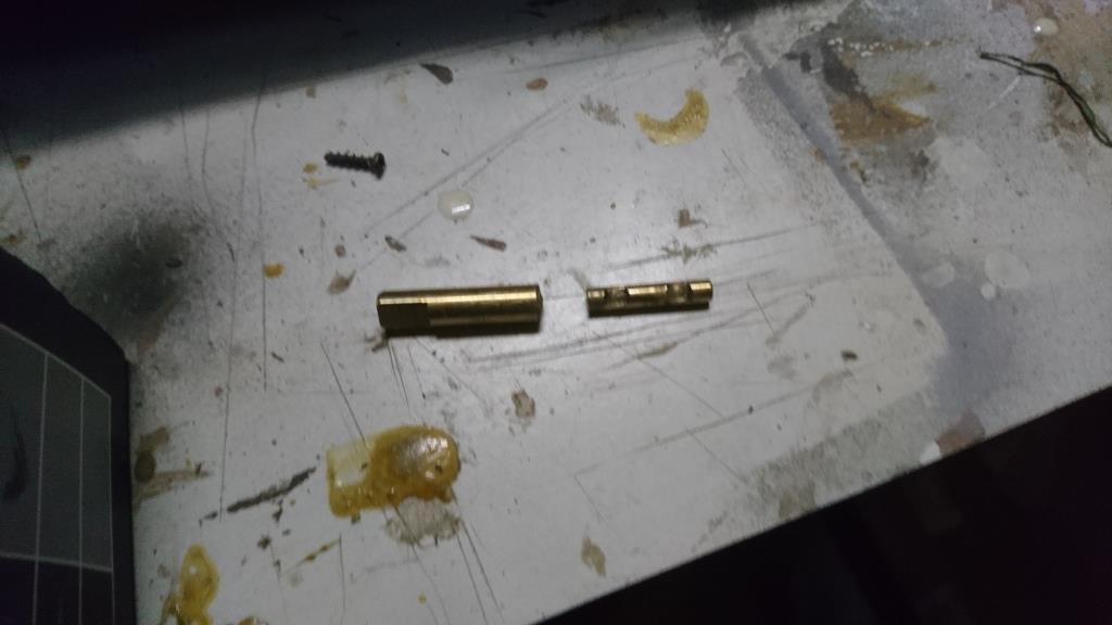

Pics of broken axle. The new gearbox's have the steel shaft already fitted fortunately....

I only have a few HengLong tanks (mostly Taigen/Torro), so I did'nt know HengLong tanks had brass axles. Just last week I had to pull out and replace a steel axle from a Mato M10. On examining the axle, a machine-familiar friend says it looks as if it was cut on the lathe off-center. :-<

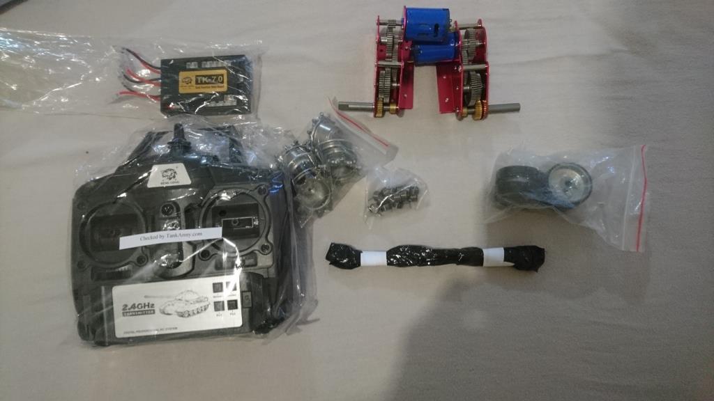

The earlier version of the Ultimate II gearbox had brass axles on the sprocket for some dumb reason, The new replacement ones have the steel axles already fitted....

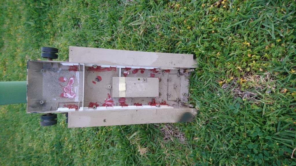

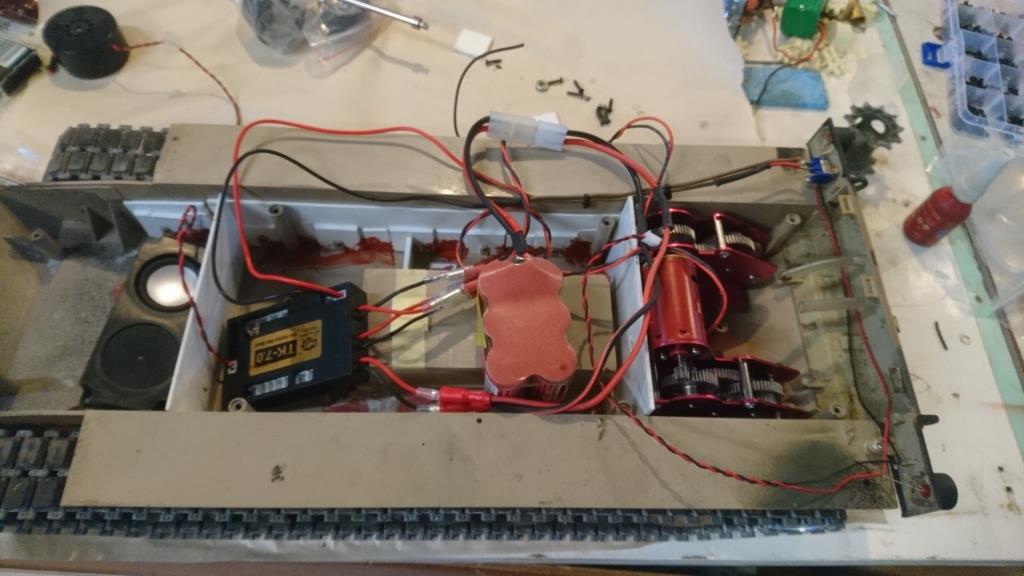

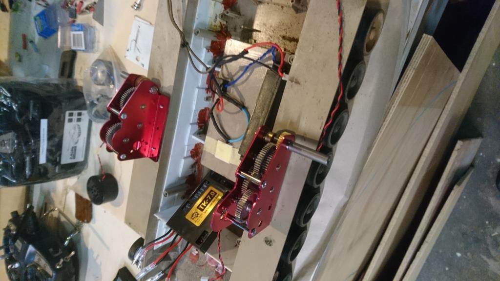

stripped the hull back and cleaned out the dirt... must get the axle supports soon too.

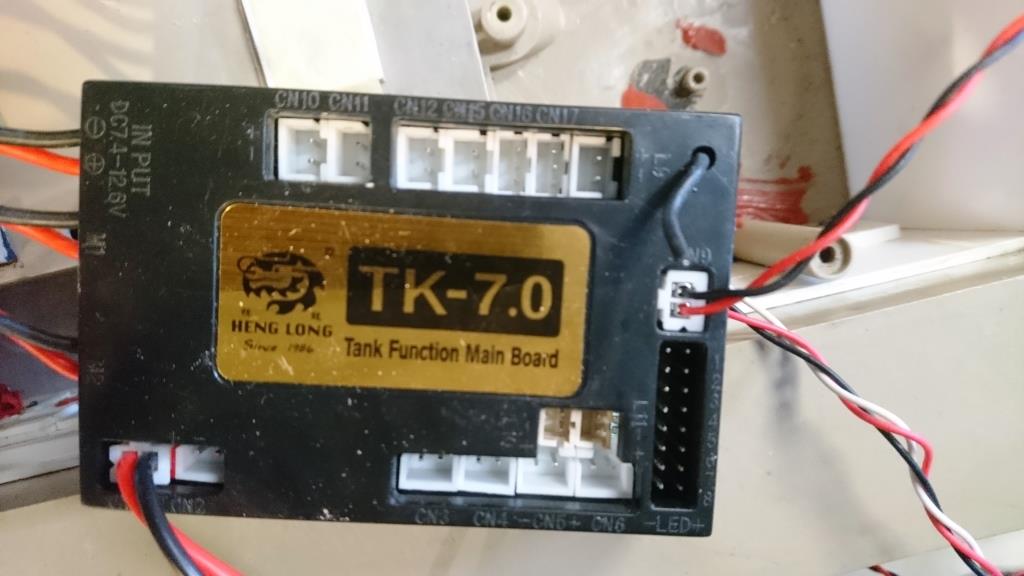

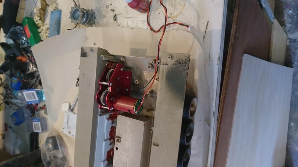

First up I used a dob of loctite on the new sprocket with slip rings to hold them together, left it overnight to set. Then installed the new gearboxes and the sprockets next day after work.
Then did a bit of rewiring to suit the 7.0 mfu, wired up motors, new battery lead (temporary till I get a lipo with an xt60 plug) and did a test run with the 12v Nimh pack that normally powers my USS Seawolf SSN21.....goes like a rocket on 12v and the GT engine startup is great!! need to swap the battery leads over as fwd on stick is backwards and rev is fwds!! This is just a test setup for now before I chop out the battery box and reinforce lower hull with some 2mm Aluminum plate and replace the plastic X bracing with some 3mm Aluminum bits (might get a pre cut bracing kit of ebay).
Also on the to do list is fit the new solid idler axle, the metal track support rollers and add a link back into each track to reduce tension as the first road wheel is being pulled up by the tight track.
I still need the correct plugs to hook up turret elevation, bb firing and the headlights/tail lights....might add indicators later
here are some pics...

HvyCgn9 wrote: ...need to swap the battery leads over as fwd on stick is backwards and rev is fwds!!
Please don't do this. Replacing the battery polarity will end the life of your MFU. You just have to swap the ESC motor power cables ( plus and minus ).
Here you have it exactly described:
viewtopic.php?f=201&t=30903&start=20
download/file.php?id=91744&mode=view
And if there are still wrong directions - swap the motor wires from MFU to motors (M1 motor to M2 MFU etc.)
Thanks Mate!! I mean't swap motor leads over in my head but my fingers typed battery!! I will get some correct plugs and finish setting this up next week

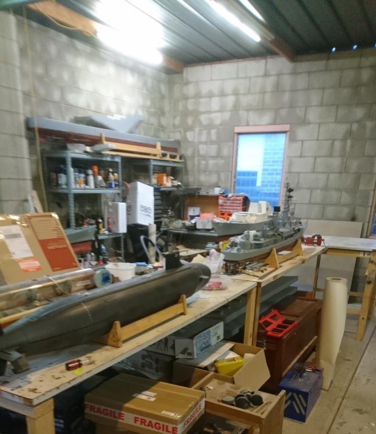

my side of the shed currently has my 1/72 Rc ships in it....2x USN CGNs, 1 LHA, 2x SSNs,a Burke DDG a RN type23 frigate, plus a mates HMAS Brisbane DDG41 and several hulls for future builds!!(see pic) Tanks are just for fun....

Been messing about today trying to get the 7.0 wiring for BB unit working.....cannot get it to fire if it is plugged into the correct channel (CN10) if I plug it into cn12 (smoker) and hit the smoke button on Tx it will repeat fire until button hit again. Not sure what is going on.
Got turret elevation sorted just needed to change plugs
