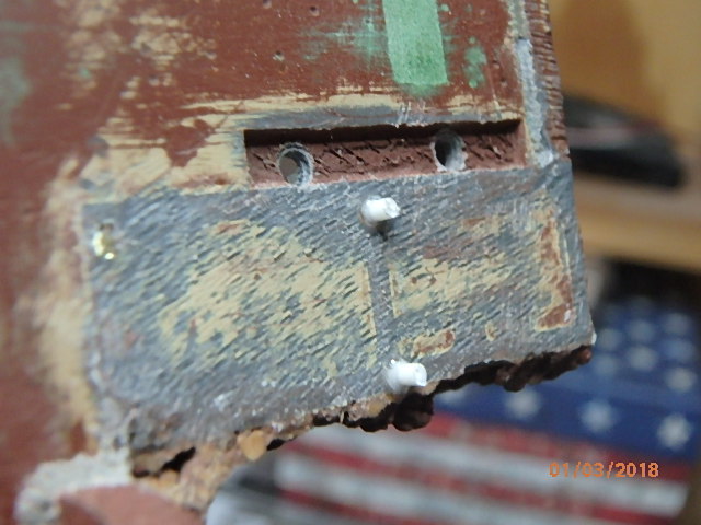

Using some plastic rod to fill holes...glued in place.

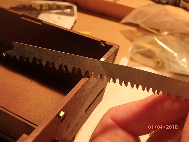

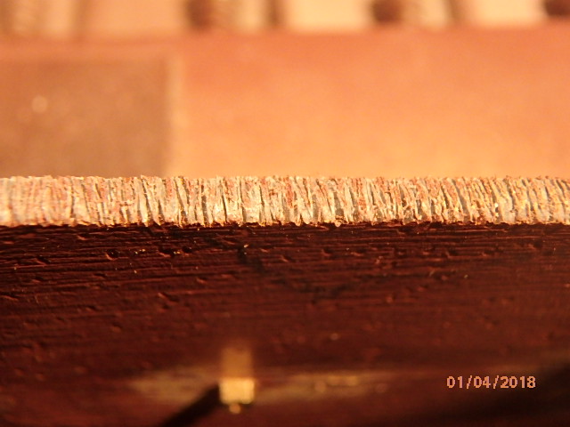

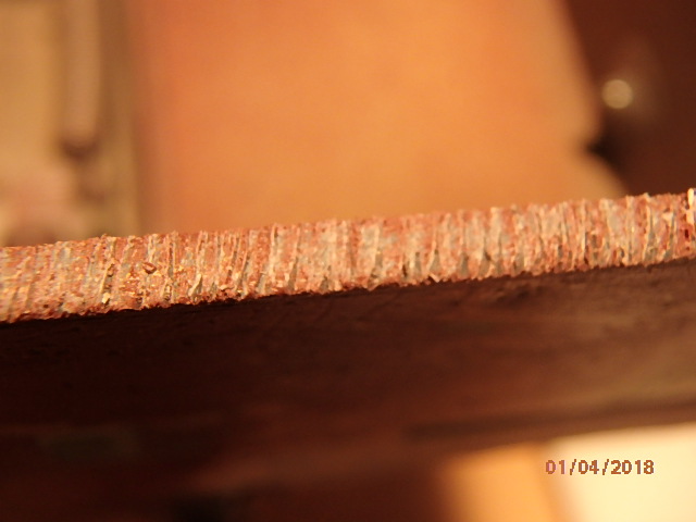

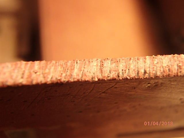

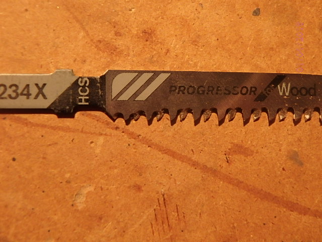

Using a Bosch T234x ruff wood saw bit to replicate factory torch cut marks on the hull. Just turn saw blade to the left at about 45 degrees so your only using the corners of the saw teeth. Then pull back towards you. Don't try to push or it may chip the plastic. keep it up until the area is to your satisfaction then move on to another spot. Don't over do it or you'll end up cutting a groove and it won't look right. Sorry, you guys with Metal hull Tigers...this won't work for ya ;D
while plastic rod glue sets up I decided to replicate some torch cutting marks on the hull that was apparent on the Tigers out of the factories.
Before cut on hull.
Before cut on hull.
Tilt at about 45 degrees and pull back towards you. Don't try to push, it may chip plastic.
Wellaaaa....
Wellaaaa....

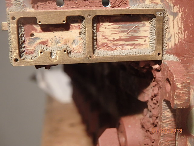

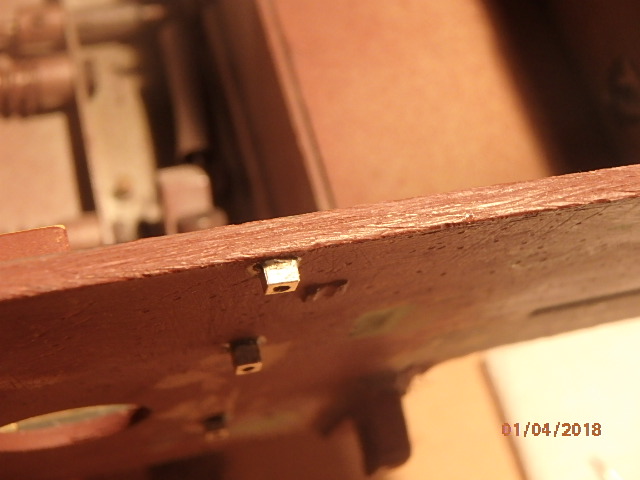

I fabbed up some mounting tabs from pieces of Brass PE sprue.
Made up some alternative mounting out of brass to beef up mounting rear mud guards to rear hull.

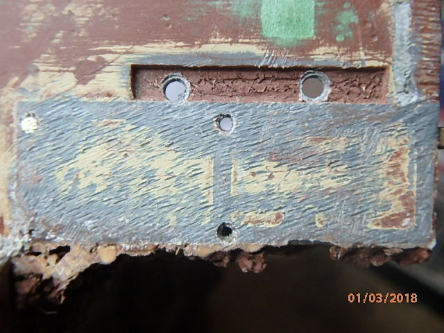

Drilled out 2 holes in stock mounting slot for brass rod to slide through hull.
Fit like a glove.
Fit like a glove.
Soldered beefy mounts to 3 mounting tabs.
