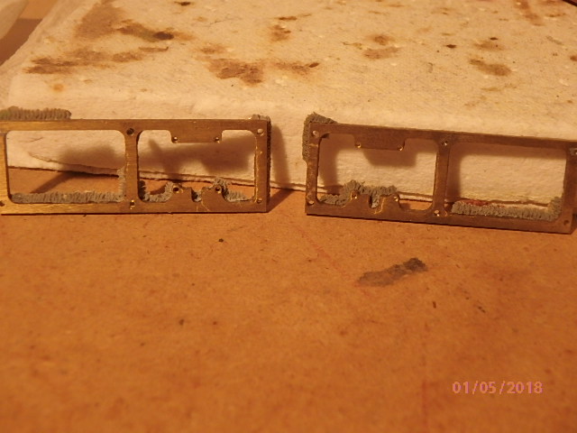

Hey Guys, HAPPY FRIDAY!!!! :clap: This last week I was working with rear ABER PE mud guards after work... I made some progress, but found out I had made a couple mistakes in my research before buying and assembly some parts...Live and learn I guess....Like my gramps used to say...Boy if your not making mistakes...you aint trying hard enough!!! :D
I mounted these rear mud guard frames and was so happy, because they looked good, nice detail...Come to find out the later model Tiger I am building did not have these frames. It has the 3 metal tabs welded straight to the rear Hull :crazy: So, if anyone needs some rear mud guard frames, I have an extra set...ha ha ha.... they need a little clean up, but are as good as new. Just send me a mailing address, pay for the shipping, and I will send them.
Well I mounted these Mud guard frames & found out later that the later model Tiger I'm shooting for did not have a frame

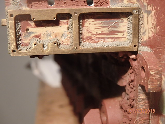

Cleaned up mounting area.

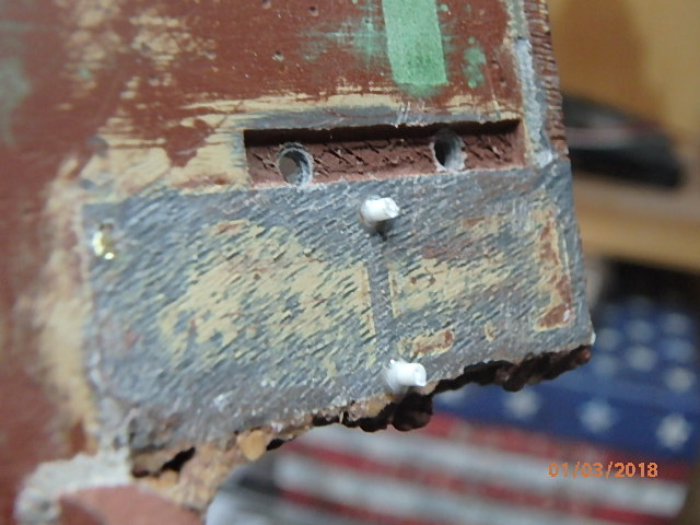

Using some plastic rod to fill holes...glued in place.

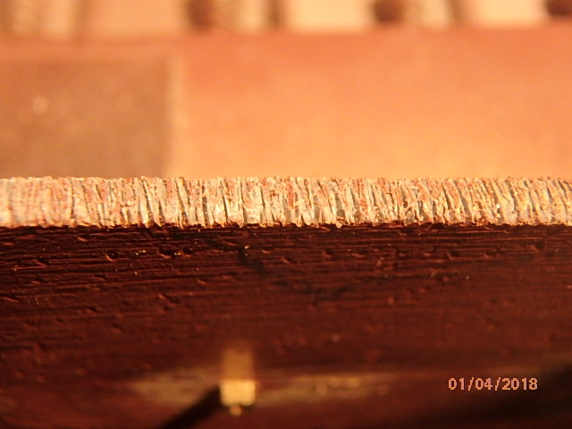

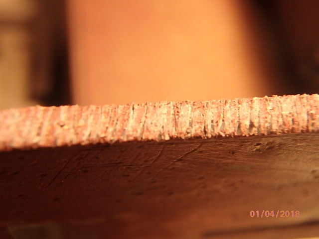

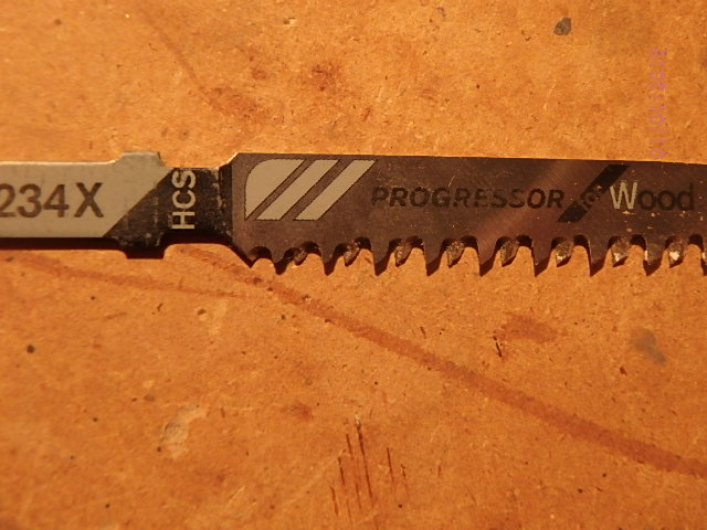

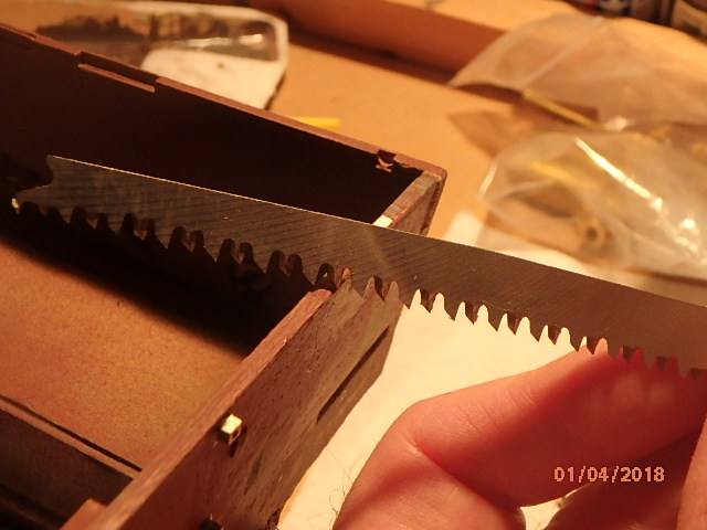

Using a Bosch T234x ruff wood saw bit to replicate factory torch cut marks on the hull. Just turn saw blade to the left at about 45 degrees so your only using the corners of the saw teeth. Then pull back towards you. Don't try to push or it may chip the plastic. keep it up until the area is to your satisfaction then move on to another spot. Don't over do it or you'll end up cutting a groove and it won't look right. Sorry, you guys with Metal hull Tigers...this won't work for ya ;D
while plastic rod glue sets up I decided to replicate some torch cutting marks on the hull that was apparent on the Tigers out of the factories.
Before cut on hull.
Before cut on hull.
Tilt at about 45 degrees and pull back towards you. Don't try to push, it may chip plastic.
Wellaaaa....
Wellaaaa....

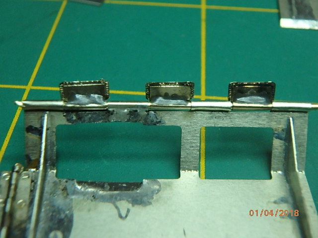

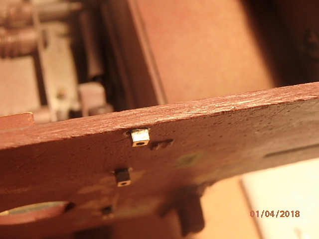

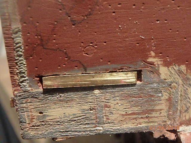

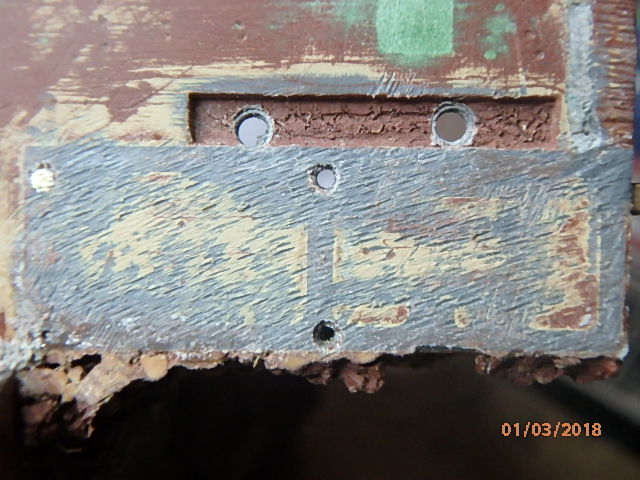

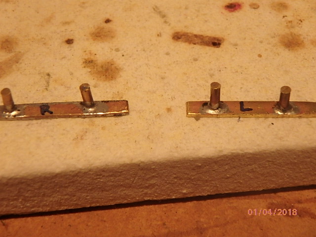

I fabbed up some mounting tabs from pieces of Brass PE sprue.
Made up some alternative mounting out of brass to beef up mounting rear mud guards to rear hull.

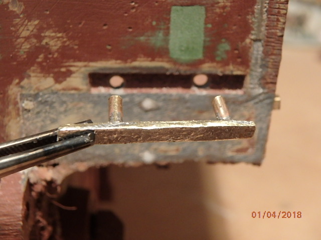

Drilled out 2 holes in stock mounting slot for brass rod to slide through hull.
Fit like a glove.
Fit like a glove.

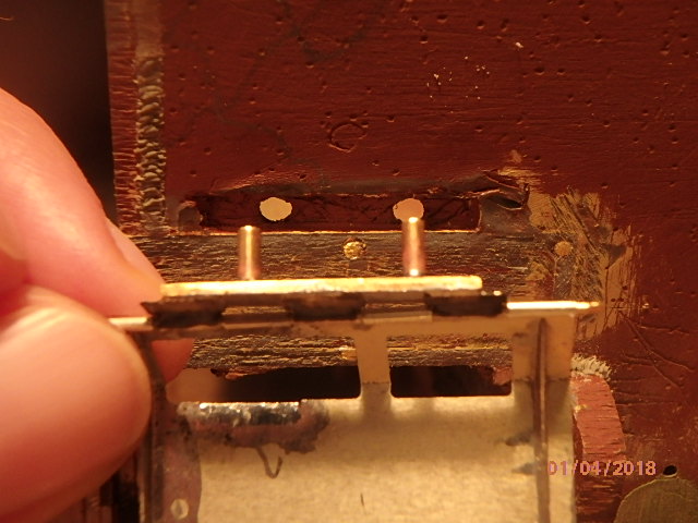

Soldered beefy mounts to 3 mounting tabs.
Ready for dry fit.
Ready for dry fit.
Just like down town!!!

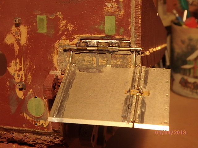

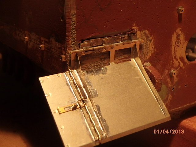

Thinking on flipping this mud guard side extension up.
Other side extension will be locked in place.

Both sides will flip upwards.

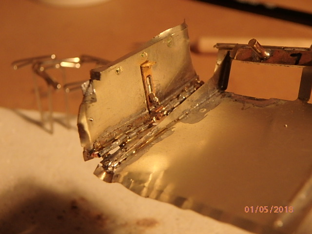

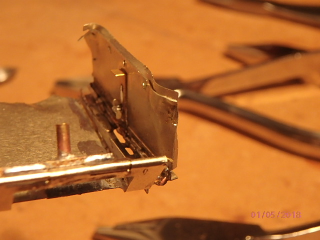

Now for the hard part...after all that work,...time to make some battle damage for that realistic look!!! :O Its kind of a double edge sword, because its a pain to get this PE looking good...but then again properly placed battle damage can add some character to your tank to set it apart from the rest. Its a love hate thing I guess!!! Looking through the photos of Tigers on deployment in numerous books, I came to the realization that these beast did not move over the terrain...THEY MOVED THROUGH IT, and destroyed everything in its path....
This fender met an immovable object along its travels.
Not new...out of the factory look.
