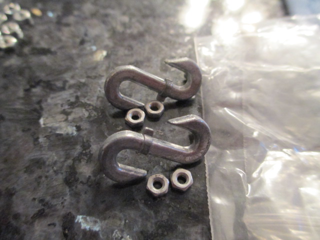

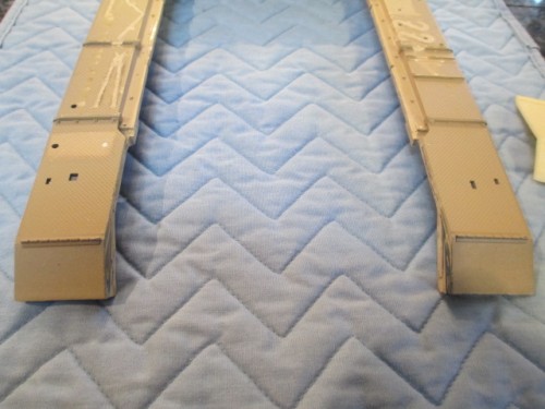

- Posts: 7941
Re: 1941 StuG III Ausf B

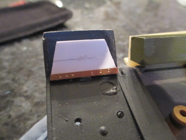

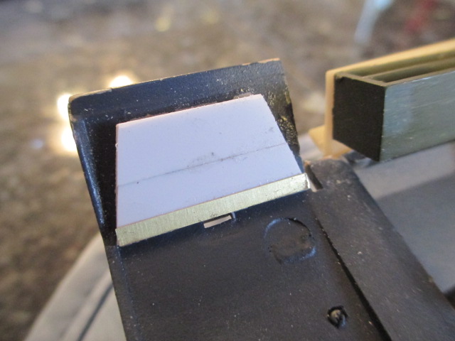

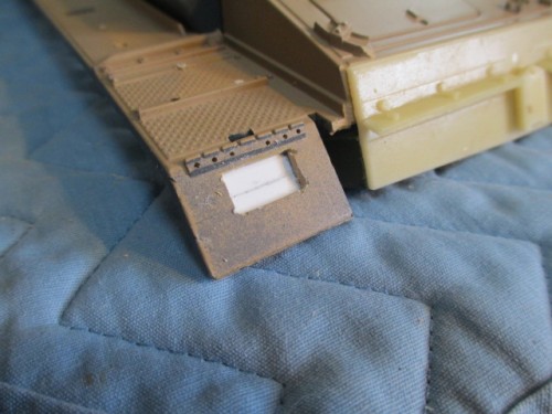

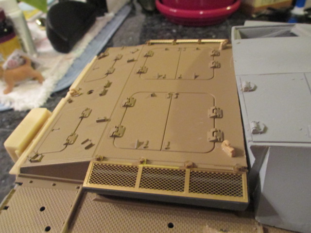

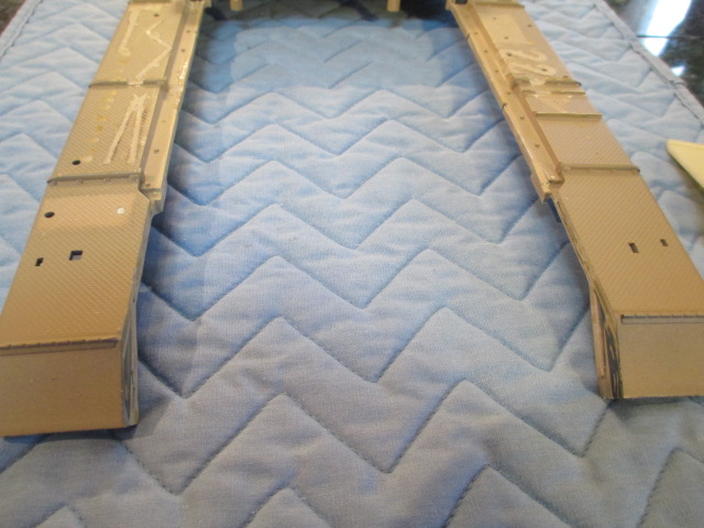

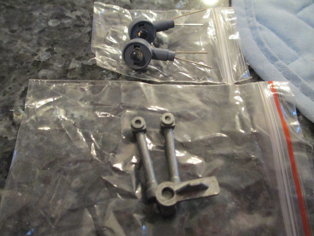

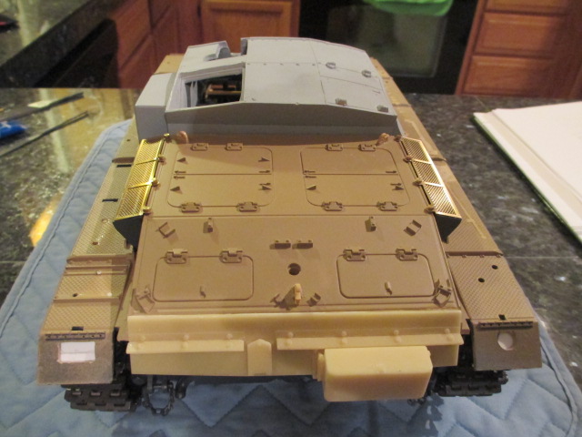

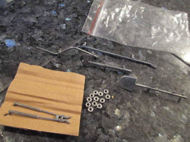

Mato parts arrived today. Some much needed stuff. On the work front, I finished detailing the rear fenders. At least as much as I want to. The little bolt holes underneath won't be seen by anyone once everything is together. Pictures:
- Tiny bolt holes underneath
- Tiny bolt holes underneath.JPG (88.35 KiB) Viewed 4280 times
- Brass strip for a hinge plate
- Brass strip for a hinge plate.JPG (88.48 KiB) Viewed 4280 times
- Metal S shackles
- Metal S shackles.JPG (96.45 KiB) Viewed 4280 times
- Shanto Mato and Murphy Ma
- Shanto Mato and Murphy Ma.JPG (88.49 KiB) Viewed 4280 times

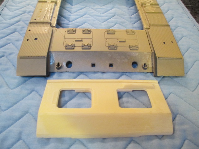

- Posts: 7941

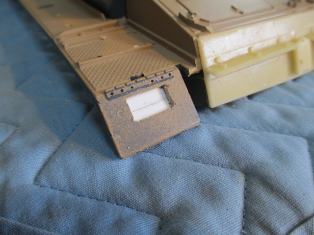

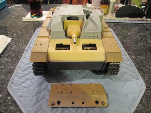

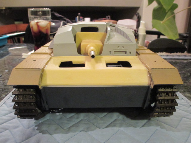

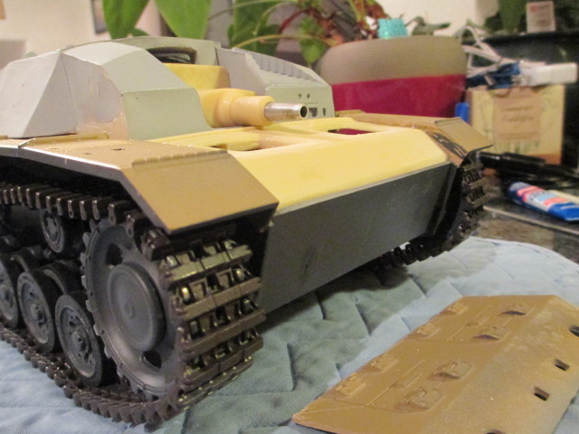

Tread plate located and ordered from Artistic Hobbies here in the States. I found a set of lifting hooks on a couple of spare Tamiya sprues so that was fortunate. I have a site that sells the correct working hinges and now need to decide how many opening hatches I need for maint., etc. Tonight's work, I considered the front glacis and addressed the question again of leaving the Panzer III version in place and sanding, puttying the thing flat and making correct hatch mounts for it. After a lot of mulling this over ( again ) I figured that the least amount of work and the best appearance would result in using the resin glacis from Profiline. I marked and cut using a razor saw, leaving a ribbon of plastic on either side. I thought I could file these down and use them as mounts for the resin piece. No such luck. Even after using the Dremel and a dressing file, they remained too thick and lifted the resin glacis clear of the lower hull at the front joint. I removed the rest of the original plastic completely and dry fitted the glacis to see what would be the best method to secure it. A bit more filing and fitting was required to get a square and solid fit but I expected that even with the generally good quality of the resin pour that made up my kit. I ended up the evening using my favorite Ultra Gel Glue to get the piece in place then followed that up with Loctite's excellent epoxy which will need to set for 24 hours to reach maximum strength. Tomorrow night, I will carefully drill and pin the glacis as well for a permanent fit. Pics:
- Something easy, the three required lifting hooks mounted
- Something easy, the three required lifting hooks mounted.JPG (98.66 KiB) Viewed 4251 times
- Starting out the evening
- Starting out the evening.JPG (98.47 KiB) Viewed 4251 times
