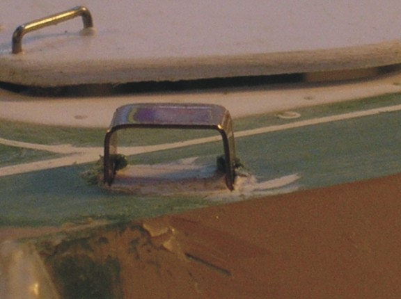

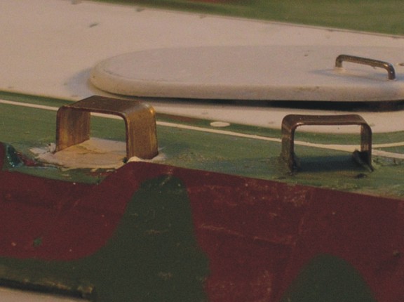

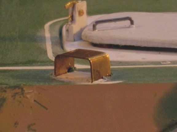

You thought those were tough! :O Now working on the travel lock. But first put on the periscope covers using the soldering iron method again. Make your little part and apply soldering gun to brass to make it sink into plastic until you get it to the right depth.

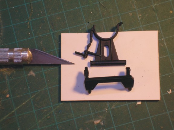

So, on to the travel lock. I want it to move up and down so first drill it through from both ends. Do it SLOWLY and watch all the time that you are going straight in. I do a little bit from each end at a time rather than one end then the other. Don't ask me why but it seems to work better...
Panther A 118.jpg (51.33 KiB) Viewed 4629 times
Then cut the lock from the frame
Panther A 117.jpg (48.39 KiB) Viewed 4629 times

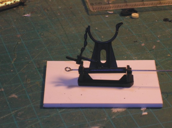

o- for the rod I use my old HL antennas they are a fairly strong steel and work quite well in any applications where you need a small rod.
Panther A 119.jpg (46.67 KiB) Viewed 4629 times

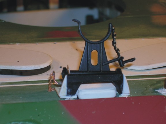

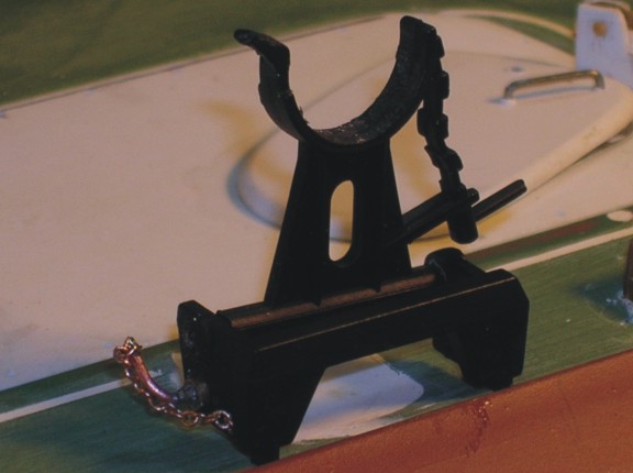

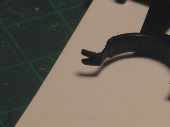

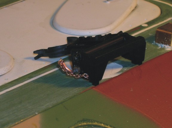

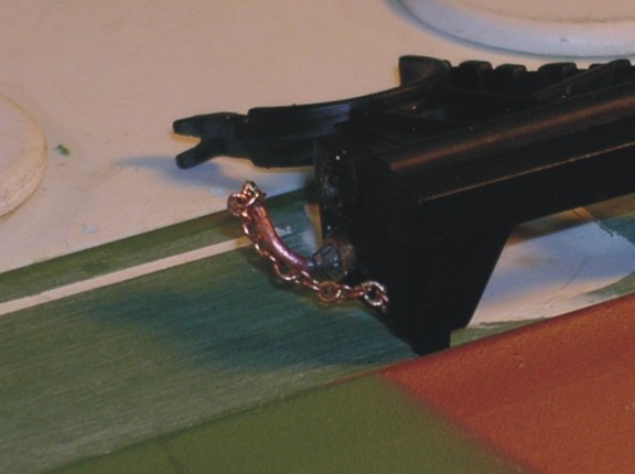

Then I added some detail with the frame pivot lock bar (hell if I know what the real name is!) On the real thing it looks like it releases the travel lock from the frame. It has a small chain so you don't loose the pintle when you open it. quick mount to test up down too. Also in this shot you can see where I cut the "V" notch into the guide arm.
Panther A 120.jpg (38.48 KiB) Viewed 4629 times
Panther A 121.jpg (39.58 KiB) Viewed 4629 times
Panther A 122.jpg (38.38 KiB) Viewed 4629 times

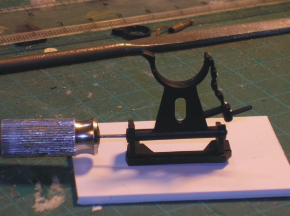

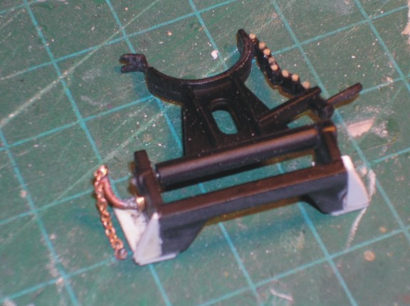

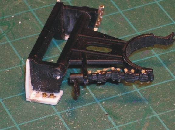

Having said that I decided to do a little more on the travel lock. I want to simulate the chain more so I added some little round pieces of styrene to simulate the pins between the links and using a really sharp xacto I cut some groves in the links and opened the V notches where the the lock handles connect.
Panther A 127.jpg (40.96 KiB) Viewed 4559 times
Panther A 128.jpg (29.86 KiB) Viewed 4559 times

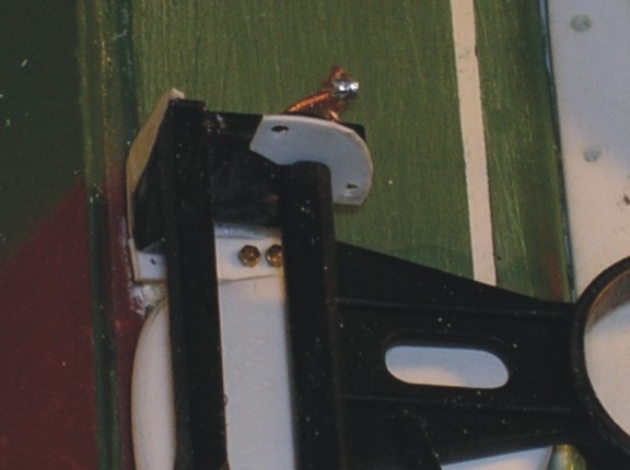

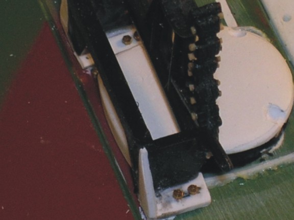

Then I decided to make the frame look proper and used some brass .8mm bolts I have for the plates that screwed into the hull
Panther A 129.jpg (61.82 KiB) Viewed 4559 times
Panther A 130.jpg (56.99 KiB) Viewed 4559 times

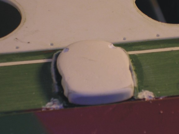

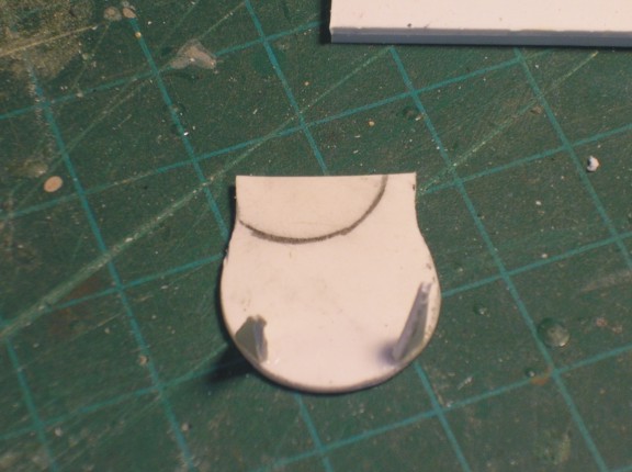

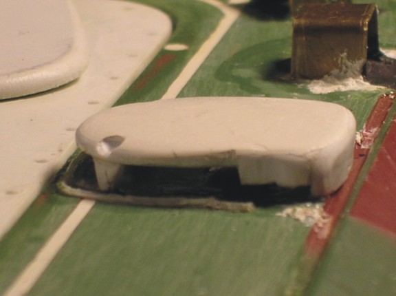

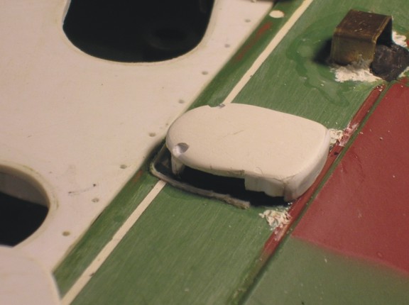

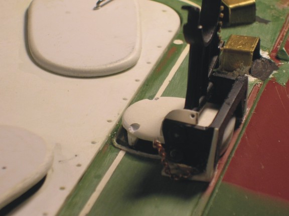

Next it was time to tackle the ventilator cover. I had been humming and hawing how to do this but decided to make it out of styrene. It took 2 tries to get a shape I was happy with and the right size by eye balling pictures, the travel lock and the tank hull.
Panther A 131.jpg (50.02 KiB) Viewed 4559 times

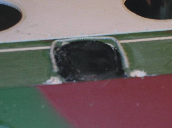

Also in looking at the pics there was a small rain guard around the ventilator so I soaked some thin styrene in glue and shapped it till I was happy. You will notice I painted where the ventilator was going to go black ahead of time as I figured it might be tough to do it later.
Panther A 132.jpg (27.08 KiB) Viewed 4559 times
Now, I got so into making this ventilator cover that I forgot to take pics as I went along! But basically I got the shape to where I was happy. I added the front rounded piece and some small side pieces as on the real one and sanded and rounded them off to the main part. Since the real thing is cast I started adding Tamiya putty to the top to get the slight curve and thickness right. The nice part about that putty is if you spread it around as soon as you put it on it will somewhat smooth and self level. so I put on 2 layers to get the center built up. I then ever so gently drilled the 2 depressions that are above the rear legs.
Panther A 133.jpg (27.13 KiB) Viewed 4559 times
Panther A 134.jpg (39.51 KiB) Viewed 4559 times
Panther A 135.jpg (28.92 KiB) Viewed 4559 times
Panther A 136.jpg (38.58 KiB) Viewed 4559 times

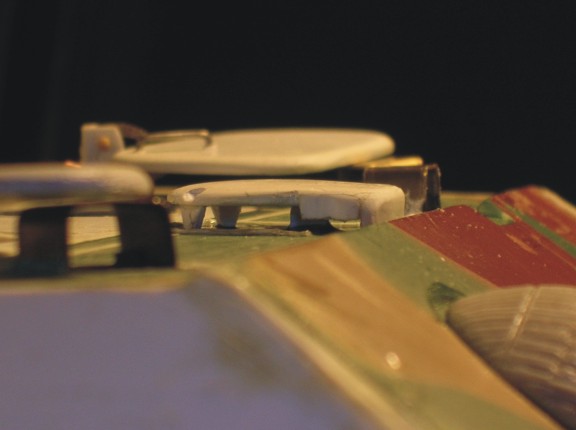

O.K. one more of the ventilator cover from the other side. This pic is kinda neat as the brass periscope cover is reflecting in under the ventilator cover!
Panther A 137.jpg (40.67 KiB) Viewed 4559 times

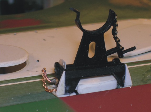

And here is the whole assembly test fitted... AND THAT'S IT FOR THE TRAVEL LOCK AND VENTILATOR COVER!!! :crazy: :crazy: :crazy: ....maybe....
Panther A 138.jpg (36.64 KiB) Viewed 4559 times
Panther A 139.jpg (38.34 KiB) Viewed 4559 times
Panther A 140.jpg (38.77 KiB) Viewed 4559 times
Panther A 141.jpg (38.88 KiB) Viewed 4559 times
Panther A 142.jpg (37.91 KiB) Viewed 4559 times
