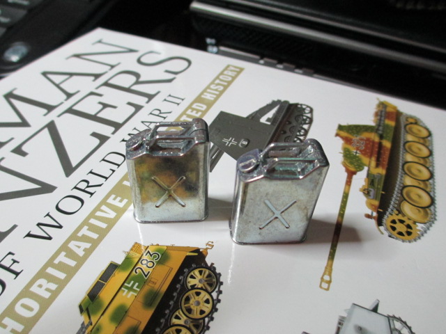

11th Day: (and also my Birthday so not a lot going on modeling wise tonight) One shipment came in, my Black Friday Jerry Cans. *chuckles* Pale, yes!, that is Hobby Town on Main Street in Longmont ;o) You probably know the place well. ;o) I picked up some plastistrut and a new paintbrush and a couple of jars of paint (steel and gunmetal) and last but not least, a new #75 drill bit to replace the one that snapped and buried itself in my finger the other night. ;o) I'll get round to fixing the rear deck engine bay grills tomorrow night. I dreamed up a better way to fix the center gap that was left after mounting. Jeff, it is an honor, Sir. I am slow to get going, still working with some parts enroute and working around the Holidays but fun is definitely being had. I hope I do or come up with something useful for someone else doing a Sherman build.
Picture:
Black Friday Jerry Cans (for water I think)

PainlessWolf wrote:11th Day: (and also my Birthday so not a lot going on modeling wise tonight) One shipment came in, my Black Friday Jerry Cans. *chuckles* Pale, yes!, that is Hobby Town on Main Street in Longmont ;o) You probably know the place well. ;o) I picked up some plastistrut and a new paintbrush and a couple of jars of paint (steel and gunmetal) and last but not least, a new #75 drill bit to replace the one that snapped and buried itself in my finger the other night. ;o) I'll get round to fixing the rear deck engine bay grills tomorrow night. I dreamed up a better way to fix the center gap that was left after mounting. Jeff, it is an honor, Sir. I am slow to get going, still working with some parts enroute and working around the Holidays but fun is definitely being had. I hope I do or come up with something useful for someone else doing a Sherman build.
Picture:
Hi Painless,
I assume these Jerry cans were captured and requistioned by your Sherman crew? :thumbup: Jerrycans were a German invention hence the term "Jerry" - a deregatory term for German used by the allies in WWII. (Similar to the use of "Fritz" as a term for Germans used by the allies in the first world war) The allies discovered the jerry cans were more useful (and durable) than their own equipment for storing fuel rations that they would capture these and use it for their own.

Hi jeff the jerry cans painless has are the us version the german blitz cans as the jerries knew them weremade from two peices of pressed steel and had a rim around the whole can whereas the us version had a flat bottom and a different filler cap 8|
