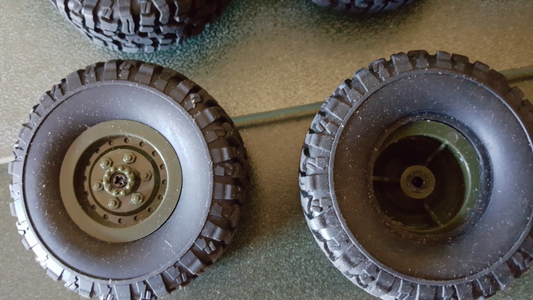

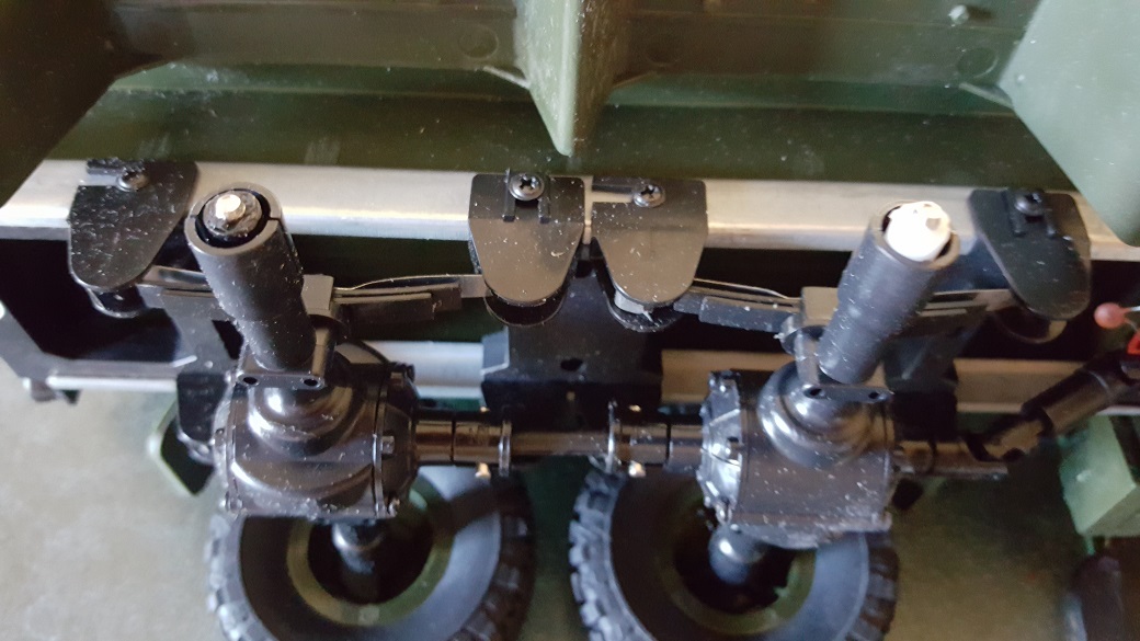

My JJ RC 'Vintage' Truck came in this morning. The seller had just thrown the truck box into a large plastic envelope and consequently, the truck was badly broken when it arrived here. :problem: Both rear wheels on one side snapped off\broken screws and the tailgate mounts snapped. I checked the rest of it over and everything is here. I sent a message to the seller but don't expect a lot back from them ( different culture and language ) Having said that, are there better axle upgrades available for this truck? If I have to keep it, may as well make it useful! :o)
P.S. How about those rims and tires, Gary?
Half screws and half axles still in the rims

Axles and screws snapped in half

As to your request for upgraded rear axles my understanding is that unlike the WPL/Heng Long trucks the JJRC Trucks have properly engineered metal Differentials that are far more effective than the Crude "Spin up and Slide" alternatives.

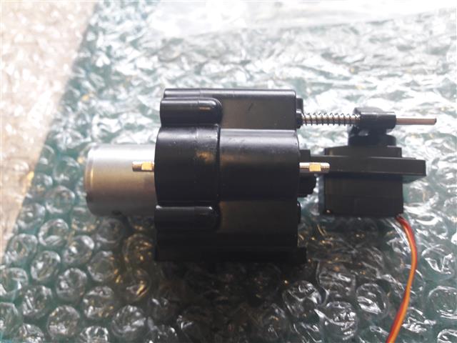

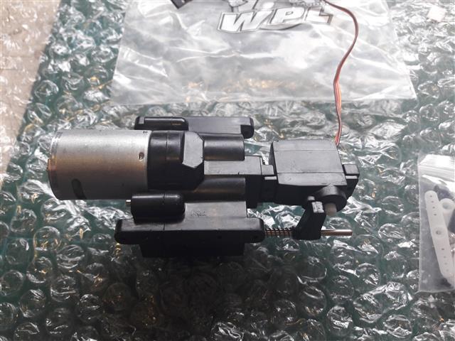

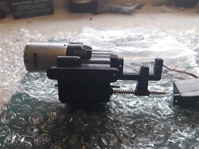

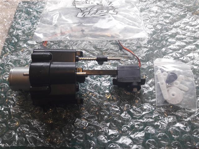

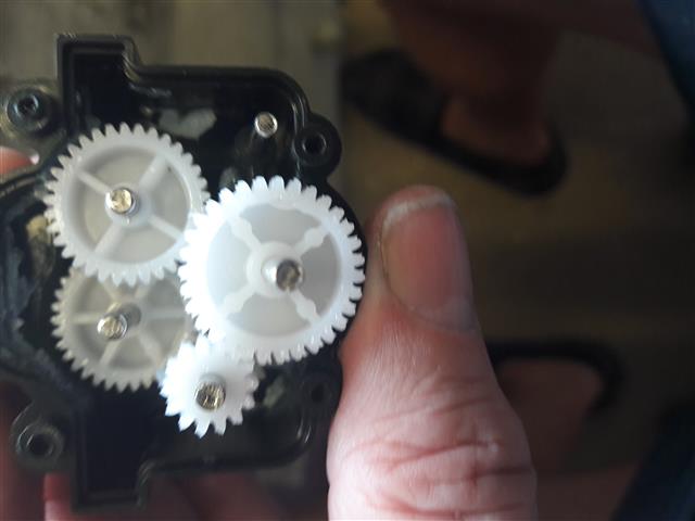

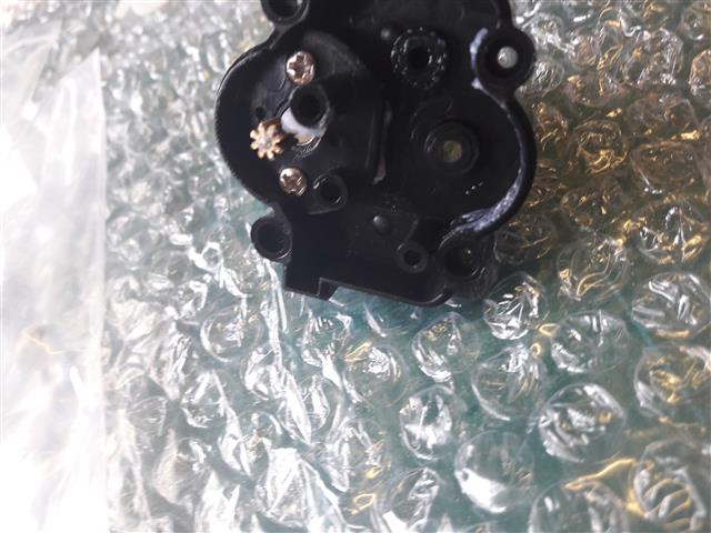

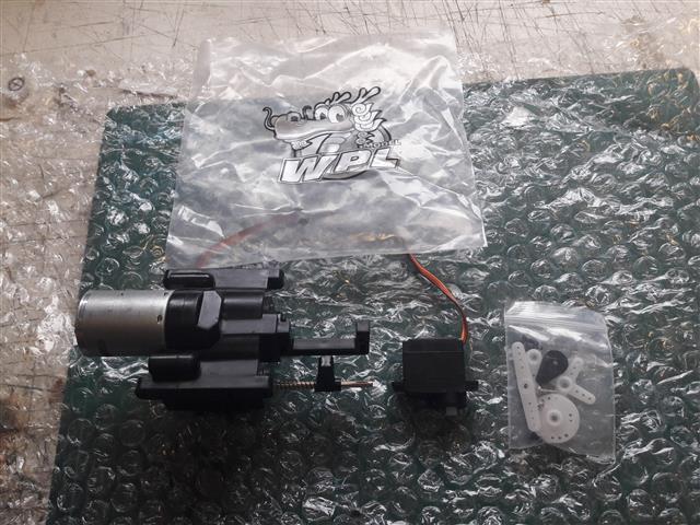

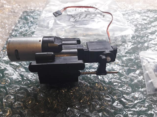

Finally received my 380 motor and 2 speed gearbox and servo set up to mod my WPL 6x6 from the standard kit 180 motor.
All in all a very nice piece of kit , appears well made and all fits perfectly
One thing to note is that the standard splined plastic shafts will not fit as the output shaft has no splines only flats for grub screws ...so unless you mod the plastic shafts as I have done or fit the upgraded metal drive shafts the standard plastic ones won't fit.
some pics for you to peruse.
Regards Sub.
