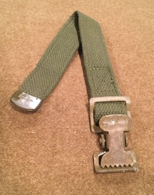

Personally if they are both wrong I would go with the easier one. I think the real straps are this version...you press on the back of the buckle and it releases the strap. I think the real strap is much simpler than the ones you are making. From what I can find it's called a "pioneer strap".

tankme wrote:Personally if they are both wrong I would go with the easier one. I think the real straps are this version...you press on the back of the buckle and it releases the strap. I think the real strap is much simpler than the ones you are making. From what I can find it's called a "pioneer strap".
Thank you sir!!
That is exactly what I was looking for. I had no idea what they were called and the couple of pics I have did not reveal the true shape of the buckle. With the proper name I have found a number of excellent picks of the buckle. :thumbup: Now I will see what I can come up with that will look more accurate.
Now for some serious scheming. :think:
Thanks again Tankme!
Barry

With the lead from Tankme and armed with some good pics of the buckle I had a go at the V3.0 version.
It is a little time consuming but not to bad in the grand scheme of things. I think the end results are well worth the effort......I'll see if I still feel the same after I get 32 of them made! :crazy: I have desided to use a smaller diameter tube or piece of brass wire of the non functional center pivot.

No problem. Been looking at those straps for my Abrams build. Not as detailed as yours, but hey... :) Theoretically the buckle is just two pieces of stamped metal with tabs pushed up and a pivot pin. It's actually a very simple design and I'm sure it's pretty easy to manufacture. Since the pieces start out flat, I'm sure these could be photo-etched pretty easily. There are some vids out there on DIY photo-etching. Micro-Mark even sells a photo-etch kit...kinda pricey, but may be worth your sanity.
