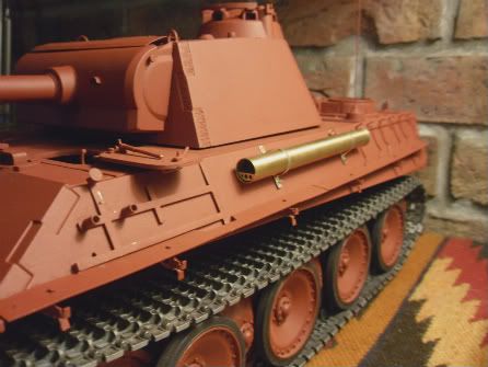

Here I put the spare aerial tube on....it is again a temp fit, but its the first time it has seen the tank, the soldering on this has been a pain...bought a small heat sink today, which should help greatly...
Von kraftwerk
Posts: 217
Joined: Thu Mar 24, 2011 11:54 am
Location: London England
Re: My Panther
Post by Von kraftwerk »
love the tube,just noticed something though,the skirt hooks.the bottom one bends down correct,the one thats hooking upwards is supposed to point to the rear,it may not matter to you,but with all the great stuff going into this one,maybe it does,I hope I'm wrong it may be optical illusion,all that primer,lol
Nic.H
Posts: 270
Joined: Sun May 17, 2009 7:30 am
Location: South Wales
Re: My Panther
Post by Nic.H »
To be honest, I never checked!...I just followed the profiline details..hang on(no pun intended!), just look at the close up picture in Panzer Tracts No5-3...they point backwards!...phew, hope its the same for the other side. I have not made them yet, but the pictures for right hand side are like hens teeth
Nic
(Ps...I think its just the angle....the profiline hangers the same as the originals)
