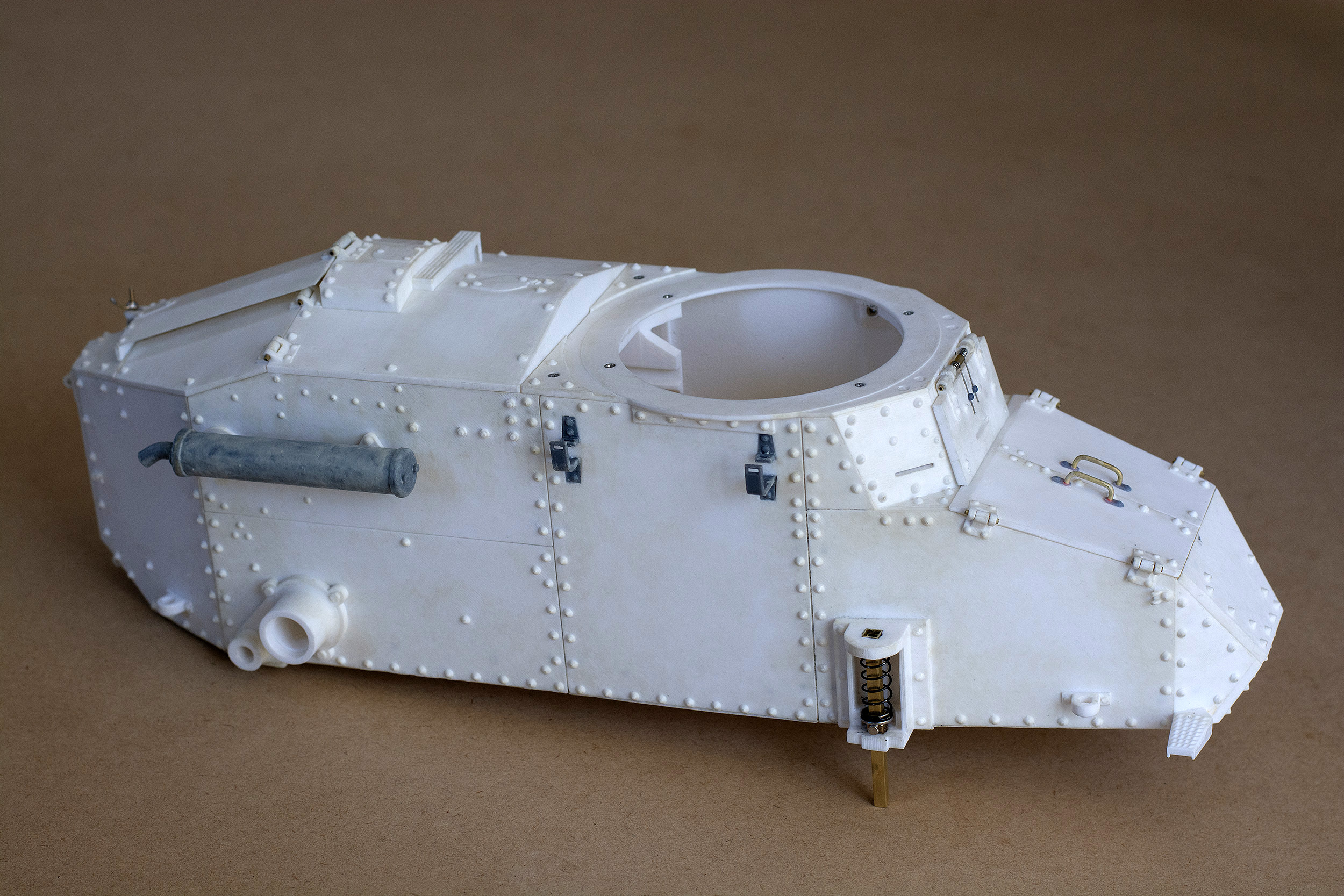

Some work has been done on the hull; it was sanded and primed by brush in the tricky parts with Mr. Hobby dissolved putty. I love Mr. Hobby dissolved putty, it is the best thing to hide layer lines. With a bit of ASB/PETG glue added, it is pretty good to create surface texture (with stabbing brush motion).
DSC_1701 copy 2.jpg (1.11 MiB) Viewed 556 times

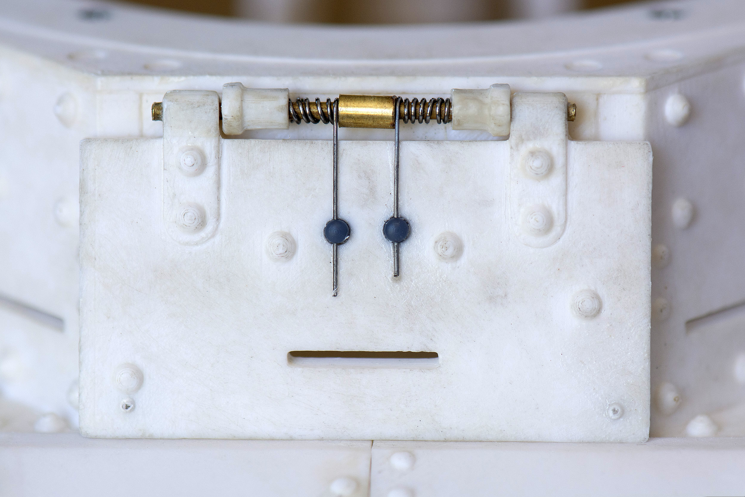

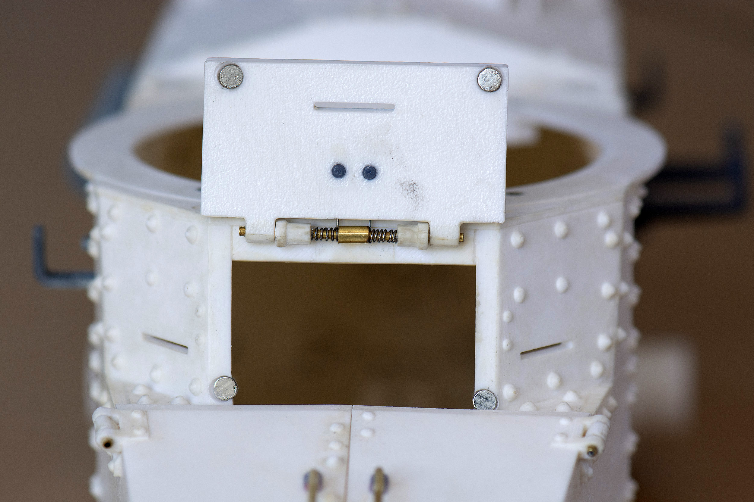

For the last couple of days I was focusing on small details. Torsion springs were added to the driver's hatch... and magnets to hold it locked :D .
DSC_1681 copy 2.jpg (973.26 KiB) Viewed 556 times
DSC_1682 copy 2.jpg (930.12 KiB) Viewed 556 times
