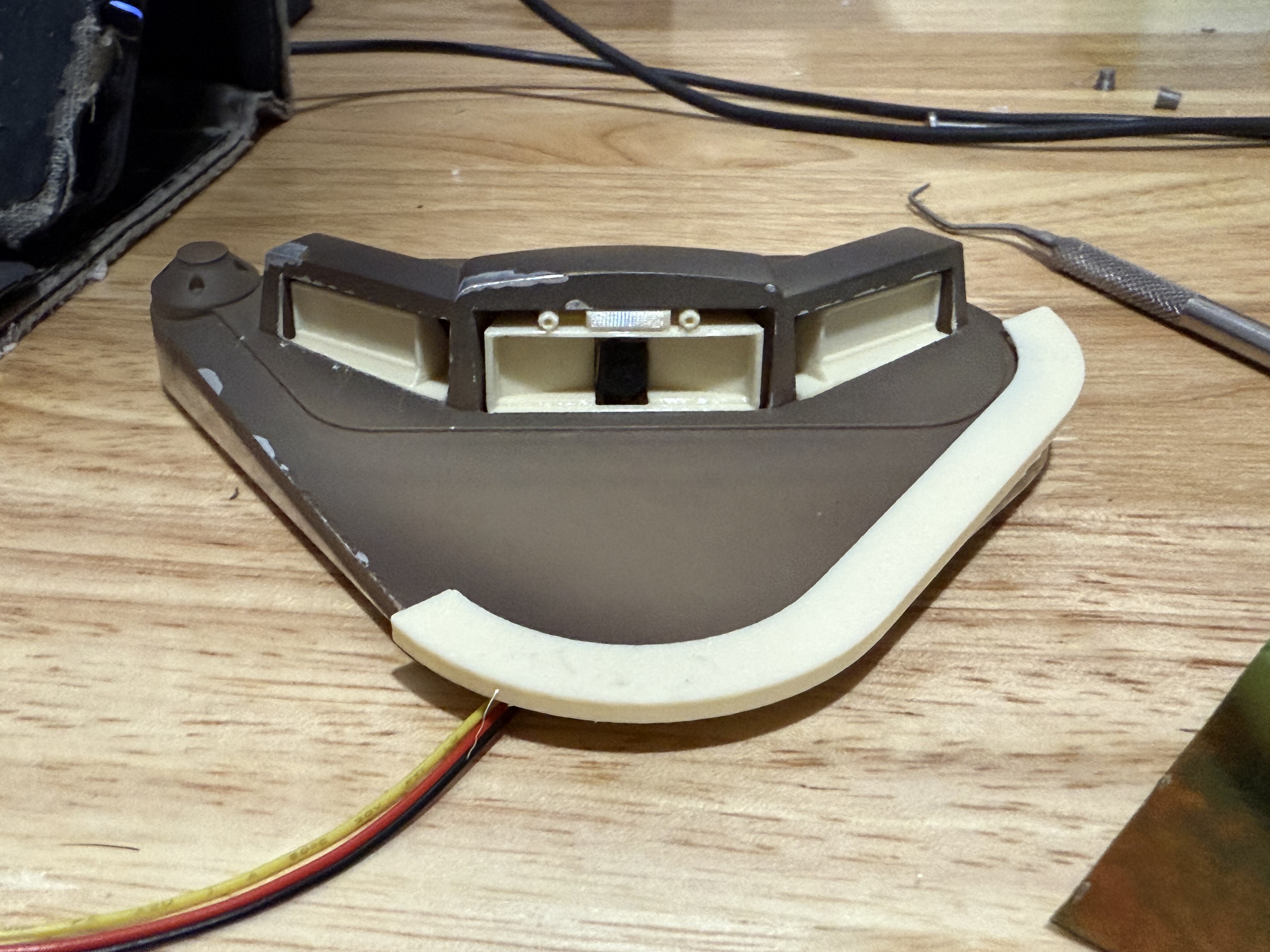

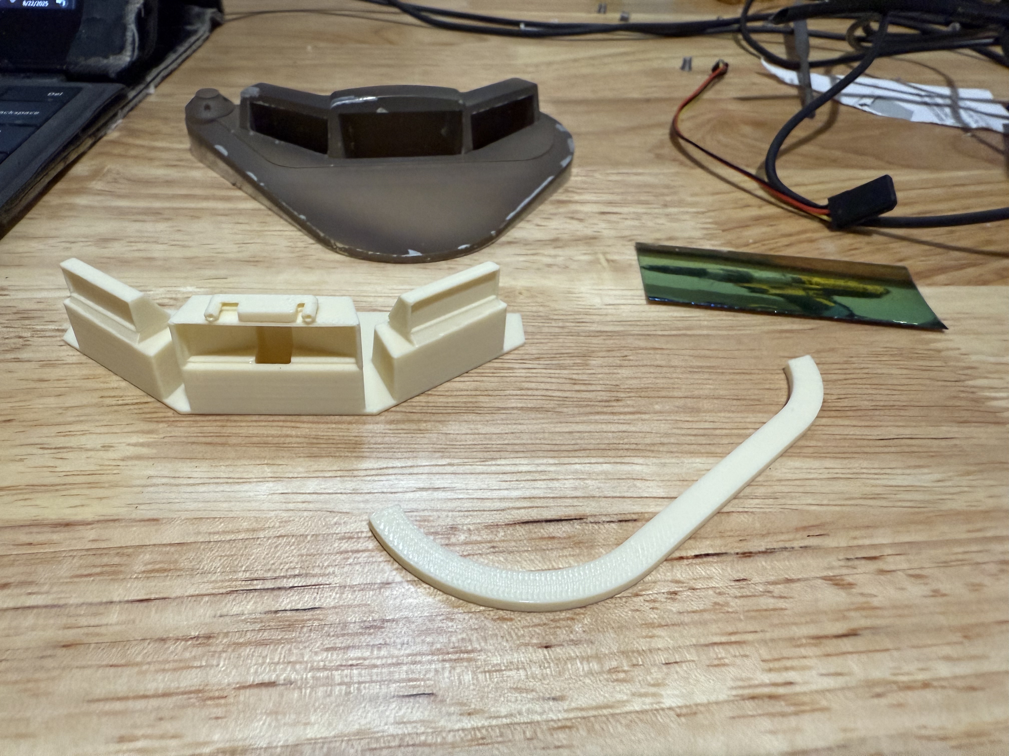

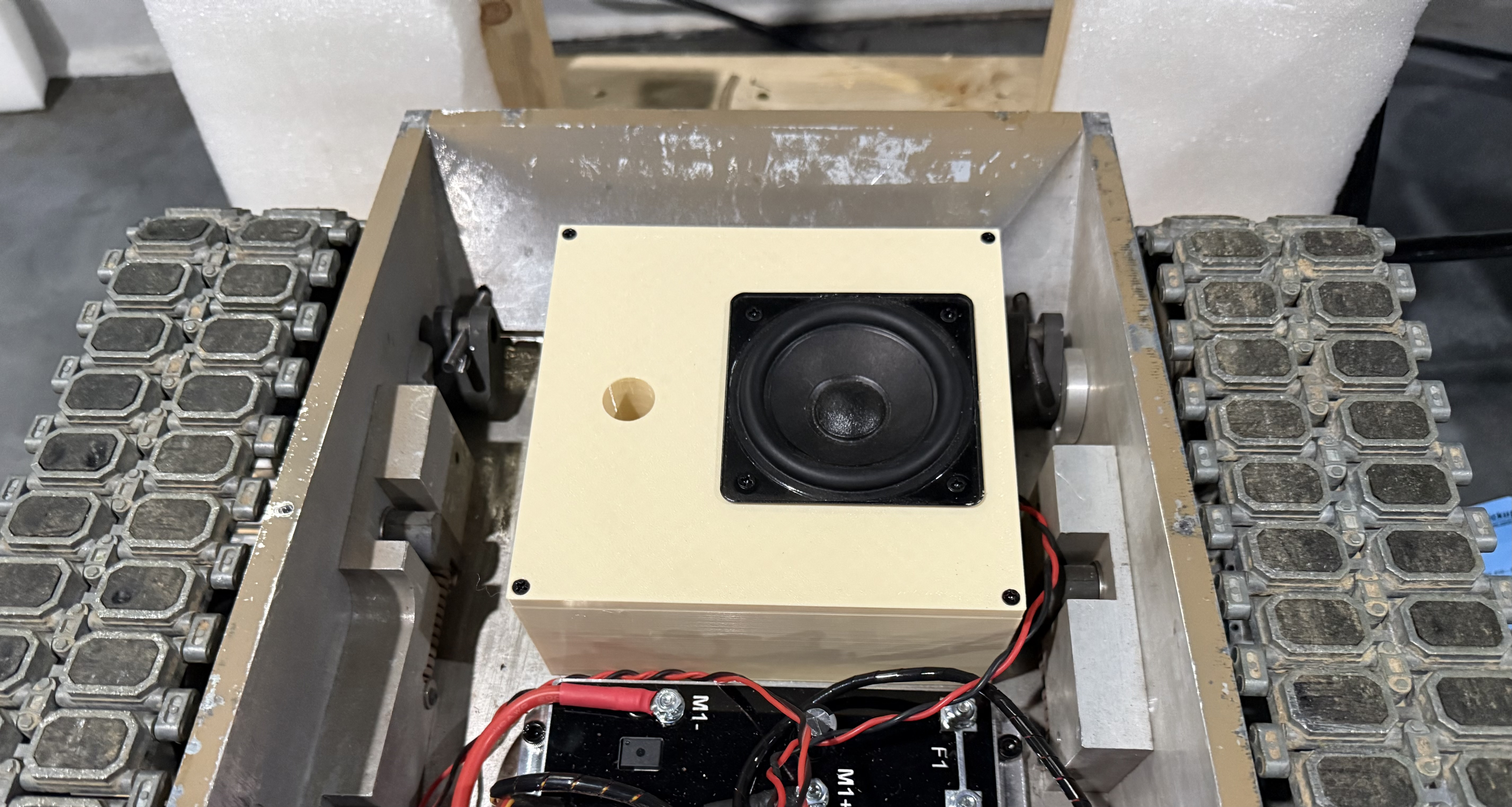

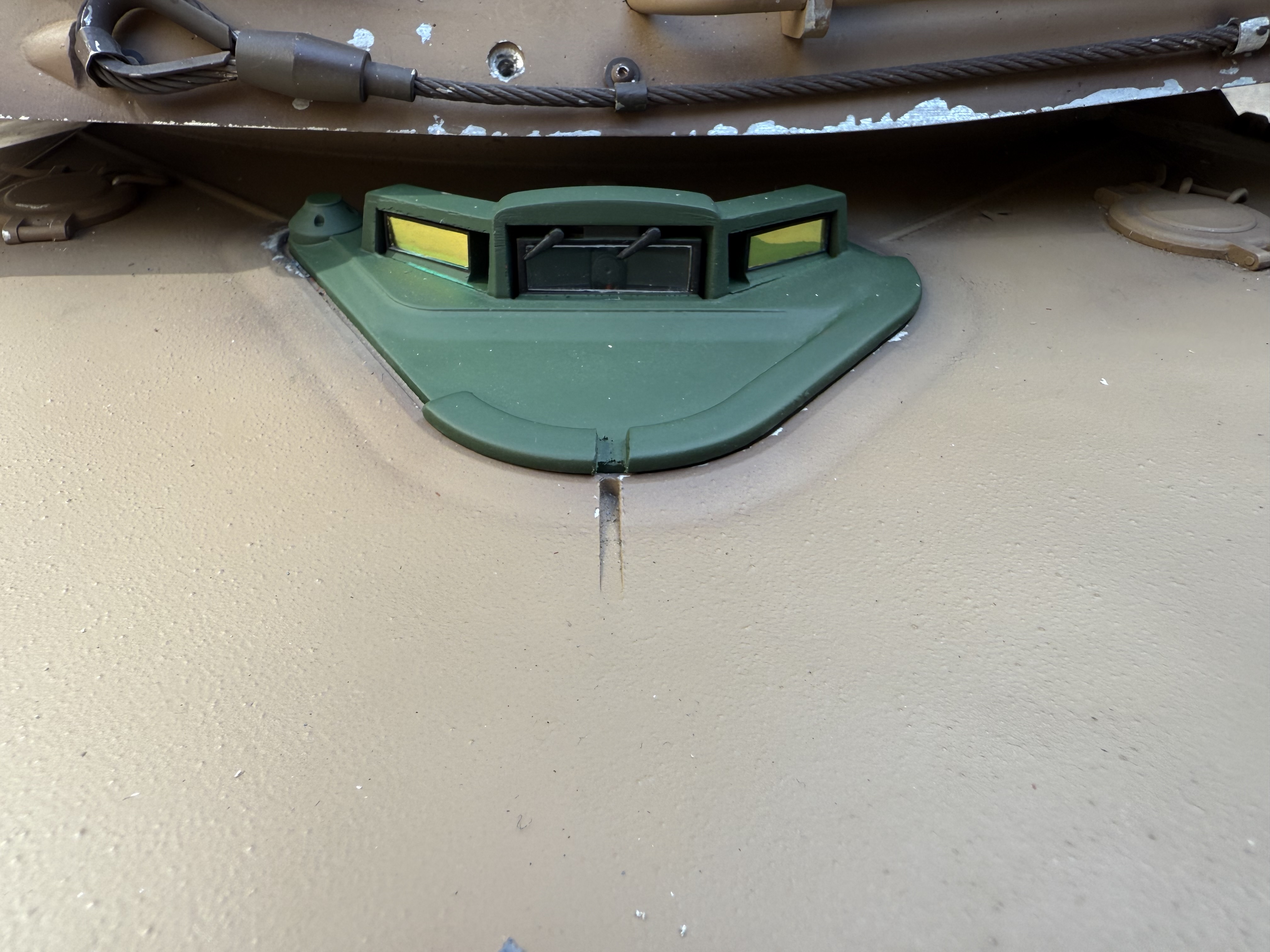

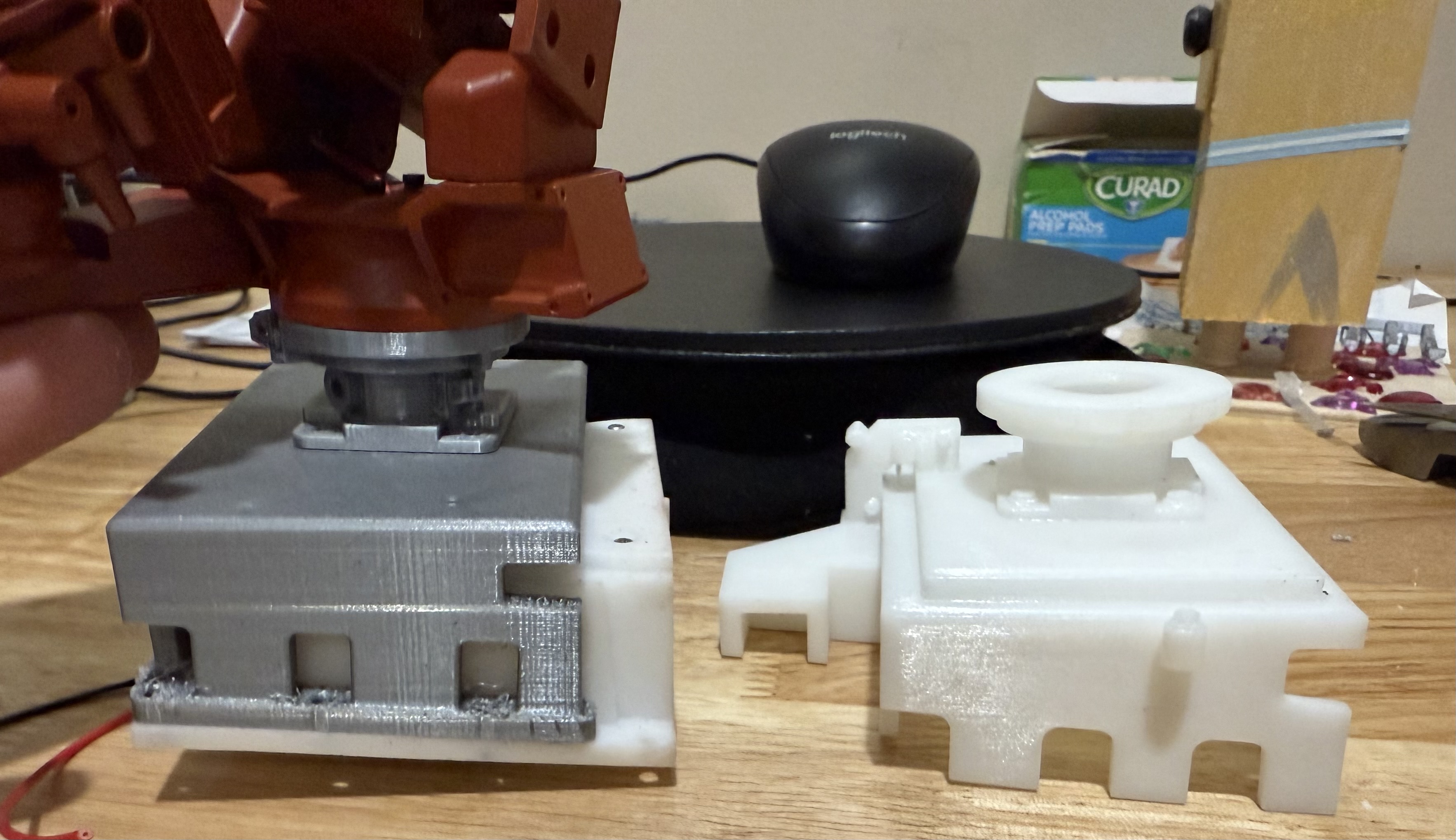

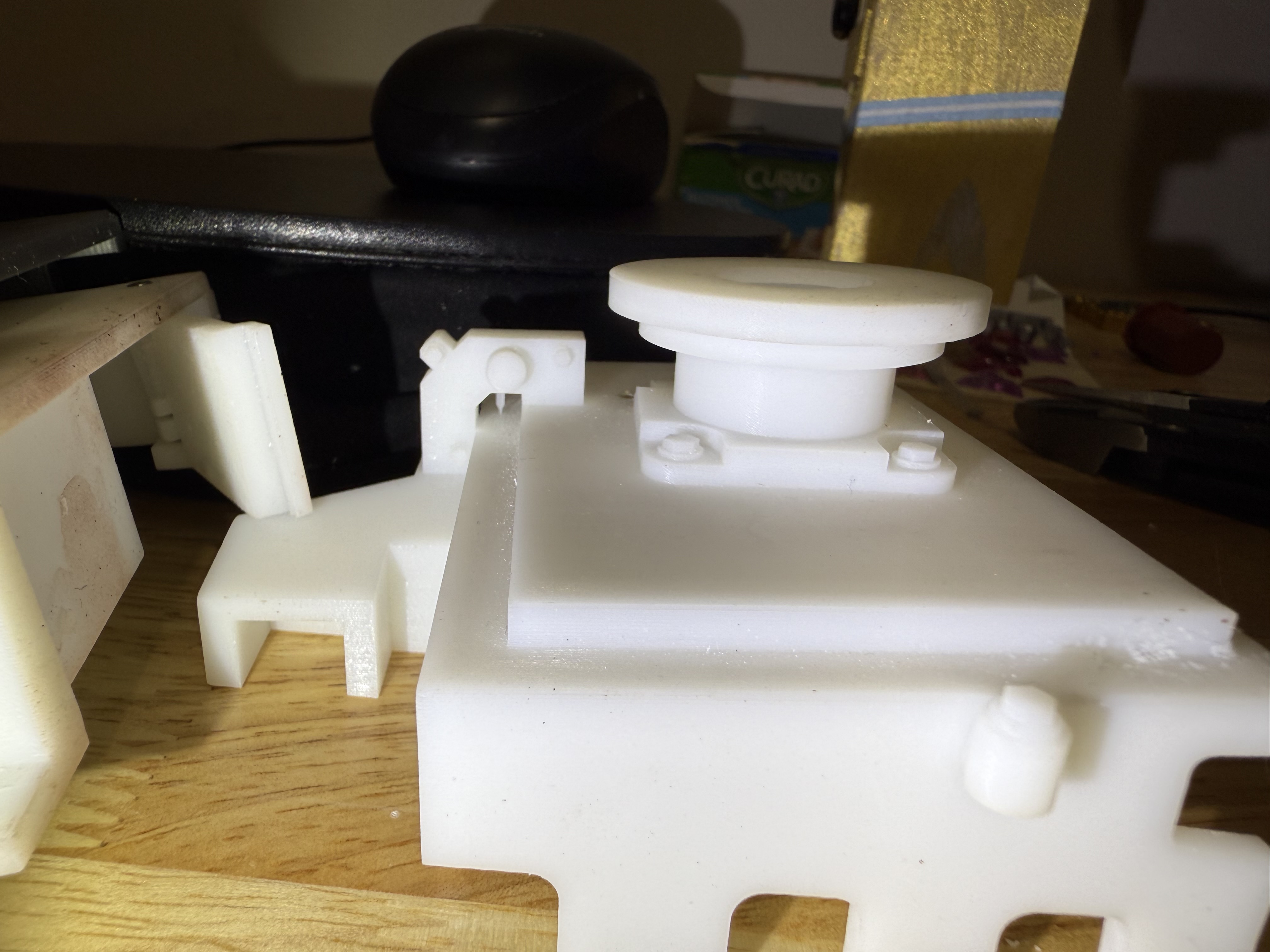

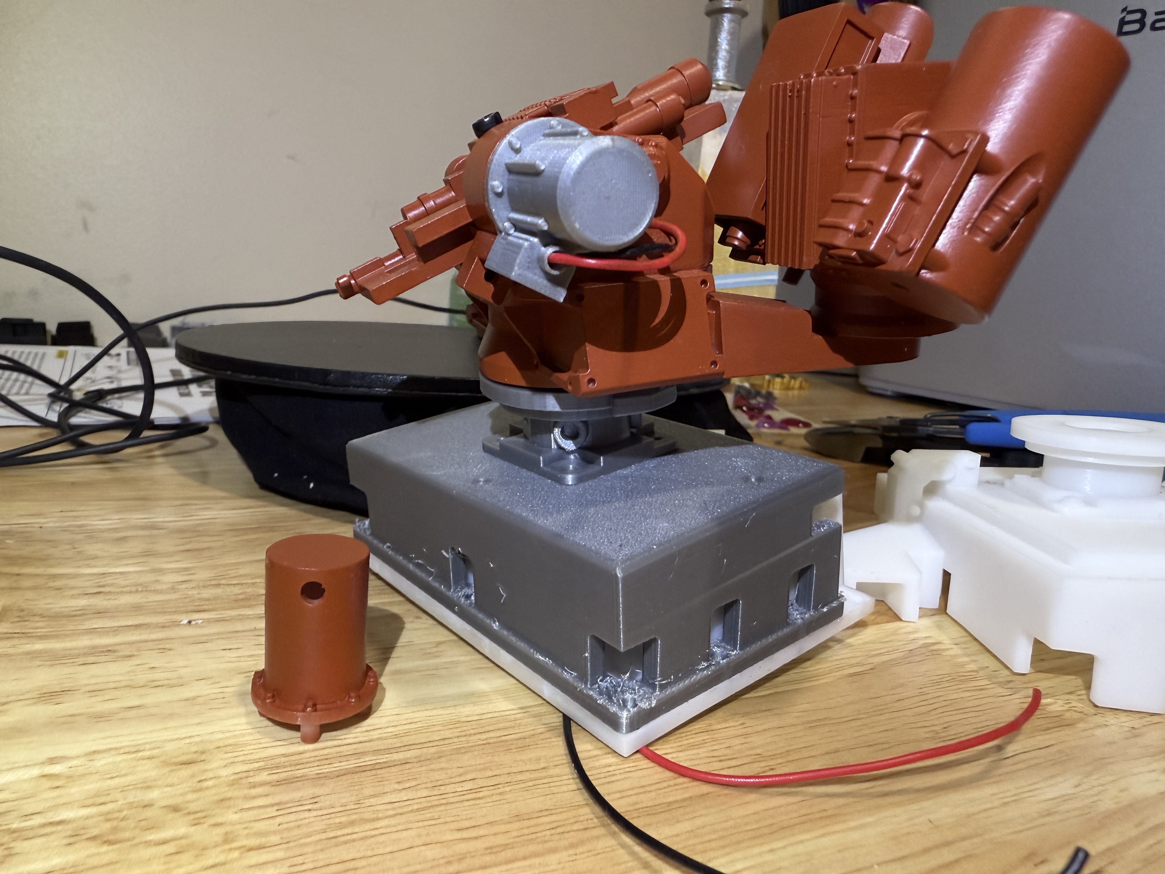

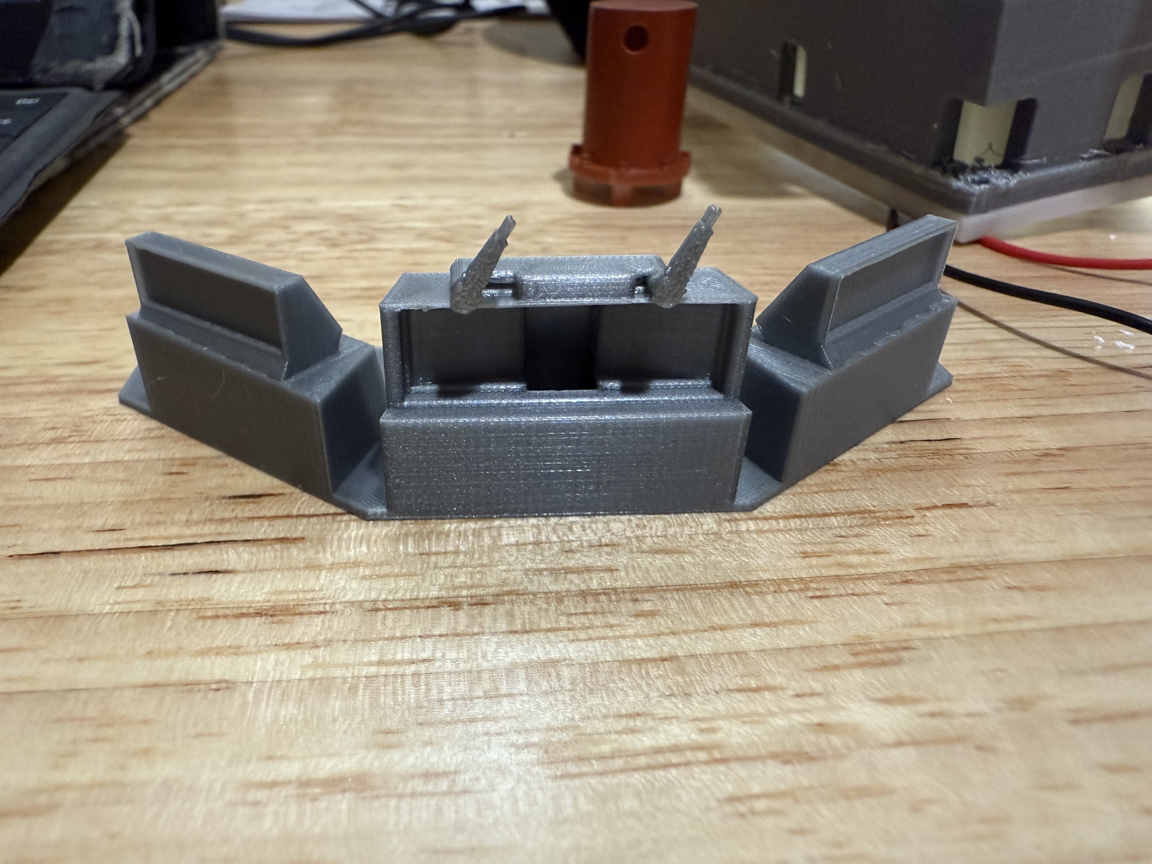

The CROWS still isn’t on yet, I got distracted 3D printing stuff for the drivers hatch and making a new speaker that fits inside the hull better.
Made my own periscope insert and rain guard lip. Going to reprint the insert in black tomorrow, put in a 1 mm piece of lexan for glass, some of that shiny film for the two other periscopes, slap some wipers on, stick the camera in. Sand and glue the rain guard and dremel a little notch in the middle.
The CROWS has some inaccuracies that are bugging me that I want to fix before assembling it, but that’ll be next. I’m really itching to get that on there.
- IMG_0260.jpeg (2.94 MiB) Viewed 1170 times
- IMG_0255.jpeg (2.95 MiB) Viewed 1170 times
- IMG_0258.jpeg (2.33 MiB) Viewed 1170 times

Re: 1/8 Scale HL Abrams
Jeez thats coming on strong mate!
Could be a case of "Stop looking and you wont find anything" going on !!
That speaker almost seems too small
Can’t stop! Won’t stop! I’m starting to wonder if I’ll ever be “done” with this model, or if it will become the tank of Theseus.HERMAN BIX wrote: ↑Sat Aug 23, 2025 7:53 am Jeez thats coming on strong mate!
That speaker almost seems too small![]()
The speaker box is about as big as I can get, it’s like roughly 6”x6”x3”. I am planning on getting a better full range speaker later, but I think it’s only about 0.5” wider in diameter than this one.
The speaker doesn’t sound louder, but it does sound a little clearer? But maybe I’m biased.

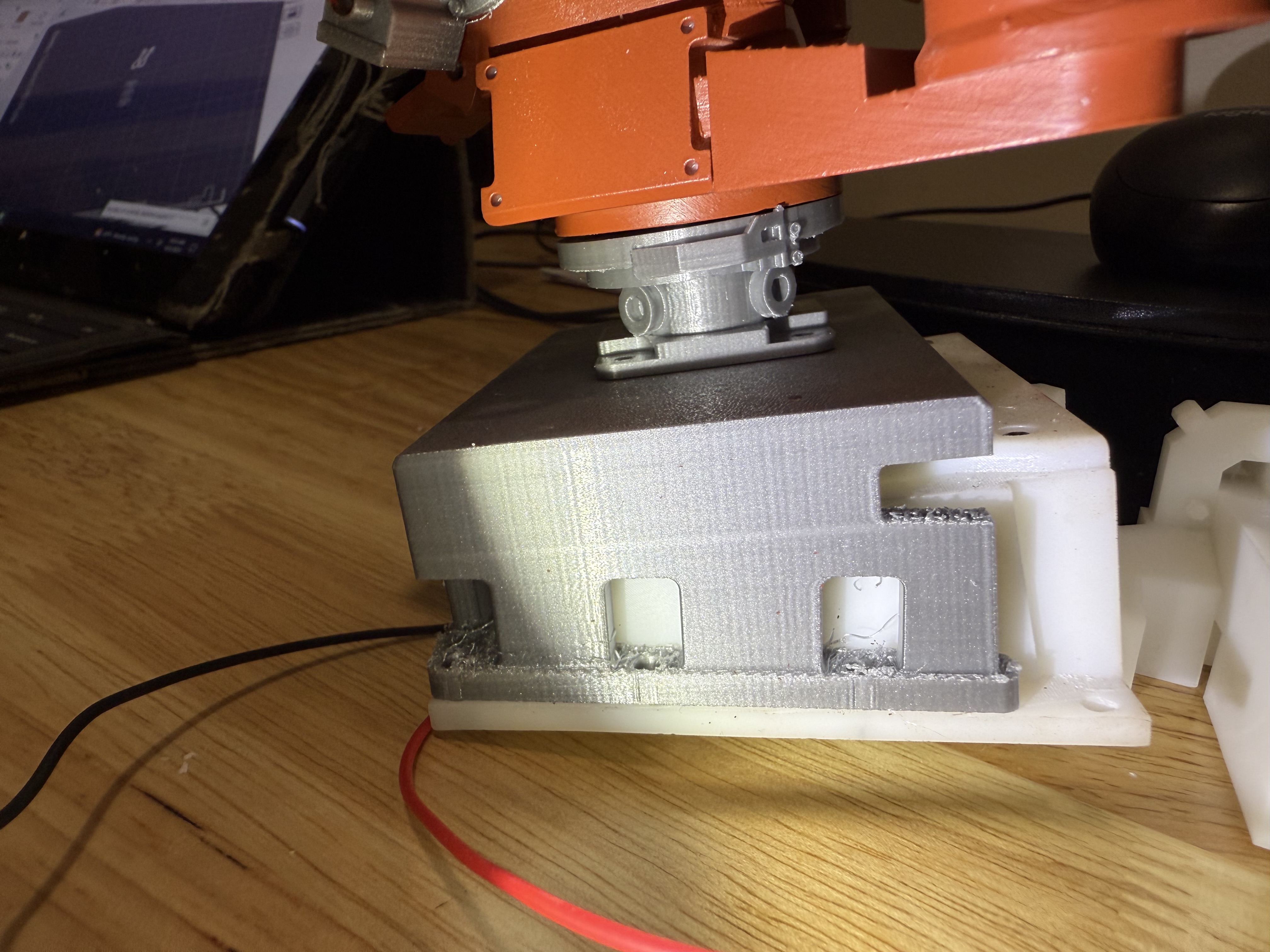

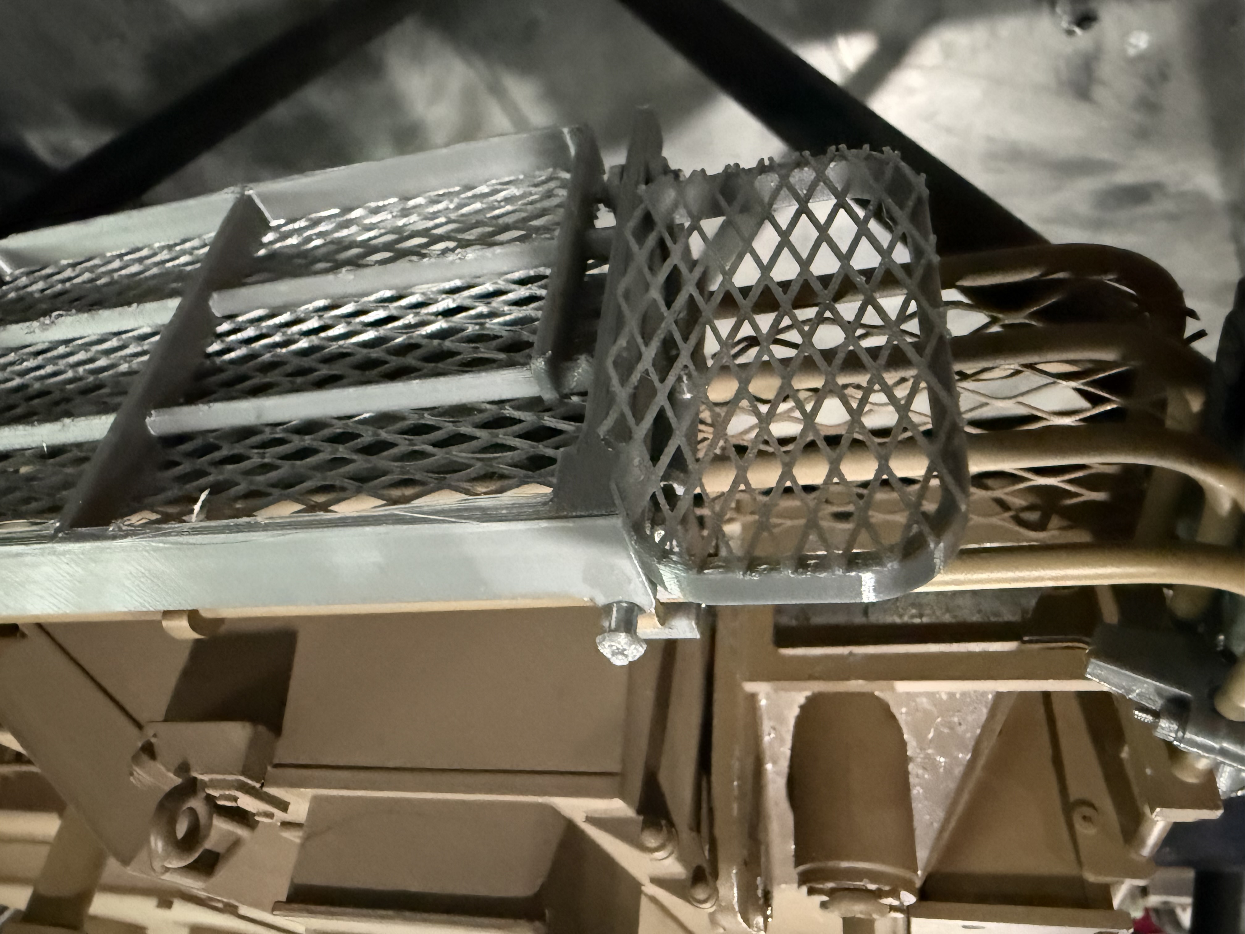

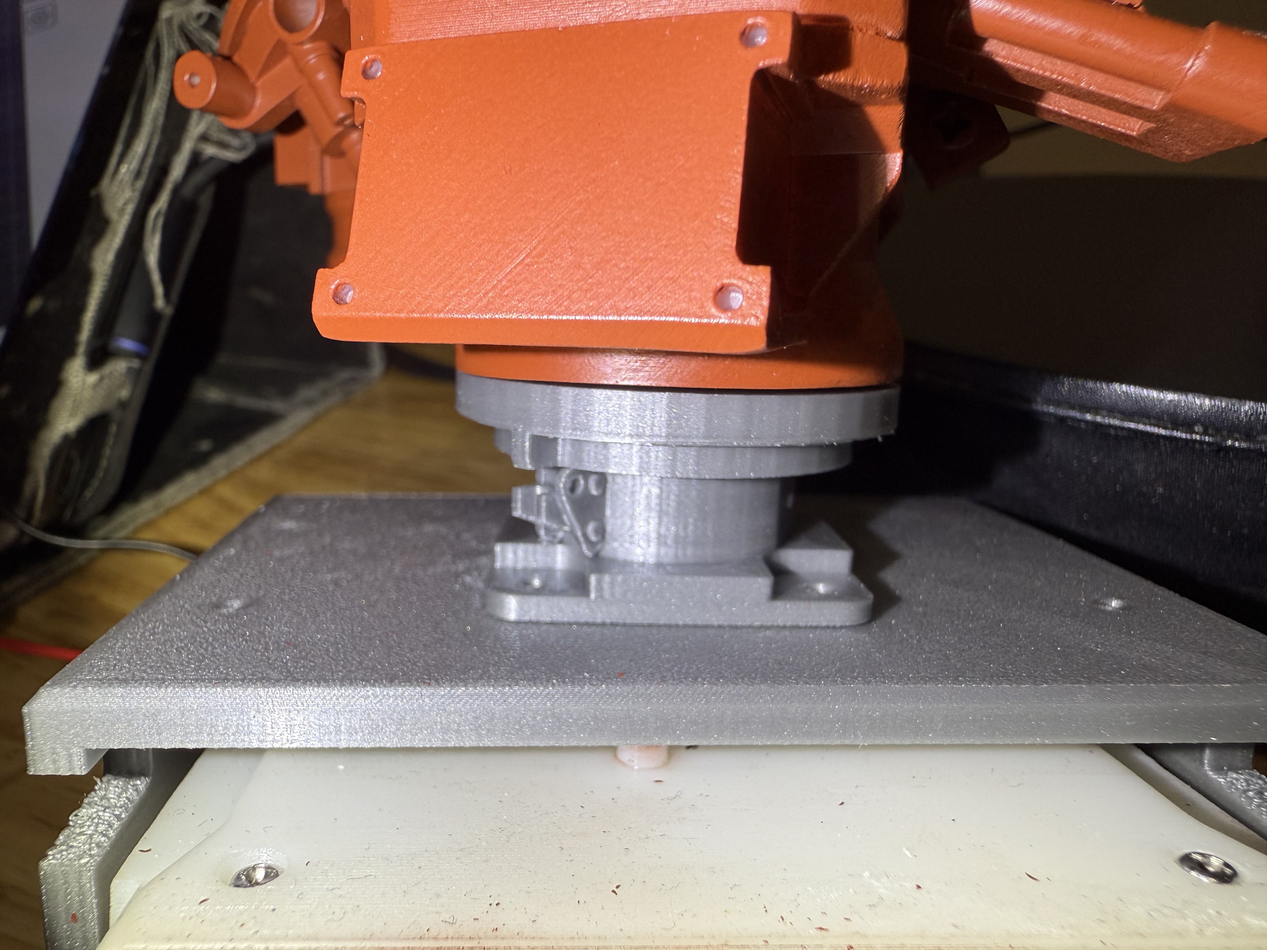

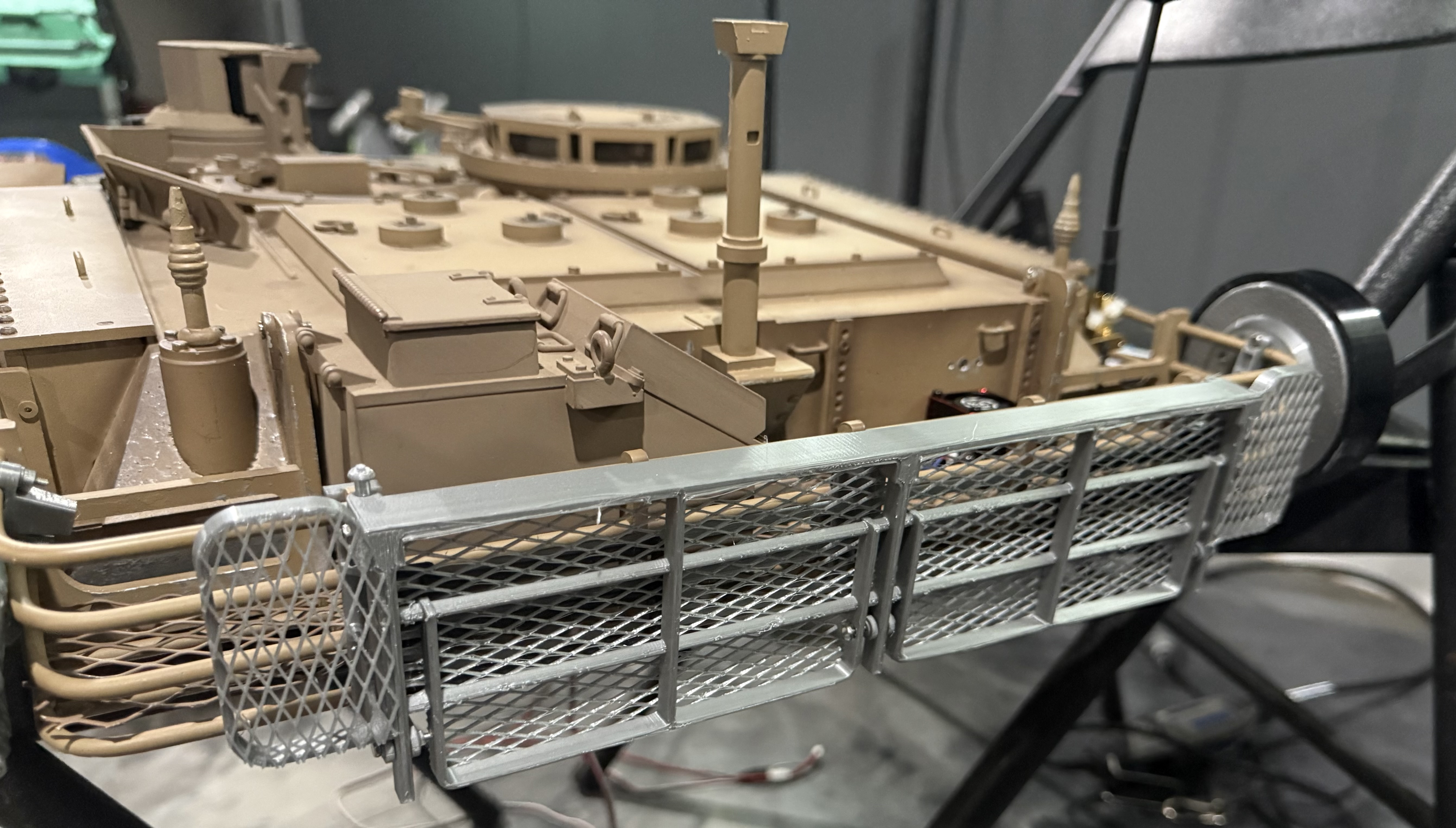

Another update here, all having to do with 3D printing. Still don’t have the CROWS LP on, but I’m getting closer. There were some parts on the original model from DKLMRC that bugged me, so I updated a few of them.
The star of the show here is the functional gypsy rack, you can fold it up and away, or fold it down for extra storage, just like the real thing. I was also able to create a pattern in Design Spark to create the mesh floor of it. I will
Probably use this same pattern to do the same thing with the floor of the main bustle rack, and get rid of my Home Depot mesh screen I have in there now.
It took me a little over a week to figure out how to be able to do the things I need to do to design the rack and get the measurements precise enough so everything folds up as it is supposed to. The mesh screen made my dinky Windows tablet have a stroke when I tried to modify it, so I had to move the project to my desktop computer to complete it.
I also had switched out the 3D printer hotend from a 0.4mm nozzle to a 0.2mm nozzle l, which made the print times jump exponentially, but I get greater resolutions. Everything in white is from DKLMRC, everything in silver and black is designed and printed my me, with the exception of the Jerry cans. Silver is PETG and black
Is TPU.

- IMG_0327.jpeg (2.88 MiB) Viewed 977 times
- IMG_0328.jpeg (2.25 MiB) Viewed 977 times
- IMG_0319.jpeg (1.65 MiB) Viewed 977 times
- I put the two hook ups ports on there, and the spent ammo case rack for the bag. Also on here is the static travel
lock in the other side - IMG_0322.jpeg (2.46 MiB) Viewed 977 times
- The old motor cover in red and the the one I designed in silver
- IMG_0325.jpeg (2.35 MiB) Viewed 977 times
- IMG_0323.jpeg (1.66 MiB) Viewed 977 times
- IMG_0320.jpeg (2.28 MiB) Viewed 977 times
- IMG_0326.jpeg (2.78 MiB) Viewed 977 times
The mesh really has turned out well

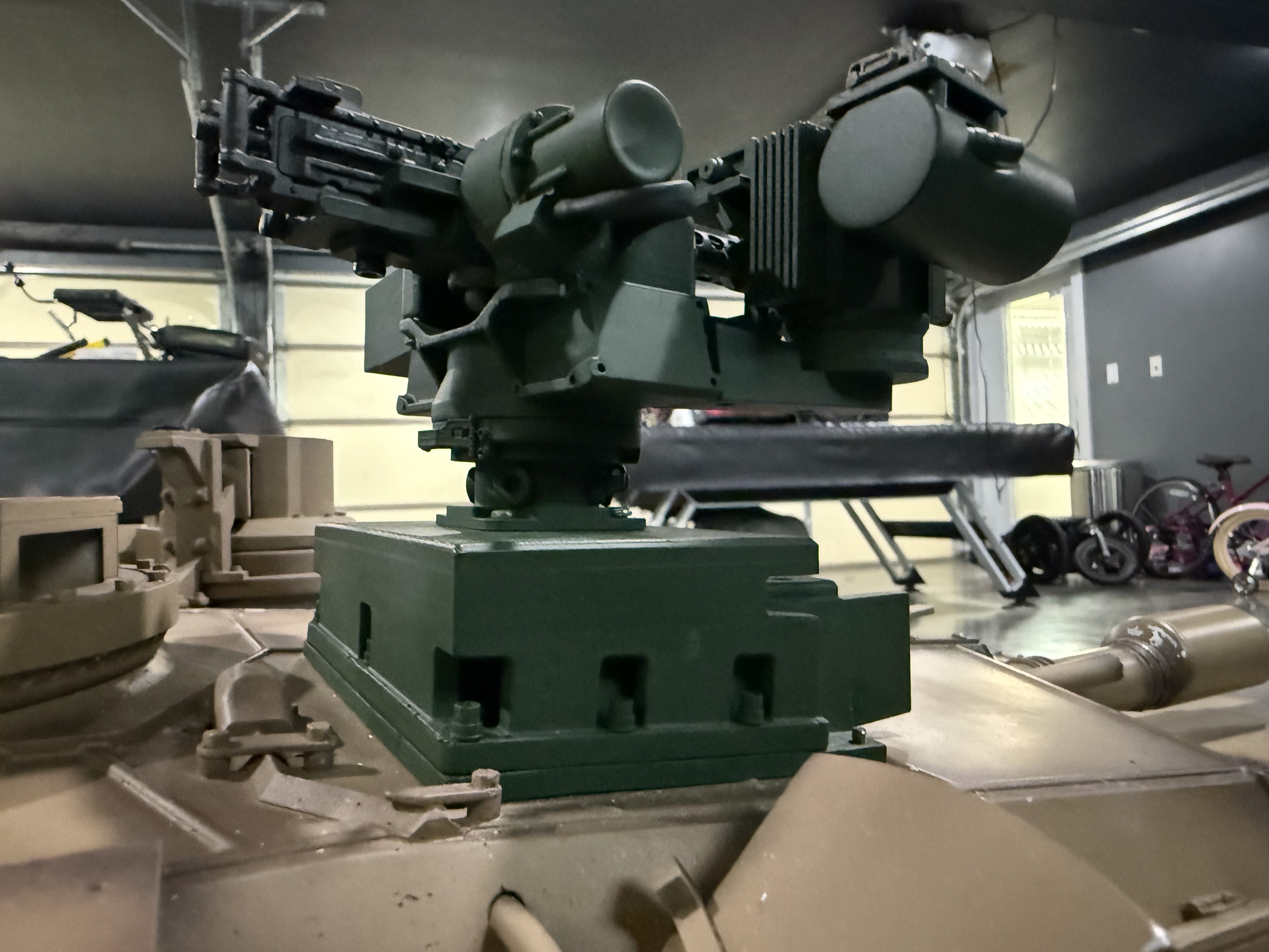

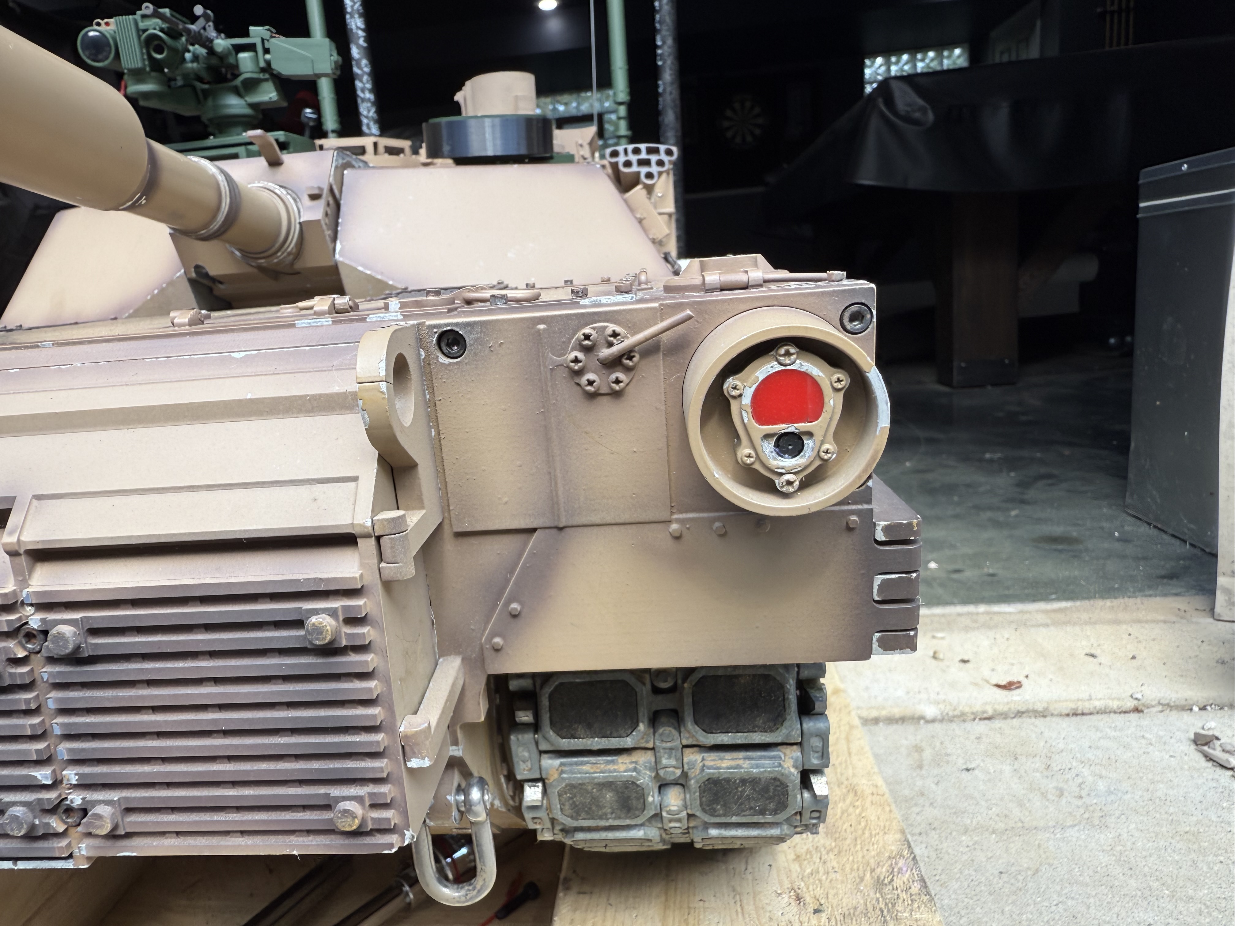

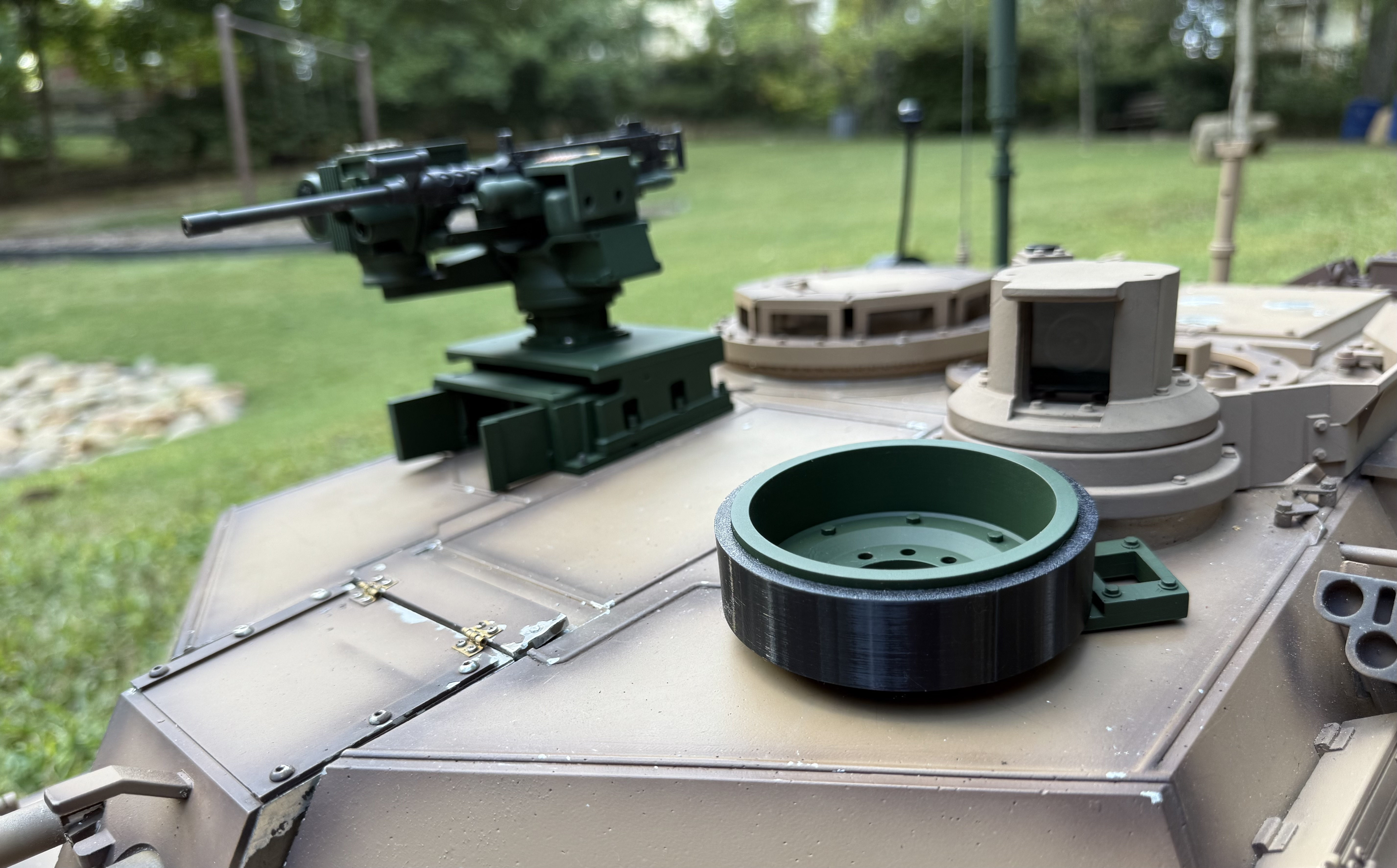

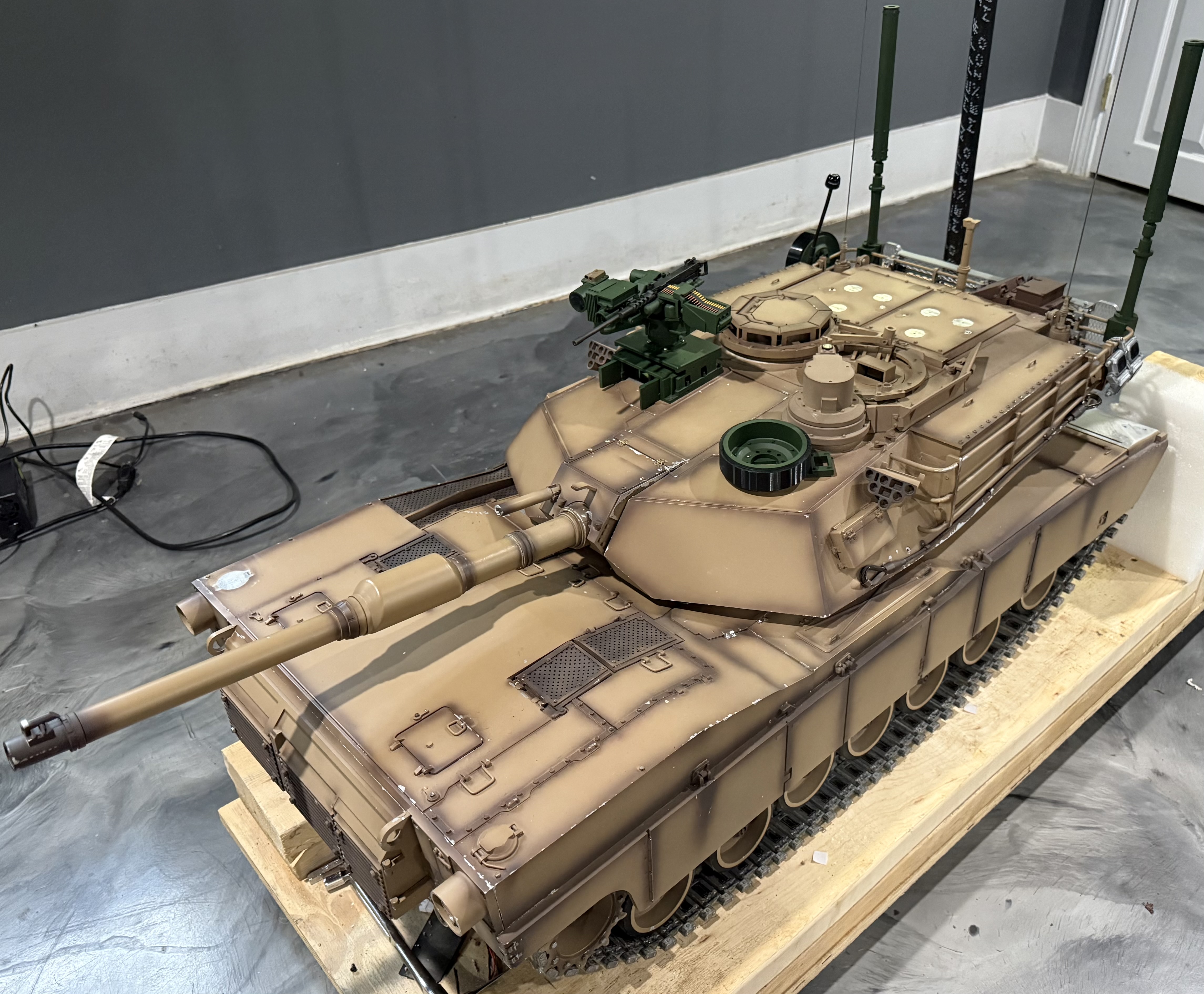

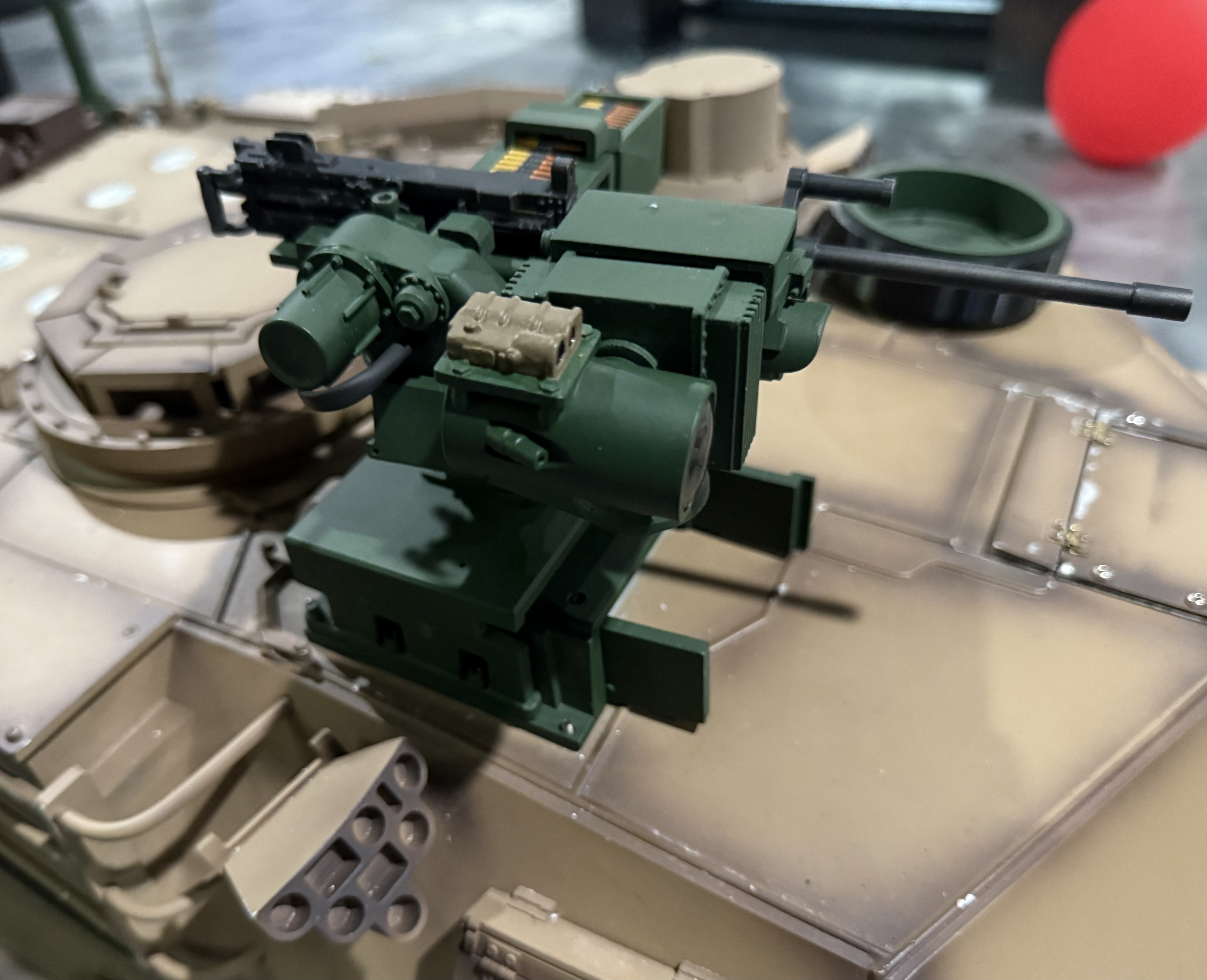

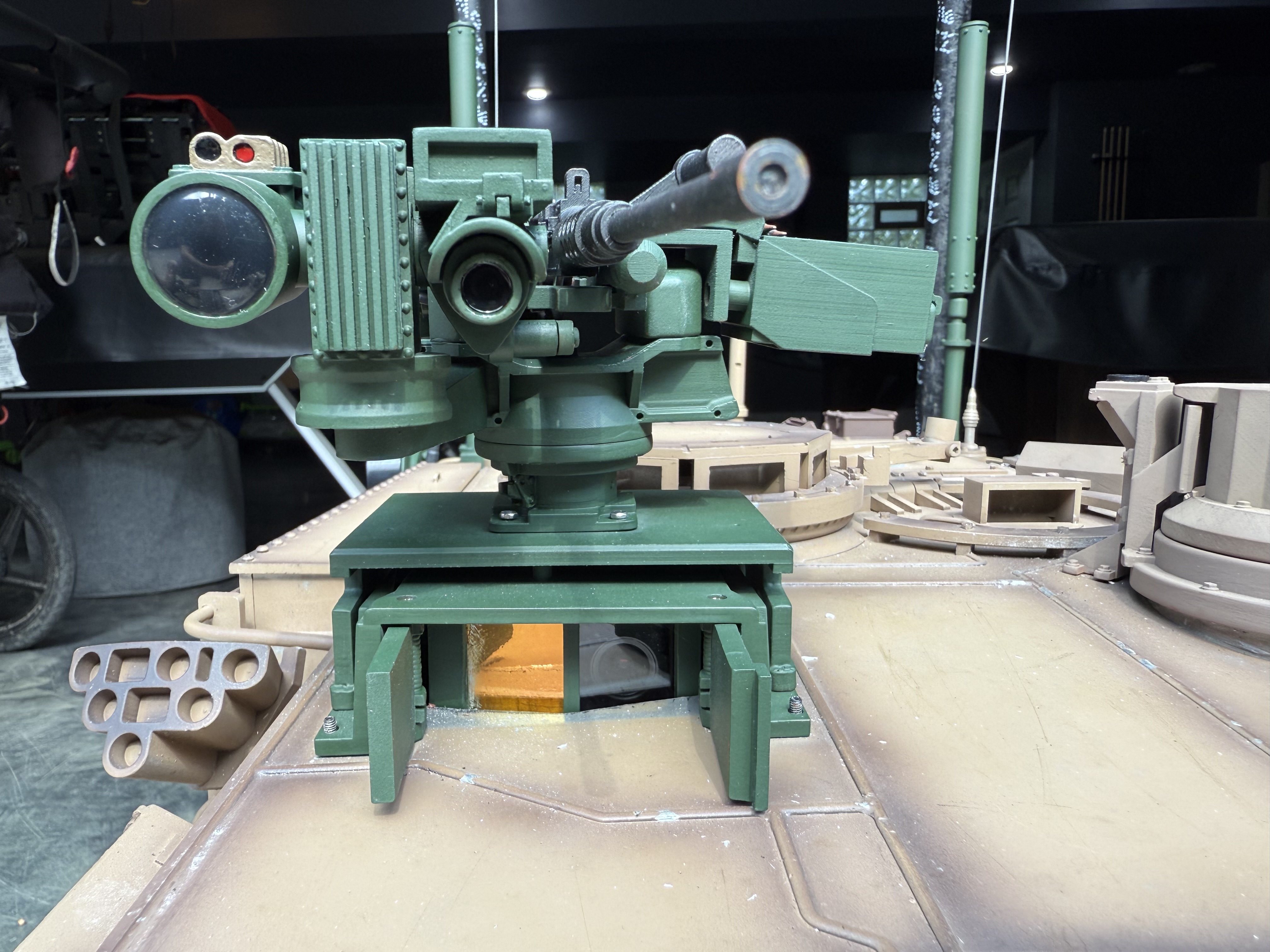

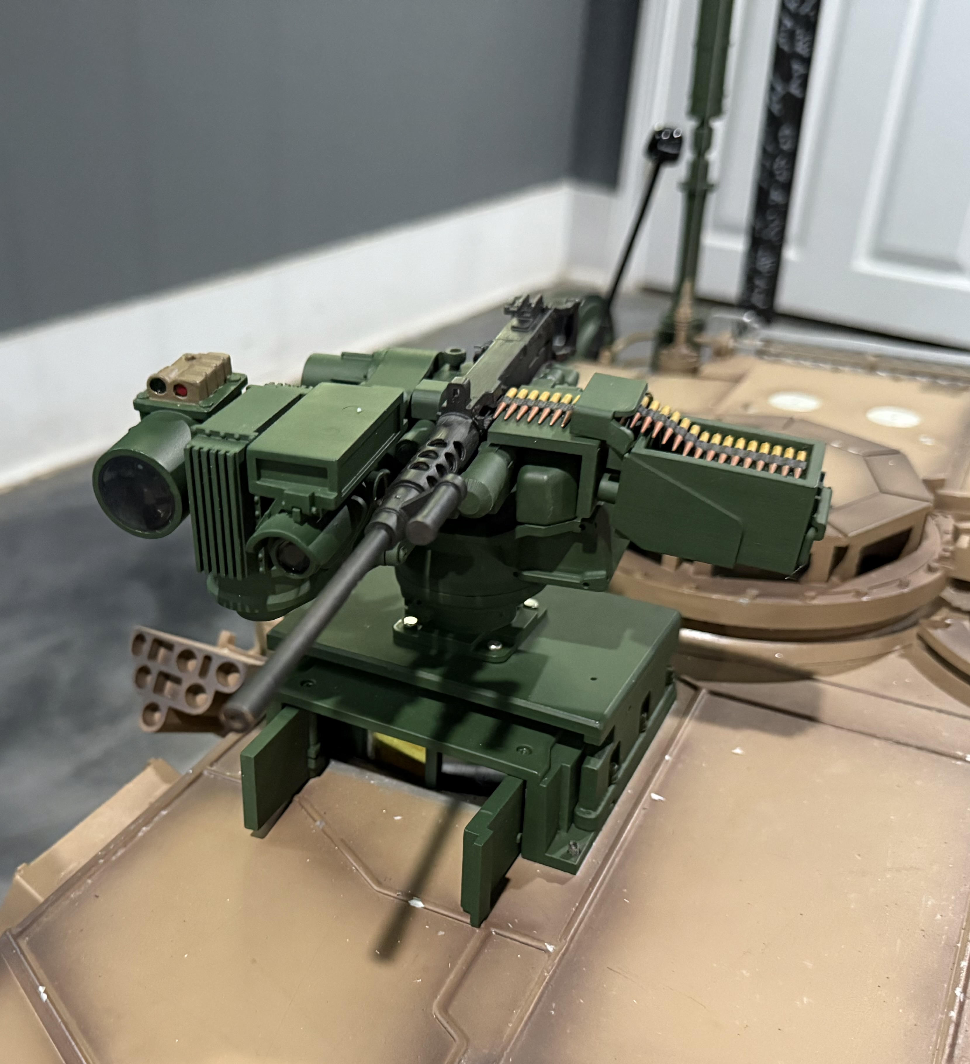

Update on the model, still having brown out issues with the MFU, but
I’ve got all five cameras installed and working
I’ve finally installed the CROWS LP
Painted and installed several aesthetic add ons
Made a new video showing these updates off: https://youtu.be/DJX6YsUvGV8?si=Qa5lZZk5hR23Fe-O
- IMG_0642.jpeg (2.87 MiB) Viewed 684 times
- It might not be everyone’s cup of tea, but O chose to go one side clear Lexan for the camera, and the other the reflective photo paper or whatever it’s called
- IMG_0649.jpeg (2.21 MiB) Viewed 684 times
- IMG_0643.jpeg (1.76 MiB) Viewed 684 times
- IMG_0646.jpeg (2.56 MiB) Viewed 684 times
- IMG_0645.jpeg (1.71 MiB) Viewed 684 times

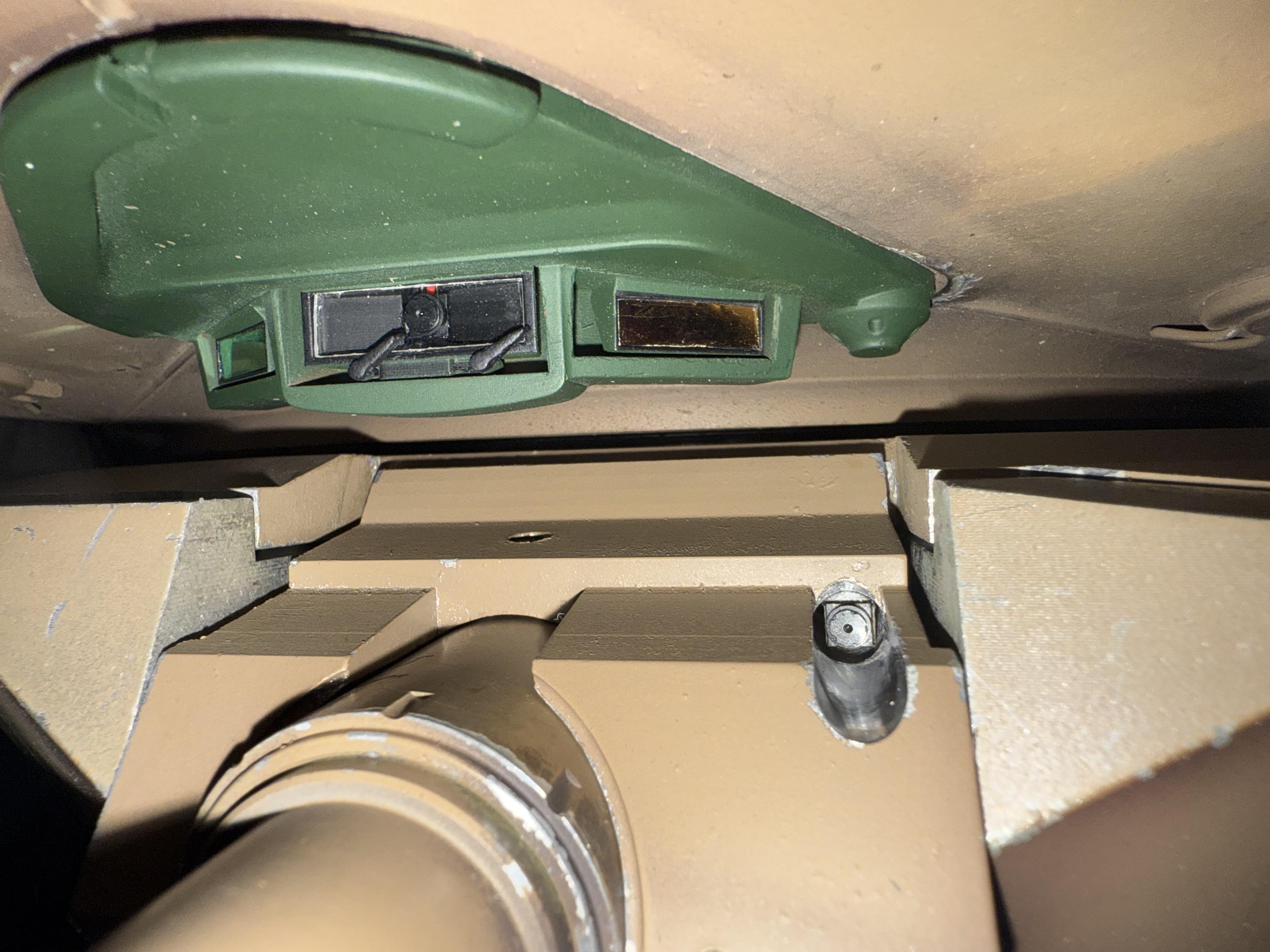

- IMG_0650.jpeg (2.12 MiB) Viewed 684 times
- Similar to the dog house, I did clear Lexan for the main drivers periscope with the camera, and reflective photo paper or whatever it’s called for the side periscopes
- IMG_0652.jpeg (1.9 MiB) Viewed 684 times
- Here you can see the drivers periscope camera and the auxiliary gunners camera
