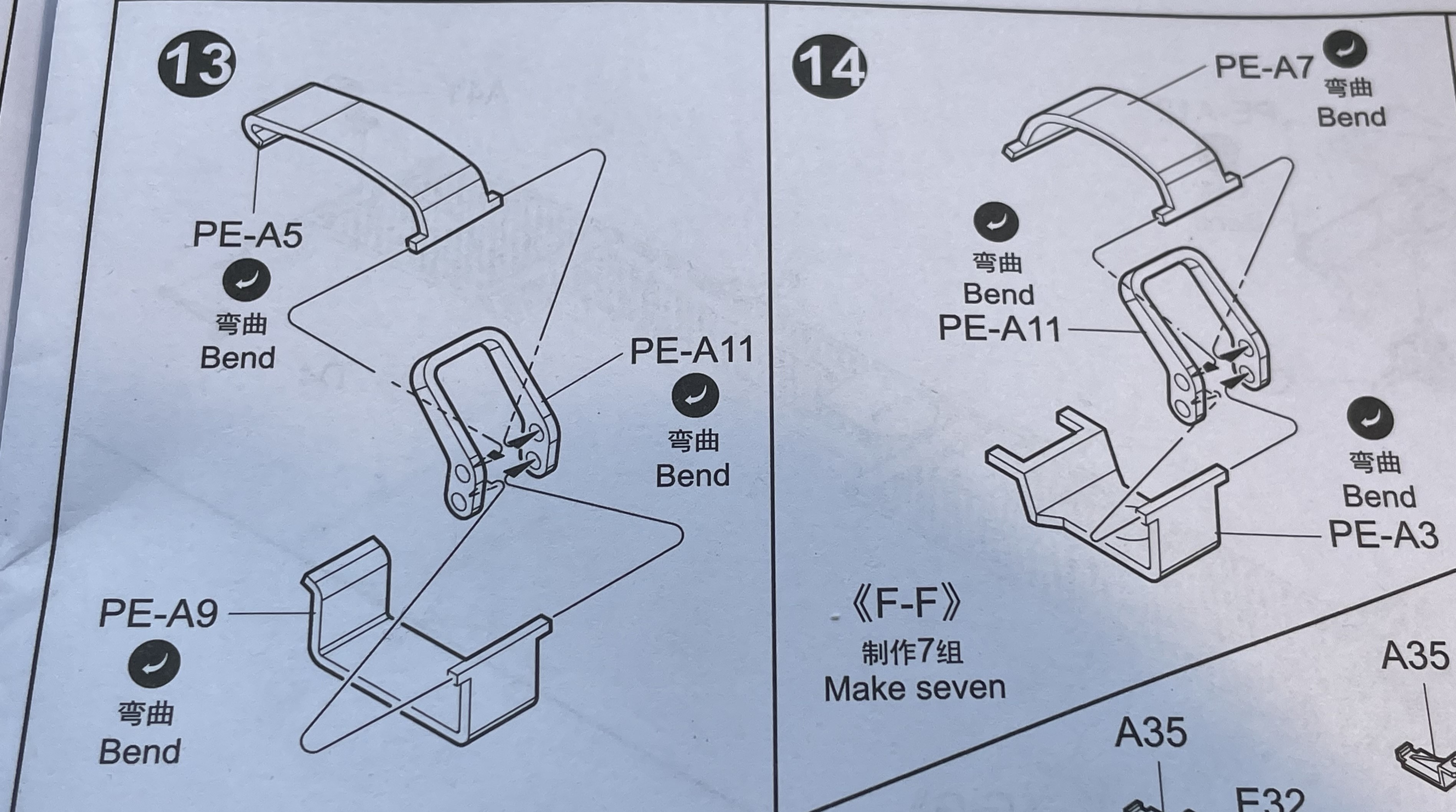

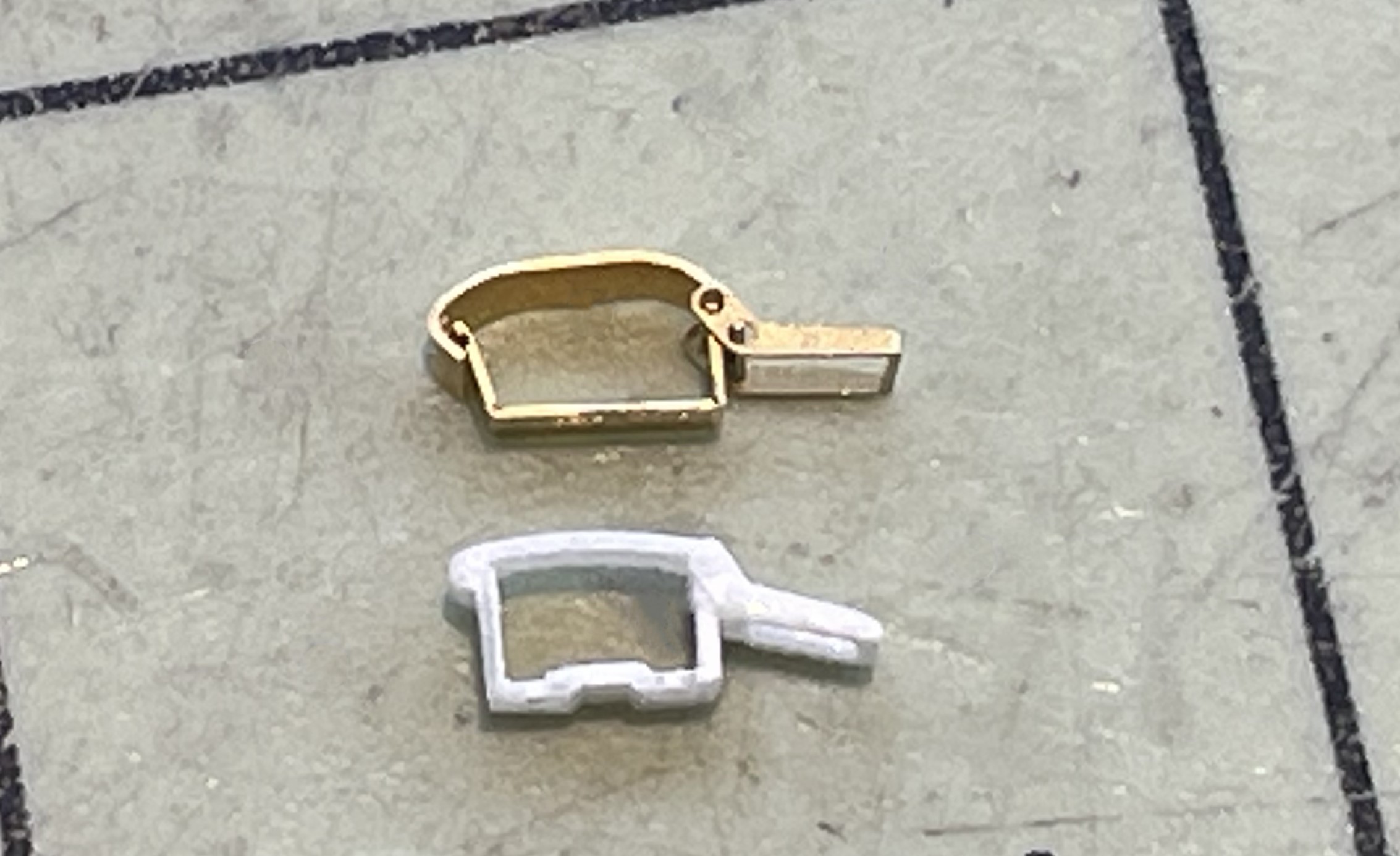

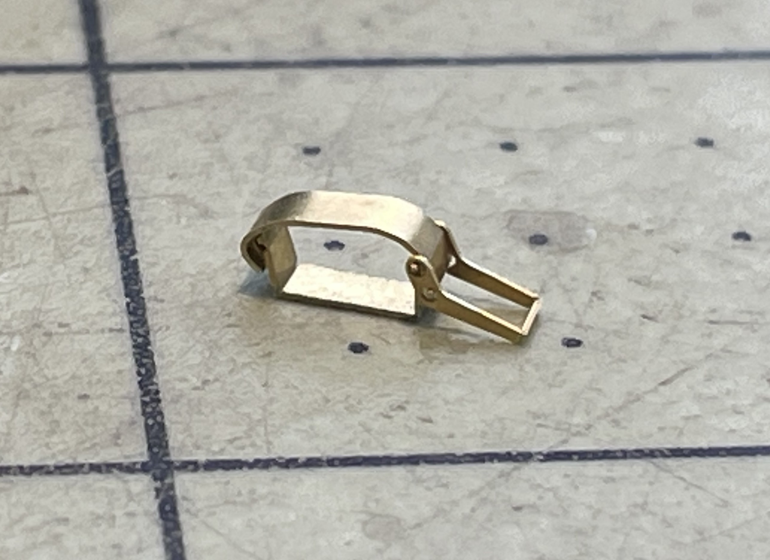

I usually paint the model and install the tools after. However, looking at the tool clamps, i decided to install them first.

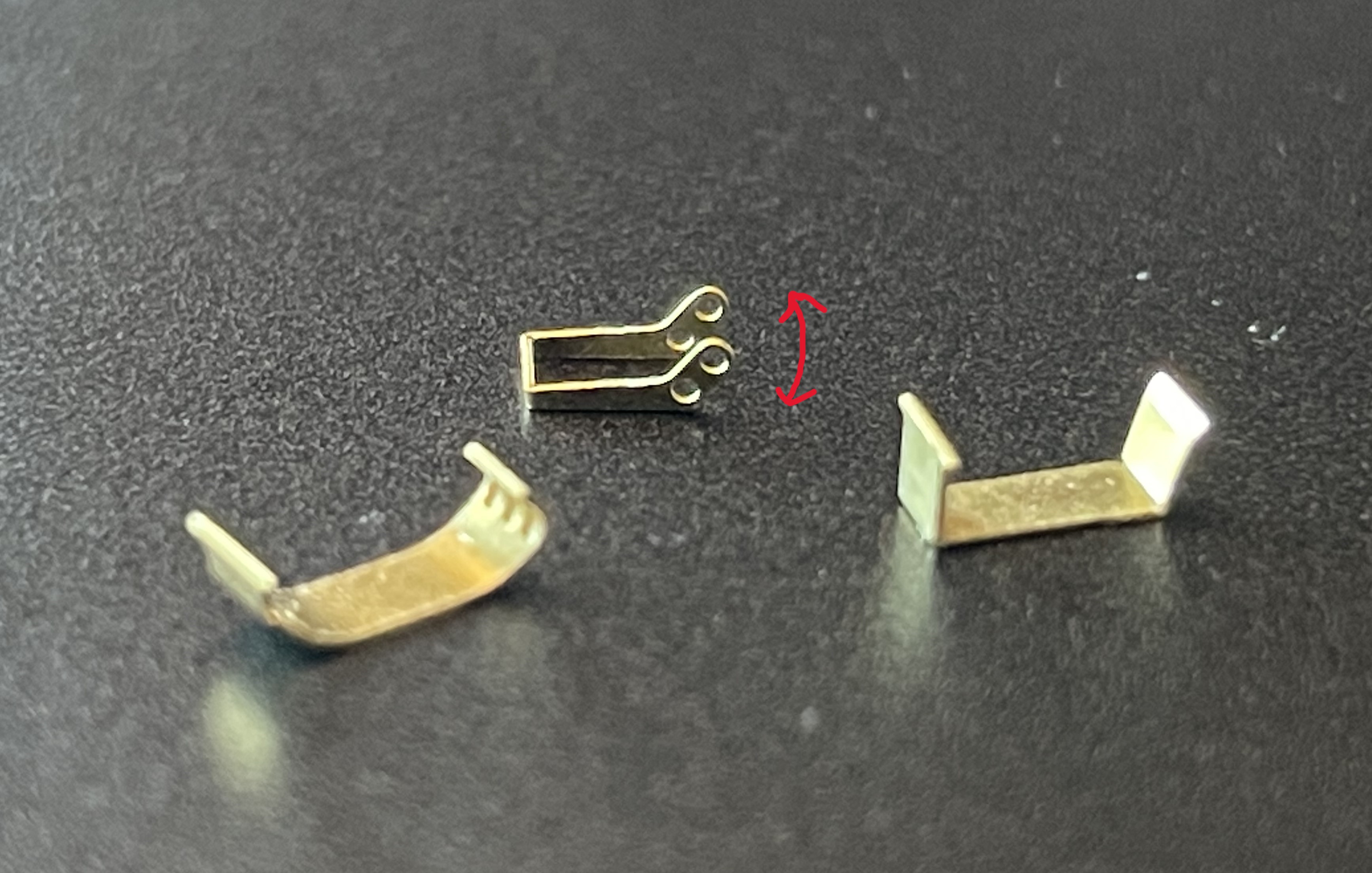

Trumpeter provides working tool clamps in photo-etched brass. At first, the 3 part clamps seem easy to build.
1/16 PzKpfw III Ausf M - Trumpeter/Heller kit with Taigen hull integration - Build
It's not obvious how to create the curve to give the upper part the proper lenght so that it will lock correctly with the bottom part. The parts are so tiny, two pairs of glasses are not enough. And the folded lever that is supposed to keep the assembled clamp together has no lateral strength whatsoever. Chinese PE parts are also typically too thin. Although the kit is straitforward to build for any modeller, these clamps are clearly not for everyone.
After 10 minutes of cursing, i managed to assemble one but it falls apart as soon as the picture is taken. The bending is also not perfect. After reassembling it 3 times, i give up. For a static model, it could potentially work out with extreme caution, but for an RC tank, there is no way these clamps will last more than a few minutes with some handling of the tank. Soaking the joints in superglue would not look good, anyway, i am done with them. Another solution is required.

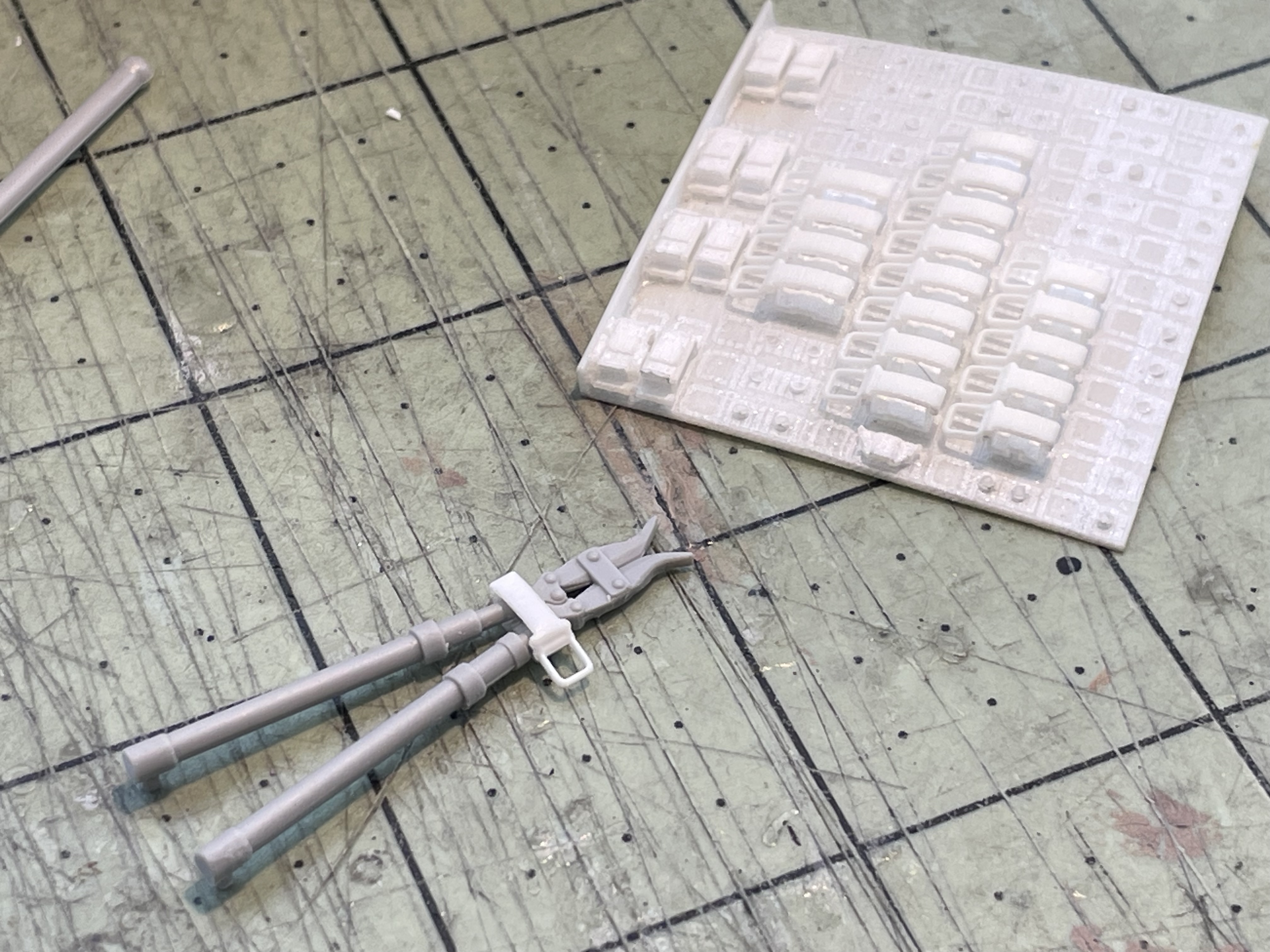

The Shapeways 3D printed tool clamps are certainly one of their best and most popular offerings. It compares well to the Trumpeter parts and are a bit more solid if you do not crush them. At least, they hold together and once glued to the tank and to the tool, they are quite solid and look good.

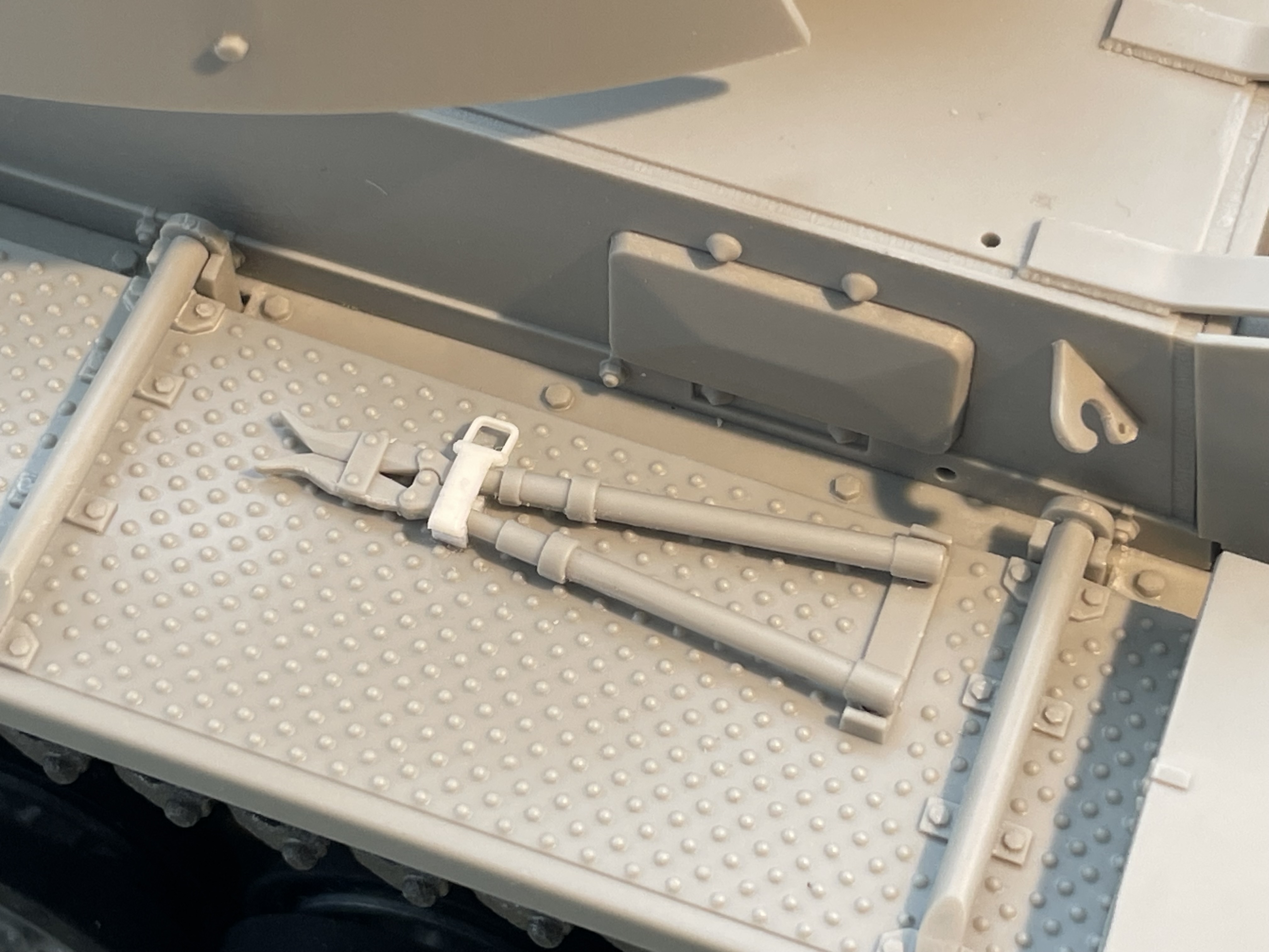

The Trumpeter tools are very good.

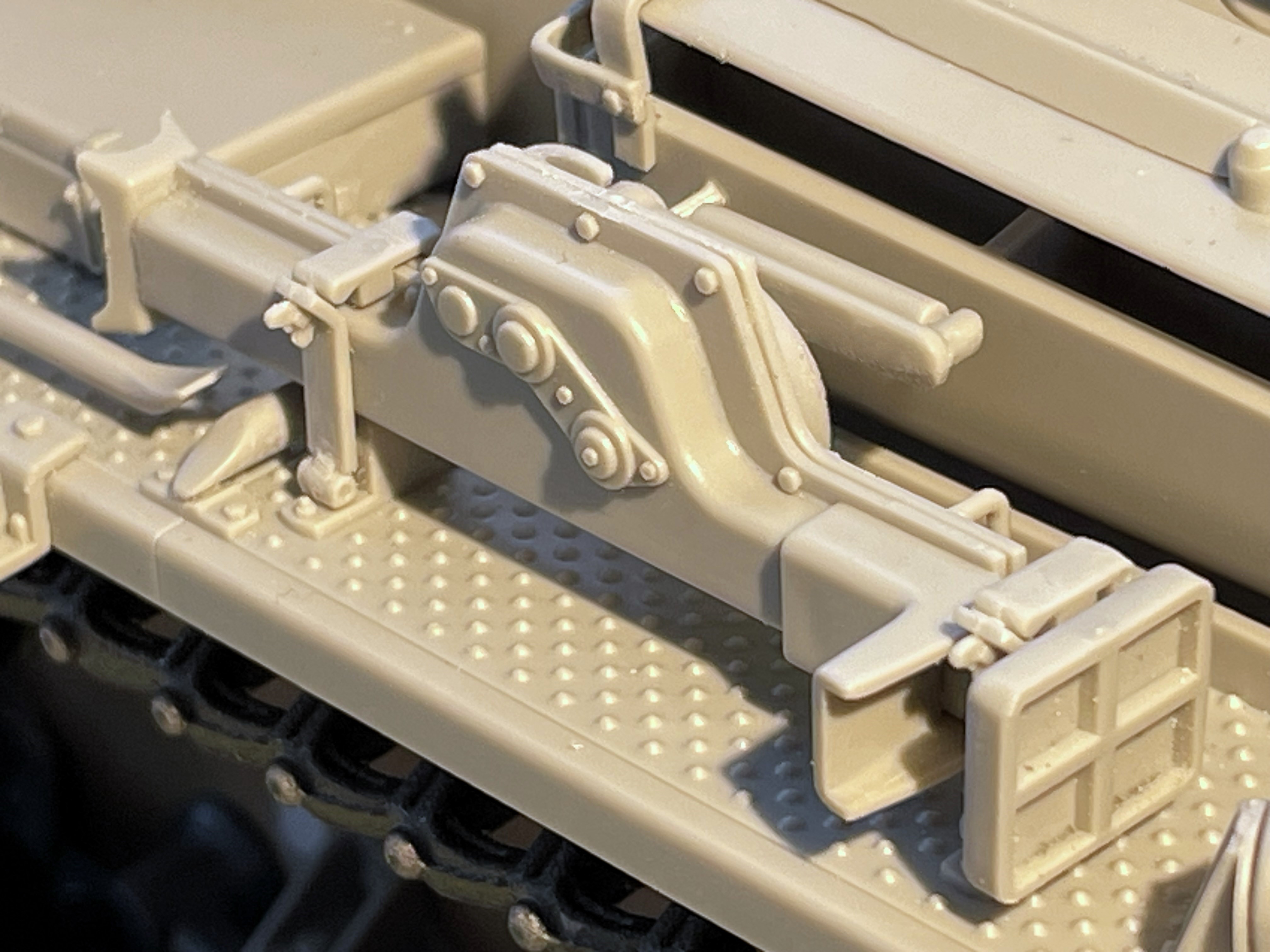

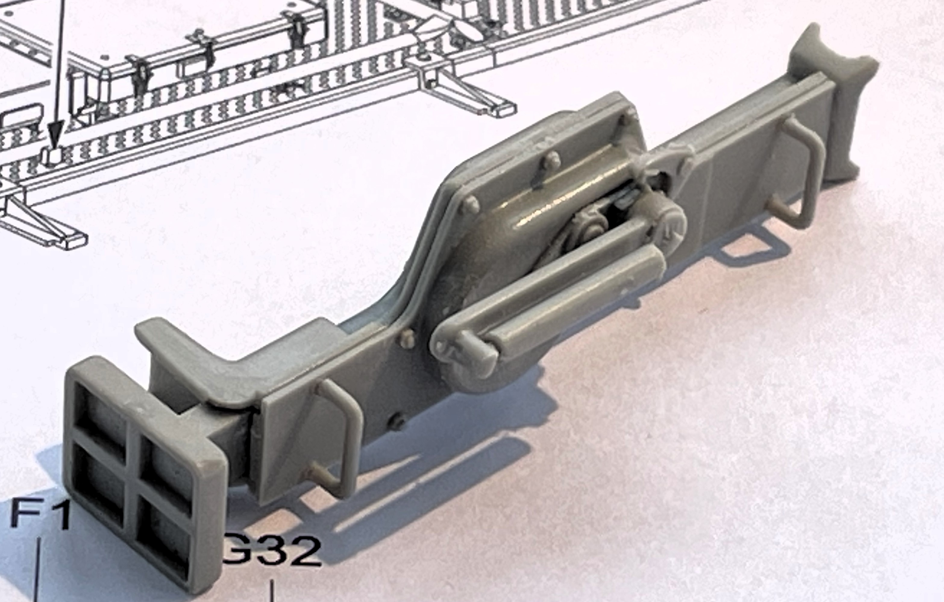

The 8 part jack is the best i have seen.

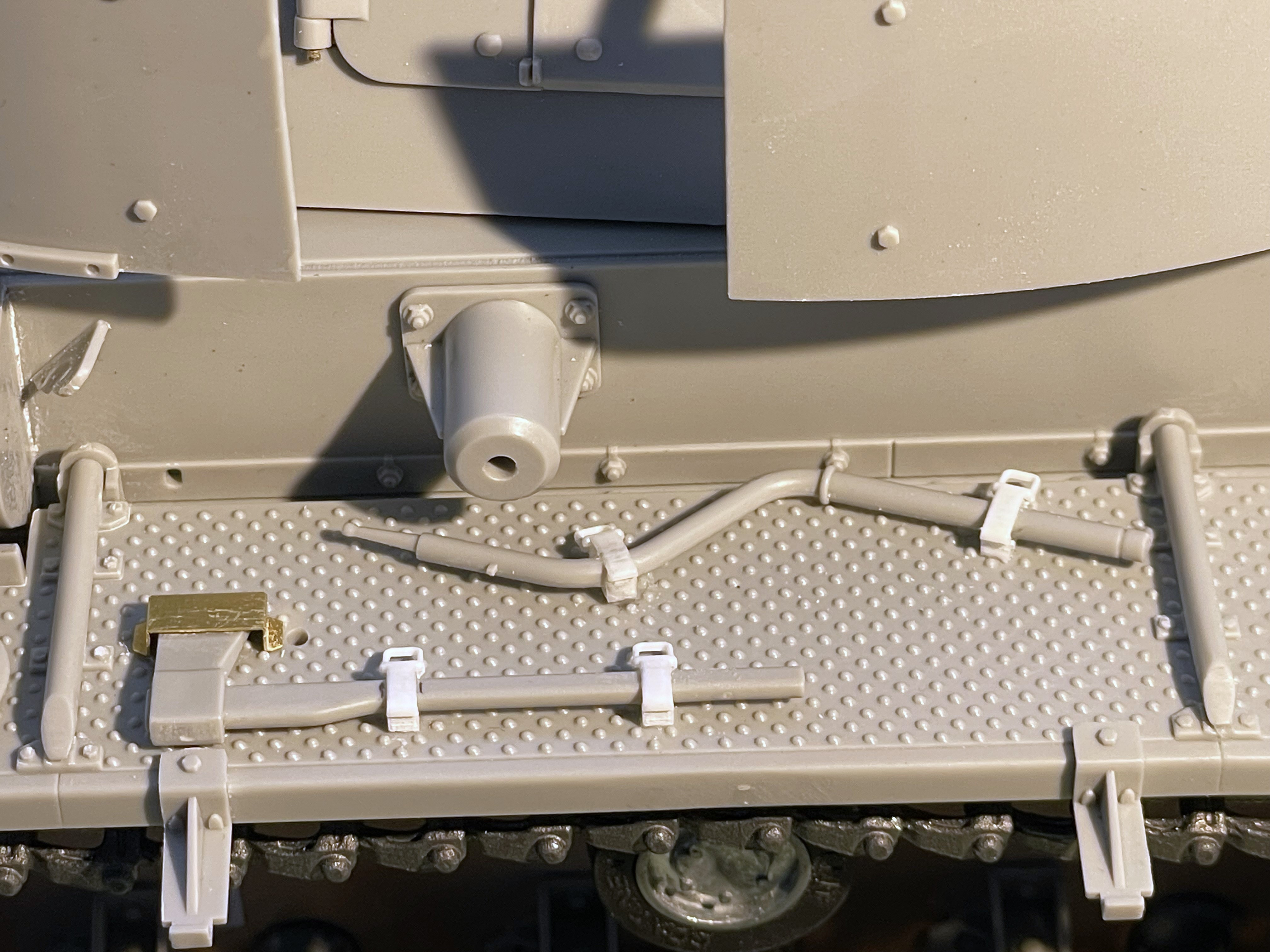

The two large Trumpeter clamps for the jack are very good but i am noticing on close ups that they need more cleanup.

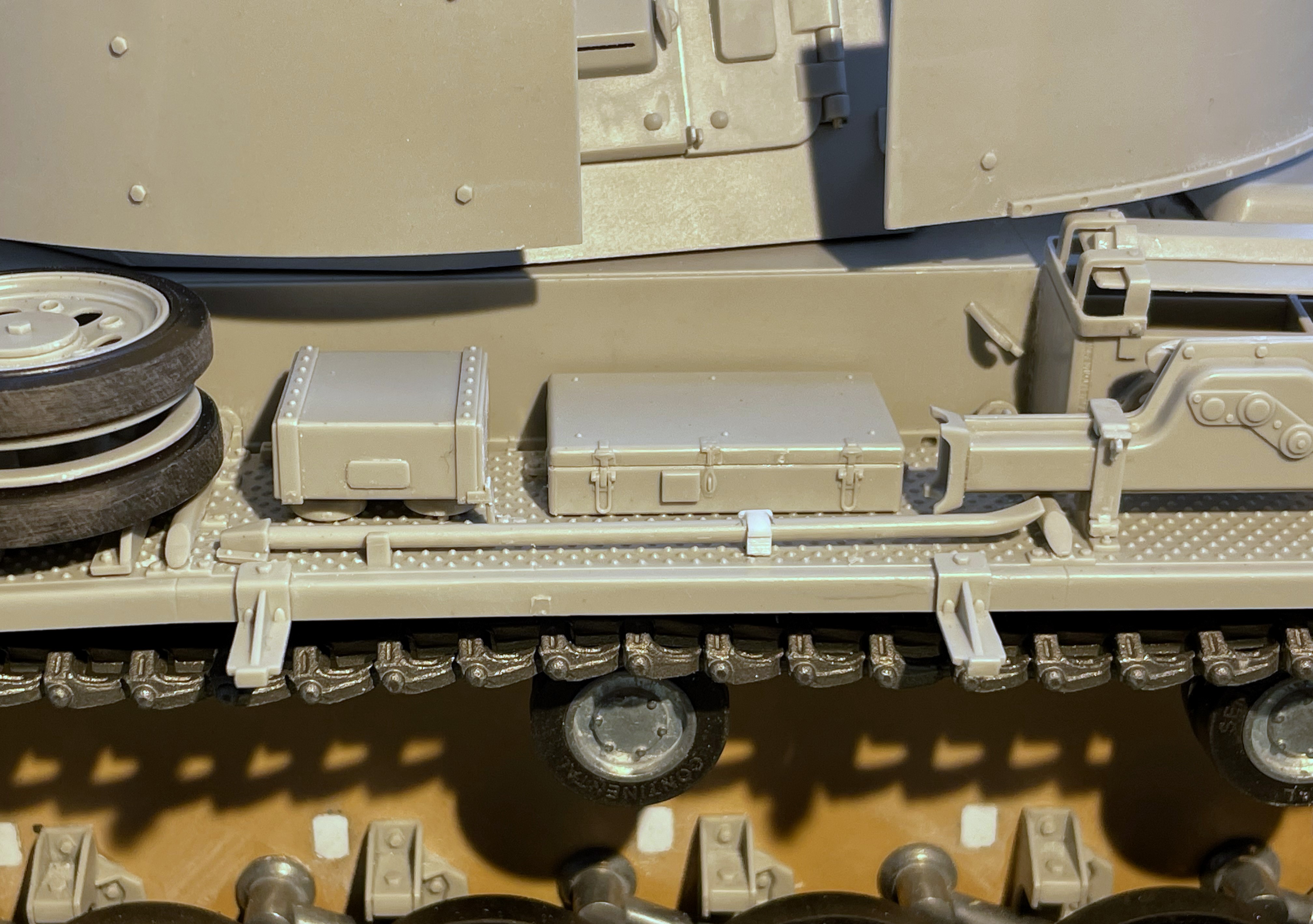

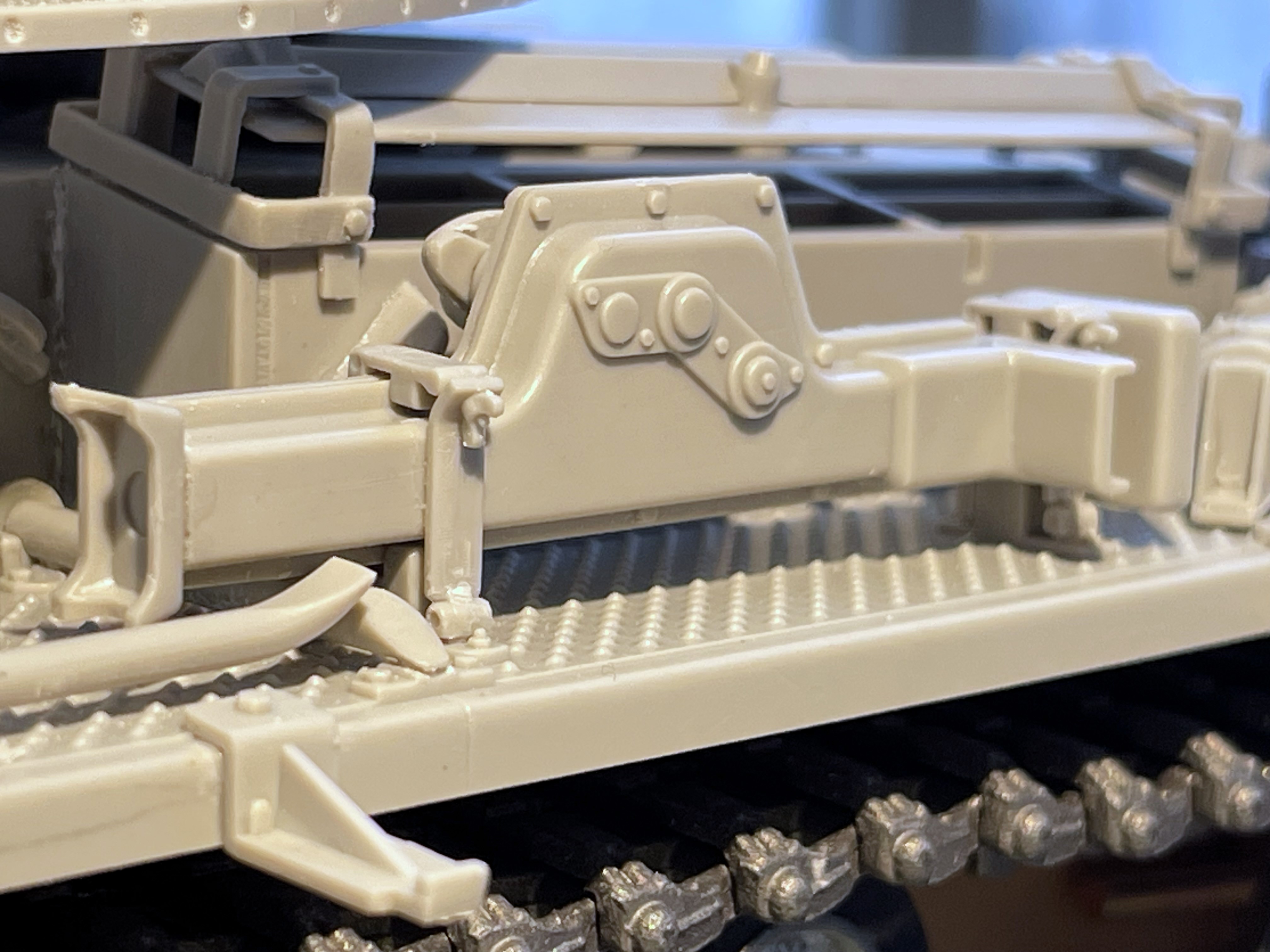

All the tools are installed with Shapeways tool clamps. The tread plate underneath them needs to be flattened for a proper fix. Some positioning holes need to be enlarged too.

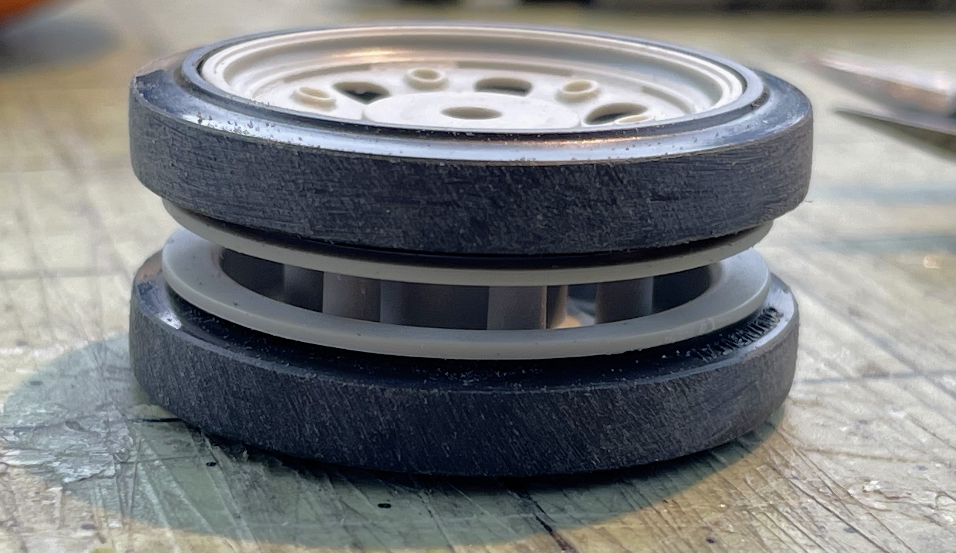

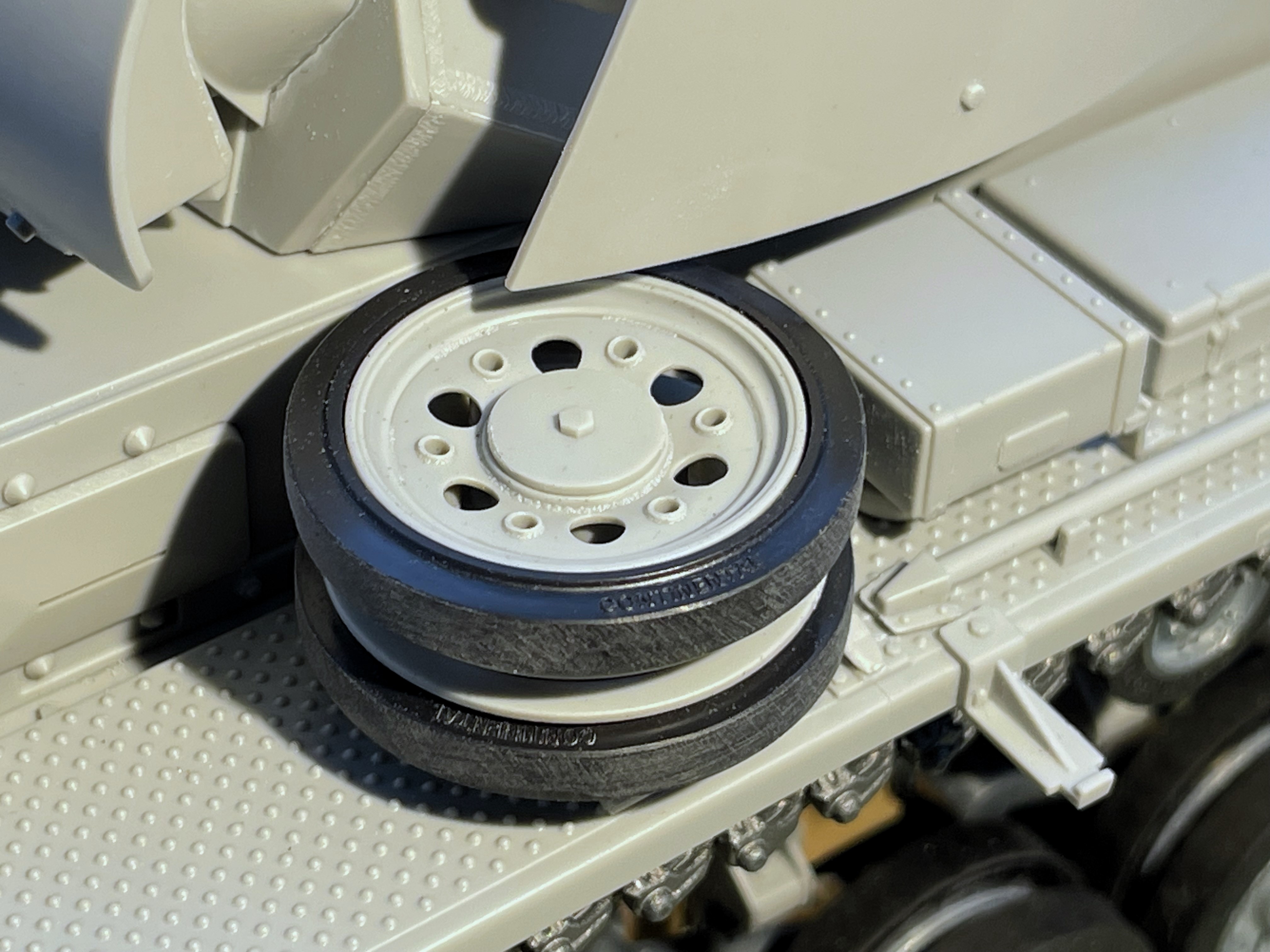

The interior rims of the spare road wheels look weird. Not used to see such large thick rims on any vendor models of Panzer III road wheels before. The tires need a lot of work to remove the molding line. Anyone building the model with the complete set of the kit roadwheels will certainly suffer.
The tires are kept removable until painting is finished.

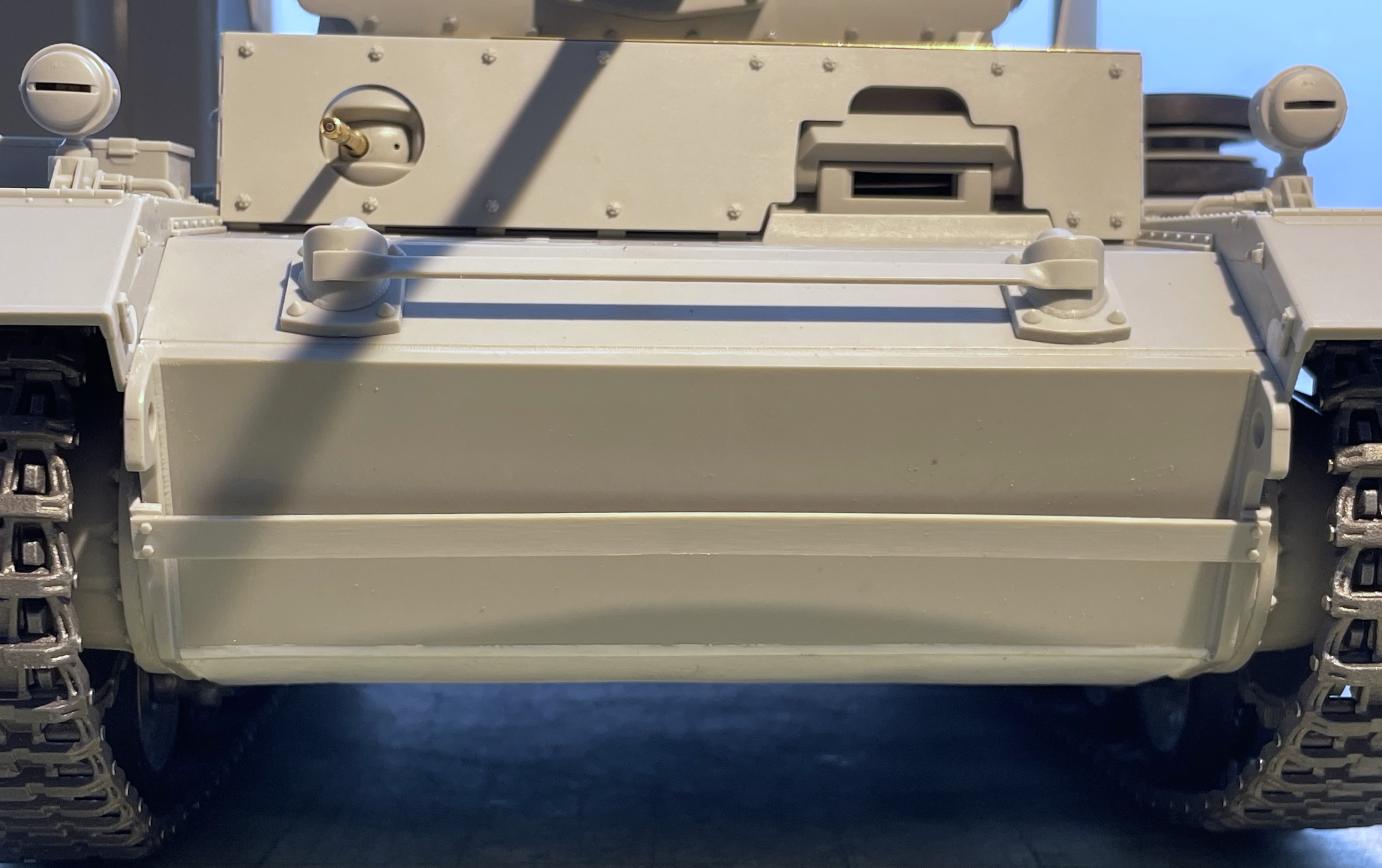

All the tools are in place, looking good.

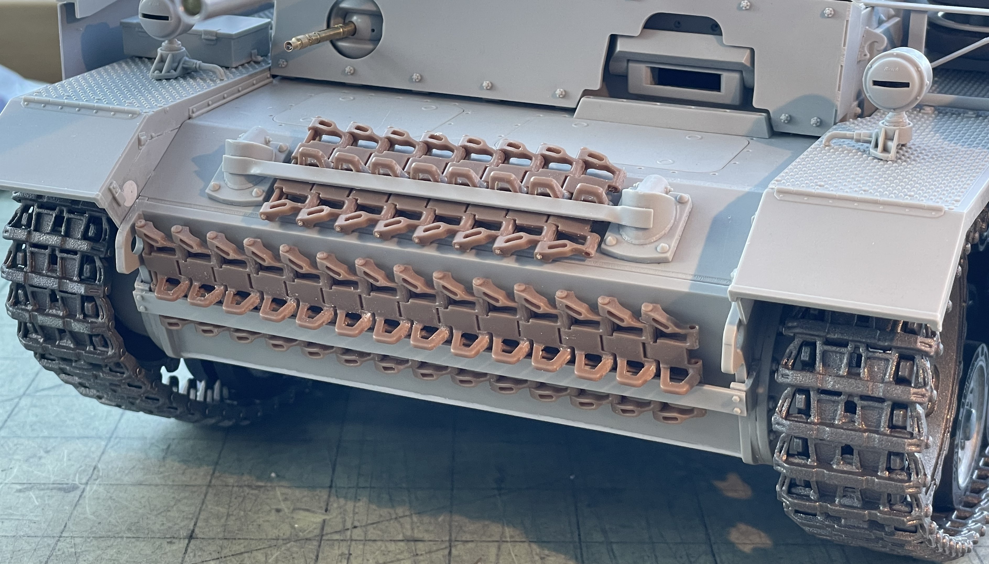

Spare tracks holders are installed.

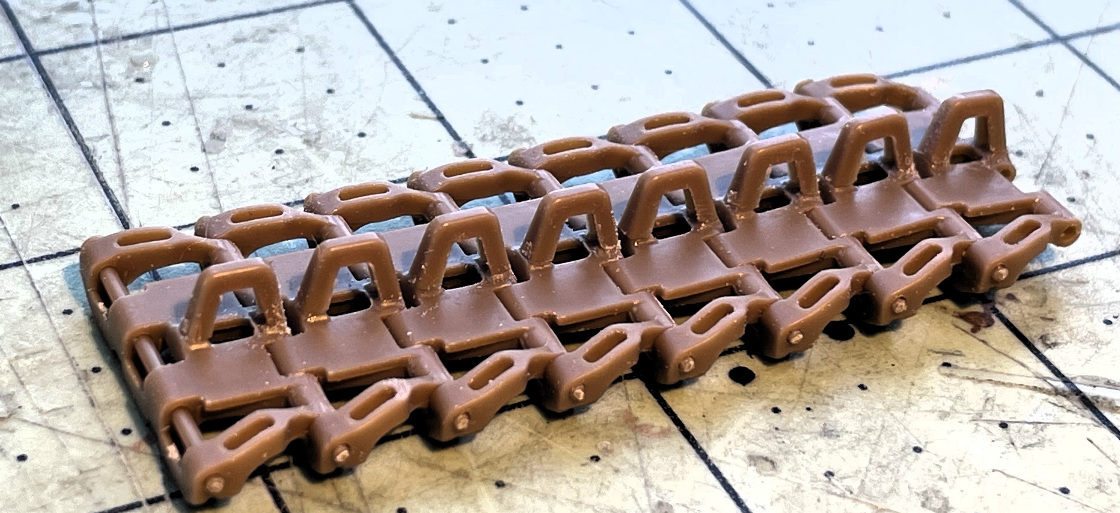

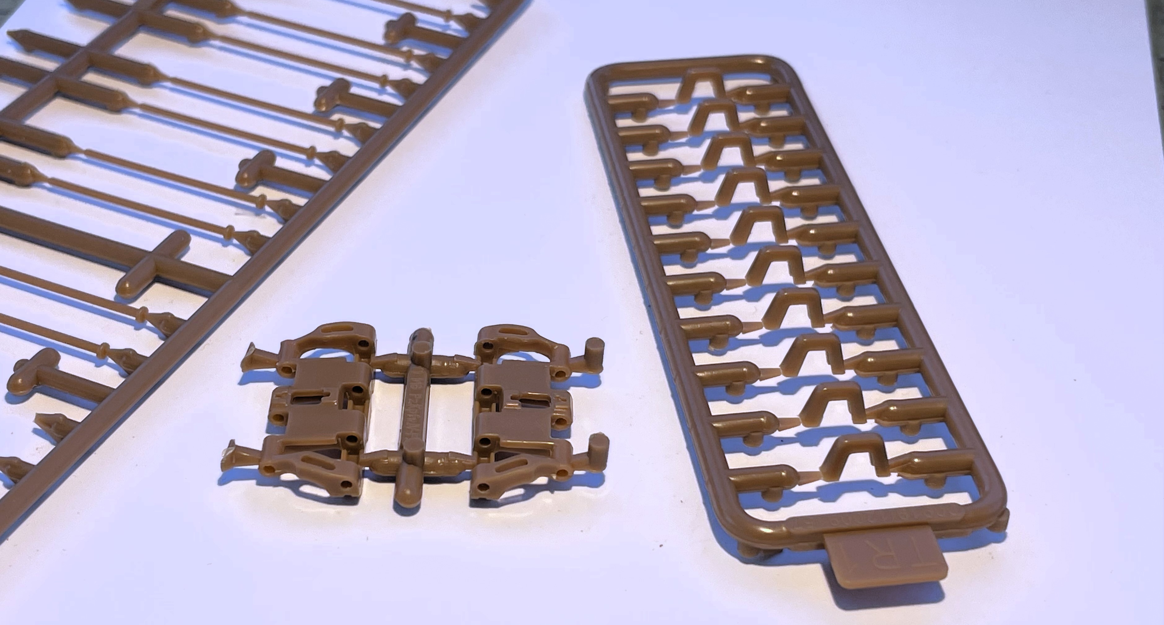

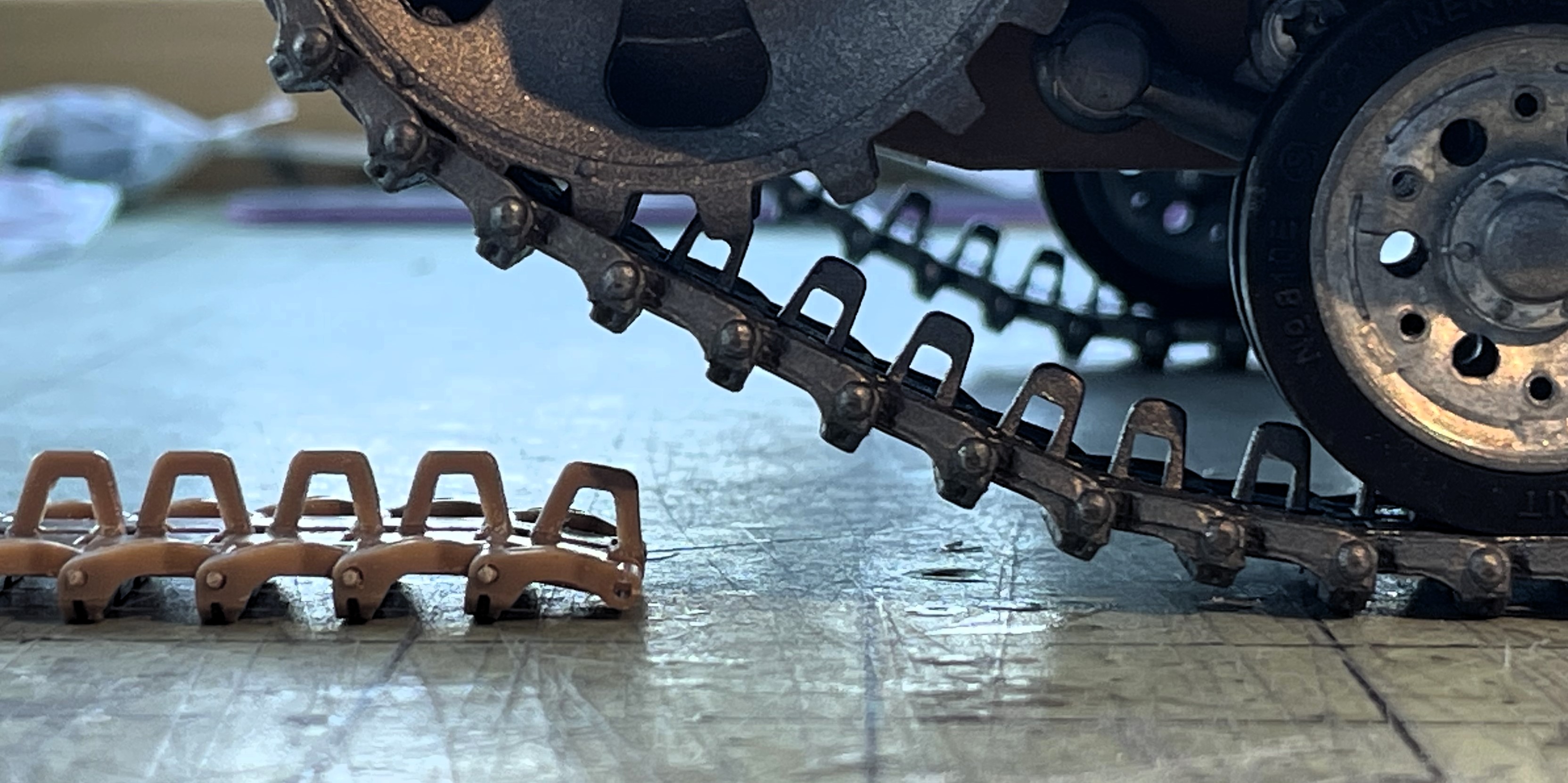

Impact did not provide enough metal spare tracks. I therefore have to use the kit's plastic tracks. They are well moulded and each track link comes in 3 parts with the plastic track pin. As the pin is quite thin, i doubt the tracks would last much if used for anything else than the spares. Would need replacement with metal pins.
Installing the center guide part was difficult. It somehow does not position itself naturally well. Thankfully, i just need a few.
I am noticing quite a difference in size between the Trumpeter and the Impact center guide pins. There is nothing i can do about that. I feel that the Trumpeter guide pins are probably too big, and the Impact guide pins are probably too narrow... Somehow, both do not look right but i am no Panzer III track expert.

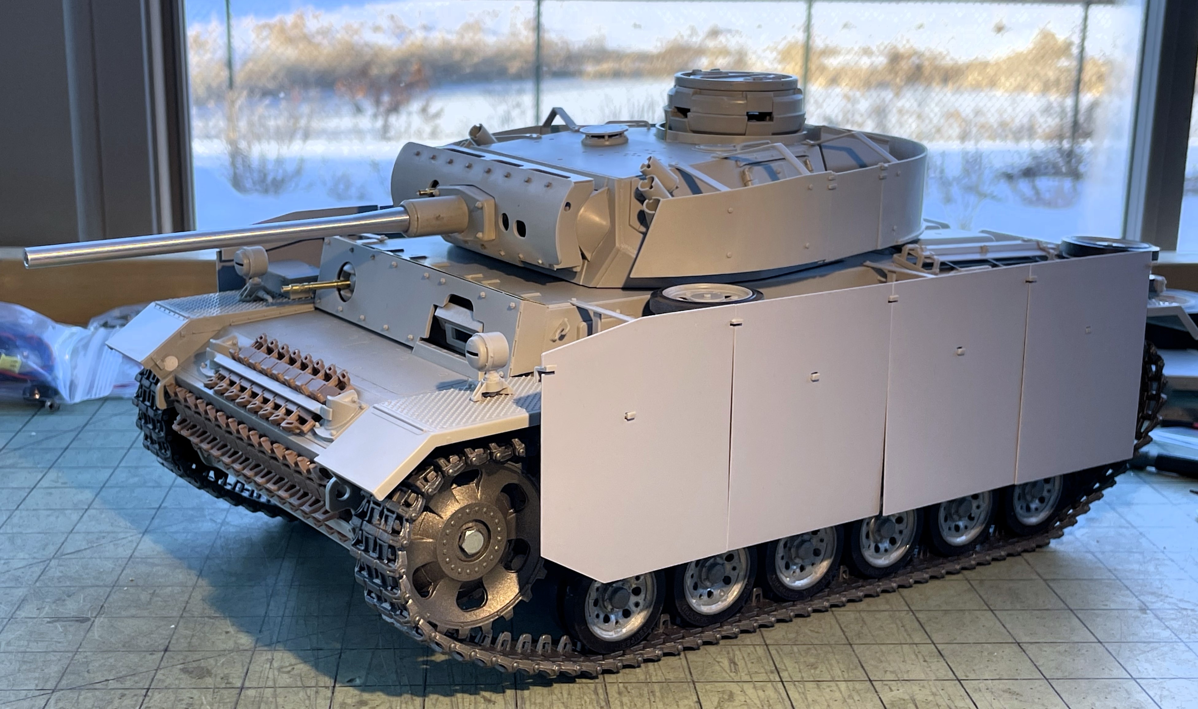

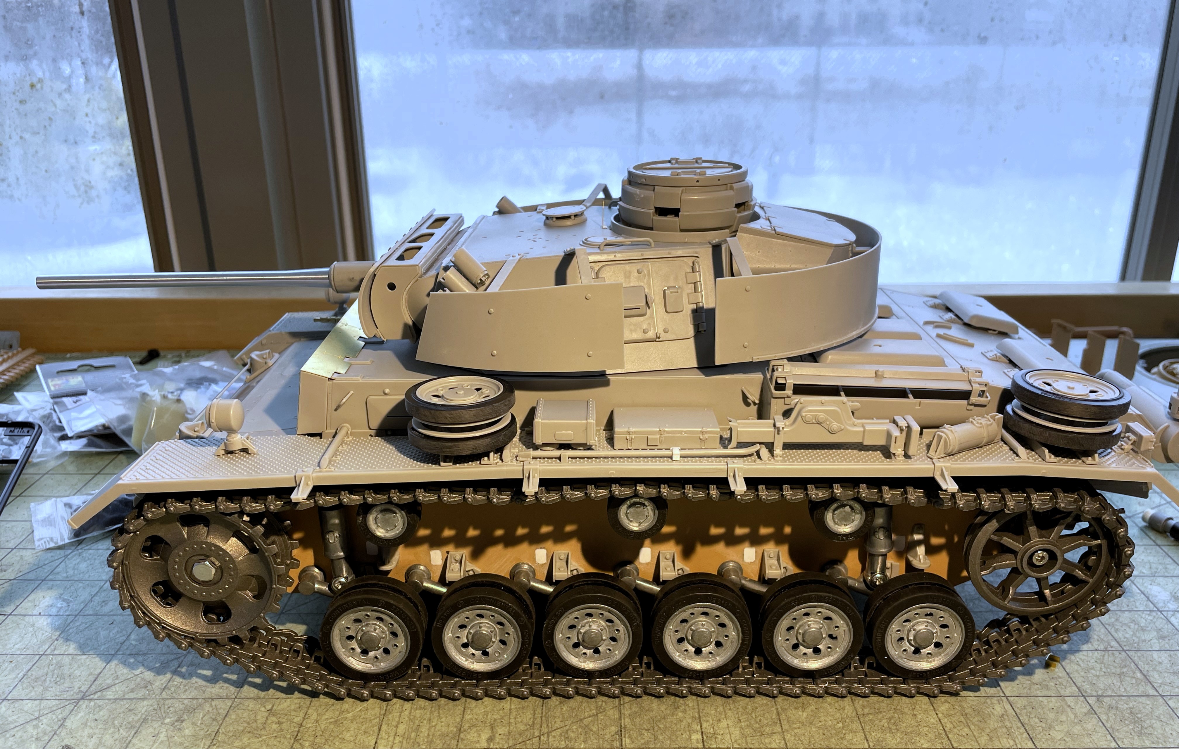

The model as it stands today.
