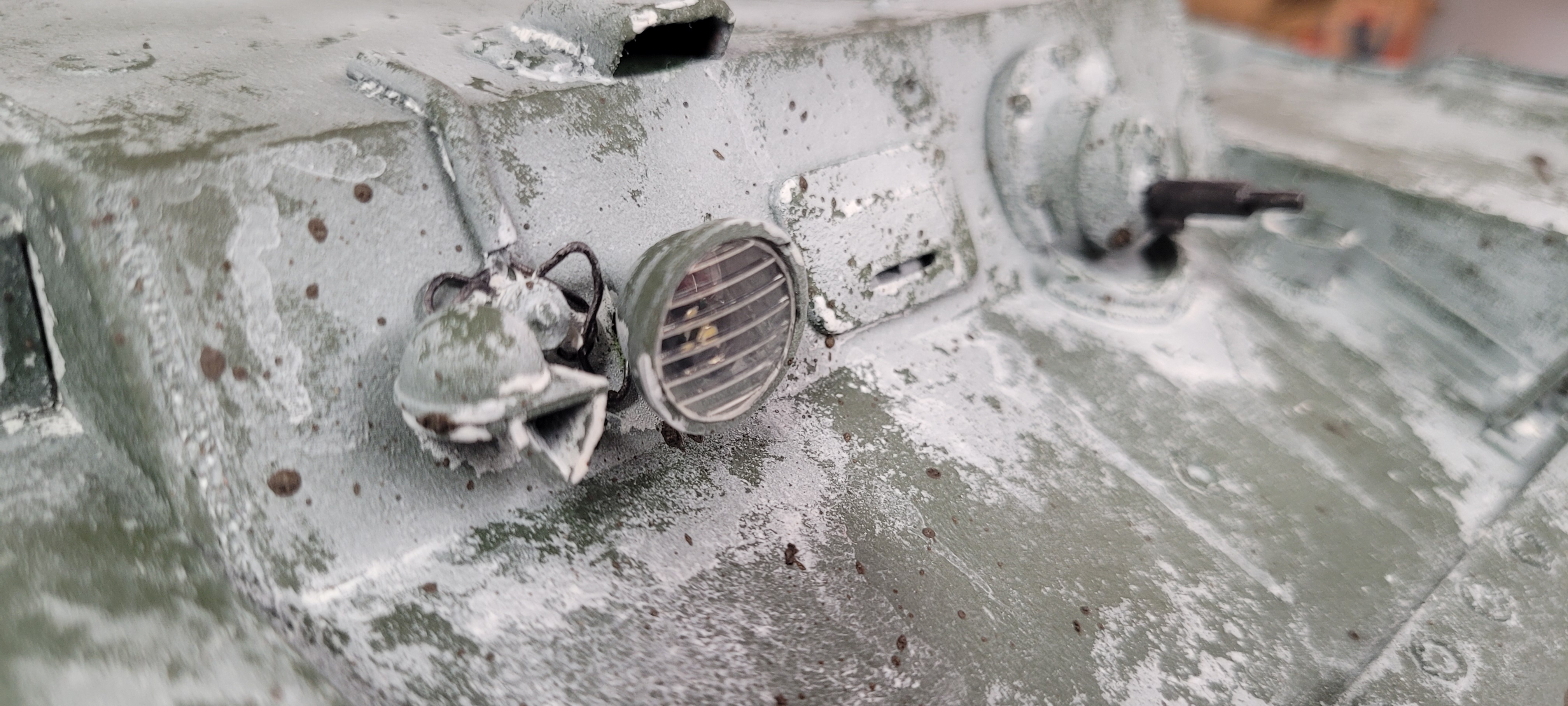

Things are heading towards completion but still a ways to go. Weathering goes on, and on...and on some more.

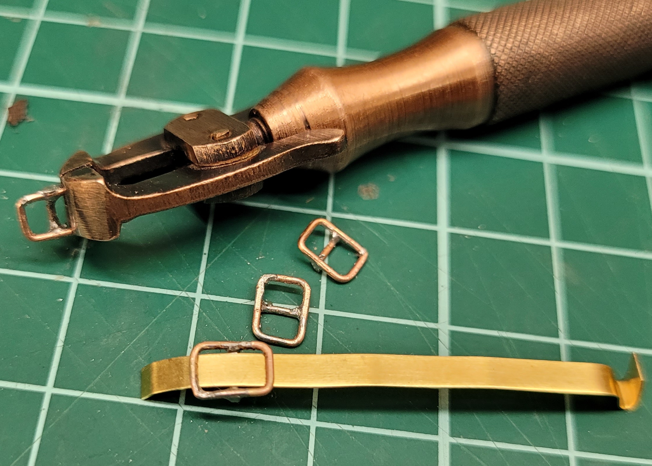

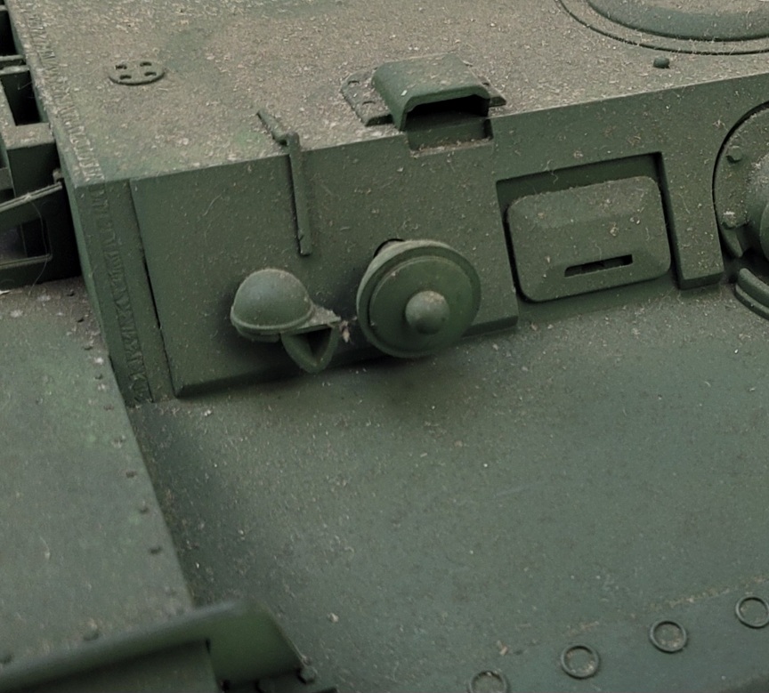

In the meantime, my headlight lenses finally arrived! Step one, drill out the hollowed out headlight pot to take a nice flat-top LED in sweet warm white. No cool-blue BMW highbeam eye blinder for the hulk! Over that goes the lens. A far cry from HLs weirdly shaped and mildly pornographic bugeye version. And a little copper work to solder up some buckles for the brass strip I'll use to recreate some tarp straps. Baby steps for the dreadnought, but end is in sight!

Re: WINTER 23-24 KV-1 to KV-85 to KV-2 Phew!
Slick work on the straps .
I'll second Herman's compliments on the buckles and straps, they look fantastic! The weathering and new headlight are great additions too.

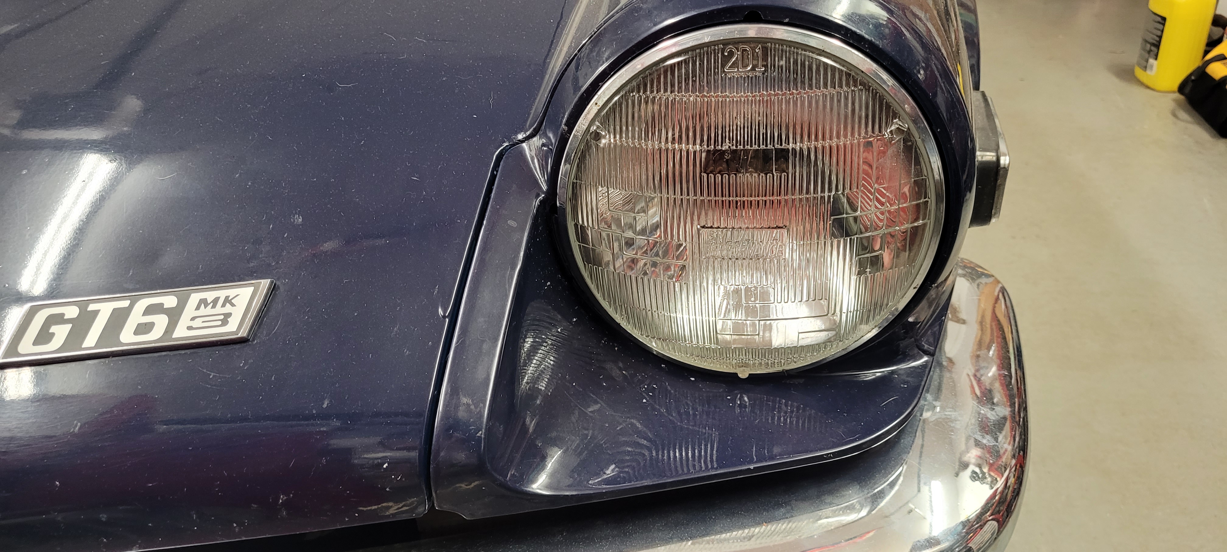

The only advice I'd have would be to rotate the headlight lens 90° if it's not too late. The fresnel lenses in the headlight glass should be oriented vertically, not horizontally; take a look at any old-timey sealed headlight unit for inspo.
As Liz Lemon would say, "Well, ah duh..."Raminator wrote: ↑Sun Mar 17, 2024 1:06 am I'll second Herman's compliments on the buckles and straps, they look fantastic! The weathering and new headlight are great additions too.

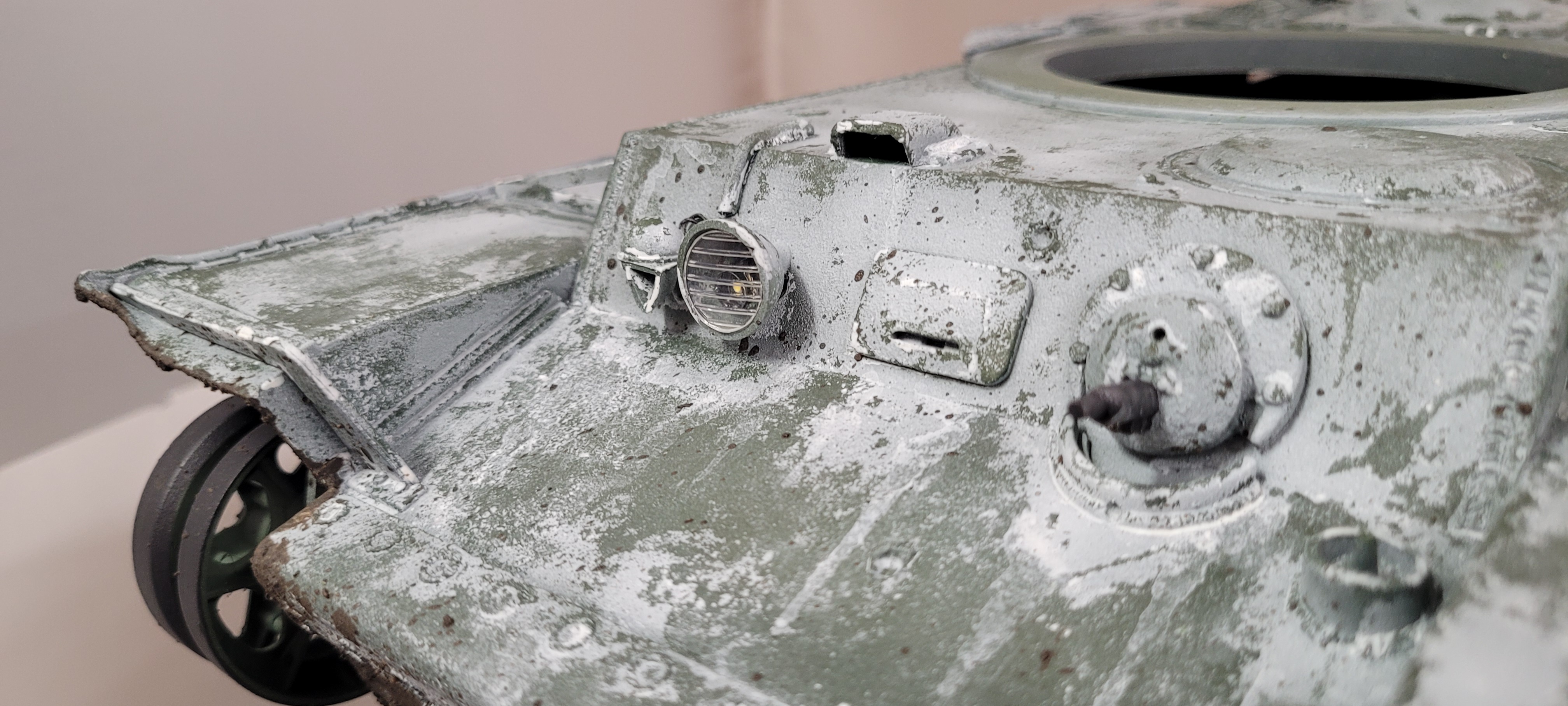

I guess I should turn around in my shop more often and look at my old-timey car's sealed beams occasionally! Fortunately just press fitted on the KV-2 until it's all done so they will be verticalized. If I get brave might scribe in a few horizontal lines like the Tamiya lens has. Thanks for the encouragement guys, and the old-timey tip Raminator!
Those buckles are amazing. I wish I had any sort of soldering skills and the eyes and finger dexterity to produce pieces like that
