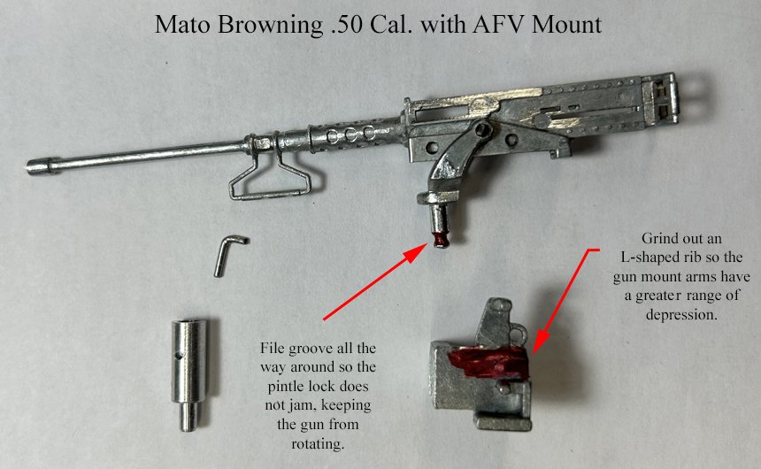

Feeling exhausted Sunday evening and even worse Monday morning (26 Feb. 2024), despite care and vaccines, I found two red lines on a Covid test. Such is luck sometimes. Progress on the T26E3 was held up because I couldn't hold my head up. But I got a bit done, including digging out of the one of the goodies containers a metal Mato Browning .50 cal. for the turret.
Taking out an unpainted Mato MG, I was reworking almost every part of it to get off cast lines and at least some of the Grand Canyon press pin marks on the castings. I knew why the body of the MG could not pivot down forward in the castings for the ammo box and its mount, but I did not know how to get the ammo box mount off. As I was filing and filing and filing, even reshaping the
I have a Mato .50 cal. on my Mato M10, and I was always depressed because the Mato MG could not be depressed. After all, Audi Murphy got a Medal of Honor for standing up on the engine deck of a toasty warm M10 and using the .50 cal. to discourage attackers. How could he ever have won the medal if his gun only pointed skyward?

On Monday morning (26 Feb. 2024), despite care and five rounds of vaccines, I found a nasty red line by the "T" on a Covid test. Such is luck sometimes. Progress on the T26E3 was held up because I couldn't hold my head up. But today I got a bit done, including digging out a metal Mato Browning .50 cal. for the turret.
Filing and grinding, I was reworking almost every part of an unpainted Mato MG to get off cast lines, to remove at least some of the Grand Canyon push pin marks on the castings, and even to create a semblance of the outer end of an ammo box. I knew why the barrel of the MG could not be positioned at all depressed: the curved arms of the pintle mount cannot pivot forward and downward because of a hidden rib inside the casting for the ammo box mount. But I did not know how to get the ammo box mount off.* As I was filing and filing and filing, the ammo box and mount (cast as a single piece) came off! Hallelujah! I attacked with the Dremel grinder and said goodbye to the useless and offending rib that blocked the way.
*I have a Mato .50 cal. on my Mato M10, and I was always depressed because the Mato MG could not be depressed. After all, Audi Murphy got a Medal of Honor for standing up on the engine deck of a toasty warm M10 and using the .50 cal. to discourage attackers. How could he ever have won the medal if his gun only pointed skyward?

Best of luck for a speedy recovery, Herr Doktor! Hopefully you'll be as fighting fit as your Pershing in no time.
That M2 is going to be great once it's all filed and polished. Nice detective work getting the full range of motion back, too!
