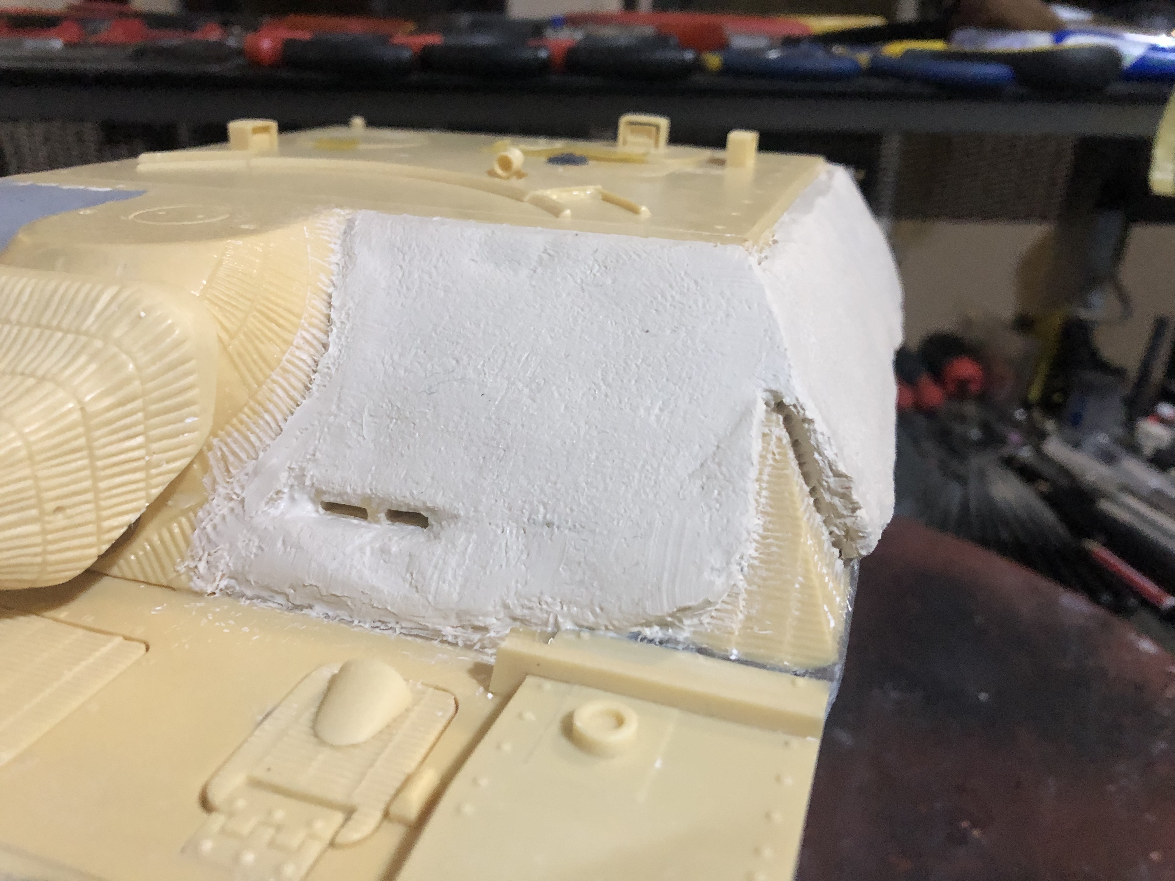

And one third is done......still wet so let’s see how the stuff goes over night.

Never heard if Air Drying Modeling clay. I'll guess that once the package is opened the clock is running. I'm watching eagerly of how this works out and how stiff, workable, paintable and durable it is when cured. I do note the damage to the concrete prior to curing. Would think that any field damage in the future would look like paint taken off real concrete.

Yes Sir, any damage would expose the bare concrete under any paint for sure.
If the stuff stays put and dries like they say then I can mask off the patches & exposed zimmerit and paint accordingly.
No point in me getting too excited until I see how is goes drying out.

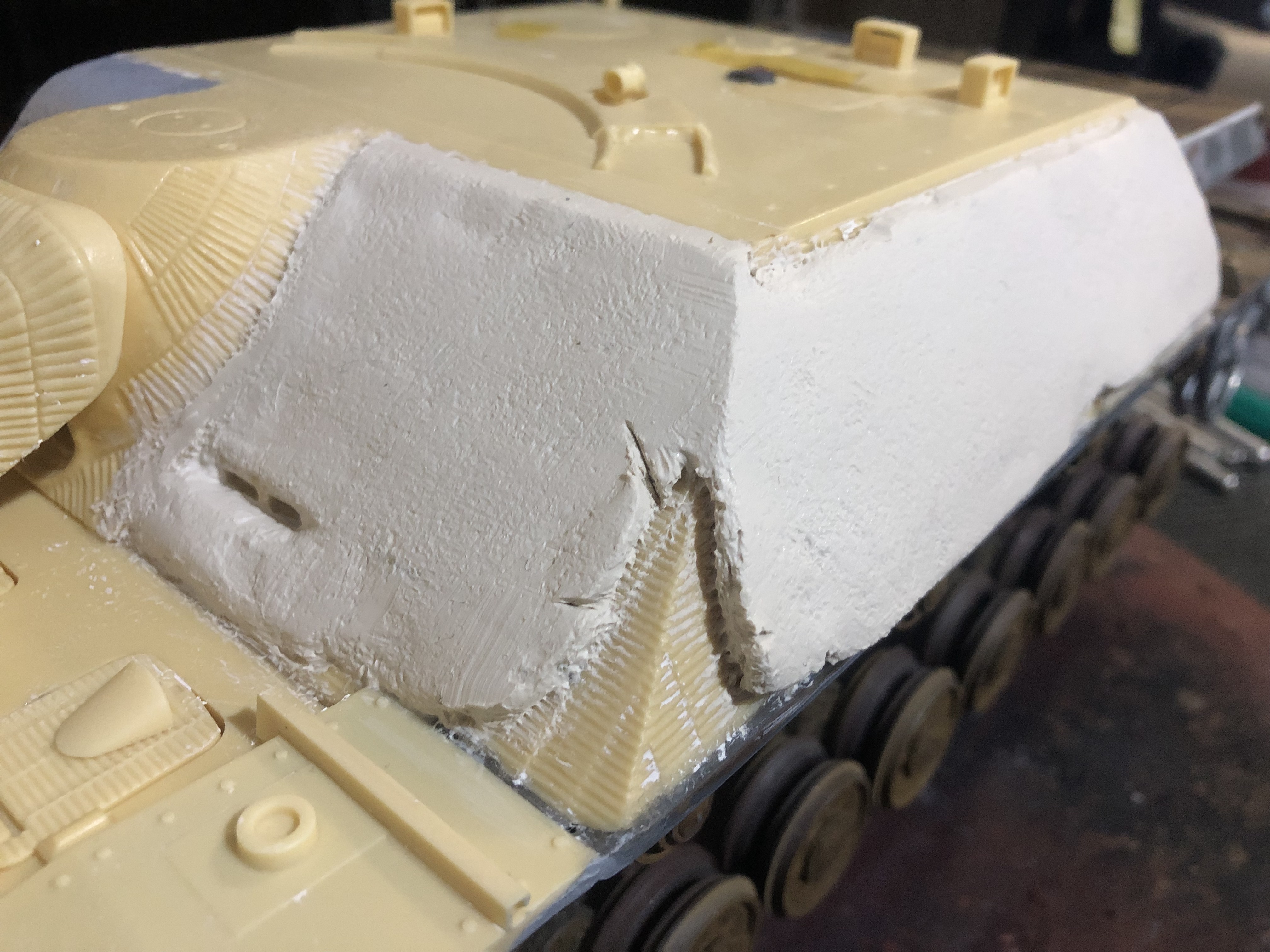

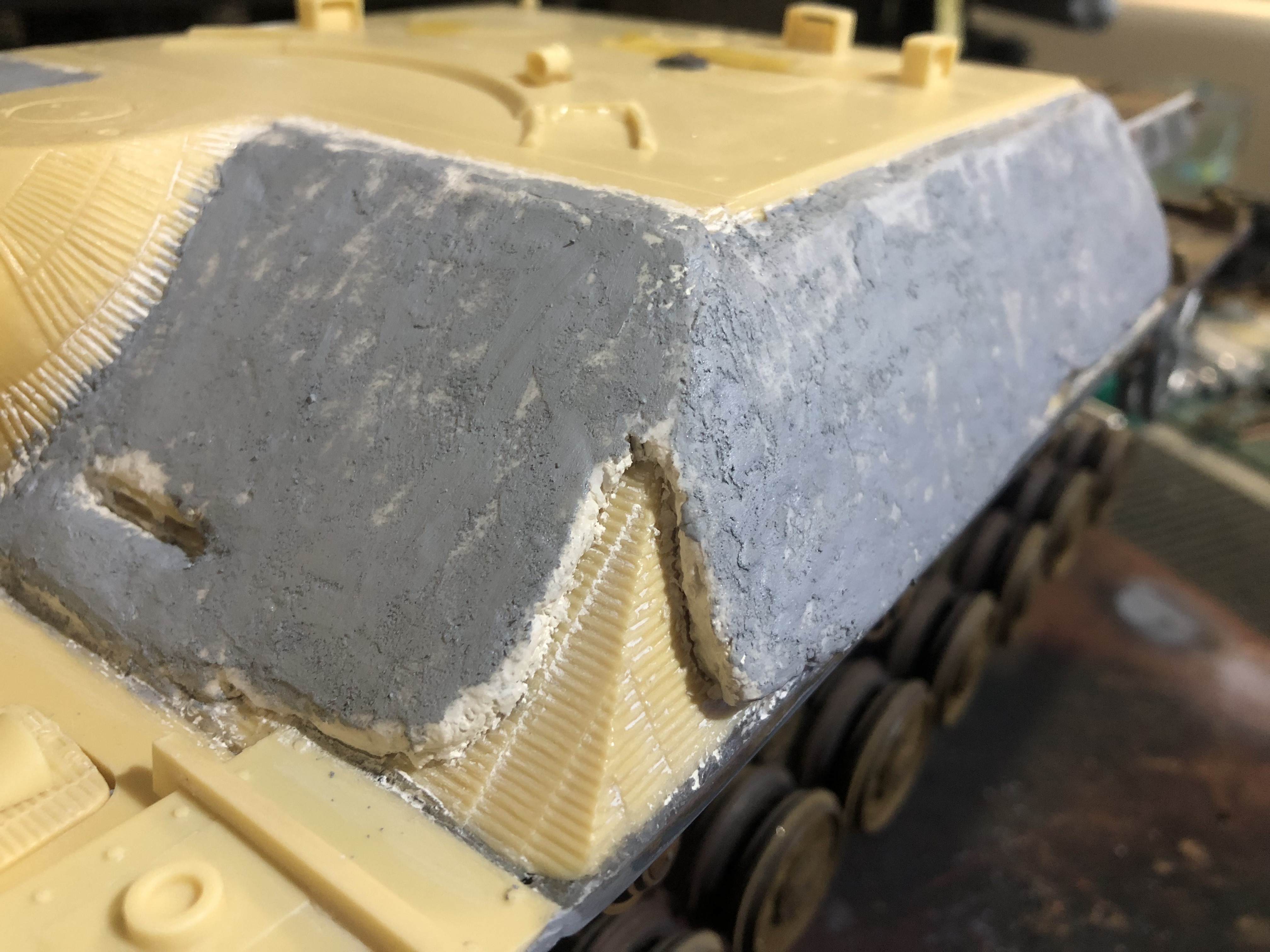

The clay worked good enough as a base. It did suffer a bit of cracking, but nothing that a mix of Mr Surfacer 500 and Tamiya putty couldn't fix on the sections I got done.
Hell of a mess though
..............certainly dont know how the hell that movie Ghost managed to stay clean
It takes a bit of time to dry but hey, at $3 a packet, it works good enough for this kid.
I used 250 grams to do it, thats half a packet, so technically $1;50 AUD to get the effect I wanted.
Of course there is a long way to go until this one is completed, but its really taking shape now resembling the concrete covered oddities that got me interested in the first place.

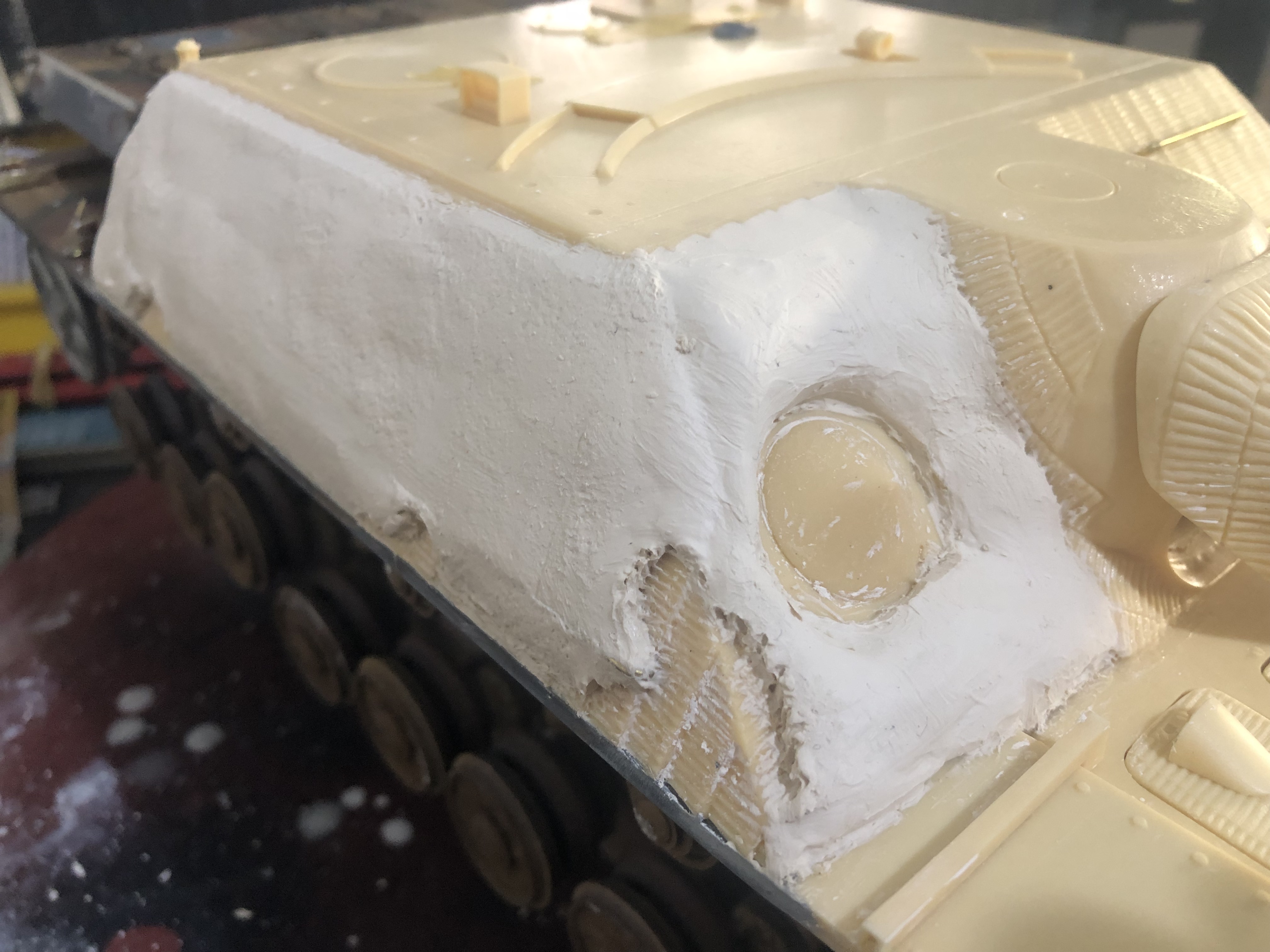

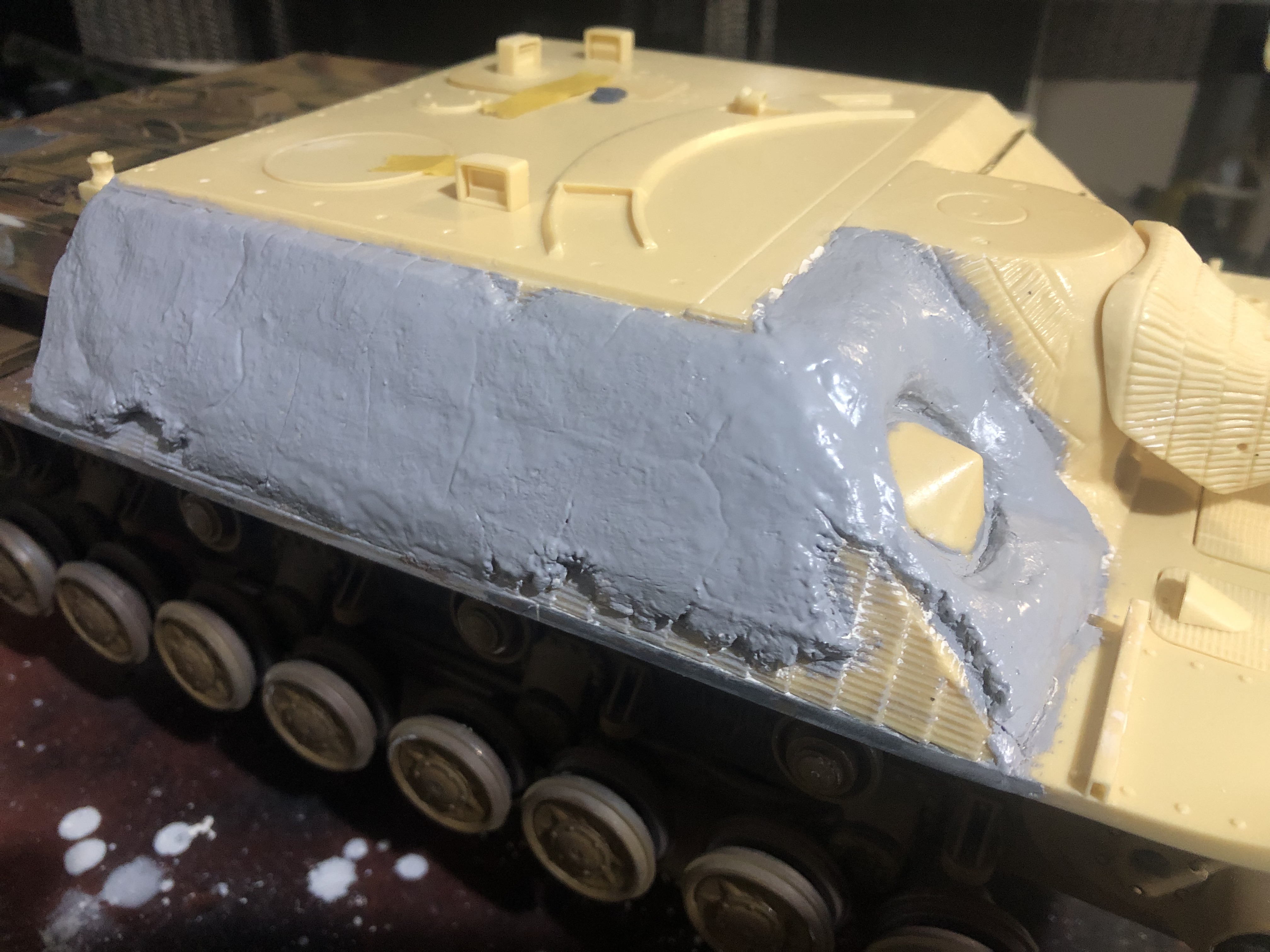

The last of the concrete is on and dry.
I will go back over it all and check the look is right before paint though.
Then it’s on with tool mounting and the rear armour that needs Zimmerit befor fixing in place.
