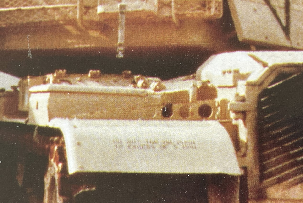

The frontal tow bracket should look like this, image of the AFV Club part and references, to which a shackle or hook is attached to the smaller hole.
1/16 RC USMC M-60A1 US tank with ERA - Build
Screenshot 2 .jpg (158.33 KiB) Viewed 1472 times
Screenshot 3.jpg (339.23 KiB) Viewed 1472 times

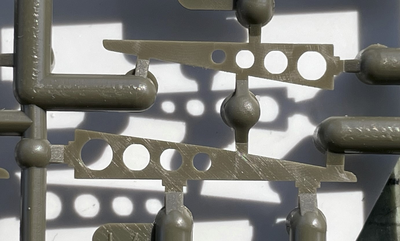

From the AFV CLub kit, these are the other brackets that need to be reproduced.
Screenshot 6.jpg (172.3 KiB) Viewed 1472 times
Screenshot 7.jpg (169.19 KiB) Viewed 1472 times

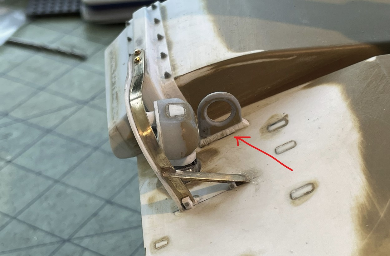

For the hook that goes on the glacis, i was able to cut and reshape the TONGDE part and give it a base.
Screenshot 8.jpg (171.19 KiB) Viewed 1472 times

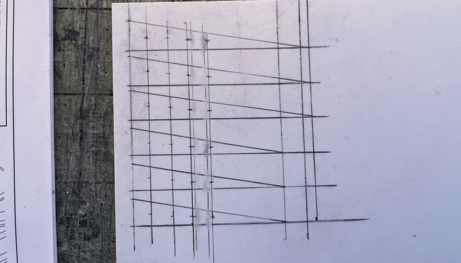

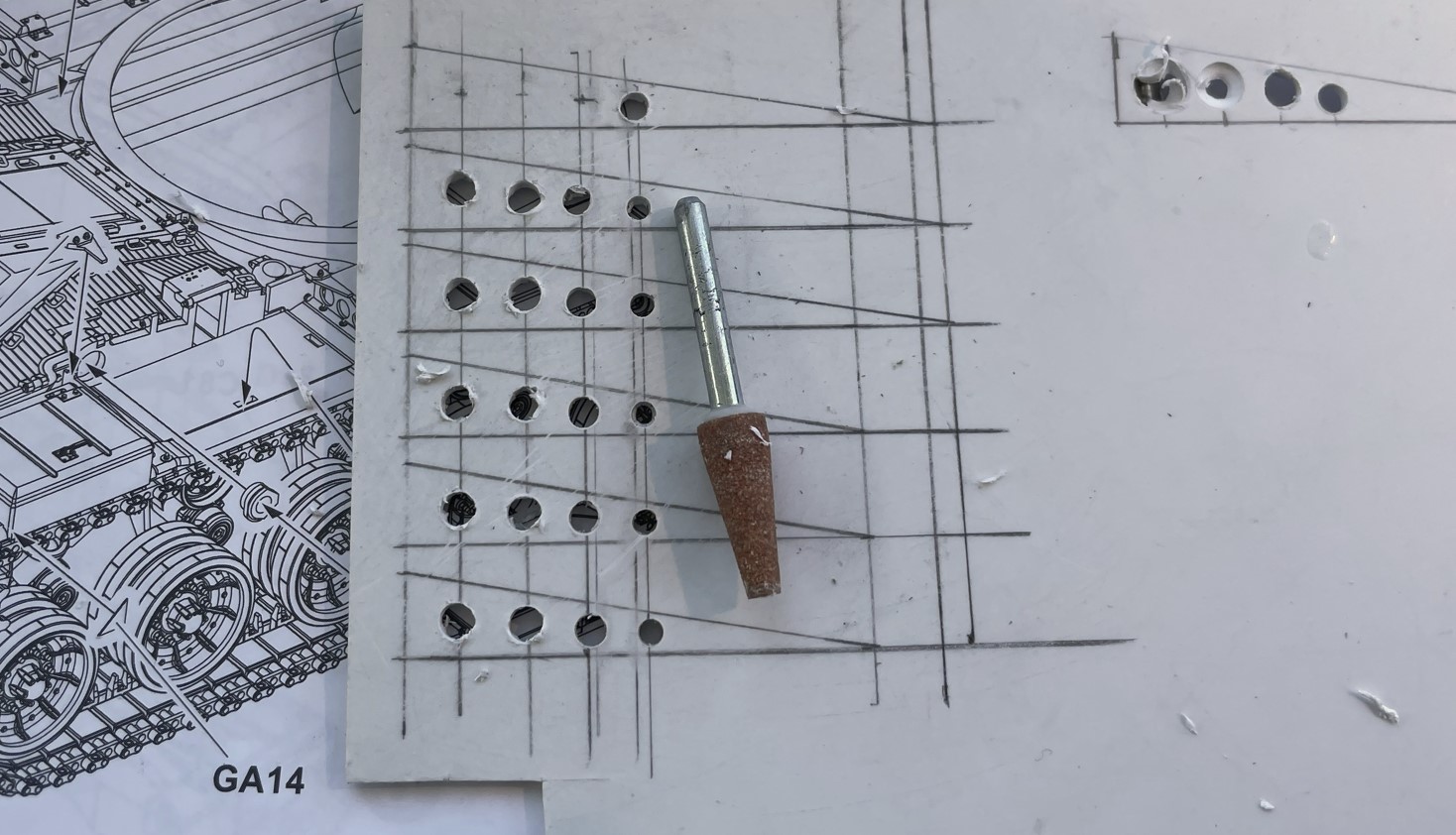

I quickly made a plan and draw a graph for the two types of fender brackets required, with one spare each.
Screenshot 21.jpg (199.53 KiB) Viewed 1465 times

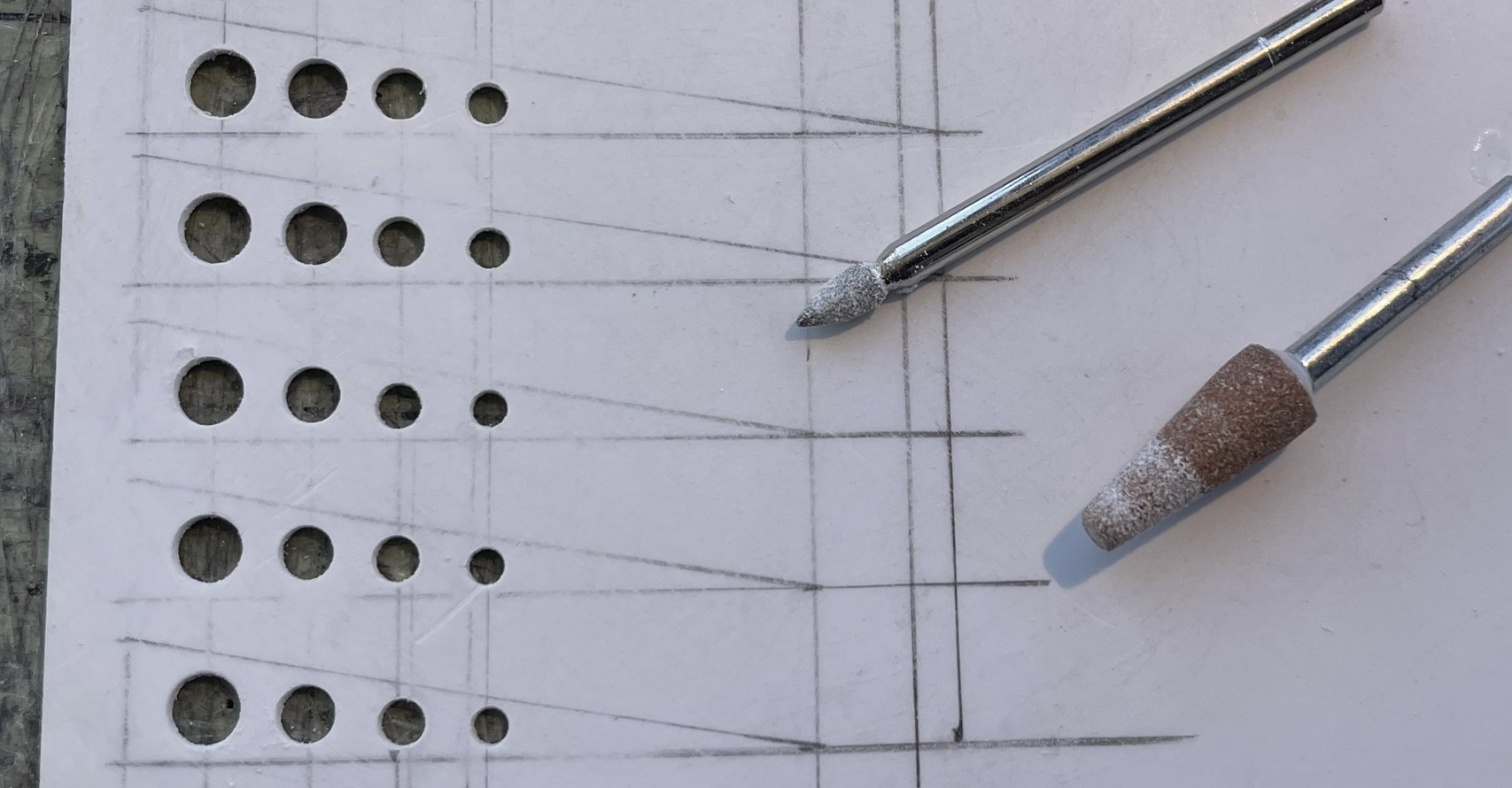

Two smaller drill bits are used to create a small hole approximately where a larger hole should be. Forget about using a full size drill bit to create the hole directly of the right diameter, the large bits will just tear apart the plasticard and you will never be able to do this part.
I used the following method; the larger holes will be created very slowly using the sanding bit that you see on the picture. First attached to the Dremel, then to the drill for slower adjustment. It does not cut the plastic, it kinds of slowly melts the plastic depending on the pressure applied to the V shaped bit, and it does it very precisely and cleanly. When a hole gets towards the right diameter, move to the next, then come back for more adjustments in relation to the 4 holes in sequence. This process took about 30 minutes in total for 4 brackets.
Screenshot 22.jpg (237.96 KiB) Viewed 1465 times

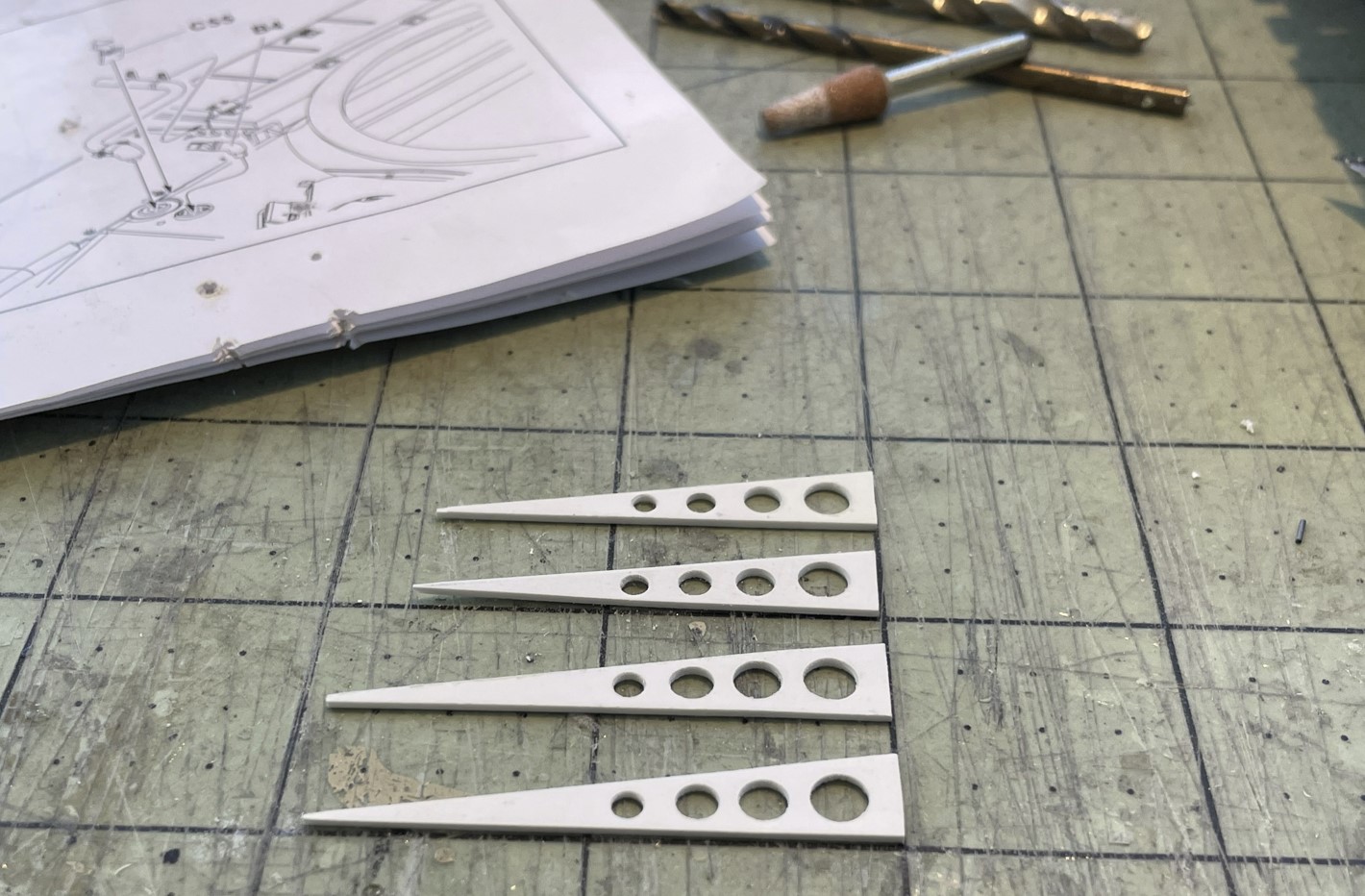

The brackets after more refining, done on both sides. Sometimes, a specific hole needs to be moved in some direction because it is not centered, the correction is done with the bit while each hole is slowly reaching its required diameter. Then the holes are slowly polished by hand on both sides using the bits. These are extremely fragile parts and extra care is needed.
Screenshot 24.jpg (278.41 KiB) Viewed 1465 times

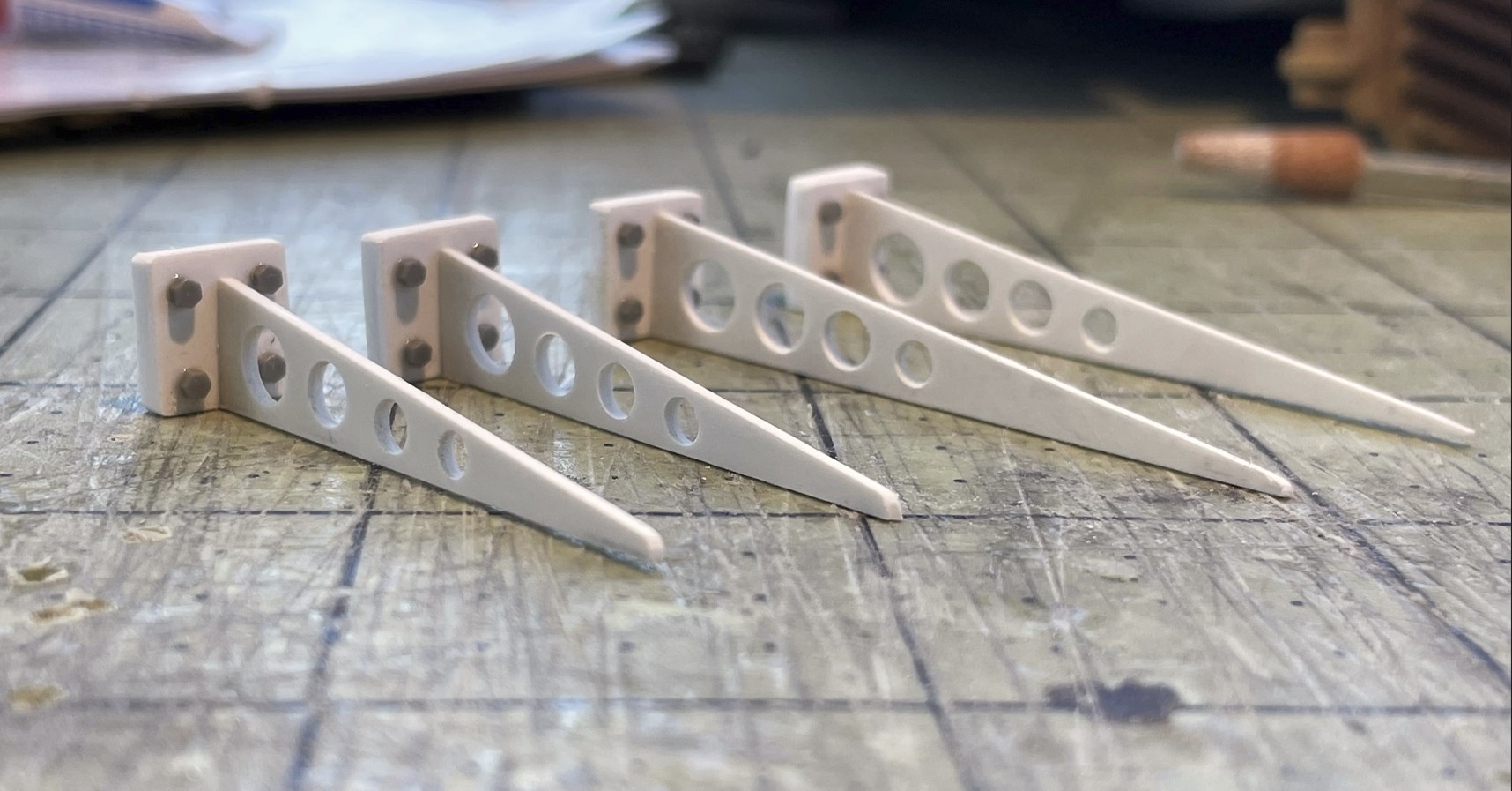

The finished fender brackets ready to be mounted on the hull. They are not perfect but close enough. Someone more patient can achieve perfection.
Screenshot 25.jpg (263.3 KiB) Viewed 1465 times

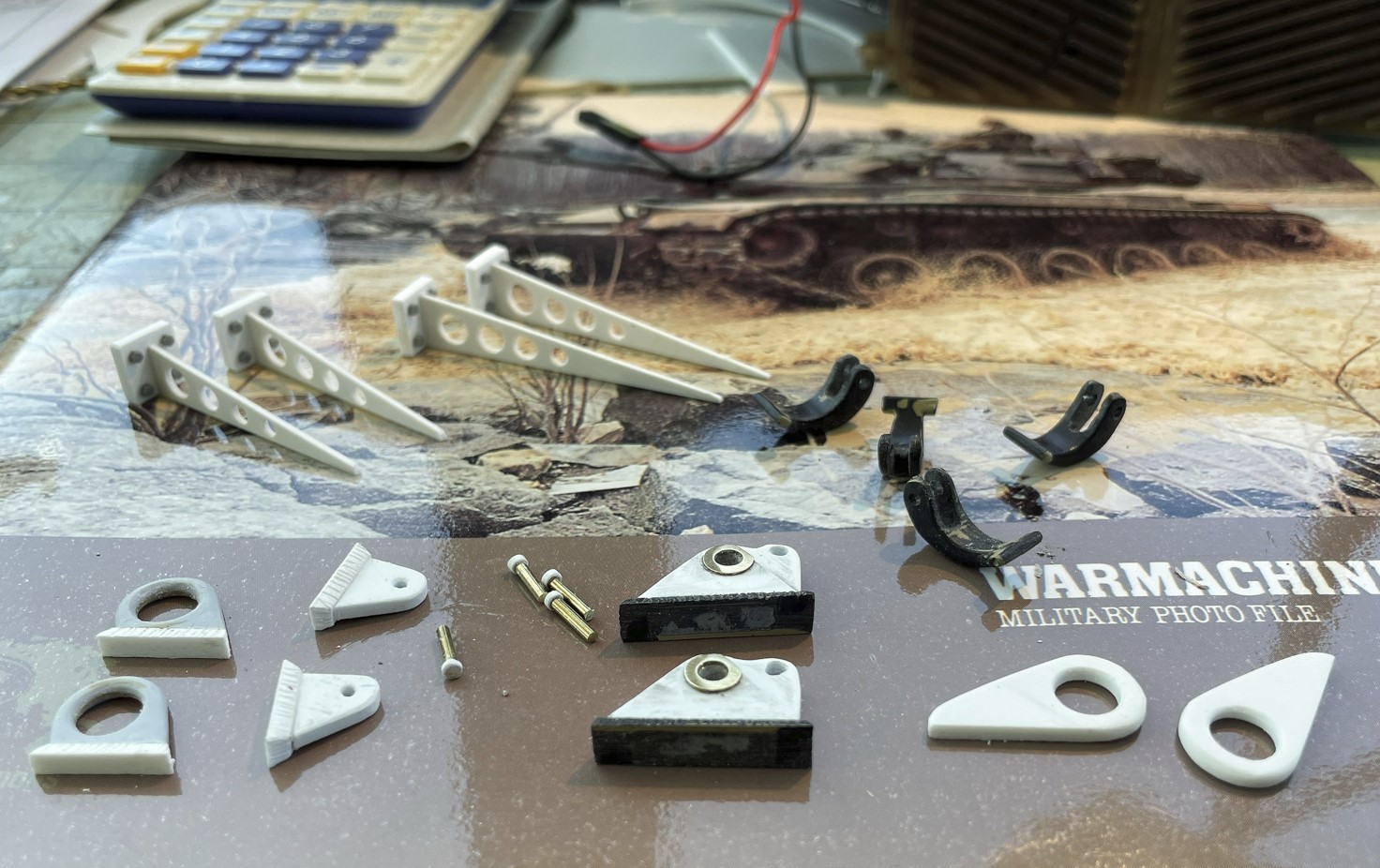

View of all the parts that i created over the past couple of days.
Screenshot 26.jpg (313.36 KiB) Viewed 1465 times

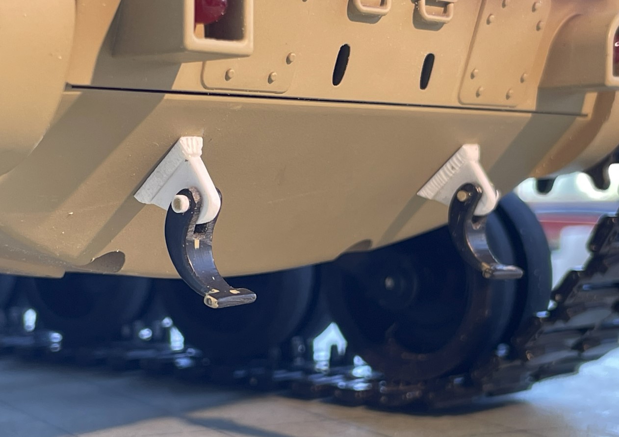

The rear tow brackets and hooks are installed over the holes that were properly located. The hooks are moving loosely.
Screenshot 27.jpg (203.8 KiB) Viewed 1465 times
Screenshot 27a.jpg (146.13 KiB) Viewed 1465 times

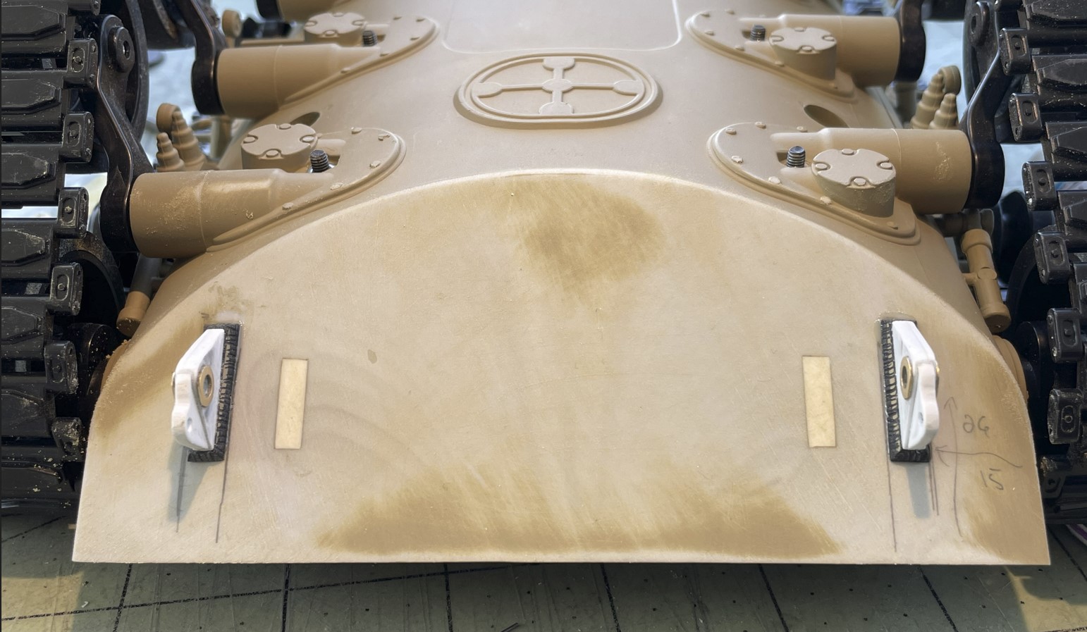

The holes for the frontal tow brackets were badly located. The holes need to be filled, and the brackets positionned like this.
Screenshot 28.jpg (259.7 KiB) Viewed 1465 times

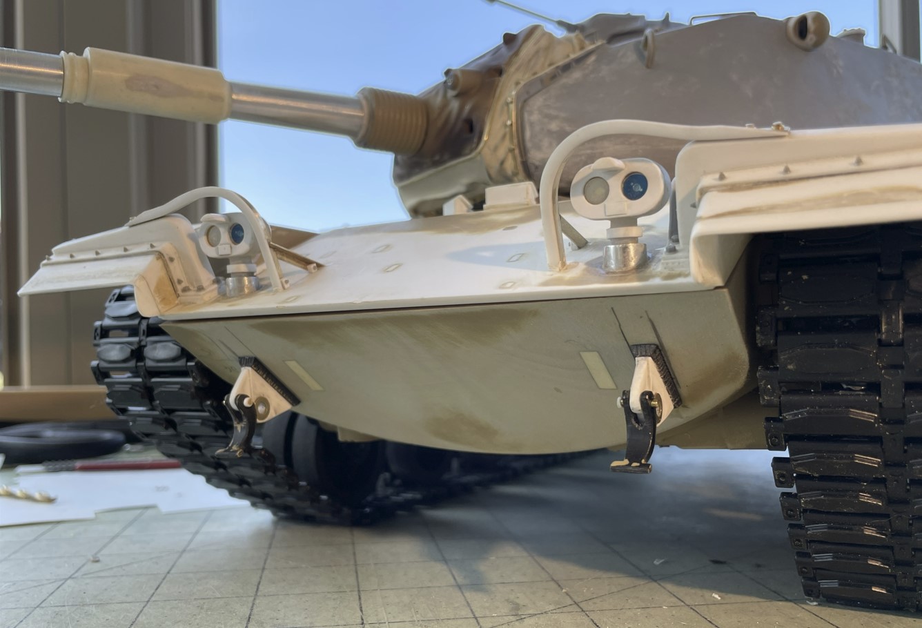

Positioning of the hooks on the glacis.
Screenshot 29.jpg (163.76 KiB) Viewed 1462 times
Screenshot 30.jpg (129.66 KiB) Viewed 1462 times

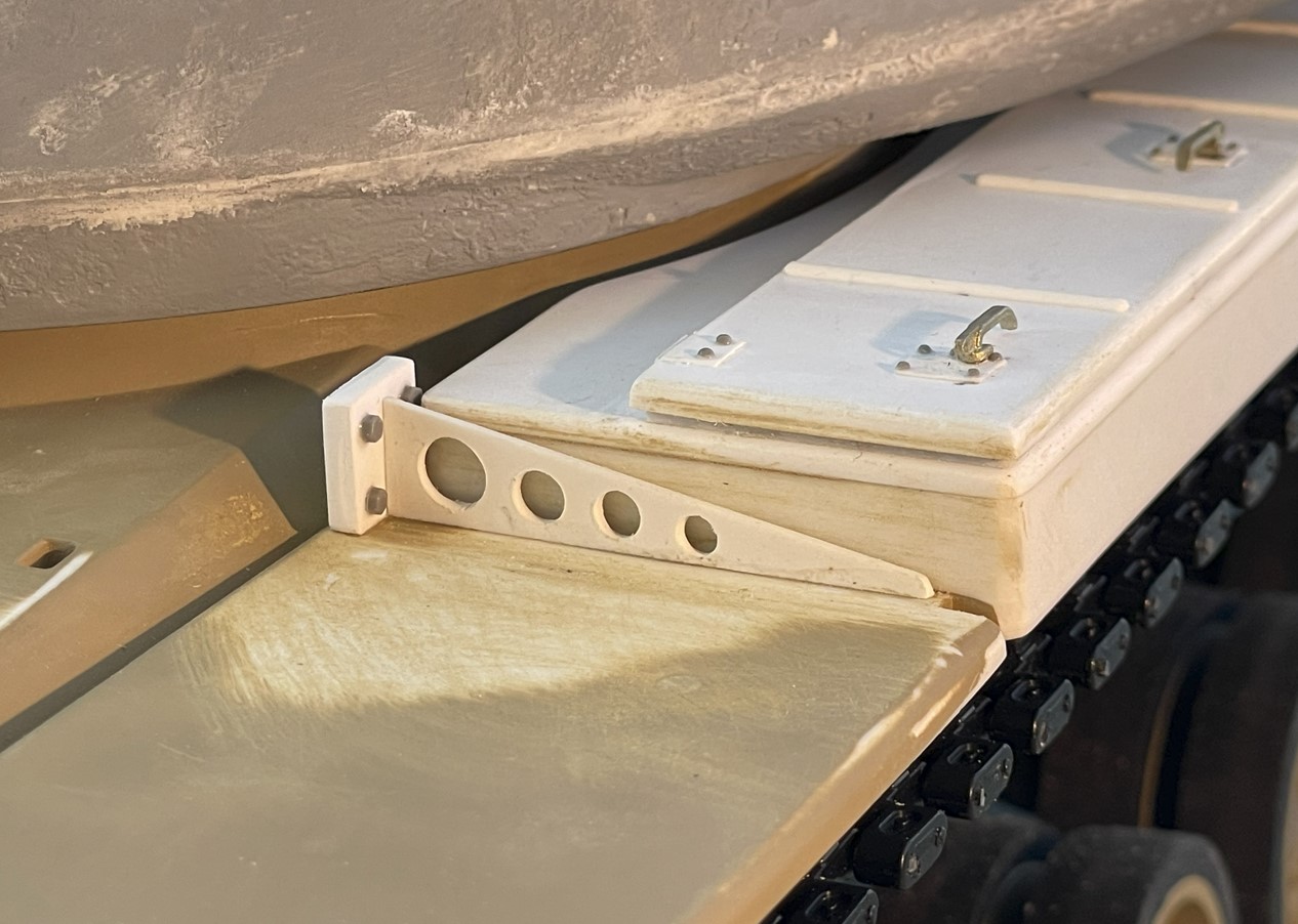

Positioning of the frontal fender brackets.
Screenshot 31.jpg (200.86 KiB) Viewed 1462 times
Screenshot 32.jpg (129.58 KiB) Viewed 1462 times

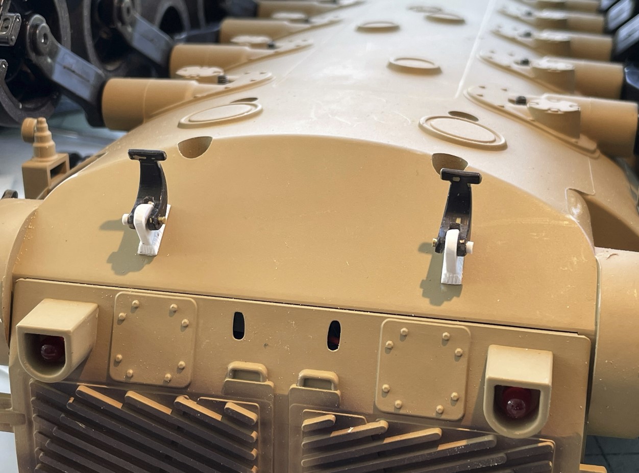

Positioning of the rear fender brackets and engine deck hook.
Screenshot 33.jpg (196.39 KiB) Viewed 1462 times

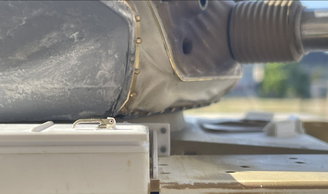

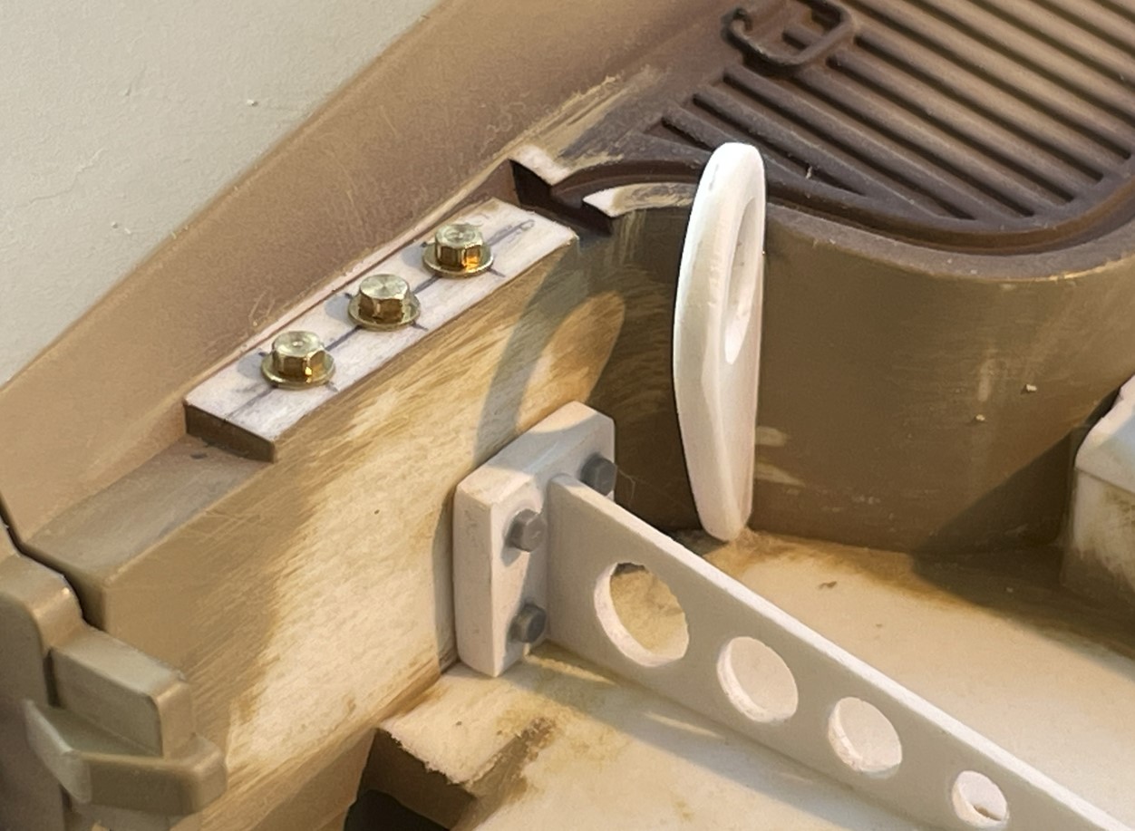

The three large embedded bolts heads for holding the engine deck have been removed.
Screenshot 35.jpg (201.05 KiB) Viewed 1462 times

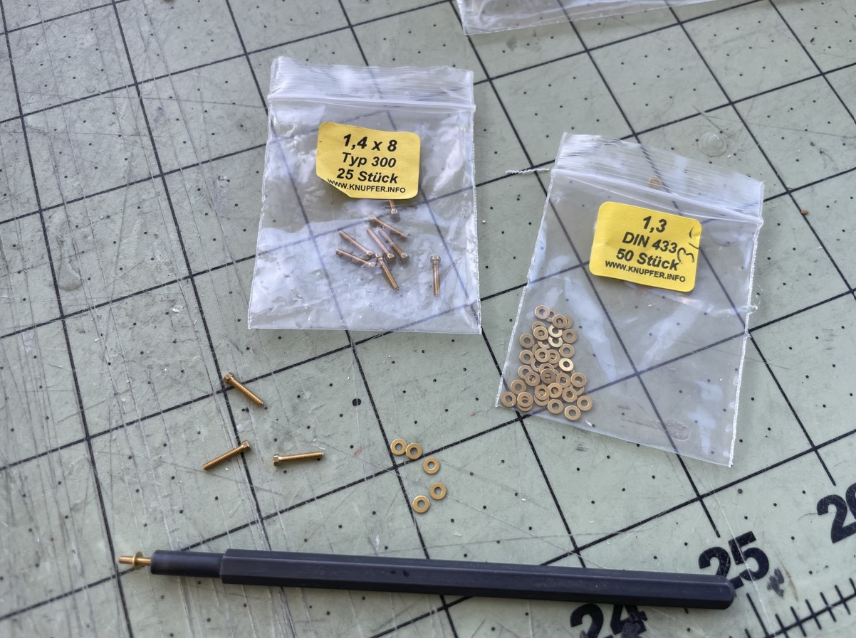

They are being replaced by M1.4 brass hex bolts with washers.
Screenshot 36.jpg (266.52 KiB) Viewed 1462 times
They are removable as i will need to unscrew them later to install the other bracket for the electrical box above the fender.
Screenshot 37.jpg (196.47 KiB) Viewed 1462 times

A couple more pics.
Screenshot 38.jpg (161.11 KiB) Viewed 1462 times
Screenshot 39.jpg (169.39 KiB) Viewed 1462 times
Next step is to continue work on the fenders, taking care of support bracket 2 and 3, plug that hole at the back, put in bolts heads here and there, add some putty, etc. And yes, i am thinking of completely redo the back engine plate.
Screenshot 40.jpg (192.46 KiB) Viewed 1462 times
The model as it stands today.
Screenshot 41.jpg (318.12 KiB) Viewed 1462 times
Regards, Louis

Lovely build, and it's a joy to see new ground being broken with an entirely new manufacturer.
Quick comment on the positioning of the T-hooks. I can only speak for how we did it in the Norwegian army and not how others did, but when out in the field we would usually keep them flipped so they curved downwards on our armoured vehicles. Reason being that is how they must be positioned during recoveries for the loop of the towing straps not to slide off. We would scold crews who did not have them flipped right by the time we arrived to help pull them out of whatever mess they had gotten themselves into.
Pointing upwards is the right way for when the vehicle is strapped down to transport trailers, and that is the chief reason they almost always show up that way both in museums and when they are sitting in depots, because they were transported there.
Having them like on yours is certainly not wrong in that regard, but you might find them less prone to catch on things if flipped around, and it should certainly not be unrealistic for depicting and operational vehicle either.

Panzer Fenris wrote: Fri May 26, 2023 9:10 am Lovely build, and it's a joy to see new ground being broken with an entirely new manufacturer.
Thanks for your insight. I was curious and checked again my references for any pictures of M-60 with flipped T-hooks. It must not be a process in the US Army. What i saw earlier is that for about half the time, these T-hooks are replaced by shackles. If you have any picture with flipped T-hooks, it would be appreciated.
thanks, Louis
Screenshot 50.jpg (314.56 KiB) Viewed 1421 times

lmcq11 wrote: Fri May 26, 2023 11:31 am Thank you Tiger Rampage and Panzer Fenris.
thanks, Louis
I have looked around a little, and yes having those hooks flipped by default seems to not be a thing within the US military. I guess they spend more time driving where there's not much risk of bogging down in marshland or deep snow, and just don't consider it worth it before they need it.
The shackles have also been noted. Can be a switch that happened during the M60's lifespan, because on the M1's I haven't found any with T-hooks instead of shackles.
In the video I linked below they even borrow a T-hook from the Norwegian ARV for the recovery. (Guy telling them to put it on at 0:28 is actually my old CO. Good chap).
