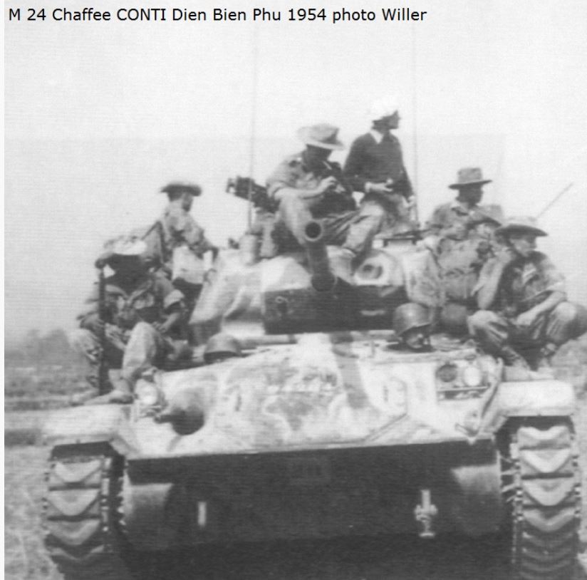

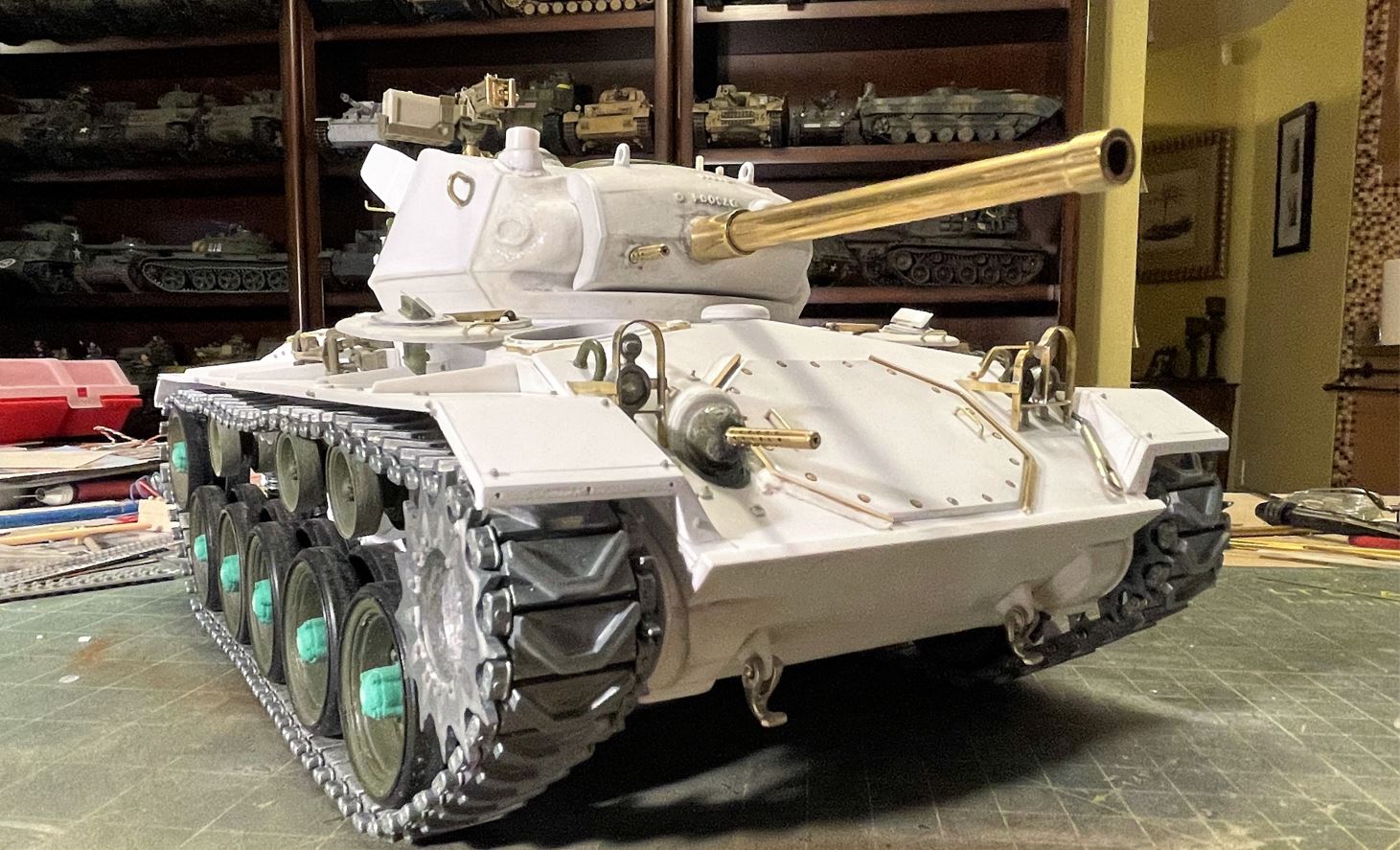

Hi Barry, yes, i think so. The tanks were delivered brand new by the Americans in Haiphong, dismantled, flown in parts and reassembled on site. After some time but before the battle started, they were camouflage with yellow paint and local dirt. Then each tank was heavily hammered and damaged during the two month battle. It might not make a pretty sight if i go too far in time. I therefore have to decide at which period i will represent the model. You know my style, i am not very good with mud and dirt...
The construction of the M24 Chaffee is completed, well... still missing the tie downs, first aid kit and some stuff loaded on the vehicle by the crew.

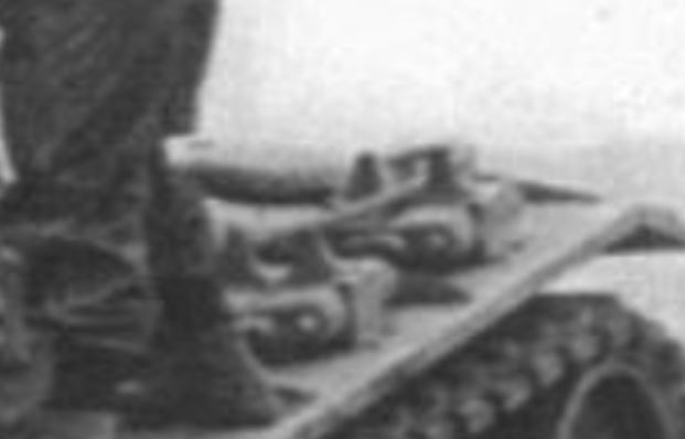

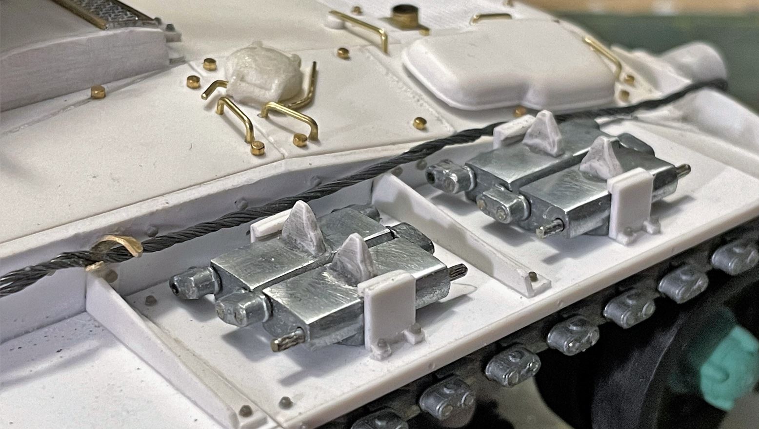

There seems to be many spare tracks variations on the M24, in style and location. View of the spare tracks and holders that are difficult to analyse on the left fender of Conti. Looks like the other tanks at Dien Bien Phu did not have these.

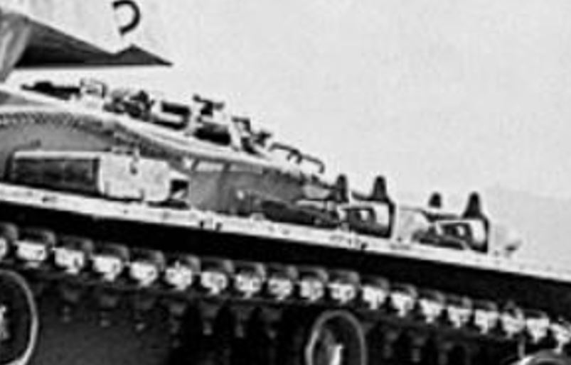

This view provided extra details, every bit of shade means there is something there.

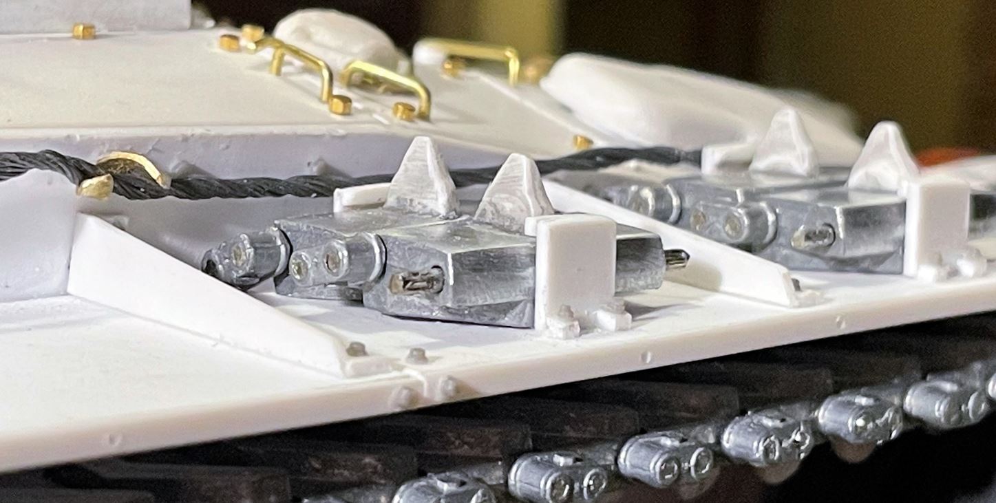

I tried to reproduce what i saw. The spare tracks themselves are the same as the ones used to run the vehicle, modified Heng Long metal Sherman double pin tracks.

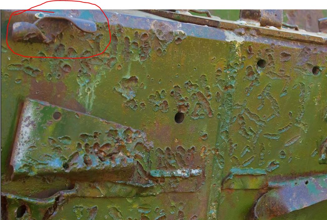

Modern view of a Chaffee left fender wreck still at Dien Bien Phu, only the broken fender supports remain visible. Notice the coiled bracket on the top left that held the tow cable, running along the fender from the rear shackle to the front glacis. Also notice the damage from small arms fire on the side armor, a silent testimony of the ferocious two month battle where the Chaffee were sent daily to every hot areas.

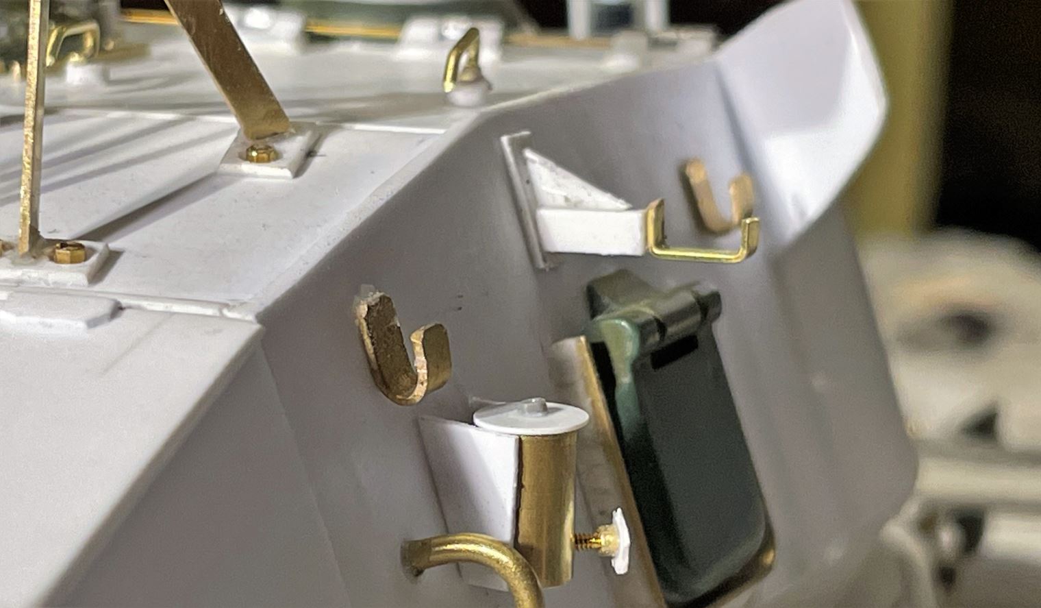

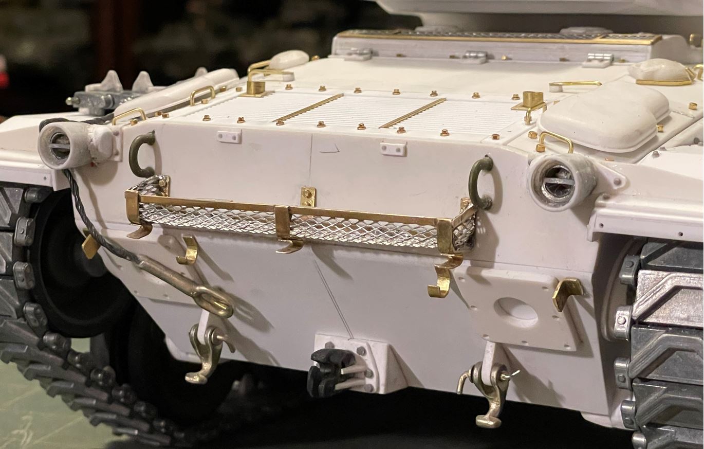

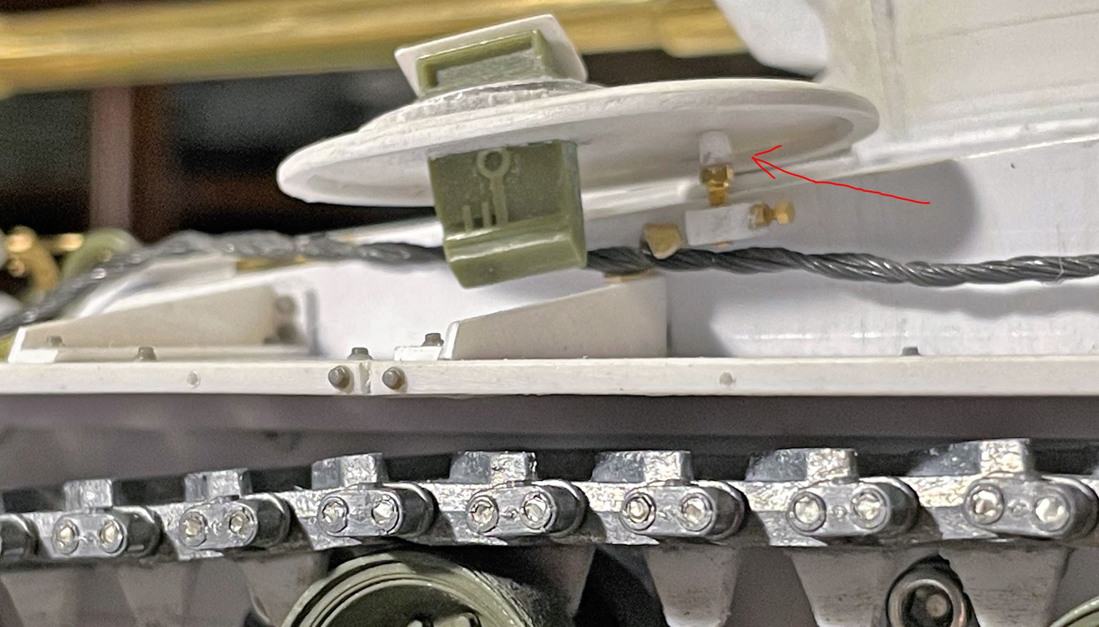

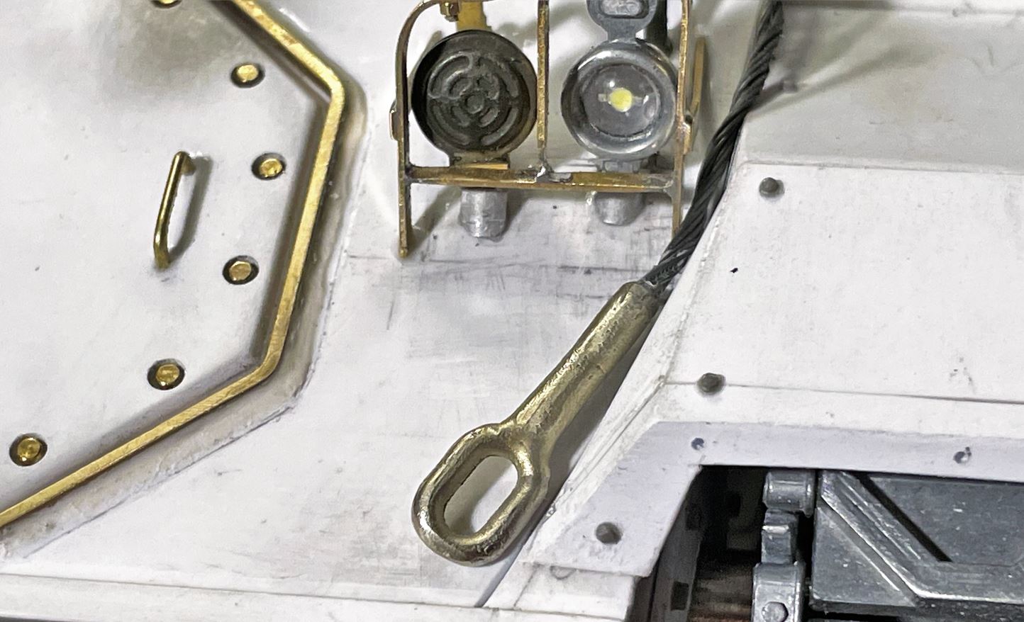

The tow cable is installed, i tried to repro the coiled brackets on the right, seen on previous picture.
RC 1/16 M-24 Chaffee light tank- Dien Bien Phu 1954 - Build
The metal tow cable connectors come with the AFV_Model M26 Pershing shackles set. Looks like the French simply deposited it on the glacis.
At the rear, the tow cable has a curved pin coming out that serves as anchor point.

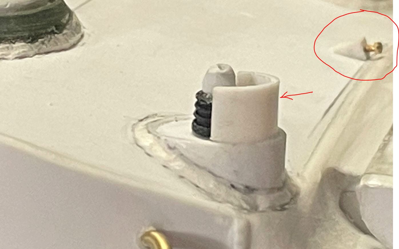

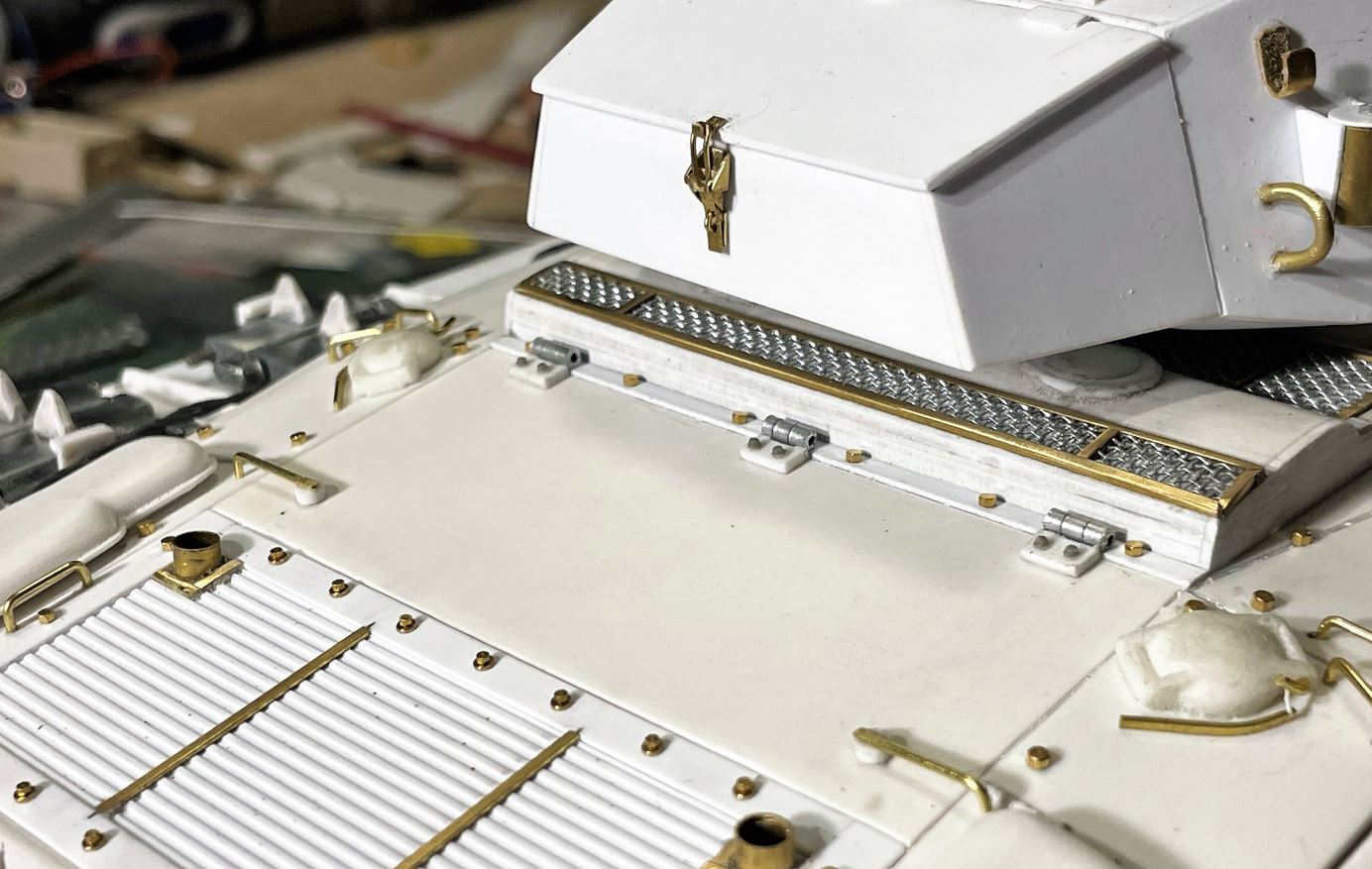

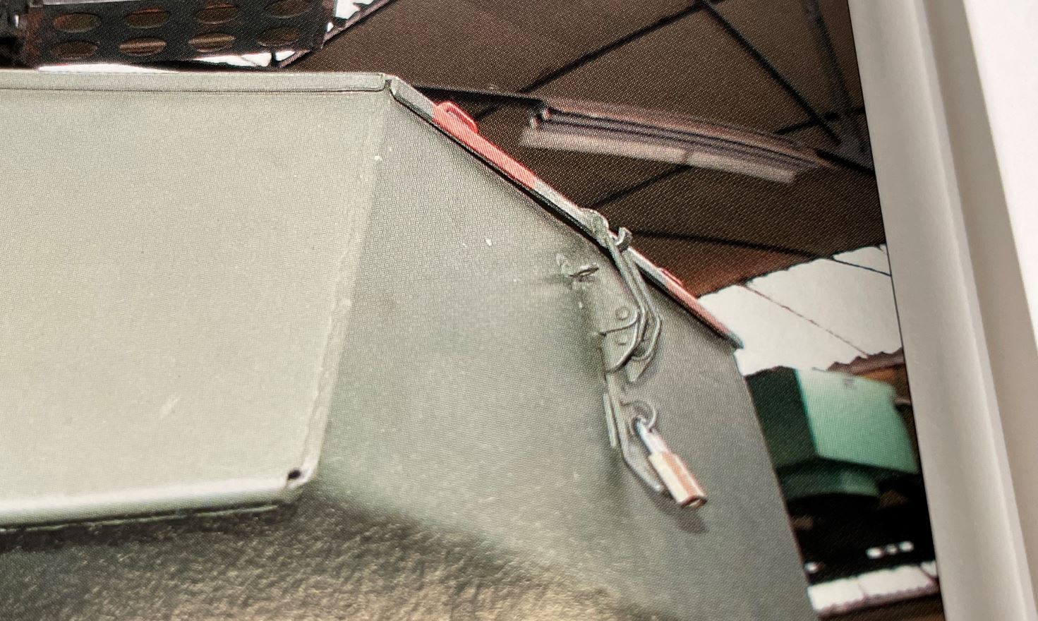

View of the turret rear bin locking latch. This is always complicated.

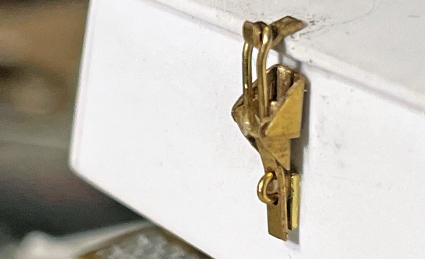

The turret rear bin latch was reproduced in brass strips and a 0.5mm rod. Also notice the hinges and the locking handles that were installed on the middle deck panel.

Close up on the latch, second attempt at it, done on a best effort basis. First attempt material used was too thick. Looking big here but it's really small even in 1/16 scale. When such thing is being built, its only through close up pictures that you really see the results for the first time. Not bad for a one hour job, after the experience of the first attempt, even at extreme close up like this. I can see that some improvements can still be done with a cooler head.

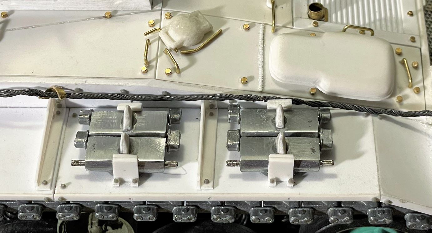

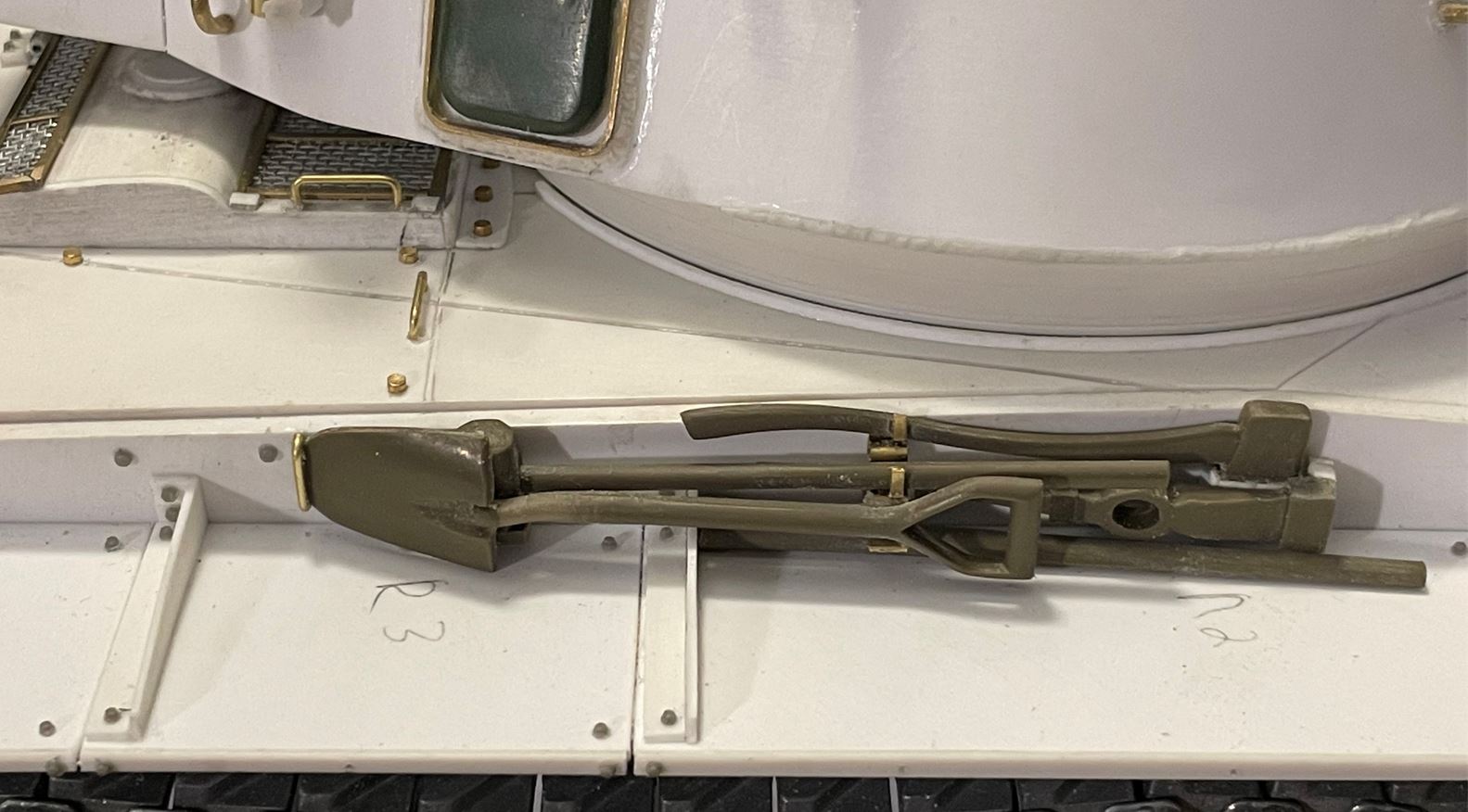

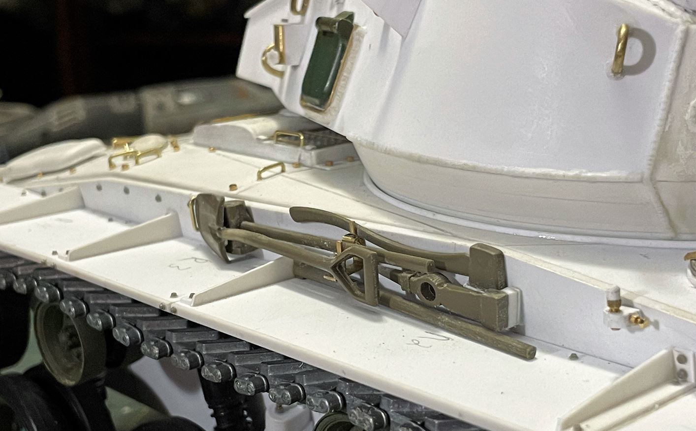

The tools are located on the middle of the right fenders. Reference pictures of the tool mounting are rare. I have two Chaffee walk around books and none of these guys could take a single close up picture of it... These are Tamiya Sherman tools, looks like a very good match. The sprue was purchased separately from AAF museum. Notice the small apparatus on the right of the tool which is a support for the front hatches on each sides when opened.
There is a three level brass bracket in the middle, each tool is installed in a specific sequence.

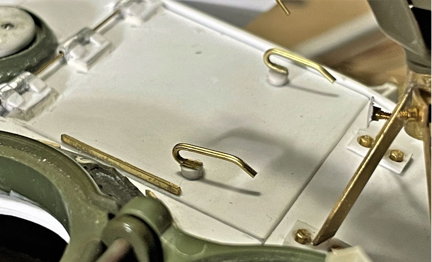

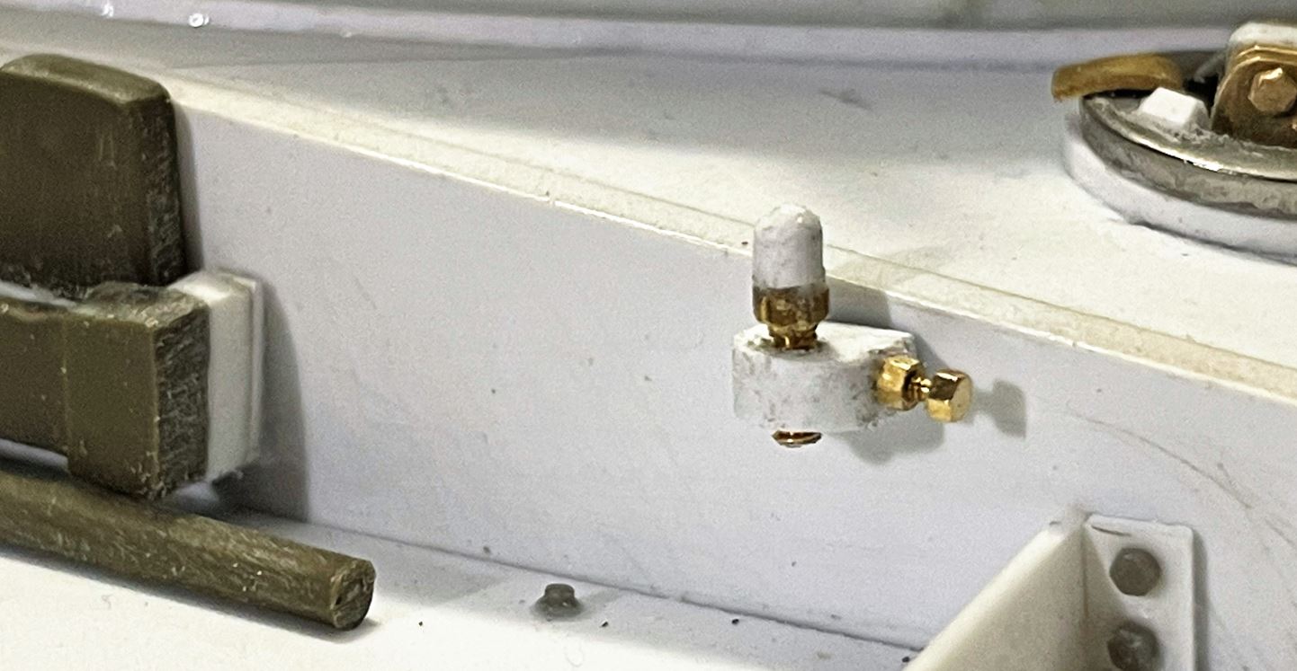

Close up on the hatch support. The middle pin is actually an M1.4 bolt, the height is therefore adjustable like the real thing by turning it. The side pin is to keep the main bolt from moving and is an M0.8 bolt with nut.
When the front hatches are opened, they rest on it.

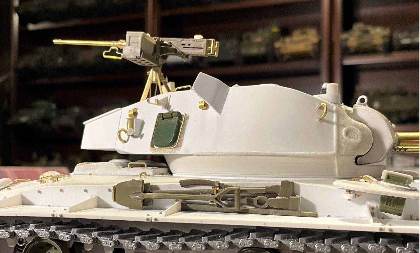

A large bracket seen in references was added to the right side of the turret. The two smaller brackets just under it is to store the M2 barrel when unscrewed from the body. The cylinder at the bottom is to hold the M2 cradle upward when dismounted from the top of the turret and my guess is that the M2 body rests on the large bracket when still attached to the cradle. The small shield at the front gives some frontal protection to the dismounted M2.

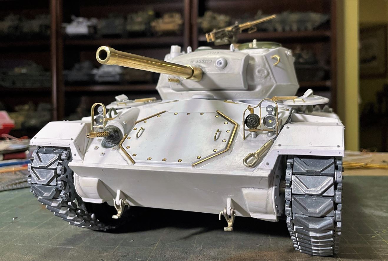

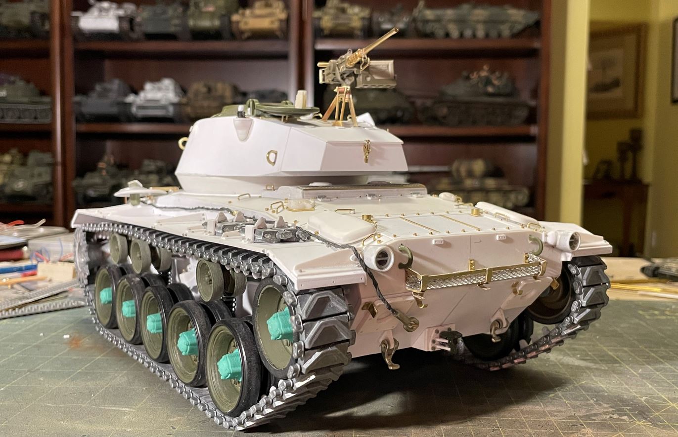

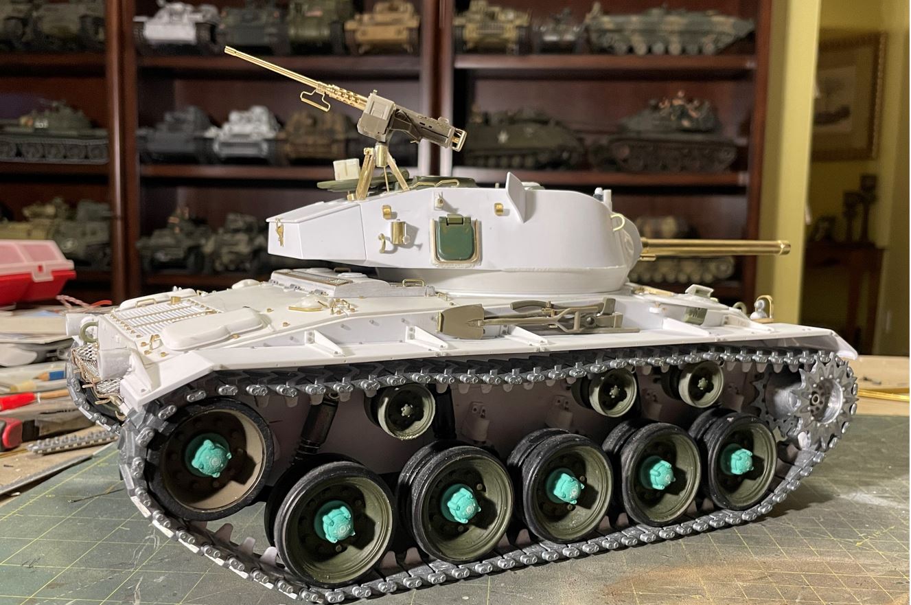

Overview of the model, now real close to the finish line.

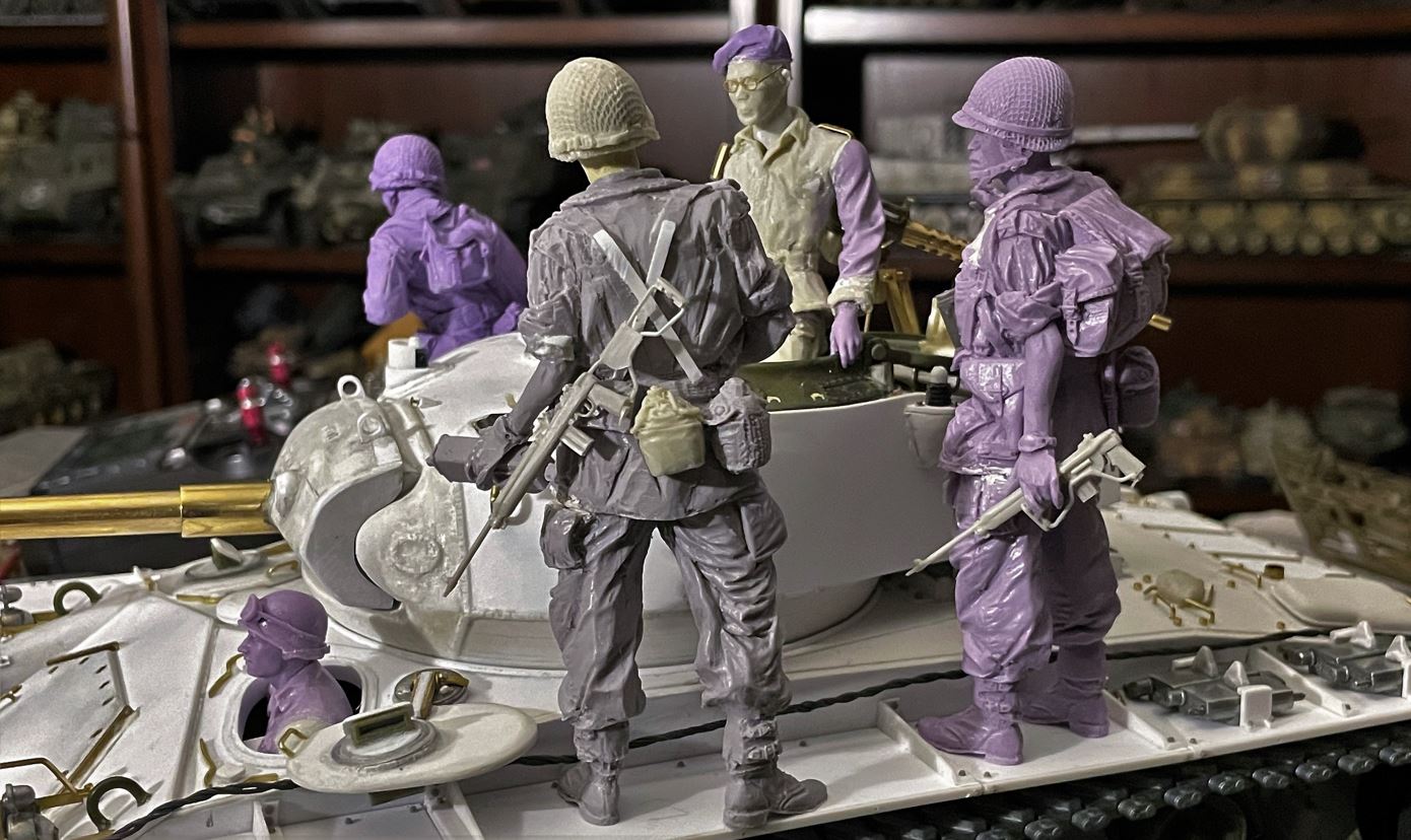

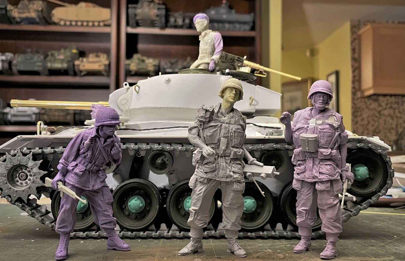

Next step, the tank commander, a couple of French Foreign Legion paratrooper riders, and maybe a driver.
Regards, Louis

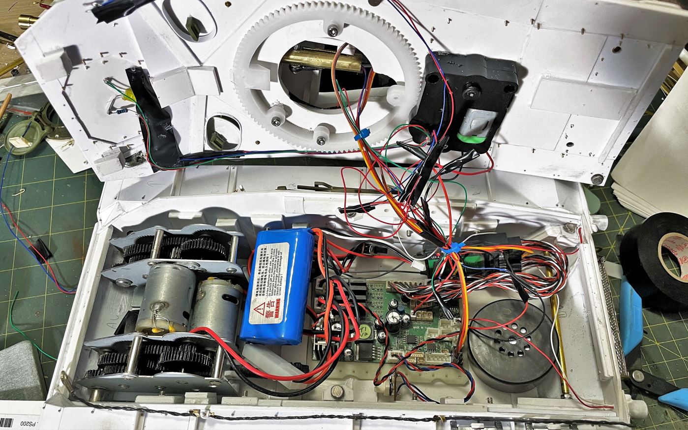

LEDs and all electronics are installed. Here is a view under the hook. The control board used was changed to the TK-60 because of the need for the two machine guns.
And here is a short video of the weapons testing.

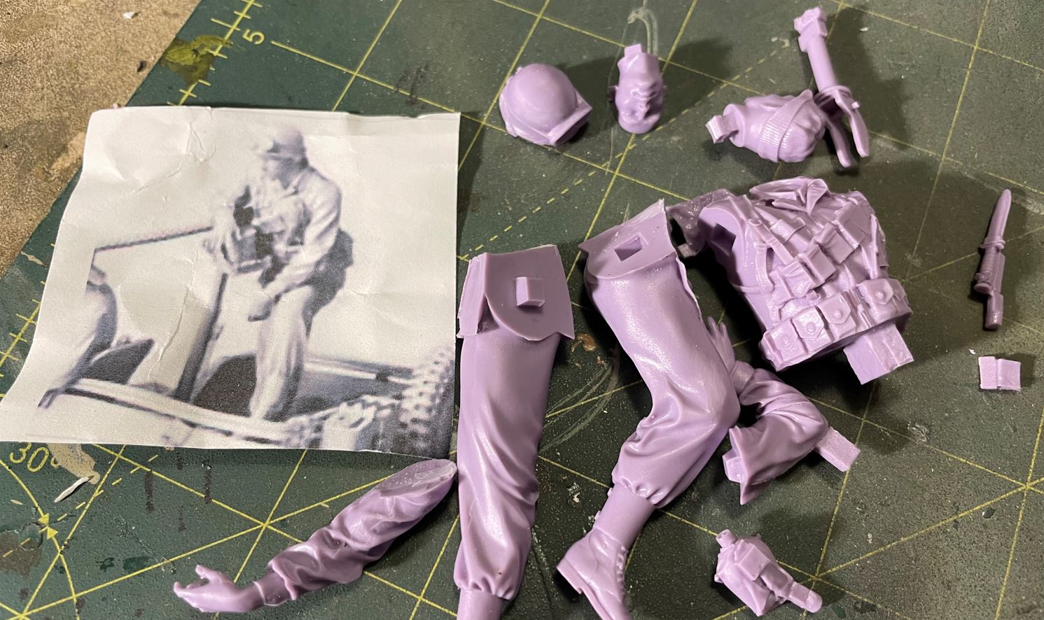

On eBay, there is a Chinese seller that sells two 1/16 resin figures of French soldiers in Indochina. These are likely copies of some other international brand. I purchase 2 sets of both as raw material for this build.

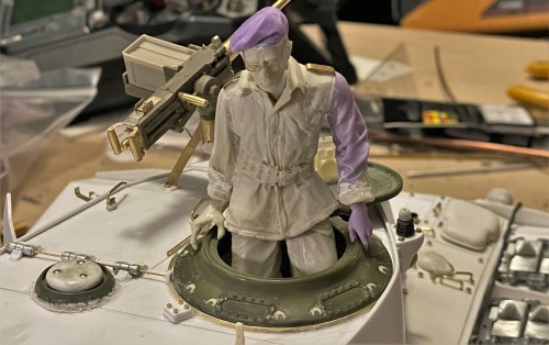

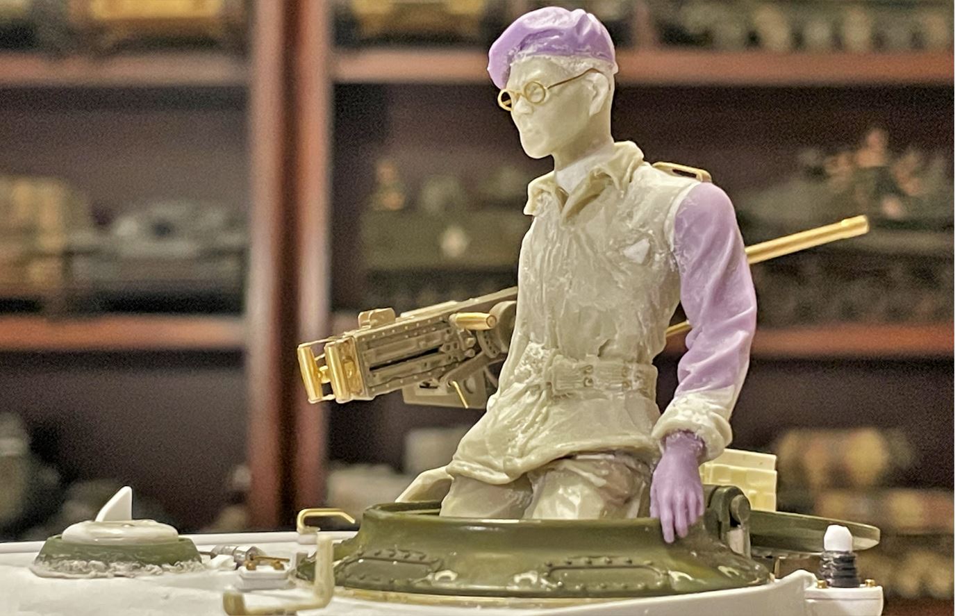

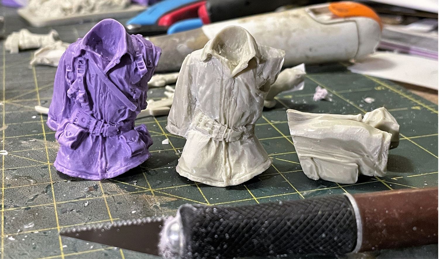

First task for the Tank Commander is to create a combat tunic, but without the webbing and equipment. I therefore removed these using a scalpel, and redrawn lines.
And plugged the holes for the equipment.

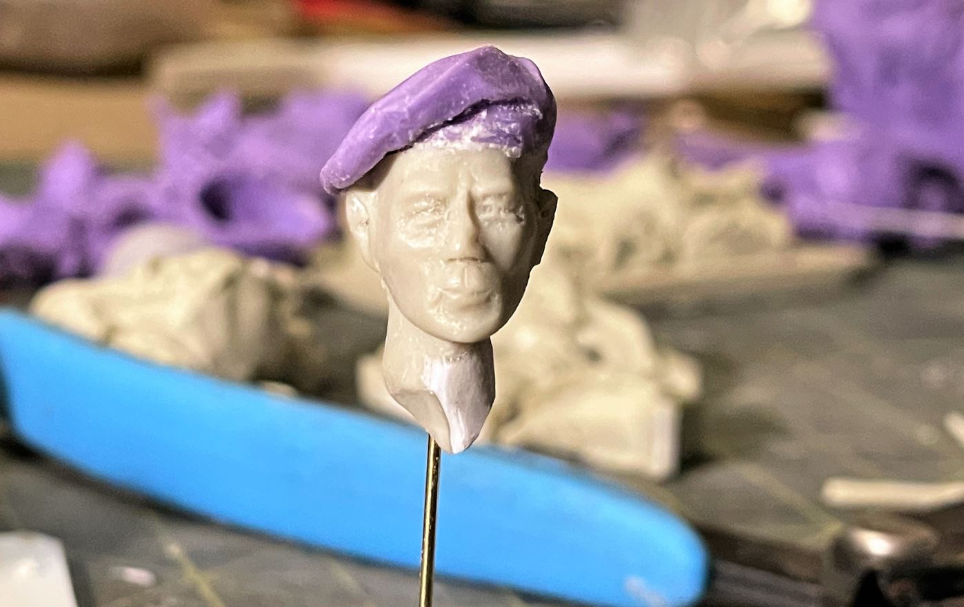

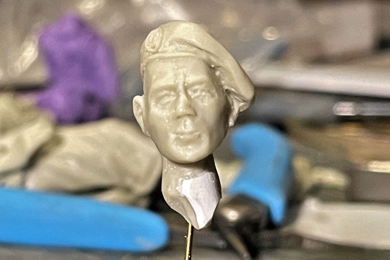

It has the head of a Foreign Legion soldier but can it be made to look like Hervouet of the 1st RCC. He has a beret but it is worn the way Foreign Legion wears them, meaning on the wrong side compared to the way the 1er RCC wears them. You can compare to the first picture above.

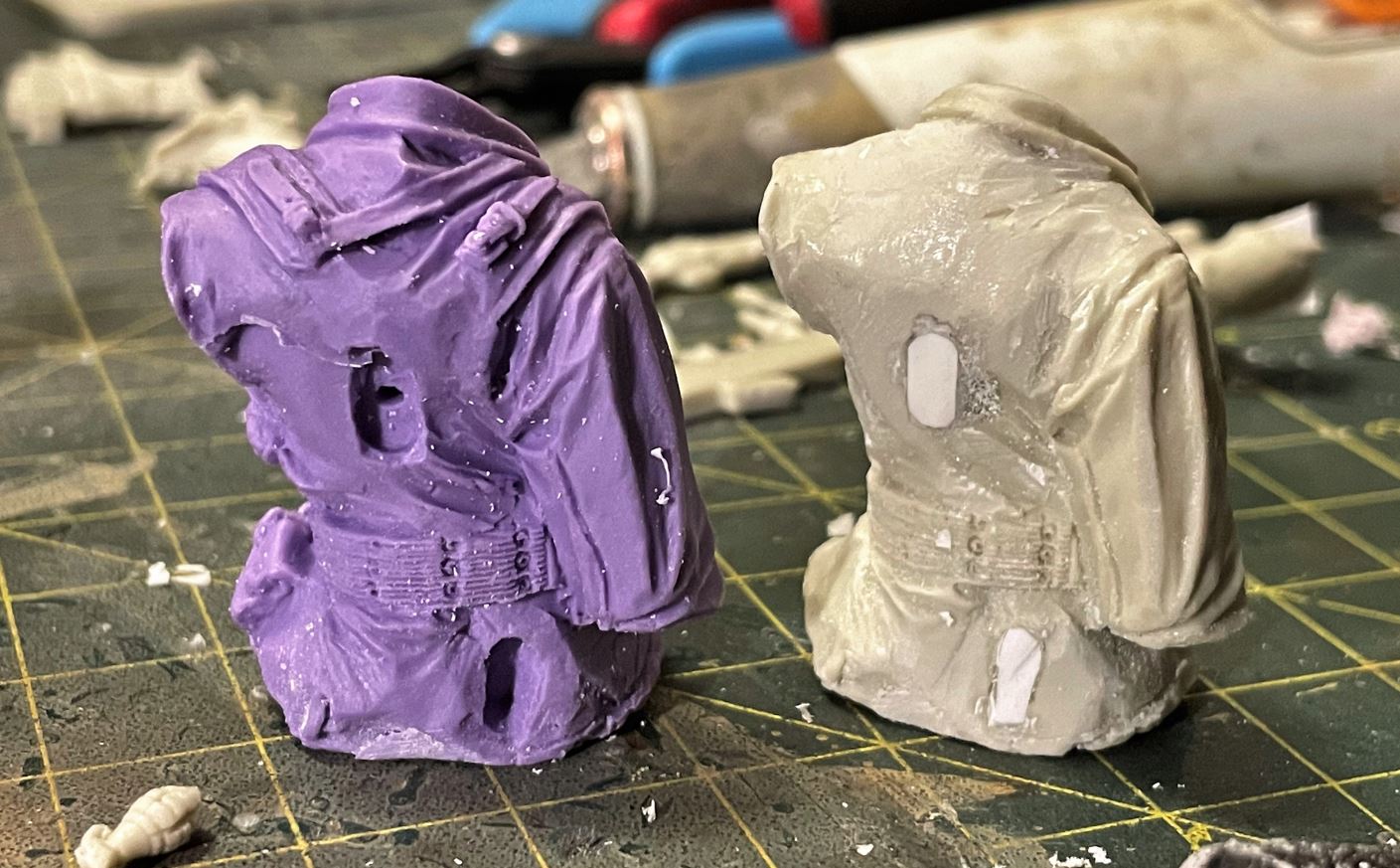

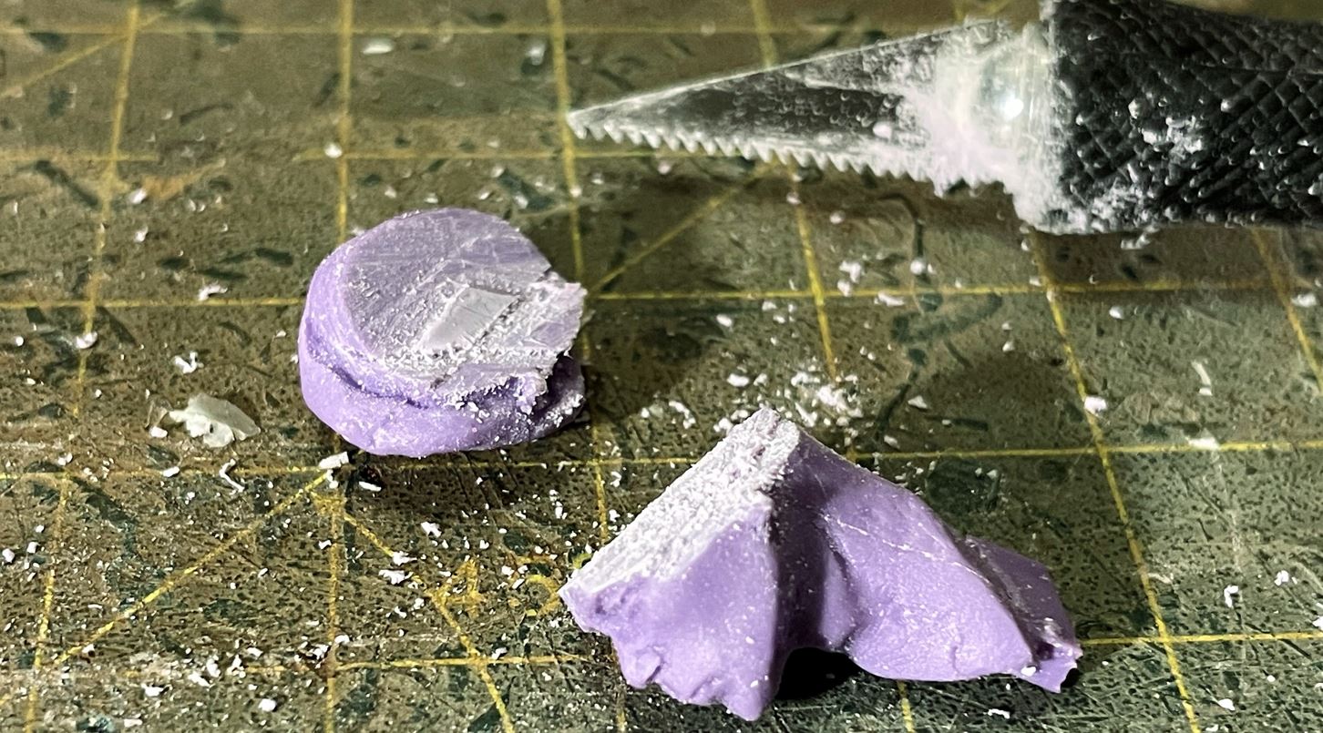

As veterans would surely notice or be insulted, this need to be fixed. As i have two sets of the same figure but won't be using the same face, i can therefore takes an intact beret from one figure, flip it around, and put it on an intact head of the other. Here, the beret is being removed.
And then put on the figure after some finetuning. Now this looks like a 1st RCC tank man. The neck was also modified to have the head face strait ahead and not turned sideways.

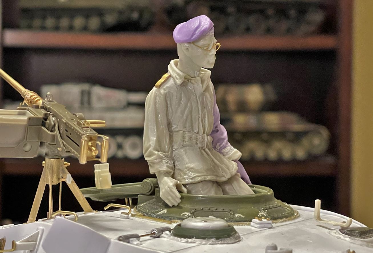

Re: RC 1/16 M-24 Chaffee light tank- Dien Bien Phu 1954 - Bu

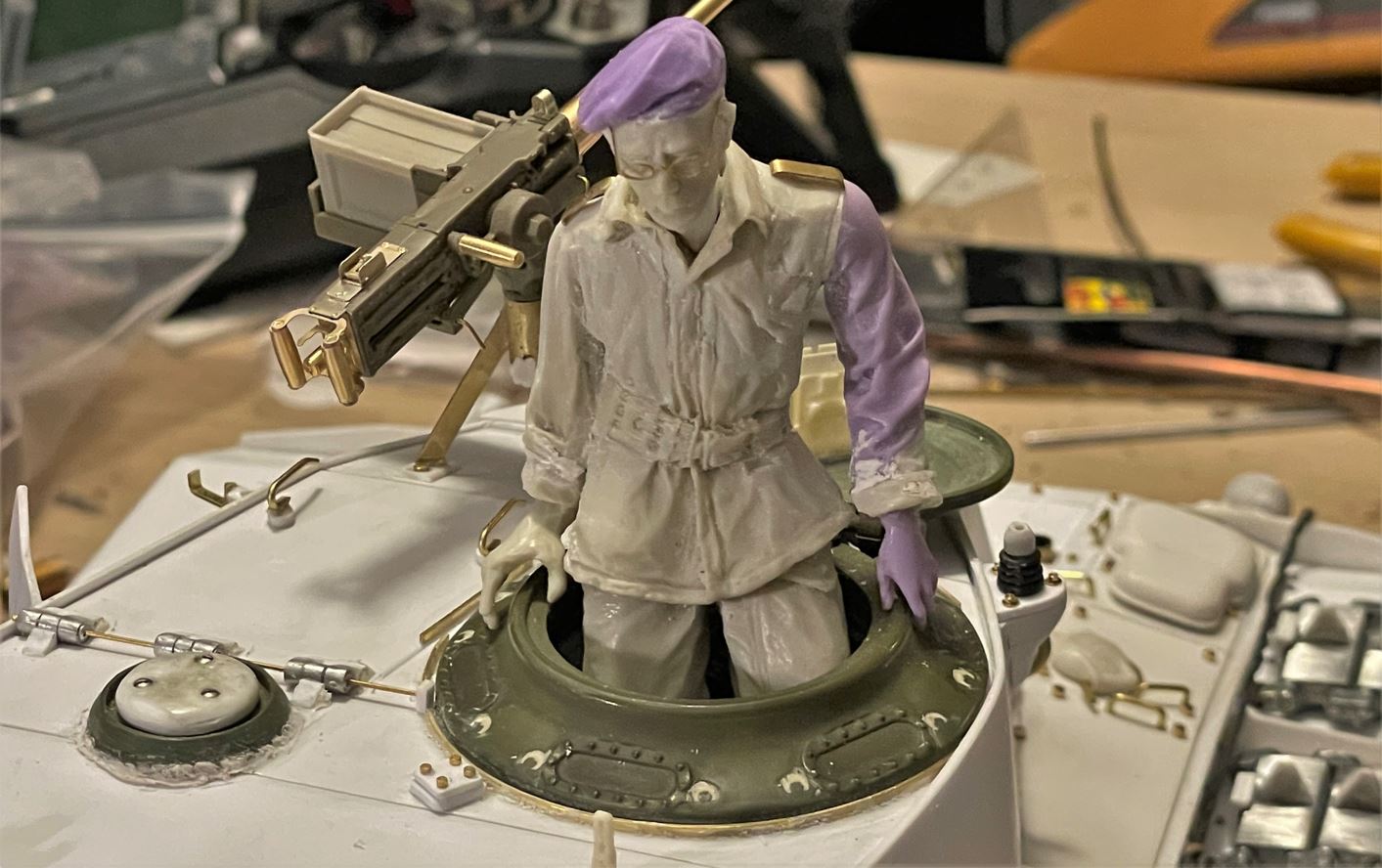

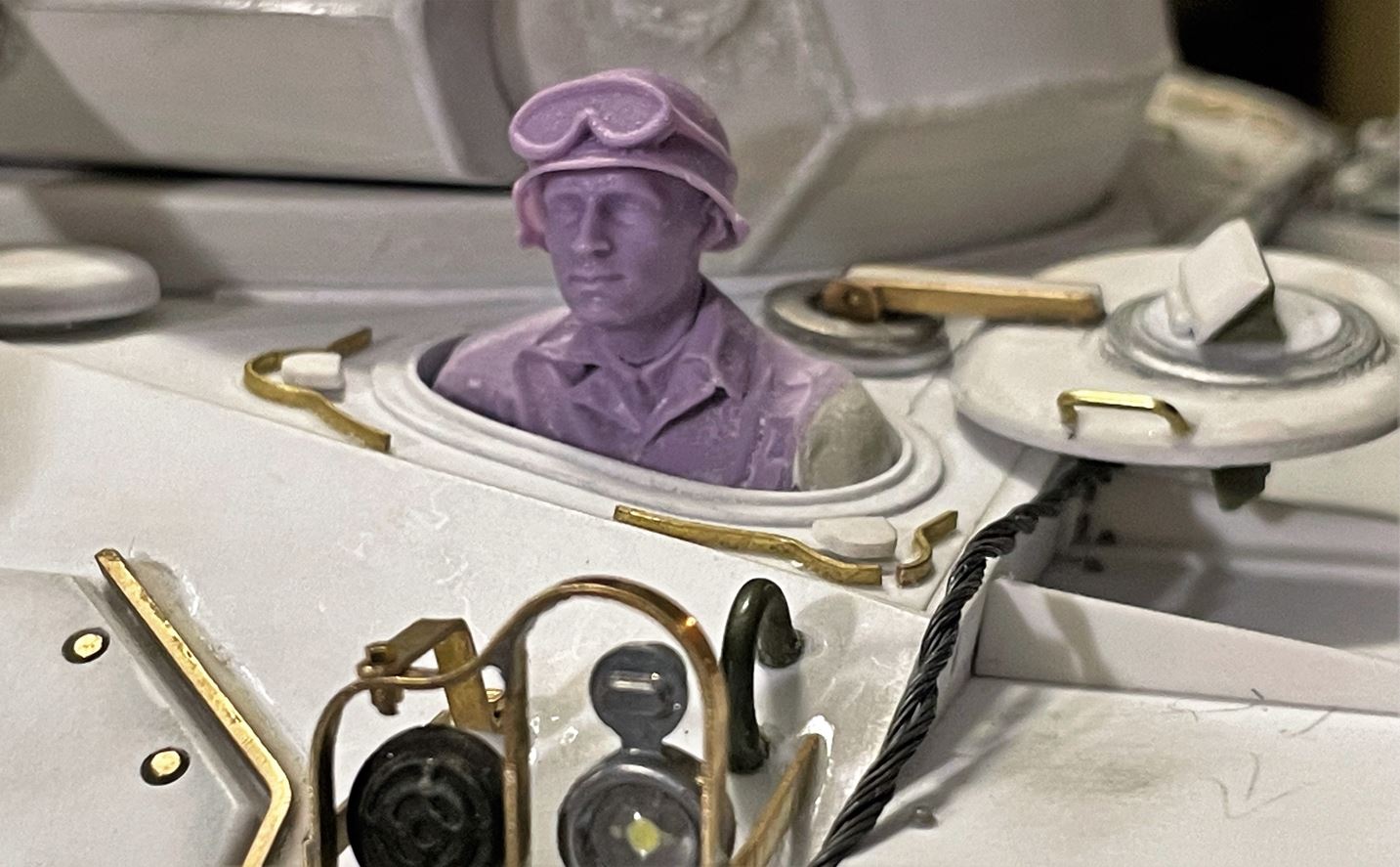

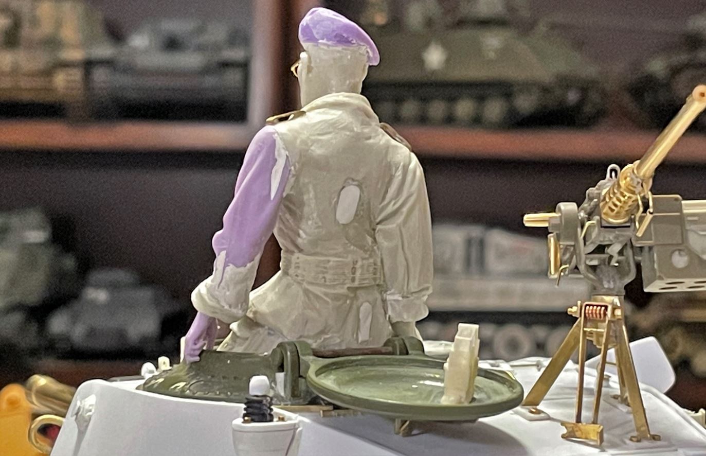

And here is my rendition of the 1/16 Tank Commander in resin, Captain Hervouet.

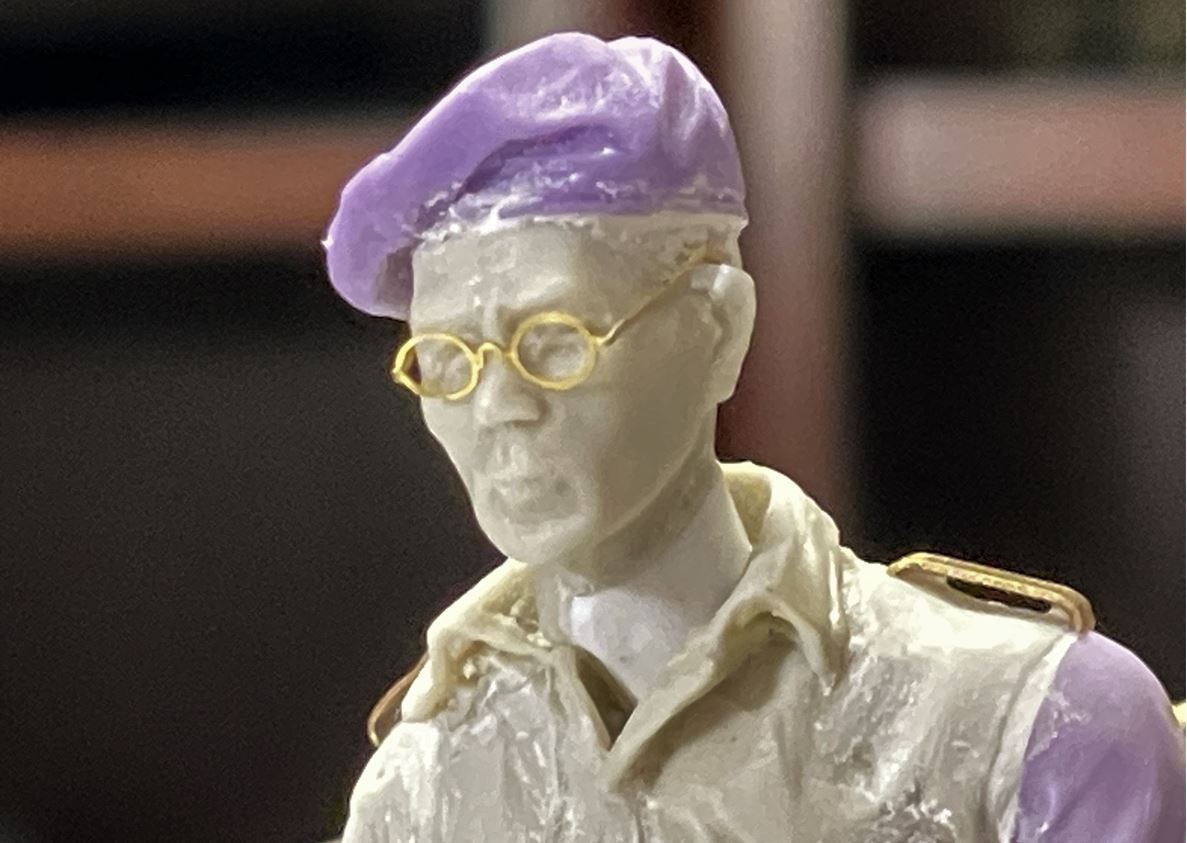

Still very dusty from the transformation, need to do some clean up. The glasses are from Verlinden. The fragile head sets and a cigarette will be put on after painting.

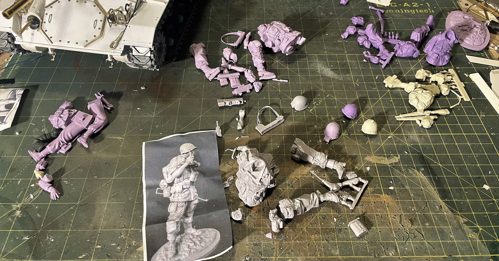

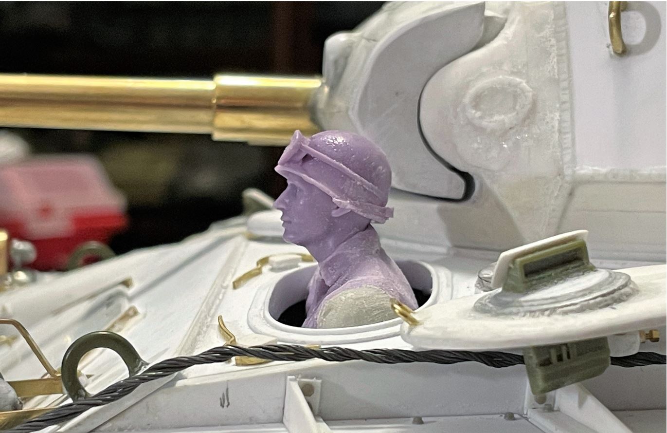

This is the resin figure used for the driver, an American soldier created to fit a Jeep. It had the components i was looking for. Sold by the same ebay Chinese seller, but i only used the upper torso, head and steel helmet. One arm of this figure is used on Captain Hervouet, heated in the microware and modified to hold on to the TC cupola.
View of the driver, named Sergent Francois Willer, an Alsacian and a former Waffen SS soldier enlisted by force at 18, veteran of the eastern front and Italy. Captured during the German retreat by the French army, he had found his new family. He escaped Vietminh captivity with a small group and after walking weeks in the jungle, a trek filled with adventure, starvation and suffering, they managed to reach a French outpost with the help of local tribesmen sympathetic to the French, he's one of the few that made it. You can't escape your destiny.

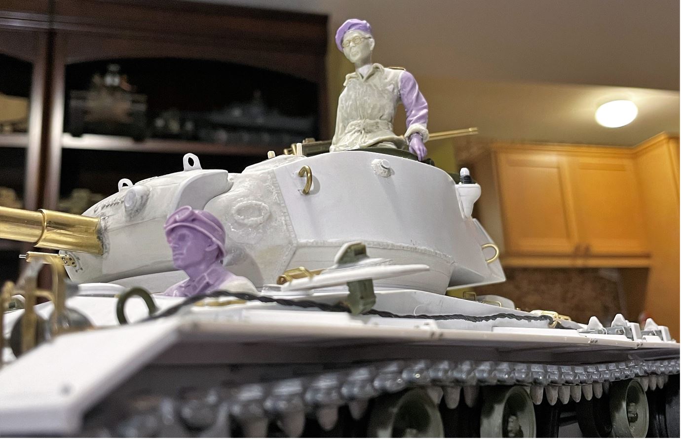

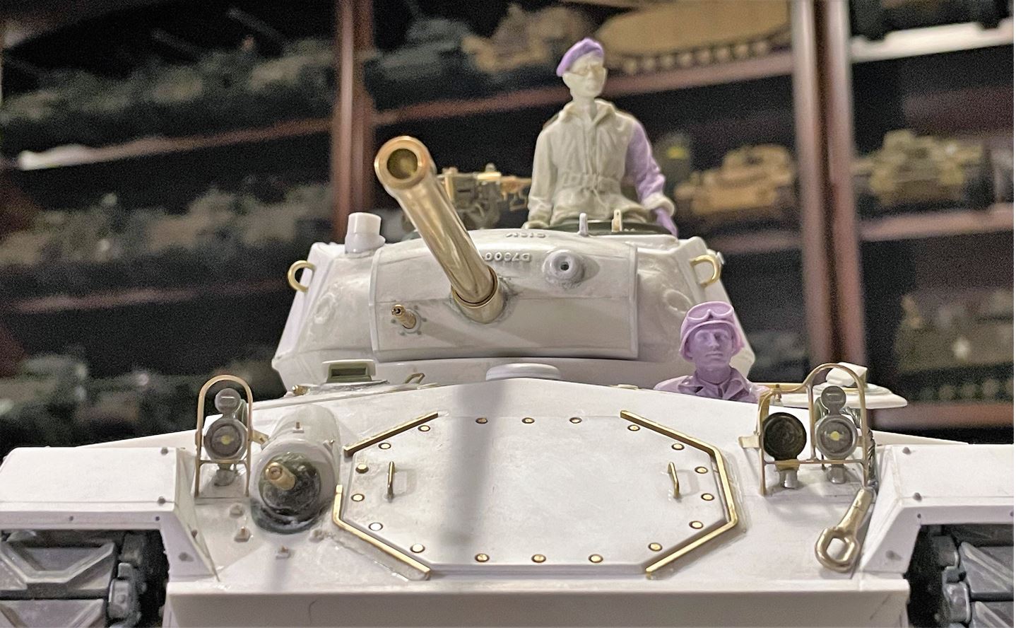

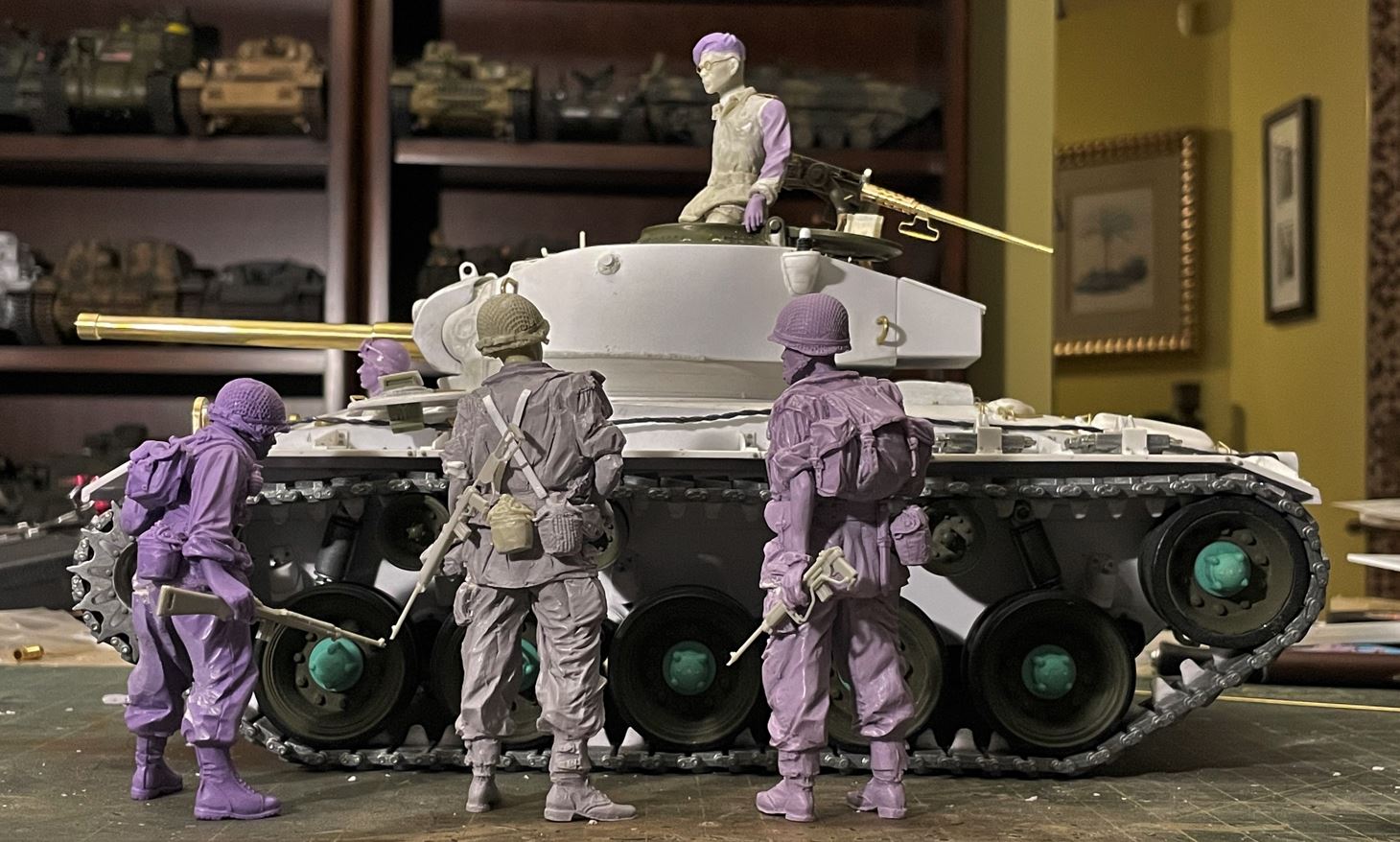

View of the 1st RCC crew on the tank.
Next step, the Foreign Legion paratroopers and tank riders.

The choice of 1/16 Foreign Legion figures on the market is very limited, i decided to create 3 standing Foreign Legion paratroopers with the material i was able to gather in addition to the tank commander and driver. These will not be sitting on the tank, it would be unrealistic for the kind of battle at DIen Bien Phu, unless soldiers were dead or wounded. The plan is to show the two main figures consulting with the Chaffee Tank commander prior to a joint mission, the other one will just be standing on the tank. Now the puzzle of putting together resin pieces that do not naturally fit together is starting.

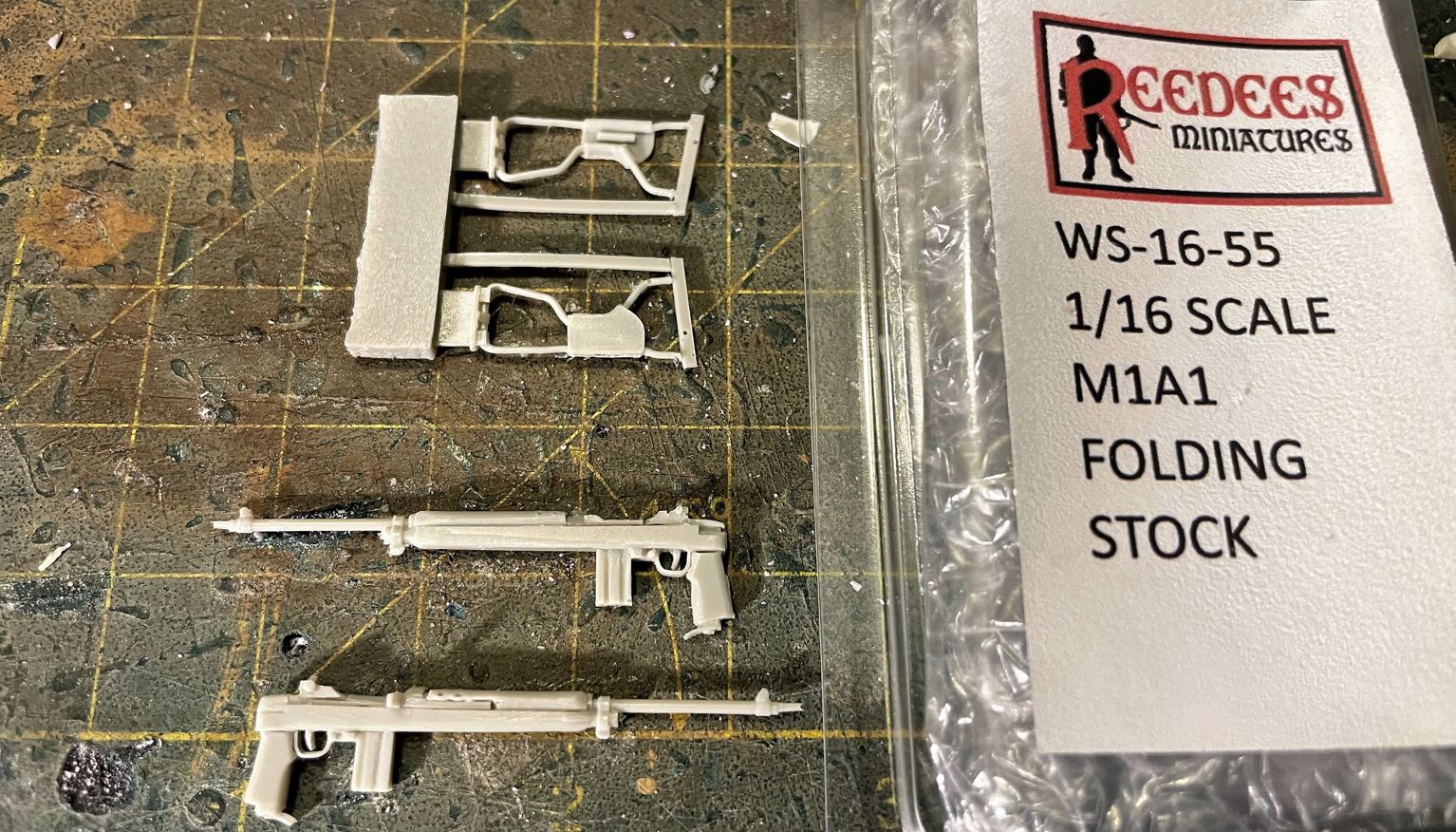

I wanted the paratroopers to be equipped with the US M1 carbine, some with folding stock as shown below.
The weapons coming with figures are usually disappointing in details and always broken . It is better to discard these and sign a contract with the experts in order to properly equip the figures with good looking small arms.

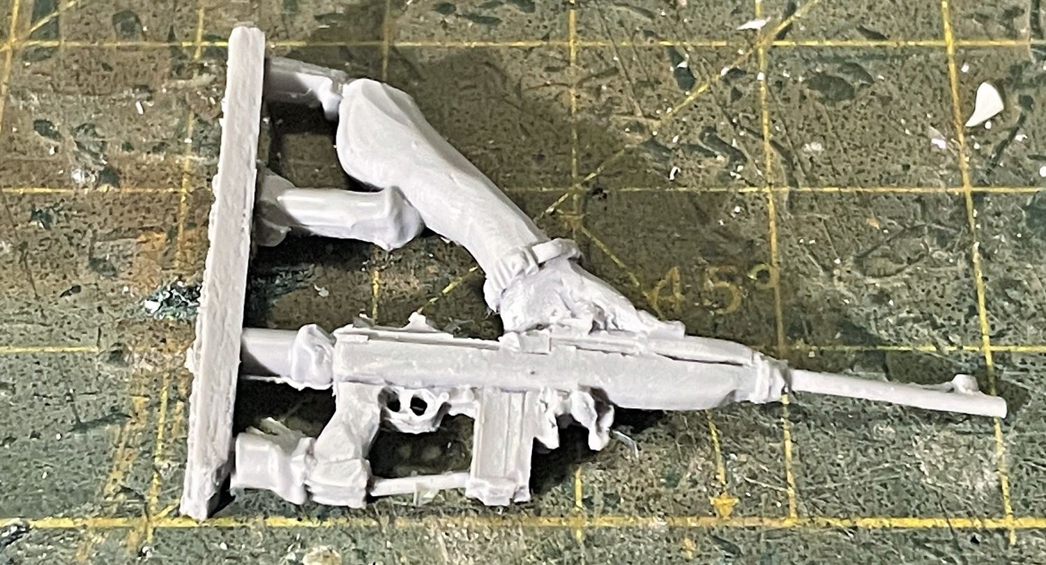

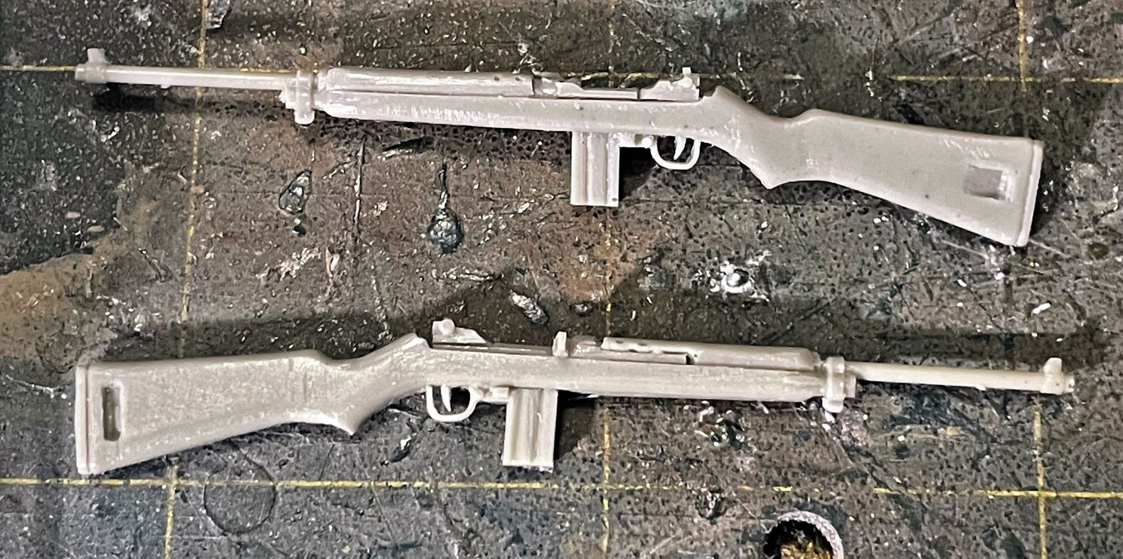

I usually deal with Reedees miniatures for my small arms, below is their resin M1 carbine with folding stock as used by paratroopers. Reedees does not have all the weapons available, but they have the major ones. Wish they had a Mat-49 though but they don't. You can see the difference in finesse between the M1 below and the one above coming with the figure.
They also have the standard stock M1 carbine that will equip one soldier.

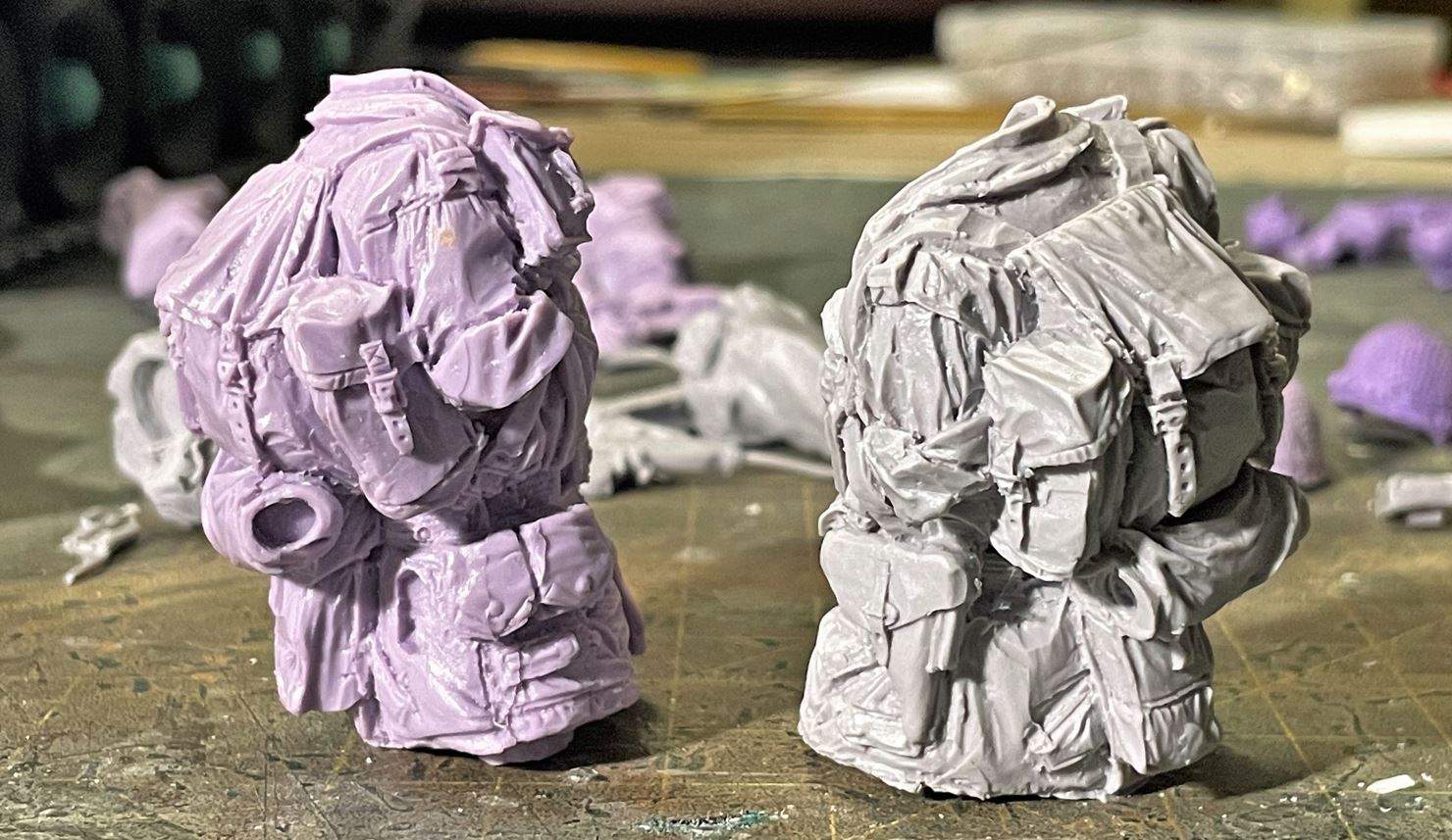

The resin figure used for the two main paratroopers is a Foreign Legion figure equipped for a 2 week mission in the jungle. As the battles involving tanks at Dien Bien Phu were mostly counter attacks only about 2km from base and uphill... these figures needed to be lightened, loading up on ammo, water, med kit and some food. Most of the backpack will be removed while allowing for variation between the two figures that use the same base. The third figure is using the same base as the tank commander.
And after a lot of cutting, kit bashing, microwaving and improvisation regarding the poses for arms, legs and heads, these are the three 1/16 Foreign Legion paratroopers i created. Figures really help making the model come alive and provide an additional dimension to the tank build.
Two of the paratroopers, officers, are coordinating their next action with the tank commander, Yves Hervouet. These three figures will obviously only be used for static display.
