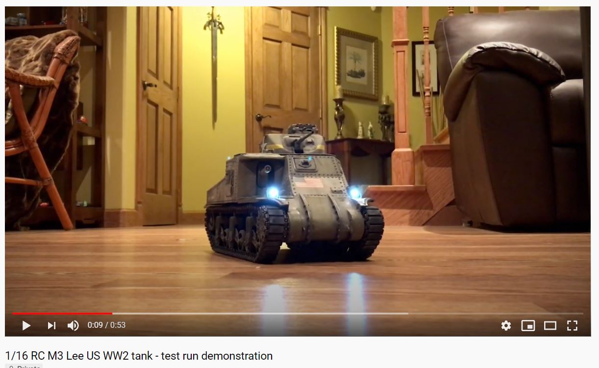

And to finalize the build, here is a short YOUTUBE demonstration video of the finished model in action. Hope you liked the M3.
https://youtu.be/Kzv9h7NLIo0
Link above

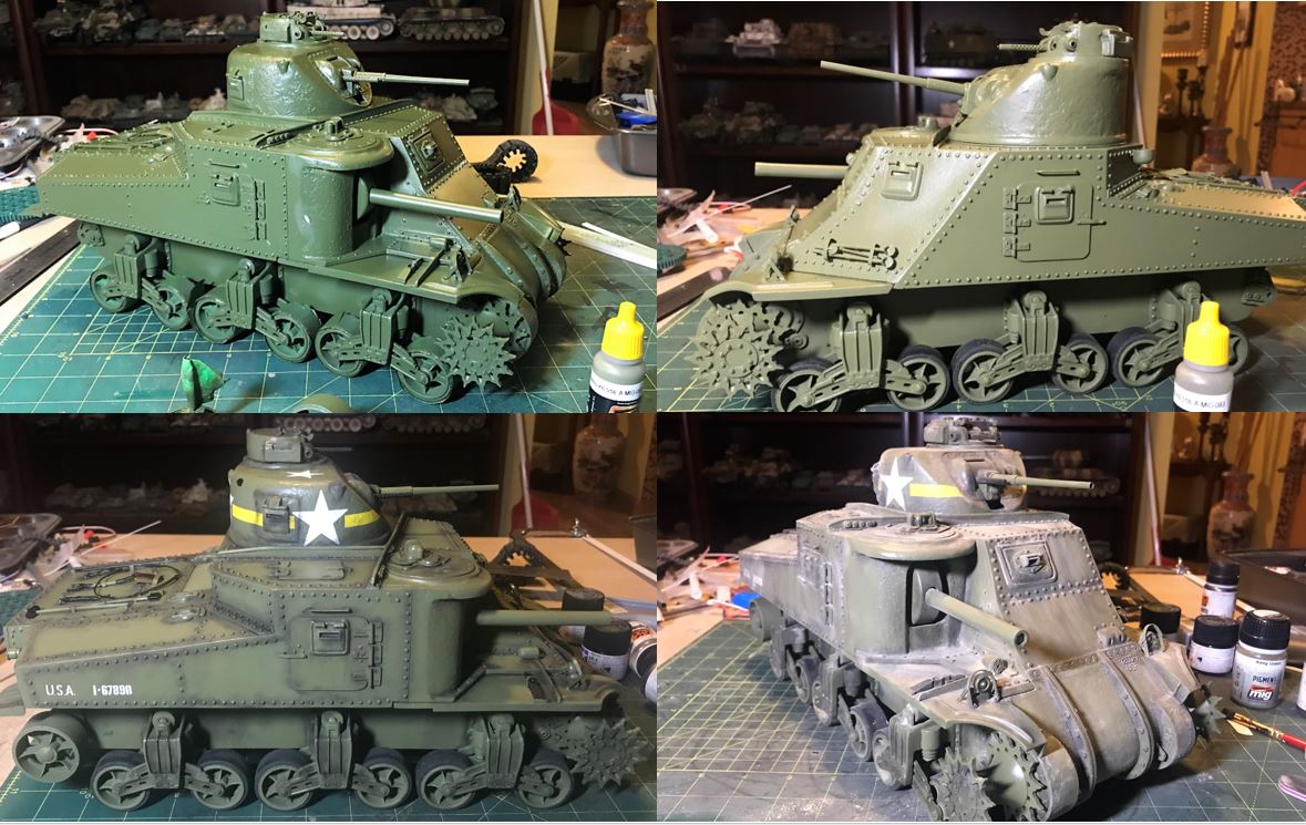

Thank you Jimster and everyone for your encouragements throughout the build. Yes, it was a fast build, about 5 weeks in total, a few evenings here and there, plus at least 2 heavy weekends. I think it looks pretty good considering the limited time and budget. Finding the issues and Improving the Vandra kit is a good challenge. The custom mechanics for the turret and guns were also fun to design, specially when they end up working well. For anyone wanting to push it further, a metal hull is required to experiment with the replacement of the 3 piece transmission housing with the extra frontal gear as shown on a picture from Herman, but i think it would have complicated things a lot. Not sure it is worth the trouble and risks of scratch building something like that. However, I recommend replacing the Mato plastic gearbox by a metal one. I wanted to keep the budget for this M3 under $350 (excluding the TK) but it would have been worth investing another 60$ into a better gearbox. I am satisfied with the Shapeways spoked wheel replacements, they run well and look good. I think the Shapeways M3 suspension plugs could be easily improved by the designer to avoid the fixes i did and be more accurate but the base were a good help.
Happy modelling!
