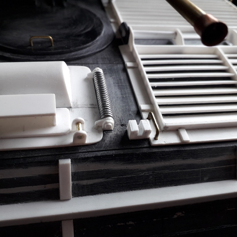

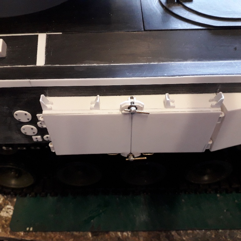

Made up some brackets / fixtures that will go on top of the loading hatch housing.

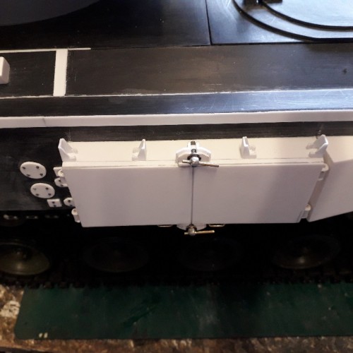

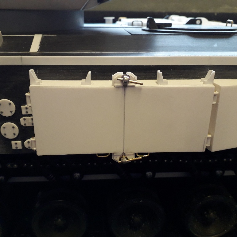

Brackets now fixed to the loading hatch door surround.

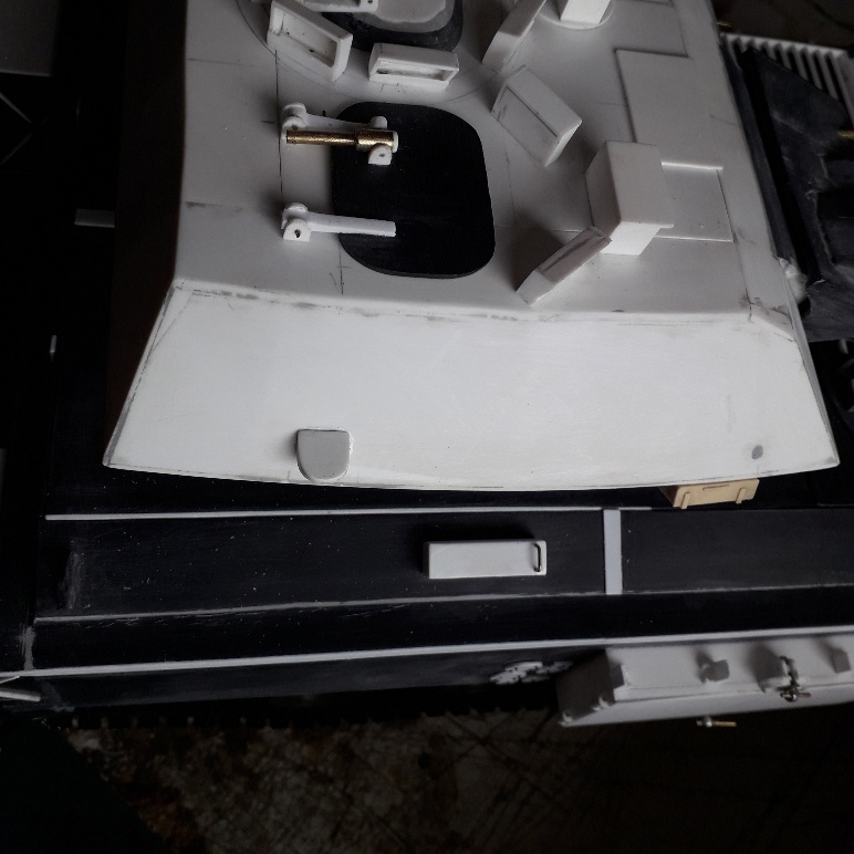

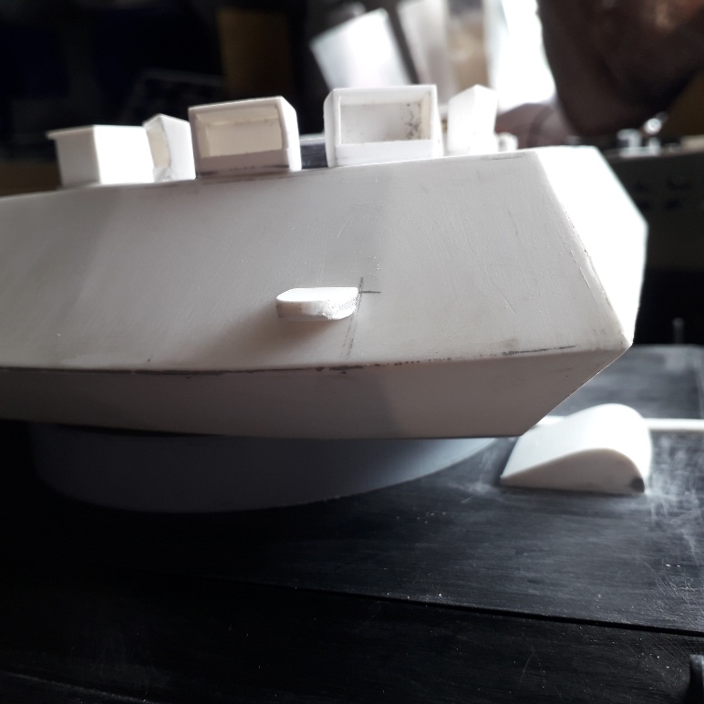

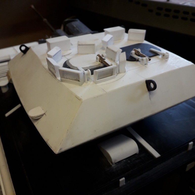

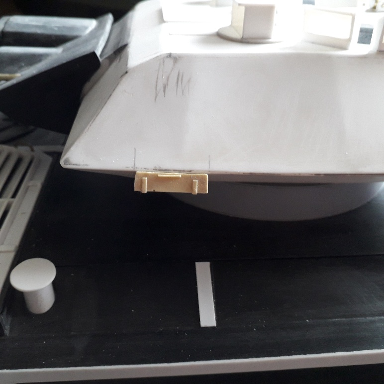

Not much done today, but added the drivers hatch open locking points, 2 turret side antenna mountings left and right sides and some small stowage lockers on the underside of the turret, both sides.

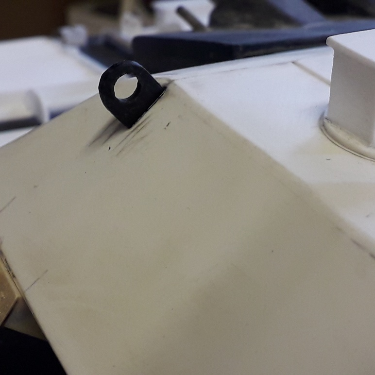

A few things more completed, i added 3 turret lifting eyes one either side and one on the rear in the .
center.

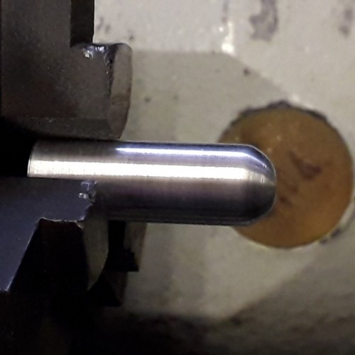

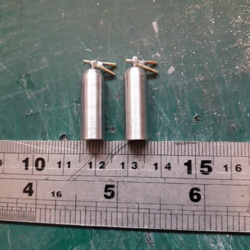

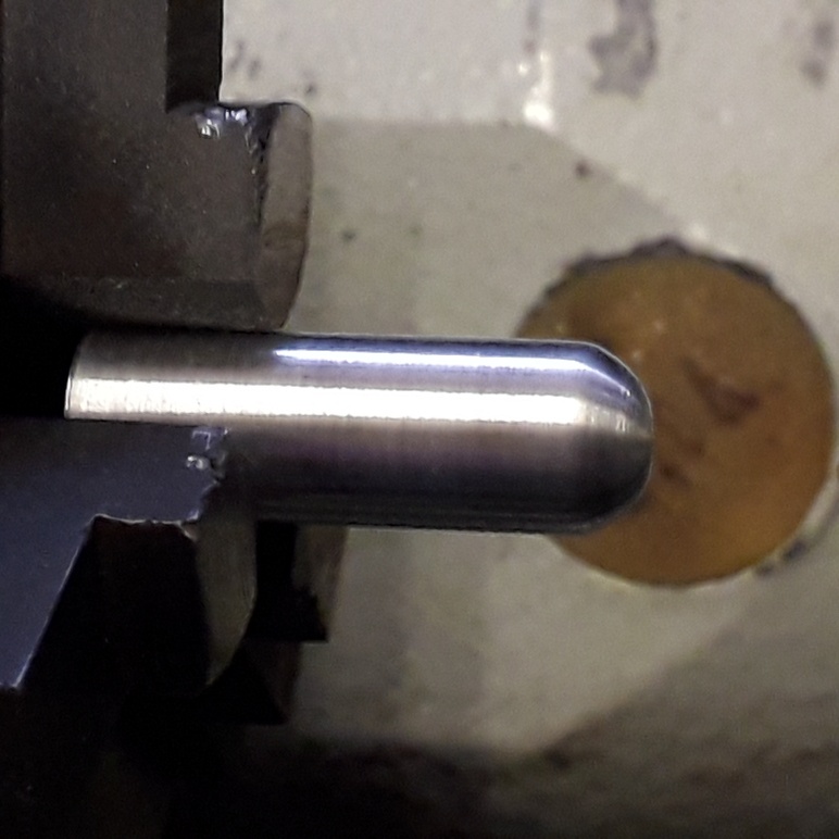

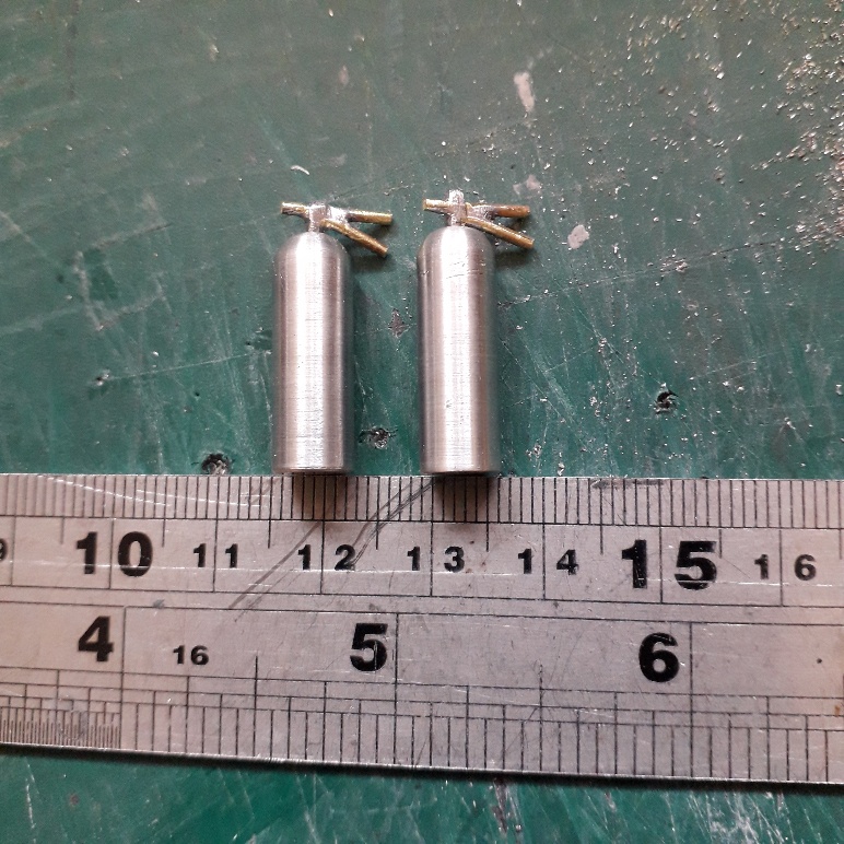

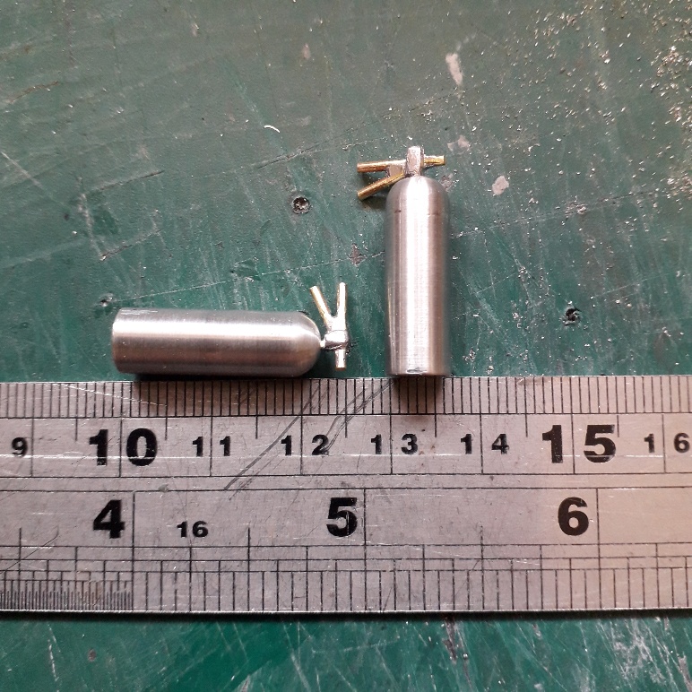

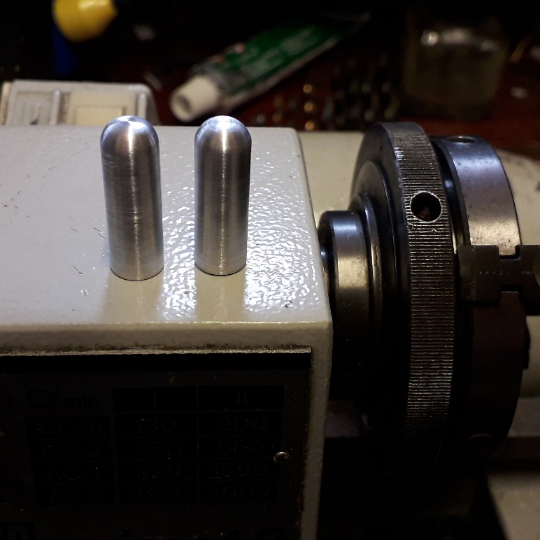

I decided to start making some of the additional accessories that are fitted around the vehicle so i started by manufacturing a pair of fire extinguishers, these are located on the rear troop compartment door externally at the top left corner.
They are 25mm long by 6mm wide and are made by turning some solid Aluminium bar up on the lathe to the correct size and making one end convex, then drilling the domed end for the handle and activation lever and outlet to fit into the body.
The outlet handle and lever are made from 0.81mm brass rod soldered together then glued into the extinguisher body, now just the mounting brackets to construct....i think they turned out ok.
