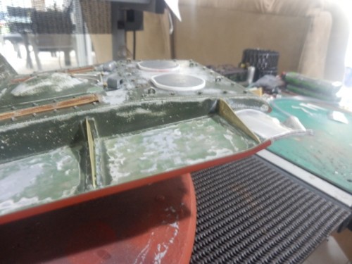

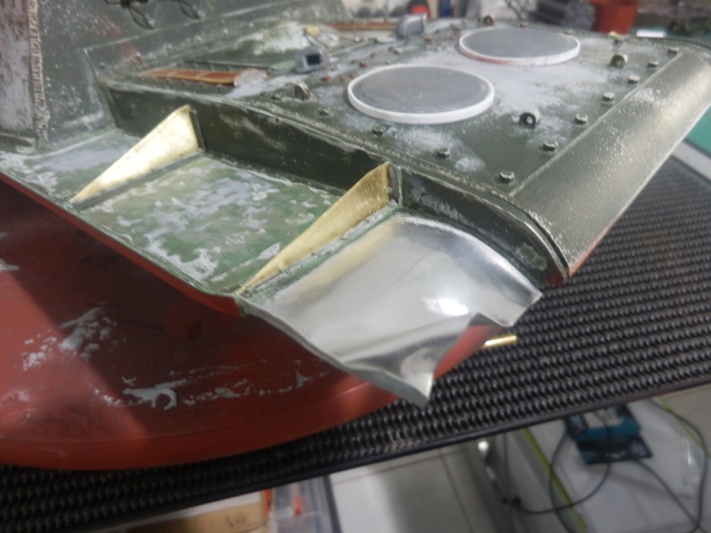

But, I have added gussets from the rear hull deck to the guard sheets that were left off & filled for some reason but the past owners.

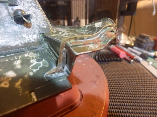

I also sliced off a rear guard section that was melted to look like damage.
No matter what I did to alter it, it stayed looking like melted plastic.
So, off it came.
Using a small piece of ally sheet, I formed the radius and folded the edges up on the outside & down on the hull side to assist with gluing to the hull.
Then used a bit of imagination to get the right look of a crumpled guard.
Still need to blend the transition from alloy to plastic a bit more, but its pretty good & much better than the melted plastic !!.
I added a stay across the front left guard as well.
To get it to follow the profile of the melted plastic, a fair old lot of grinding & filing was required !!
More effort to be rough than leave things new looking :crazy: but it has to be rough or it wouldnt be right !
