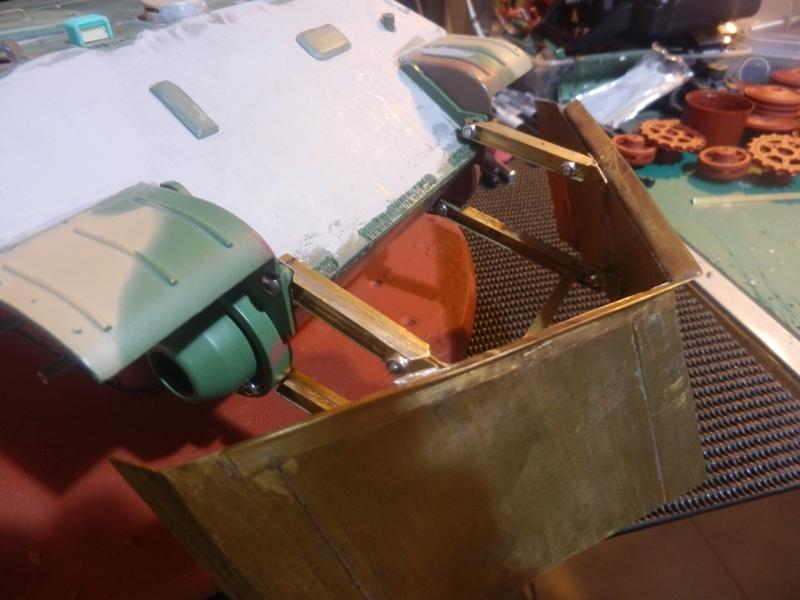

Been a while...............house move, end of year dramas with work, the usual
Finally secured the blade to the Panther hull.
Top mounting arms soldered to the upper blade and they're pretty robust.
The arms are bolted to the hull through the normal shackle points with 3mm hex head cap bolts with nylock nuts.
Now done, I can get on with the internals & look to secure the hull halves ready for final assembly and detailing.
Perfect or not, its gong to be a fair representation of a 'D', let alone an example of what the sole Ramschaufelpanzer might have looked like.

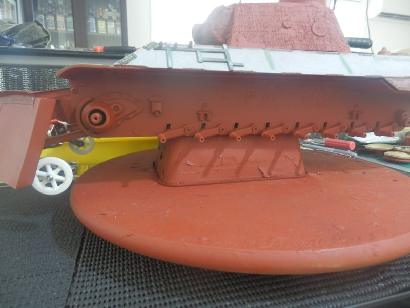

Nothing screams progress like primer !!

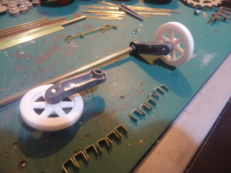

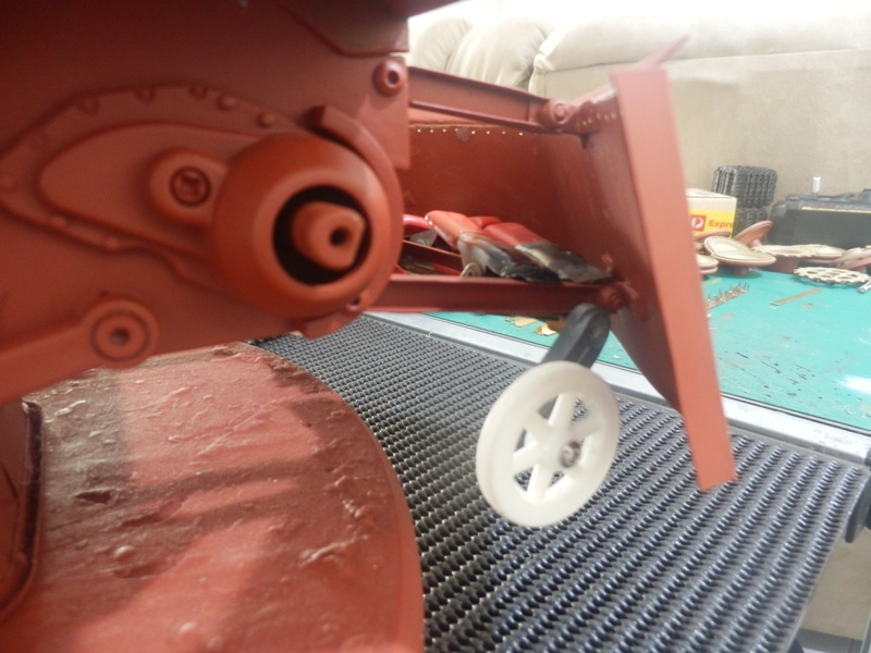

Been a bit slow here with the xmas over-indulgence time upon us.
Have got on with making a set of spare track hangers much against my better judgement and common sense.
They are not perfect but will do as this wont have any track links hung.
The probable blade support wheels (and they are only probable due to no info, and pics of a wheel on the front of the blade) have been secured & seem to offer the right representation.
Pz1 3D printed leading roadwheels are fitted to spare Taigen Tiger swing arms that are drilled out & soldered to a brass tube(toob for you left -hand drivers!)
Ive doubled up on the base plate section of this as its going to see a lot of force when its being used.
Now I have to get the elevation screw & handwheel on.
Sure doesn't look like much, but there was a lot of hit & miss that went into it.
The exhaust support straps were also made out of Aber Panther schurzen plate sprue left over from a mates project.
Its a good enough impression of one but they dont photograph very well !
Once the blade support is done, I can fit the detail bits & move to paint.
