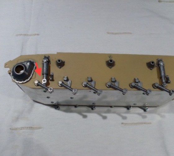

After that, I bonded the lower section of the front three plates in place. I wondered what the holes (one indicated by a red arrow) were for in it, as there's no mention of them in the instructional pdf., nor a picture :problem:
Eventually, I chose to fit the plate this way round because the holes are likely to be needed to adjust the Henntec unit. :)

Back to the suspension. This is where there's not a lot to go on online. Anyway, this is how I tackled it. The wee brass spring retaining bolts (2.5mm hex heads, 12mm shaft length) were screwed in gently to the undersized holes I'd drilled through the plate sandwich. Using a 2.5mm bolt driver, I carefully used the bolts to cut their own thread. Then unscrewed them slightly to receive the loop/hook of the spring.
Then the arms were slipped into place, and the brass pivots I'd made pushed into place. A final light tap was needed to drift them through the inner panel, and the reinforcing strip that's bonded to it. It's an intentionally tight fit, and that was the result I was aiming for. It fits like a cotter pin. The outer stub of the pivot pin will be secured in place by some Plasto. The idea is that if the springs are not up to the job (and they are an unknown quantity), it won't be too much of a pain removing the suspension arms. :| The springs allow the arms to swing almost horizontal, but any more than that might tip their elasticity range beyond recovery.
The arm now moves freely, as its captive bushing swivels around the brass rod/axle. I'm being very careful in my choice of terminology, lest any unintentional double entendre opportunities emerge. :lolno:
The gaps around the brass rod end will be filled with Plasto or Milliput, after the arms are centred perfectly.

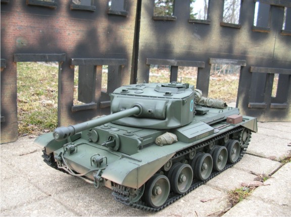

The T34 suspension can be adapted to mate with the Comet (Ludwig) upper hull. A notable example of that is to be found here (a build by Michael C., using a T34 lower hull and suspension):
viewtopic.php?f=33&t=19362&p=175144&hil ... +c#p175144
Comet by Michael C.
Comet by Michael C.
Michael's Comet.jpg (78.85 KiB) Viewed 3453 times
I believe the finishing touches to this build were applied, with great finesse, by Dean (dgsselkirk). :thumbup:

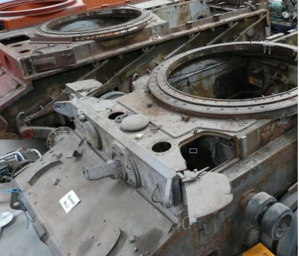

The Comet hulk in the background shows diagonal brackets where the suspension units used to sit. (Click to enlarge- not all pics come from Imgur)
