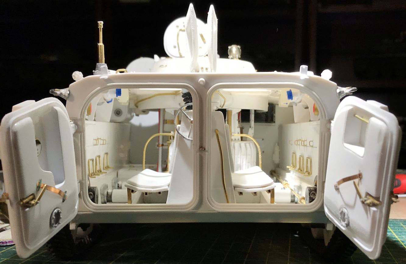

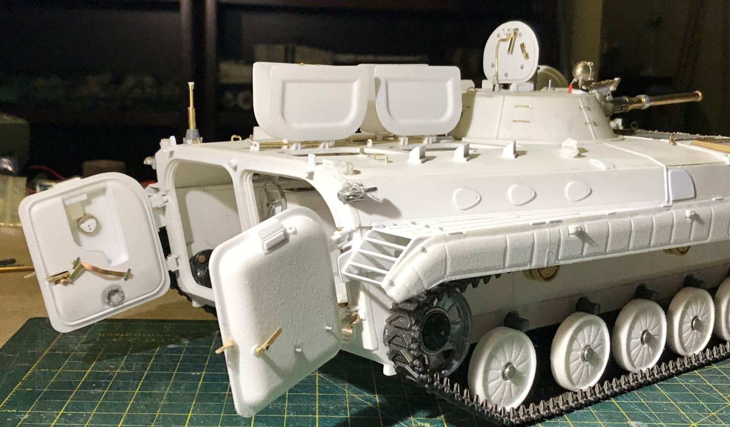

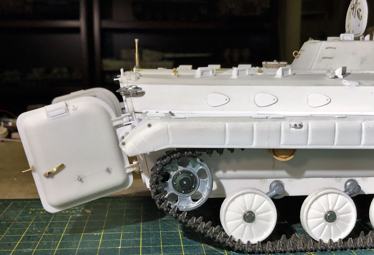

With that angle, the doors on the real vehicle must be easier to open than to close. The large flexible trip that serves as a closing handle must be something to pull, specially when the tank is going uphill with fuel tanks full.

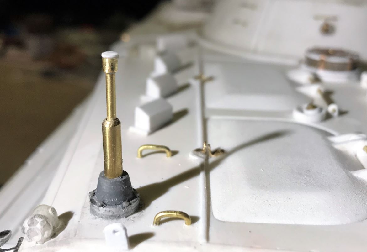

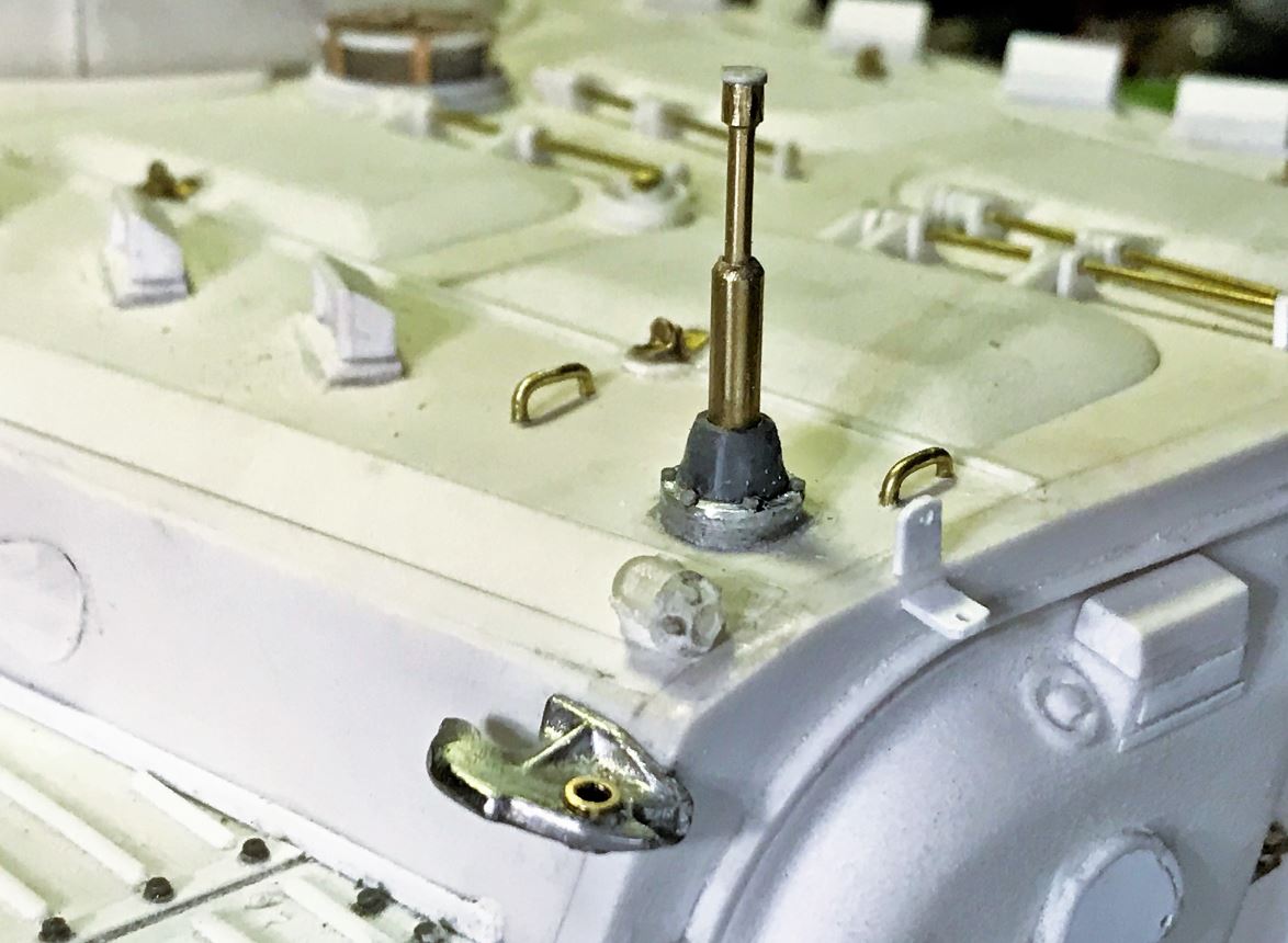

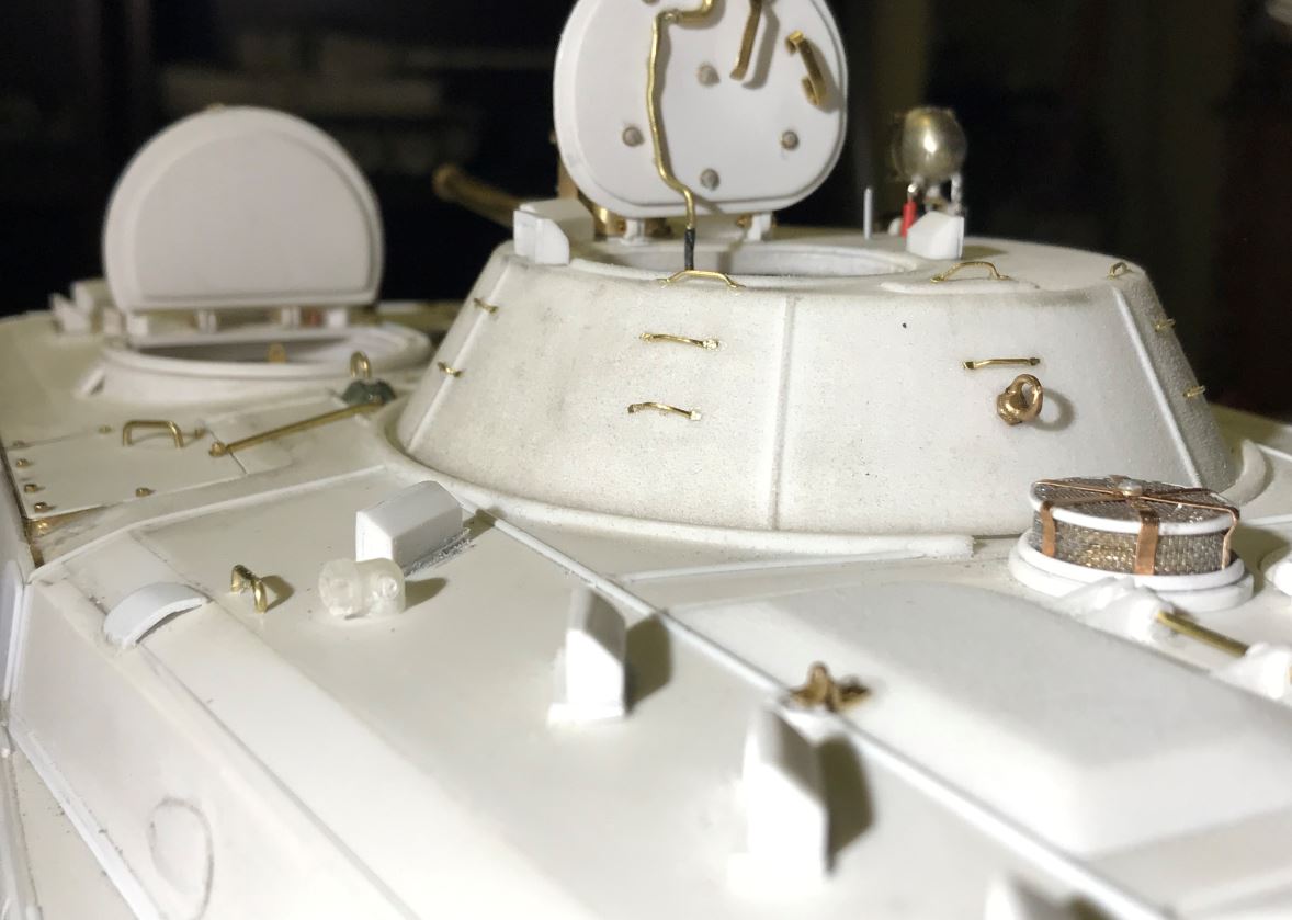

This is the radio antenna, done in aluminum and brass tubes, also with a lego grey round block.
Ludwigs 1/16 BMP BMP-1 BMP1 RC IFV

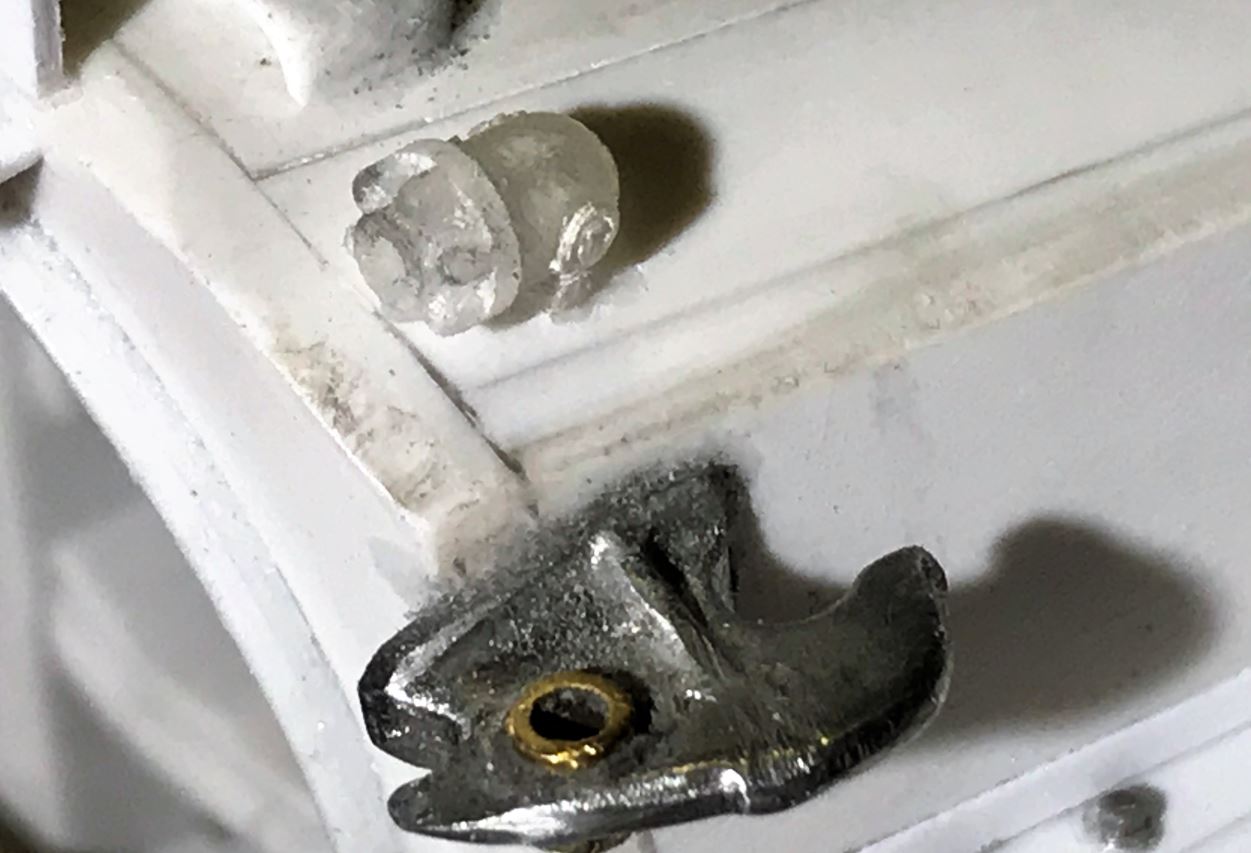

This is a Shapeways T-55 positioning light used on the BMP as well, a rare luxury to find this item available on the market. Need 2 at the back, 2 in the middle, more at the front. Also used a T-55 hook from Dioramaparts, modified to look similar to the ones used on the BMP at the rear.

The periscopes and stands where scratch built.

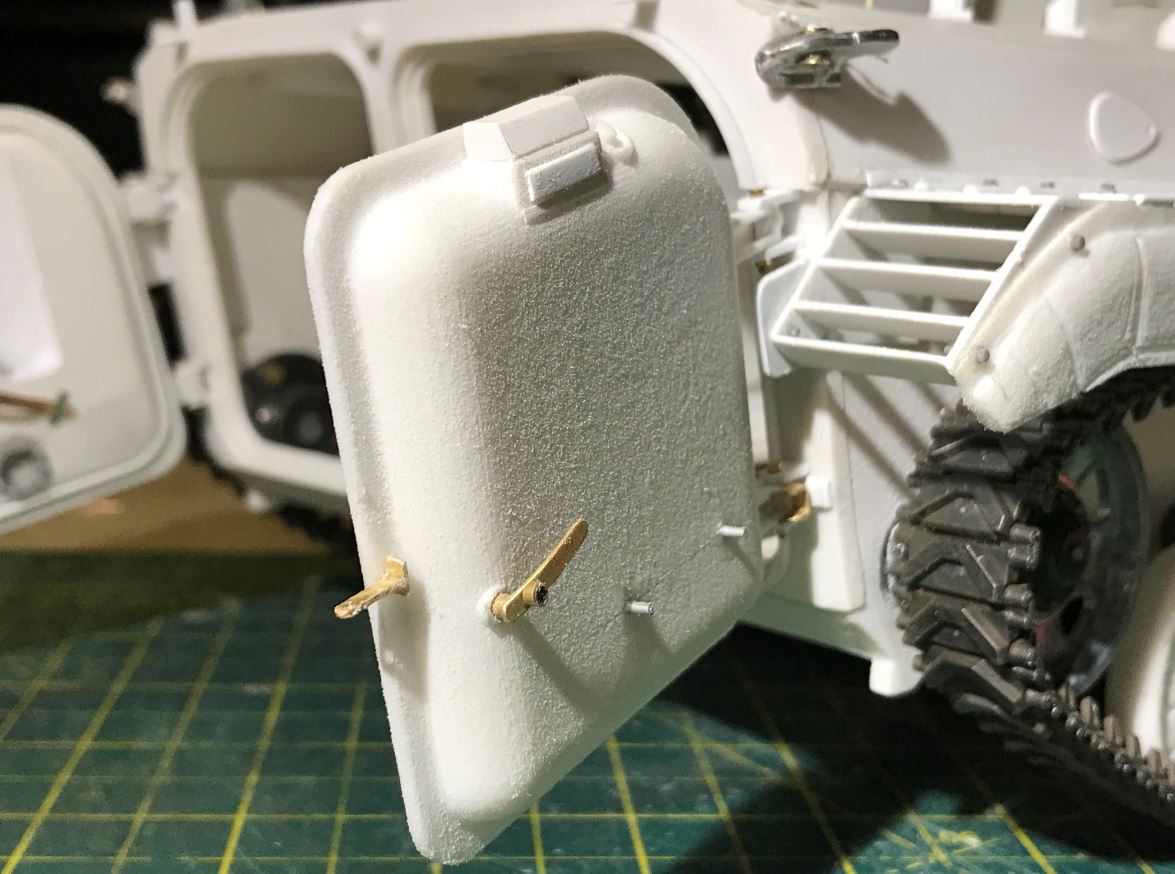

Those rear doors must have some form of spring assist device, it would be smart to do that.

The latch is non functional. There are limits...
Disappointed with your lack of commitment...

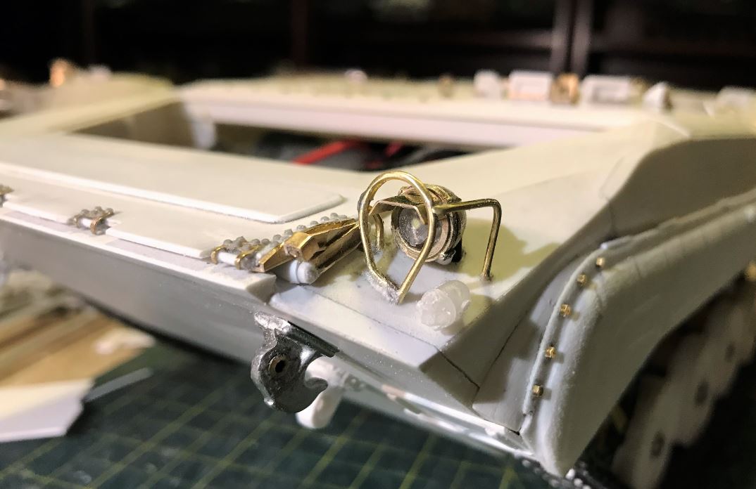

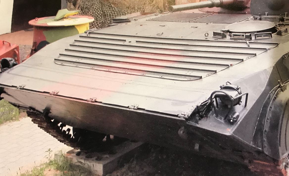

Presenting the front of the vehicle.

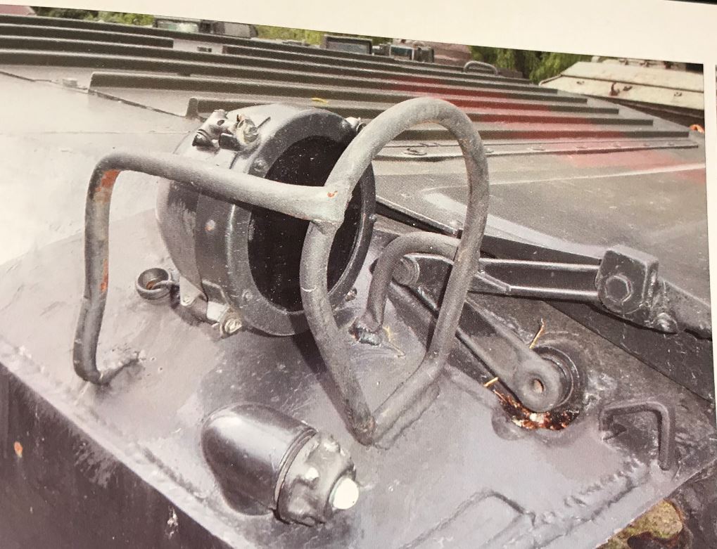

Here is the real vehicle right headlight, guard and trim vane mechanism.

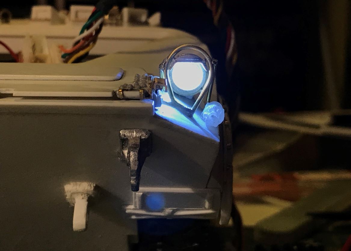

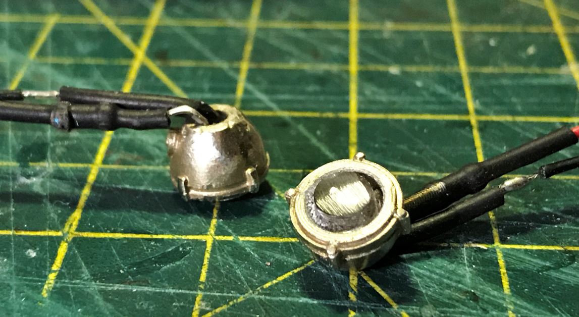

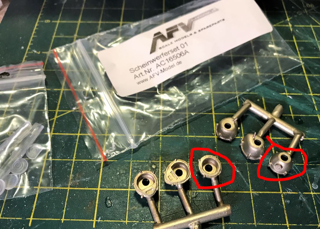

The AFV-Model MLRS light kit has an example of a head light very close to the BMP model used.
Ludwigs 1/16 RC BMP BMP-1 BMP1 build

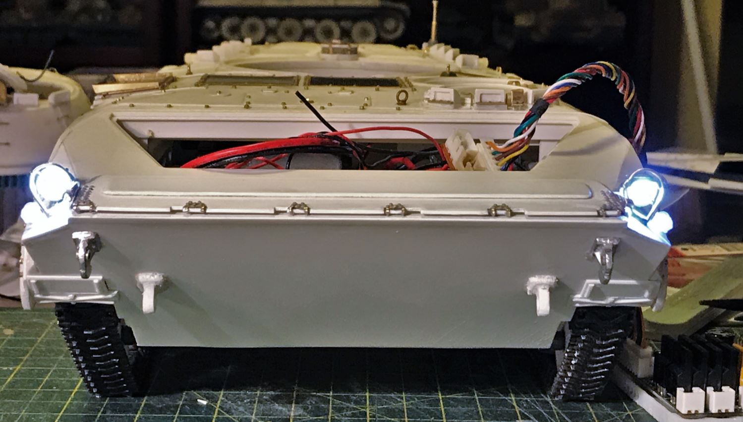

A 5mm LED is installed inside each. The lenses will be added only after painting.

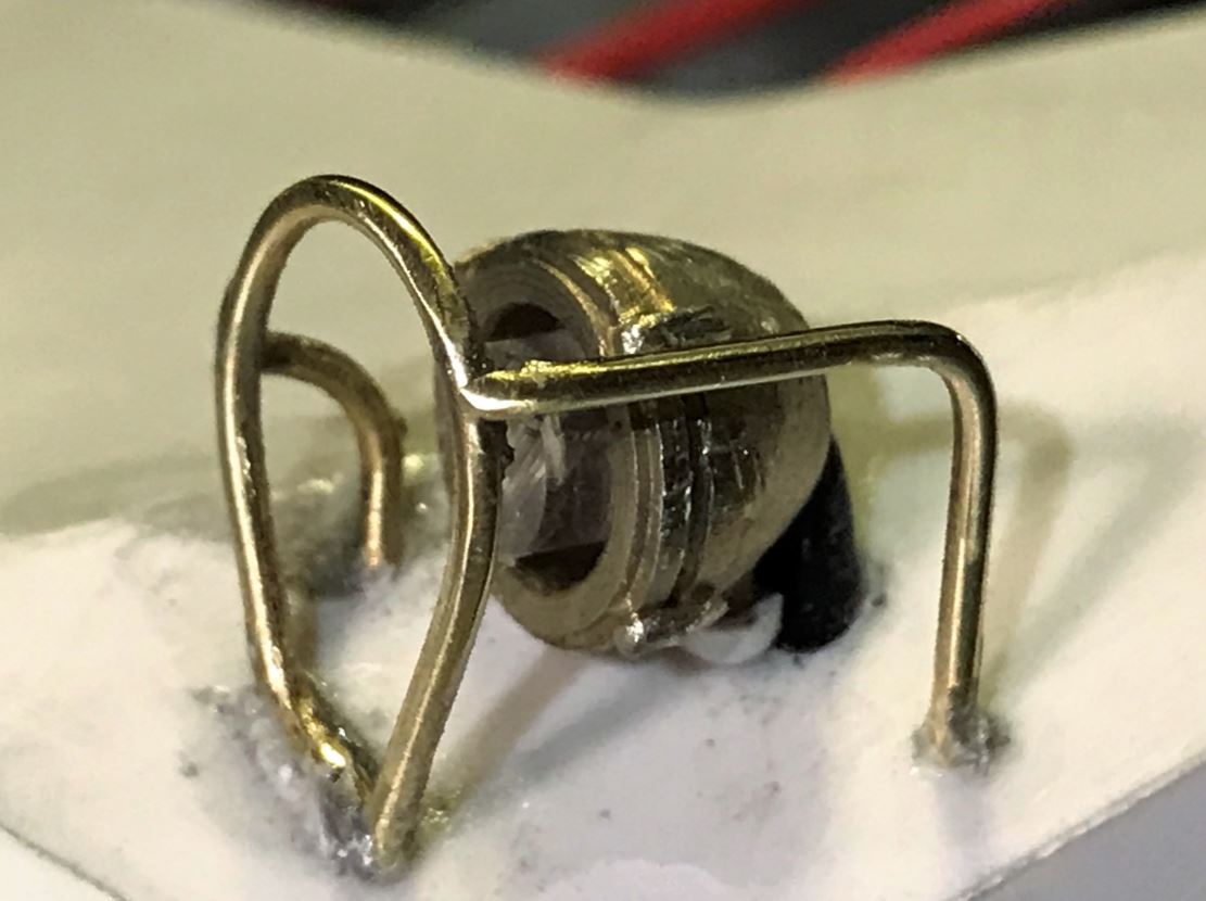

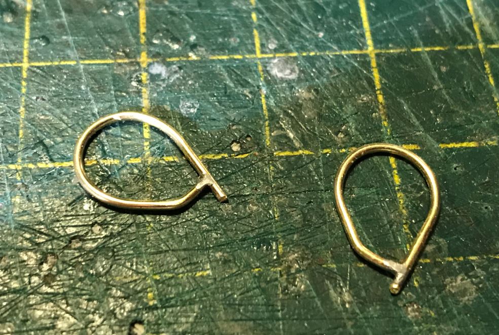

The head light guards need to be made from brass rod.

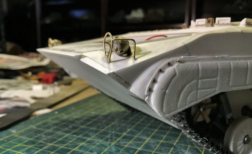

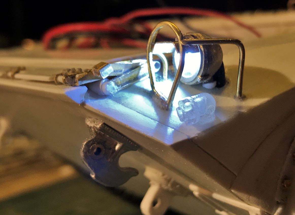

View of the basic headlight in place.
The front armor needs to be pointed so an angled plasticard strip is added to the front top section as per references, and sanded smooth.

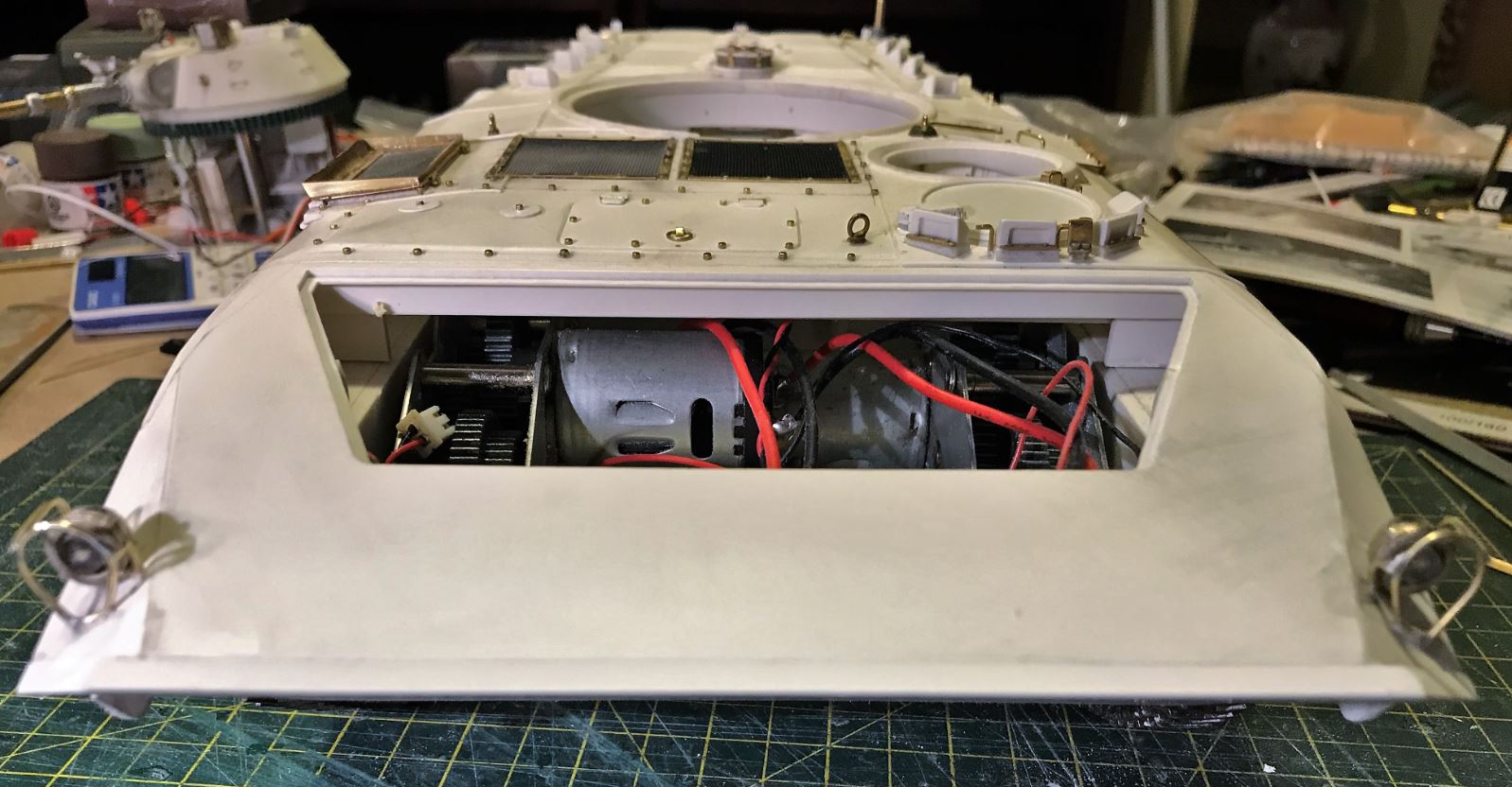

The BMP RC model has a nice trap at the front that can be removed to give access to the battery and electronics, it avoid opening up the chassis for basic maintenance.

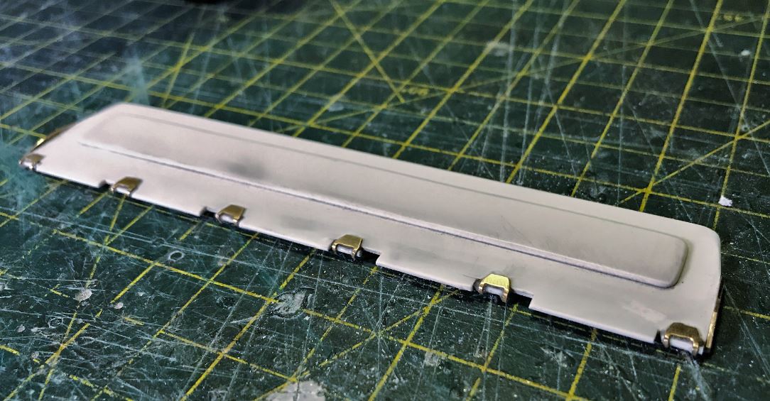

The trim vane needs to be scratch build. The 1/35 scale model provided dimensions.

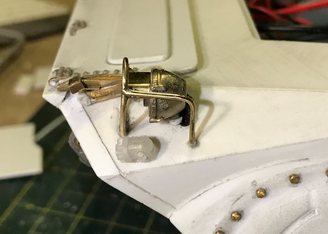

A best effort is made to reproduce the trim vane elevation mechanism (static) and the bolts. Notice the plate added to dim the left headlight, and the Shapeways positioning lights.

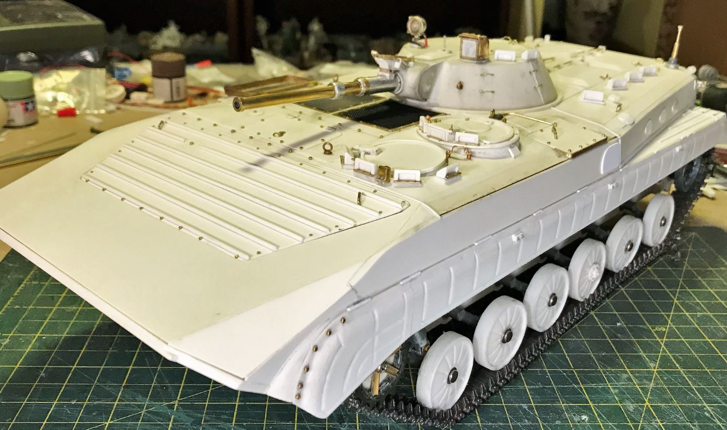

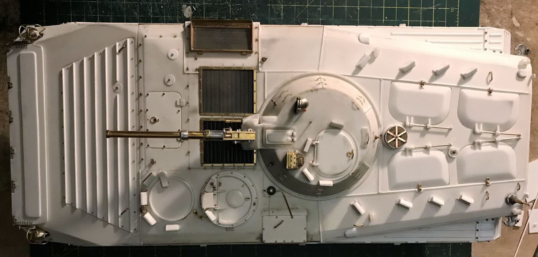

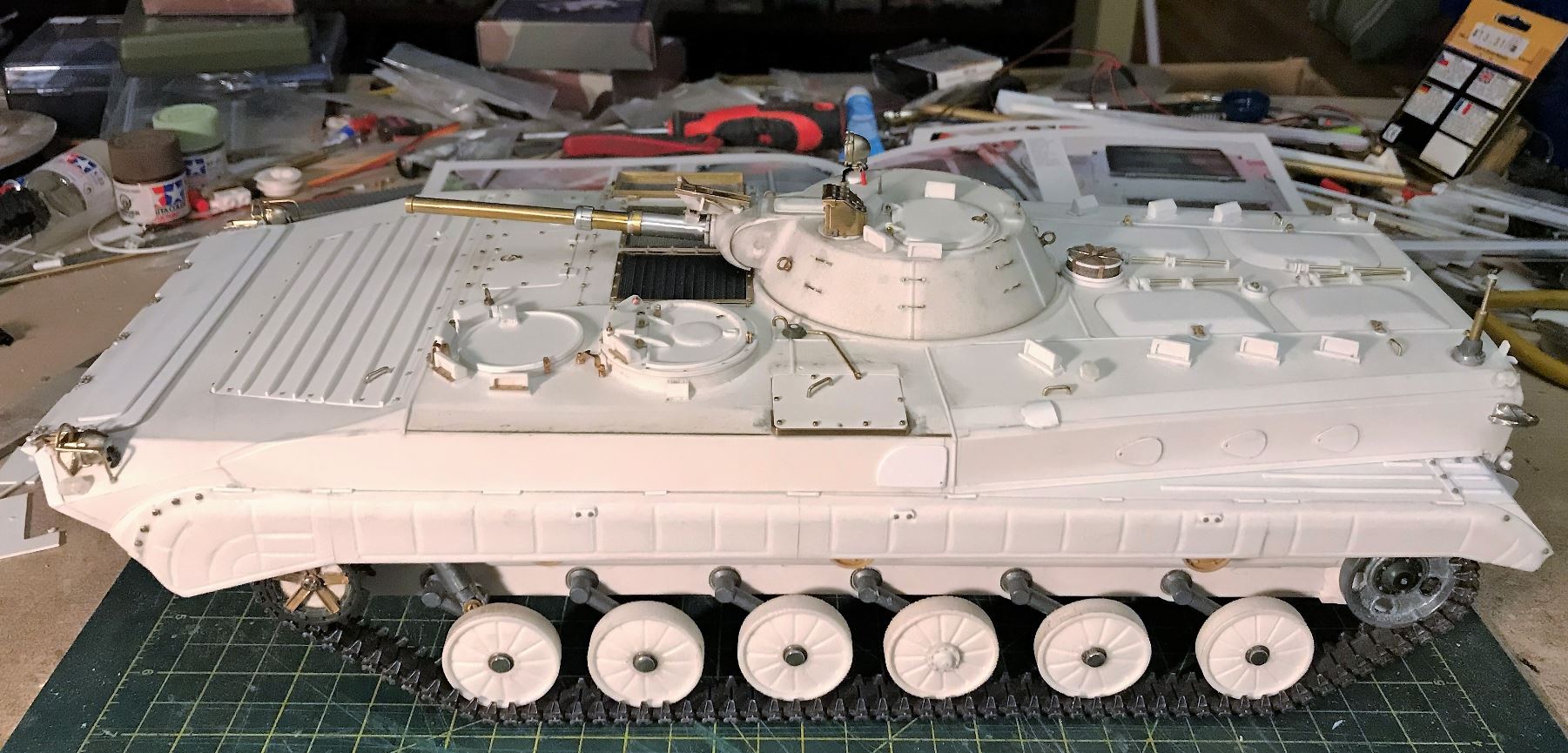

View of the BMP-1 model as it stands today.
