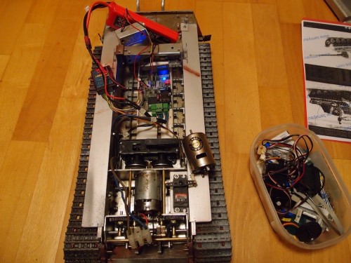

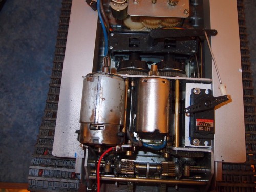

Might have modern power plant for the Kingtiger
This could solve the lack of low end power for crawling and turning.
- Going to strip this down
- Tested and its OK. If i can remove the pinion on the motor it will fit.

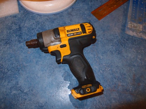

Fitted the motor out of a Dewalt impact driver 10.8V. The motor fitted well ,even had the fixing holes and the bearing housing on front same size as the hole in the gearbox . Another plus it has a fan to cool the motor. Test run perfect, original motor on side.
- Any longer and the terminals would foul the gearbox.

Very innovative use of that drill motor mate, and even more amazing it was a perfect fit after destroying the drill to try it !

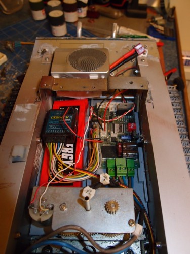

Battery and board trays tidied up and painted.
- Primer will do
- Ready to go ,

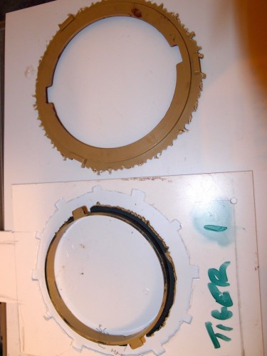

Posted: Thu Jan 24, 2019 10:46 pm
by ronnie42

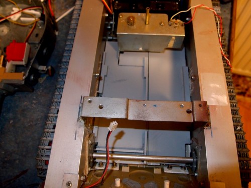

- No turning back now, made a mistake with the styrene will be handy if i do a tiger .
Time for some changes, the old central turret gearing is going. Think i have sorted out cutting the hull for a Leopard ball bearing turret ring.
Along time sorting the ring for centre . If the plastic servo gears strip will change to one with metal gears.
A tie-wrap and servo tape for now .The servo bracket is a hard metal burned out a drill bit, time for some good twist drills.

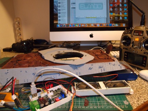

Turret test one revolution slow 75 sec, fast 15 sec. Now to find out a KTs real time speed of rotation.
- Just love how you can adjust settings with an Elmod board.
