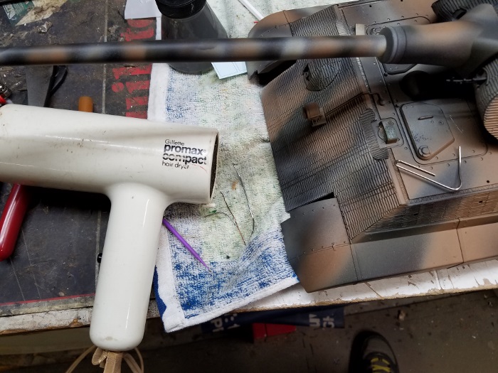

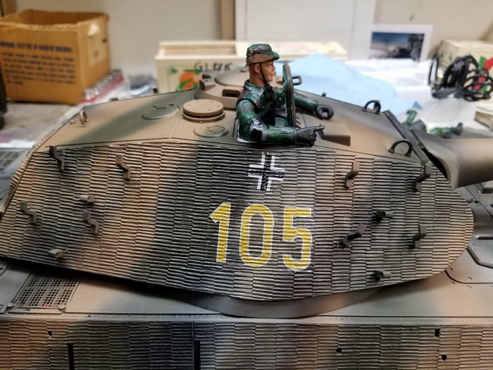

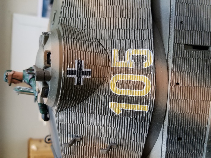

Well here's the result to date - I got to thinking that the issue appears to be one in which the decals are not soft enough to sit properly into some pretty fine cracks, i.e. the Zimmerit. So I got my handy dandy heater out, old hair dryer, and heated them up a bit and used a paperclip rounded corner to push the decals into the proper space. We'' see how it looks in a coupld of hours. But if it will stay there for a period of time I can then shoot a coat of Testors Dull Coat onto it and that would hold them down permanently.

And it appears to be holding. I will pick up a can of dull cote tomorrow. Then I can begin the final assembly!
