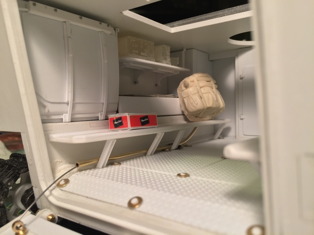

Continuing with the interior. It is far from over but the following picture gives you an idea of where this is going. Yes, I intend on building the central pole with the 2 seats.
Ludwigs M113
Ludwigs M113
An wide interior like this offers lots of potential, making the model something very interesting to build and look at. I am currently accumulating Vietnam era grunt material. I put on a couple of items just for the picture.
Ludwigs M113
Ludwigs M113
Few pictures are available of the battery box on the right. it still need some fine tuning because I had to do some interpretation. And yes, the engine bulkhead will have the red "Danger Monoxide gas" sign on it, an absolute must. I am still wondering if M-113 in Vietnam had the heater that would be installed at the back there.
Ludwigs M113
Ludwigs M113
The seats were a lot of work because of the shape. I am still undecided if I will attempt to create the cushions. Above the seat on the shelf is the AN/VCR-47 radio set (I think) with RT-524 receiver/transmitter on the left and R-442 receiver in the middle, and what seems to be maybe an AN/VCR-46 Vinson on the right. Currently still figuring out the parts to use and the wiring but I found a great source at http://www.radionerds.com/index.php/AN~VRC-12

Overview from above of the interior so far. The floor of ACAV M-113 could be covered with sand bags, but I am not planning to do that.
Ludwigs M113
Ludwigs M113
The ramp elevation push rod was made to go through the seat. Not ideal but it is less intrusive that way because items can be put on the seat to hide most of it from view when seen from the rear. The interior of M113 in Vietnam were a real mess so it won't be difficult.

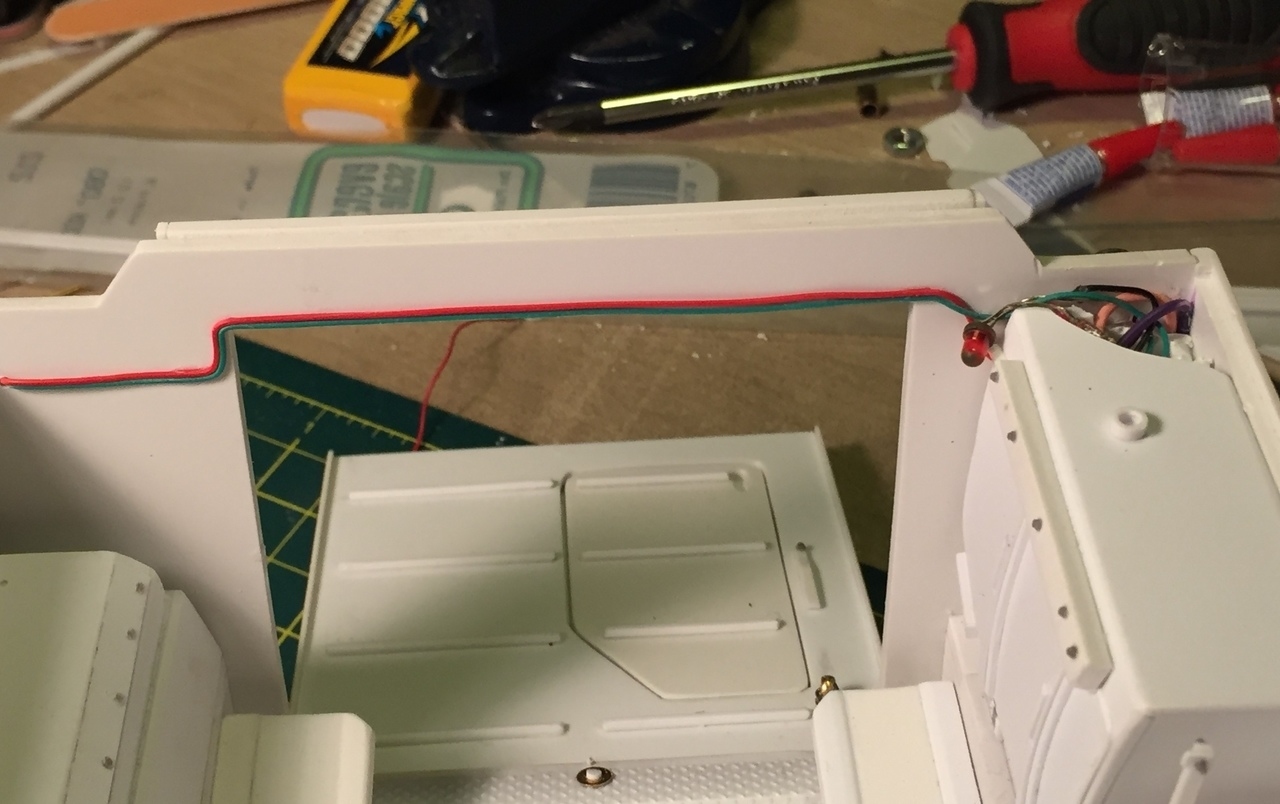

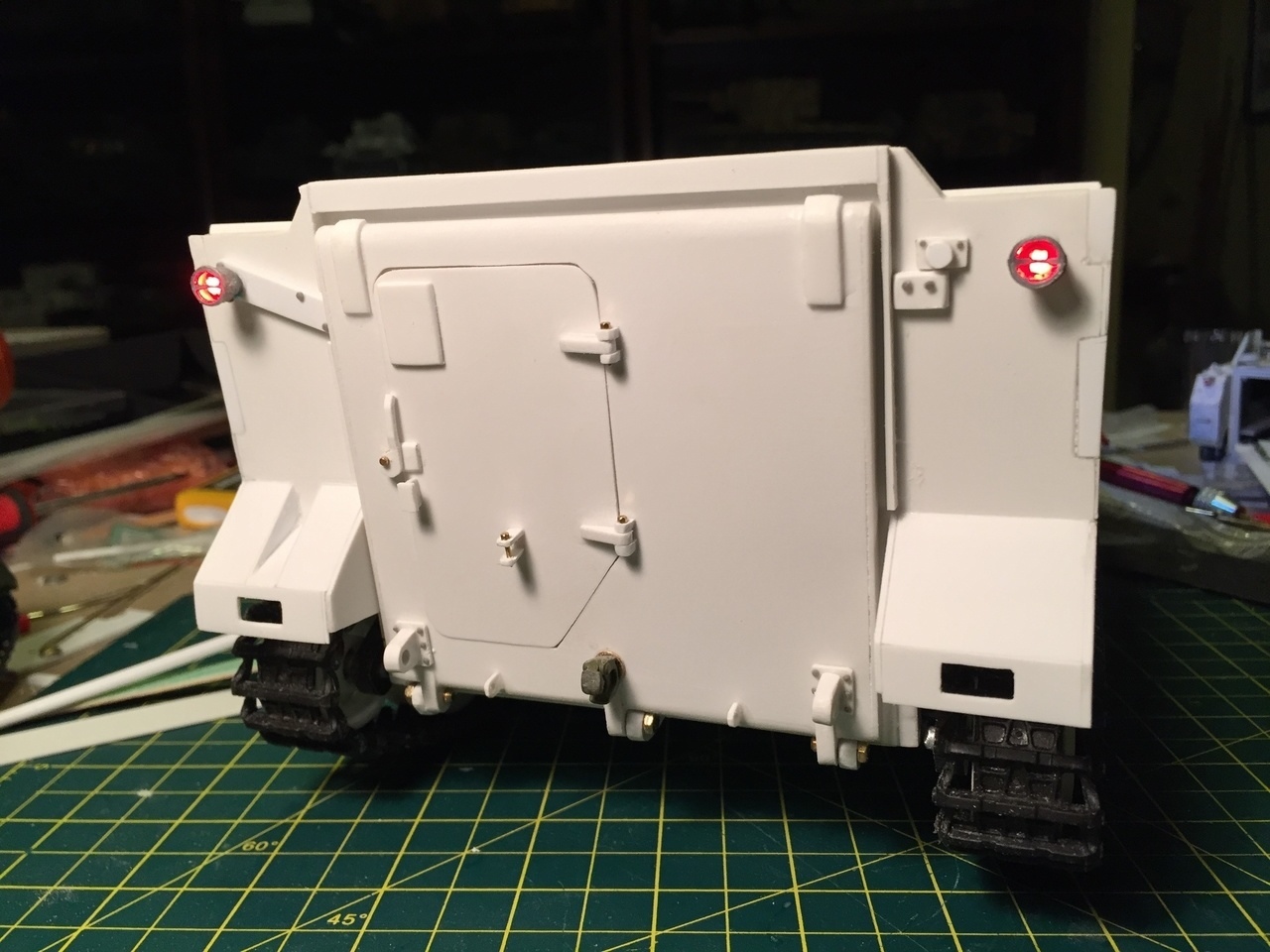

Now finishing the rear panel.
The rear lights are made from Mato Sherman rear lights with the mounting removed using a file, as shown on the right one in the picture below.

Rear lights are installed but I had to cut a section of the top of the gas tank in order to hide the wire connections inside. There are quite a few wires to weld together. It is advisable to plan this ahead of time. You can see the small Heng Long led taken from the spare box and used for interior lighting. It is not positioned on the roof as per reference but this is the best alternative. Ideally, someone would install a small switch to alternate between red and dimmed white light. The hole on top of the gas tank was later covered to protect the wires.

The rear panel is almost finished. The guard on top of the rear lights will be installed later because they are quite fragile and will surely break while I manipulate the model until it is finished.
M113 rear panel
M113 rear panel
The trench like feature on the left mud guard was replicated, not included in kit. The trench seems to be used to evacuate liquid, either water or gazoline, I don't know.
M113 rear panel
M113 rear panel
The door has an external frame that need to be scratch built. The US jerrycans will be installed on both sides of the ramp after painting.

The small red led is properly illuminating the interior for night time lighting in combat zones.
