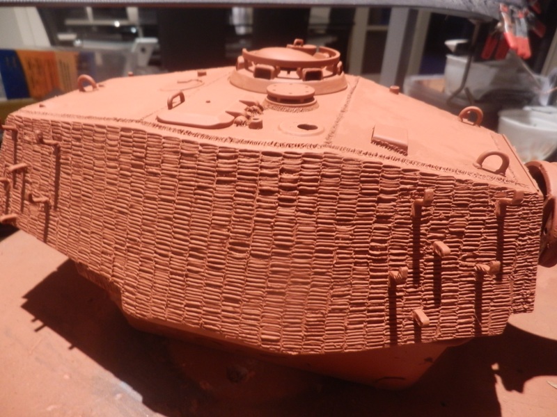

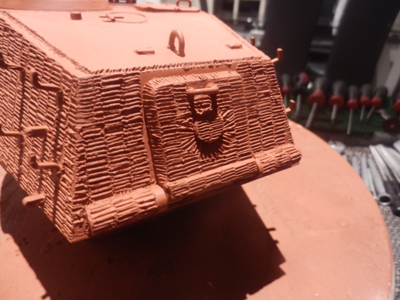

Turret Zim is all done.
A side, front plate and the rear plate & hatch.
Me poor old screwdriver now looks like its got hemorrhoids !!

Wow, that looks so good Herman

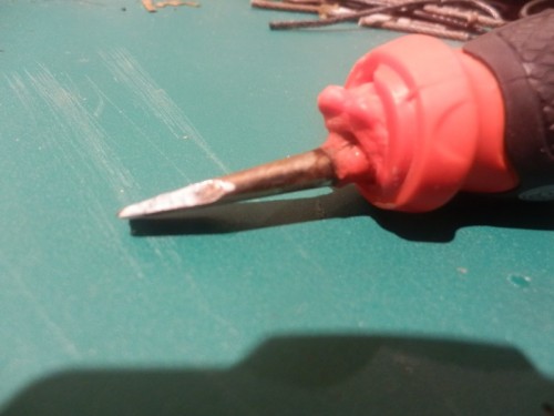

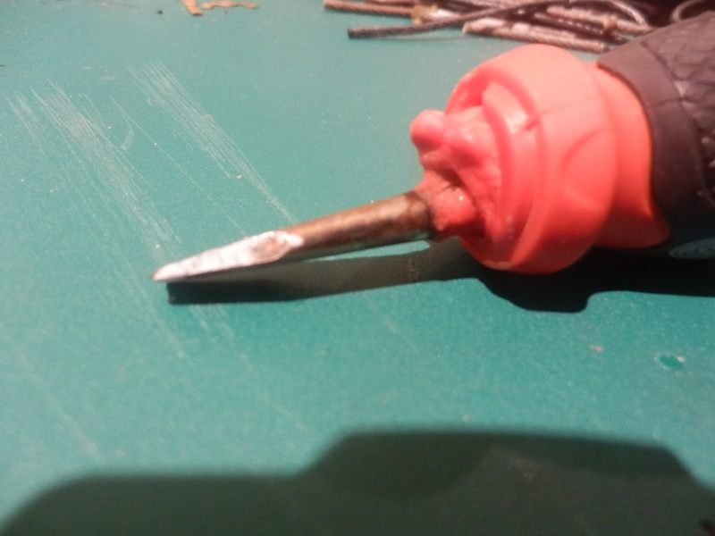

Out of curiosity, how wide and thick is the tip of Mr Locomotive? (Its got a tender behind

Ha!!, pretty close mate. The heat transfer is fairly aggressive by the time I complete a side/section I can tell ya.
I've got a blade shaped burn profile on my thigh from dropping the thing too
Blade tip is 6.5mm wide X 1mm thick.
That works out to approx 4 inches X 5/8 inch in full scale, so pretty close to what Ive seen on real tanks.
Of course that also depends on how deep you go with the blade each time.
As it cools, you need to leave it in place longer, or, keep heating it & do smaller areas...........

Cool, thanks for the driver dimensions
Note; must not drop it whilst hot
