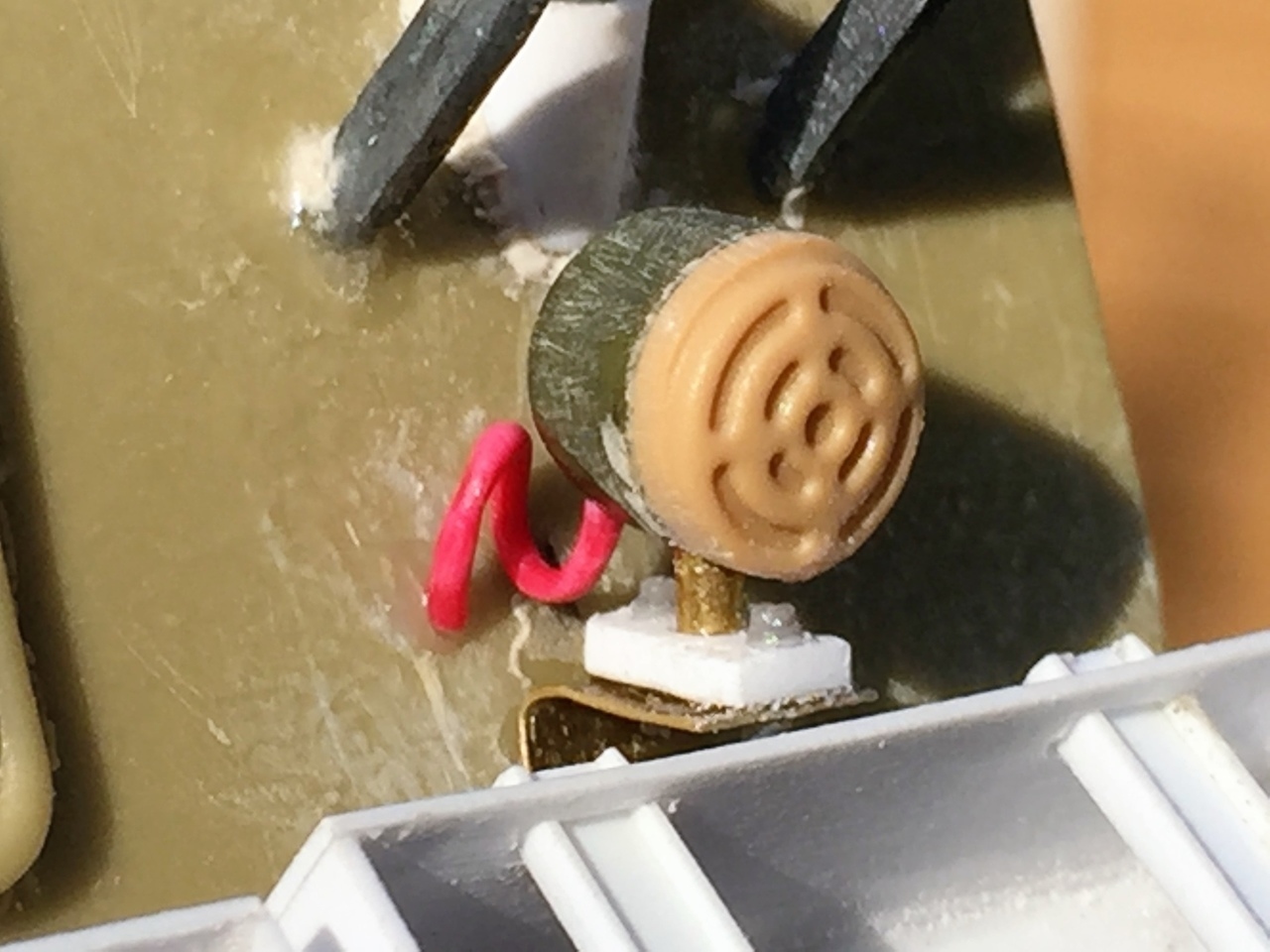

				hi,
Here the boxes for the grousers have been built and installed on the front glacis. However, probably 90% of the pictures of M7 in the field that i saw show spare tracks or the crew's personal items in there, so I prefer to show them with spare T-48 tracks. Use of grousers is likely more relevant for vehicles with the flatter T-51 tracks.
Making the rectangular slots for the boxes need a lot of care. Use of various plasticard sheet sizes, a cutting knife, a metal ruler, superglue and some files allow items like this to be built with good accuracy, cheaply and without too much complexity.
An M7 mid production horn has been built with the material that was available. You can see that the model is quite dusty with all the sanding that is required on such build. I good wash will be required before priming.
The Vandra kit provides the gun locking mechanism with convenient hinges to glue in the floor. However, I could not find any photographic evidence of hinges on this item. Reference show this item to be fully removable and when it needed to be put in place, the legs were inserted in slots on the floor of the fighting compartment right under the tail of the cradle. I have yet to build those slots in the floor. The kit part is accurate in shape and form but can be further enhanced for accuracy by making it thinner and reinforced as shown. There are very few available references on this item.
The M7 is fully loaded with Shapeways.com fiberglass containers and some of the ammo provided with the kit.
Regards, Louis
