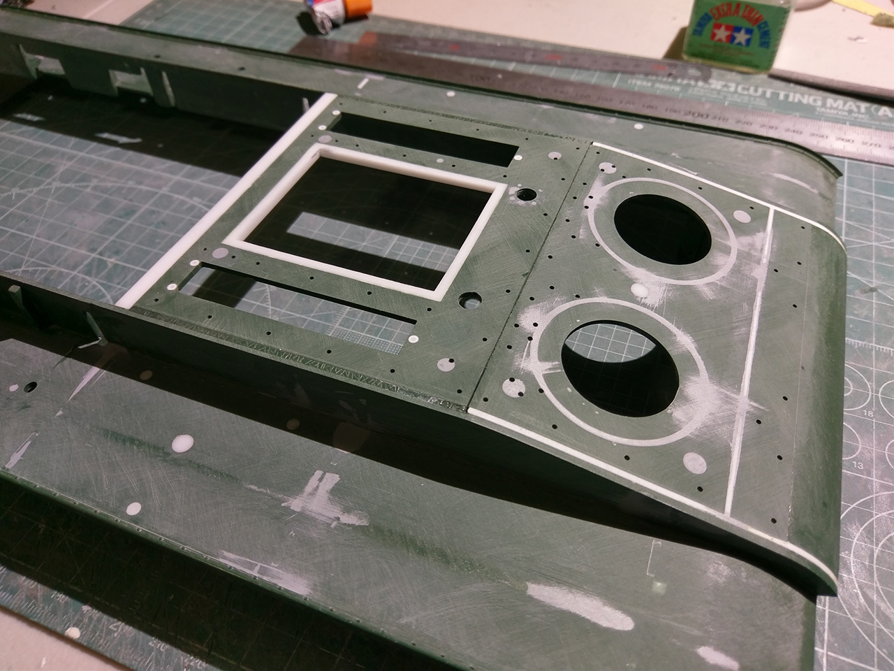

Mostly just filling and sanding in the evenings this week, getting the upper hull prepped and ready for texturing. I've also marked and predrilled all the holes for various bolts, hinges, lifting points and exhaust pipes. The back deck is going to be a pretty busy place!
I'll use Mr Surfacer 500 to create the same rolled steel effect as on the lower hull. This will tie together all the disparate materials the vehicle is made of (ABS, aluminium, styrene, white metal) and make it all look like it's actually the same stuff.

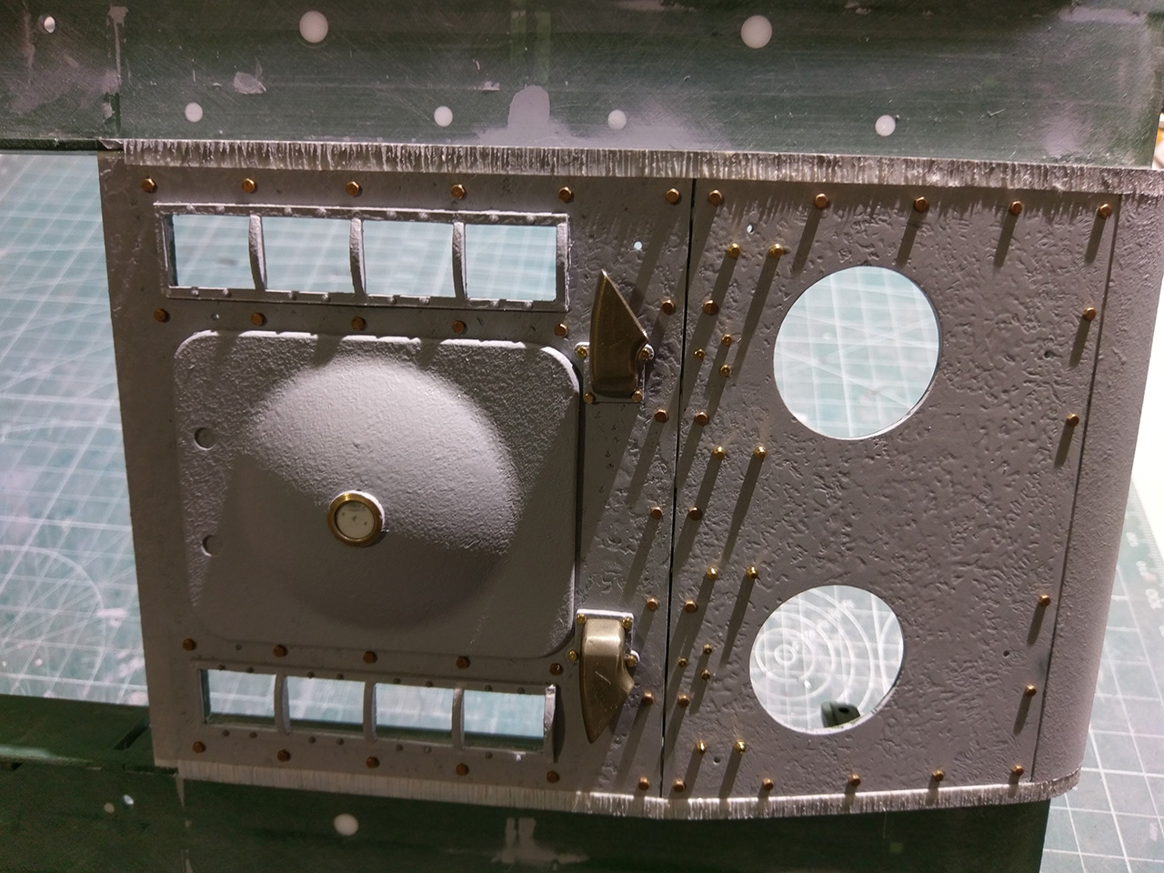

Getting on with detailing the back deck. All the flat armoured panels have been textured with Mr Surfacer 500 for a cold-rolled steel effect, and I've used the same hot-knife technique on styrene strips for the torch-cut edges to the side armour. Lots of little brass bolts from Knupfer; the eight predrilled holes that remain are for the covers' lifting eyes. You guys make this scratchbuilding stuff seem a lot easier than it really is! The air intake covers and exhaust brackets are built up from styrene, just waiting on some bronze mesh to do the grilles.

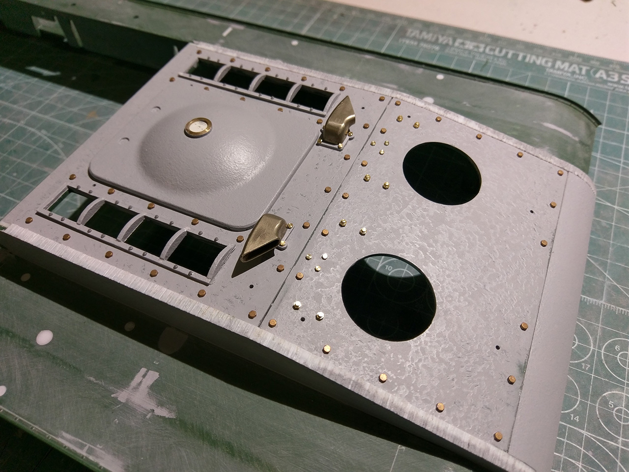

Still on the to-do list for the back deck: tankodesantniki handrails, engine ventilation louvres, engine hatch hinges and opening stand, transmission hatches and the aforementioned lifting lugs.
Lit up at a grazing angle to highlight the different textures.

The texture is really nice. What I found with those brass screws though.these are in my opinion too sharp on the head. Using a nice fine sanding sponge breaks the corners and looks much more to scale.
The exhaust outlets look fantastic. Did you make these yourself from brass sheet?

That's a truly enviable touch you have there, Dan, with the Mr Surfacer :clap: Simulating casting surface marks, and pitting, is one of the hardest things a scale modeler can do, I think, especially when it's essential to retain the scale of the flaws for the sake of that 'authentic' look. Here, you've provided an example of how it should look. :thumbup:
On commercial RTR models, I always thought that the Taigen T-34 (metal edn.,) had the best pitting effects (Turret), until the JS2 lurched onto the scene. Kept in scale, subtle casting and production (forging etc.,) marks can be really gaze-grabbing.

Incredible I salute you! Do tell the secret behind those brass exhausts
