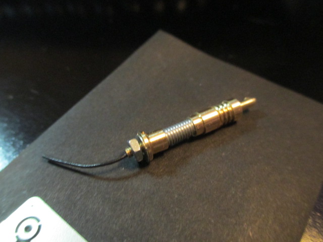

Back from the Holiday ( and so was the Post ) Got a couple of needed items in, the diamond plate decking material and the U.S. Antenna mount. I started out tonight with the antenna mount and while I was able to assemble the correct antenna and base, the actual brass mount included is more for a truck or halftrack ( which will come in handy later ). I will get out some styrene tomorrow and scratch a correct mount for this TD and epoxy it into place. It is a simple flat and single upright welded to the M4A3 hull by the Radiomans side headlight and shouldn't make too much of a fuss ( famous last words ) ;o) Pics of tonights progress:

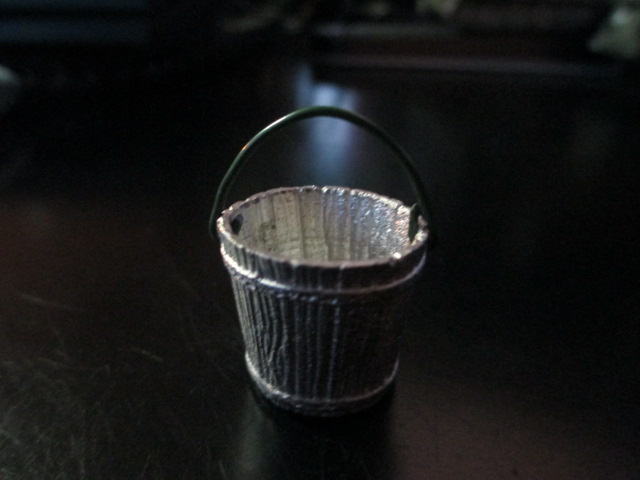

Bucket handle installed
Bucket handle installed.JPG (75.98 KiB) Viewed 3693 times

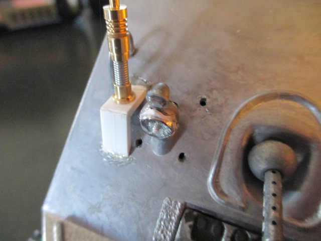

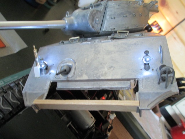

Not much going on tonight. No Post so I went back to working on the antenna mount. Also, I removed the MATO headlight covers and am in the process of ordering either a Tamiya or Schumo set. Pics:
Hole drilled and wire glued.  Headlight braces removed.  Loc Tite Epoxy added to simulate a weld.  The base is screwed into the plastic beam.  A nut and washer hold it in place.
Hole drilled and wire glued. Headlight braces removed. Loc Tite Epoxy added to simulate a weld. The base is screwed into the plastic beam. A nut and washer hold it in place..JPG (92.91 KiB) Viewed 3674 times
Mount created out of one plastrux beam.  Cut to measure, 45 degree angle end filed and triangle filed to fit together at a 90 degree angle.
Mount created out of one plastrux beam. Cut to measure, 45 degree angle end filed and triangle filed to fit together at a 90 degree angle..JPG (95.72 KiB) Viewed 3674 times

Details incoming :). Question, you went with a scratch styrene support for the antenna. What was wrong with the piece shown in the aber instructions, was this not included in your kit?
Posts: 7877
Re: 1944 M36 B1 Tank Destroyer
Good morning, Doc,
I had mentioned in the previous Reply that the included brass mount looked like it was for a truck or half track and that I would save it for another build. The mount depicted in photos for the M36B1 is as I built it, a simple, open 'L' welded to the front glacis. ;o)

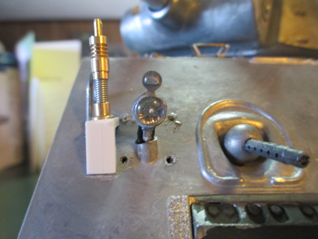

It was your experience with the guards that led me to remove them, John. One came off whole and the other one broke in two pieces. I'd already sent MATO a letter on their website mentioning how nonsense like that really hurts their business and the Hobby as a whole. They never got back to me but they never will change unless lots of people complain so it was time well spent. The Schumos I ordered will be a much better fit for a 700.00 tank destroyer, eh? ;o) They are part of a general Sherman upgrade pack so I'll get a couple of other things that will help the M36B1 shine. Speaking of shining, I've not had the upper plugged back into the lower again yet. I'm working on the turret interior currently. I will test and let you know how they worked.
Posts: 7877

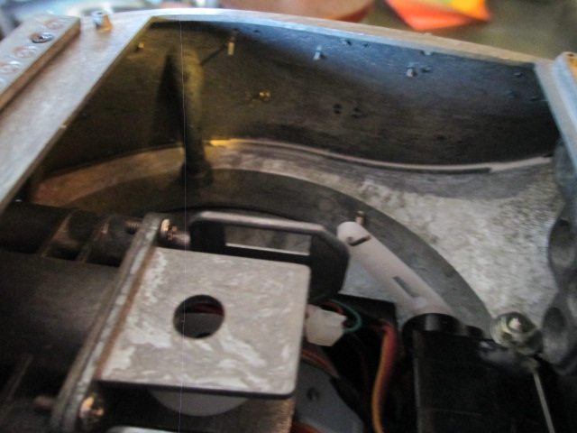

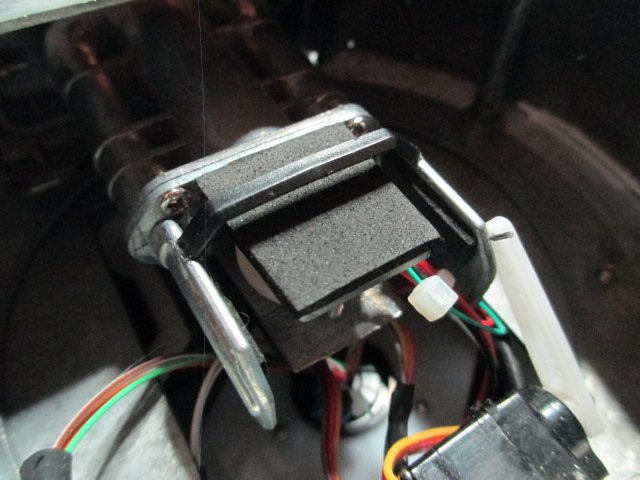

Nothing in the mail today and threatening weather cancelled all my outdoor projects to boot. Plenty to do on the M36B1 so I went to the counter and spent some time looking it over for hull gaps and seams, etc. I filled the obvious ones in the two piece turret and cleaned up the bow MG mount. The headlights did work, John, I was pretty pleased. Looks just like a bulb in a lens. For bigger ones like the KV-2, I will just use a bigger bit. They had some light gaps round the edges so I filled those in. The paint later will finish off any escapee beams there. Lastly, I did some work on the main gun to make it look a little more authentic to the passing glance. Pics:
Gun breech somewhat simulated by a flexible rubber piece with an added crossbar and rubber blocks on the sides.  The top is flexible to access the servo screw adjustment.

The headlight lens idea pans out.
The headlight lens idea pans out..JPG (98.14 KiB) Viewed 3600 times

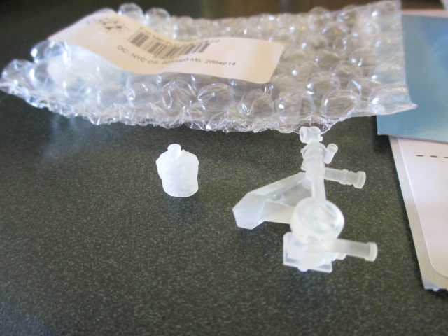

A platoons worth of canteens and a gun sight for the M36B1.  I am pretty pleased with the quality of these pieces.
Fridays post brought some anticipated pieces.  My first order from Shapeways
Fridays post brought some anticipated pieces. My first order from Shapeways.JPG (81.07 KiB) Viewed 3600 times
