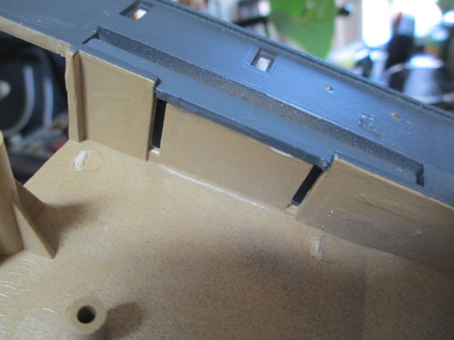

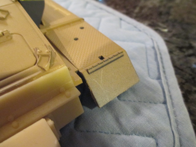

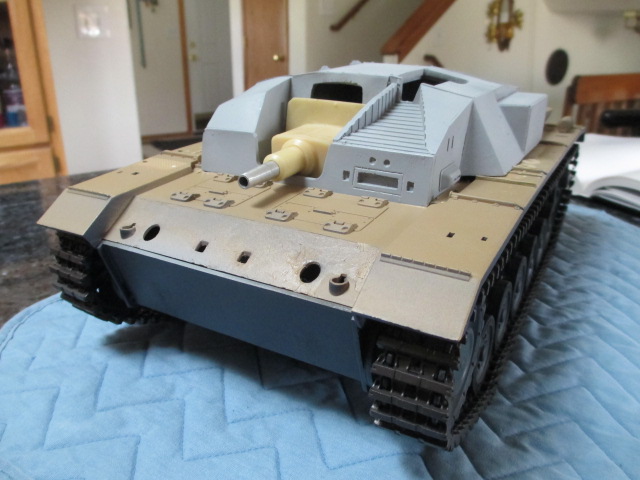

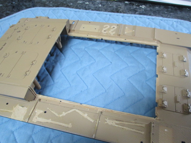

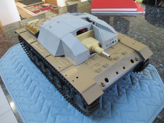

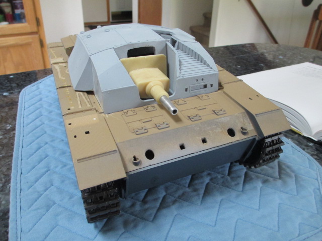

Took a little time today to get the casemate matched up with the upper deck. In the end I had to use the Dremel for straight line cuts then used a variety of files to clean and square everything up. The resin parts are nice and heavy duty and file like the best plastics. Next I will need to figure out a mounting system for the casemate to the decking. The decking I plan on screwing into place like a regular HL version so no issue there. I want the casemate to be removable for maintenance and smoker oiling. Pics:
Still a lot to do...
Still a lot to do....JPG (99.75 KiB) Viewed 4377 times
Looking a lot more like the Tamiya model that I'm going off of.
The lower warps in a little on the Loader's side.  I will fix that with a brace.
Starting out with the original cuts

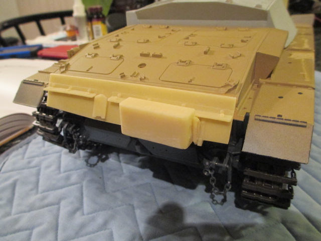

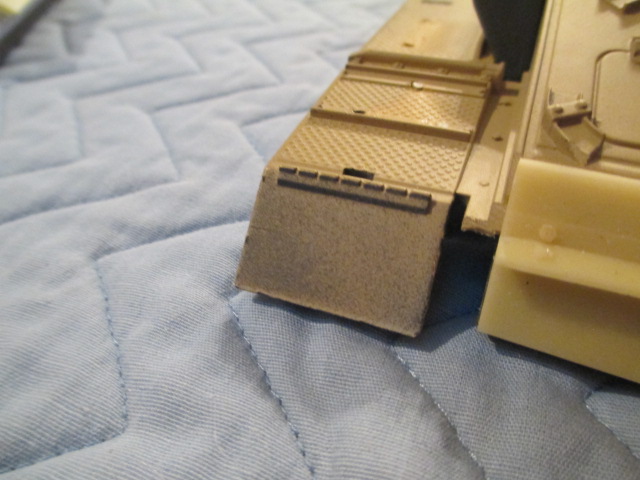

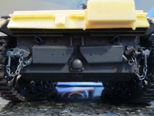

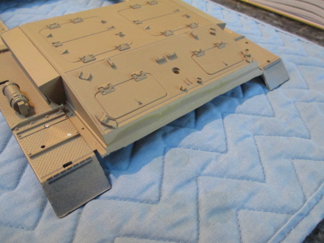

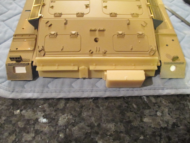

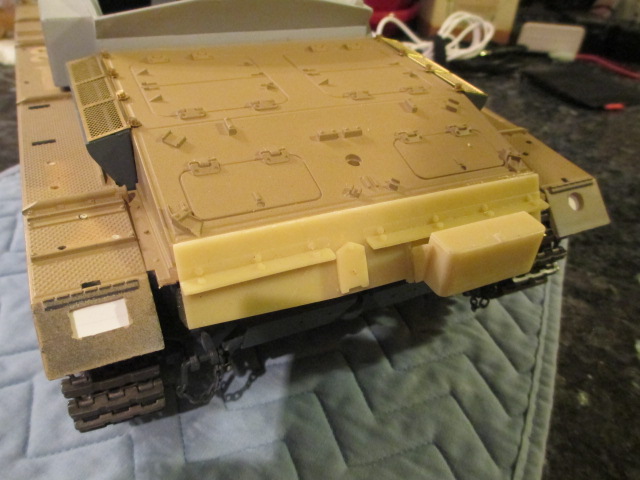

Thank you, Ed. ;o) The early StuG Assault Guns have a certain pugnacious air about them it is true. Tonight I worked on cleaning up the rear of the deck and getting a little resin mounted. Instead of cutting off the entire rear face, I removed the 'L' channel that runs through the center with a razor saw. Taking a couple of larger files then, I filed and sanded the rear face smooth. This gave me a larger surface area to cement the new resin plate and channel on with than if I had just removed the old plate entirely. Pics:
Next up for the rear is that vent box and screens that fit up under the lip of the rear armor plate.
New resin plate and channel along with the new for 41' covered smoke grenade box.
New resin plate and channel along with the new for 41' covered smoke grenade box..JPG (97.38 KiB) Viewed 4354 times
Rear face with 'L' channel removed and the remainder filed and sanded smooth.

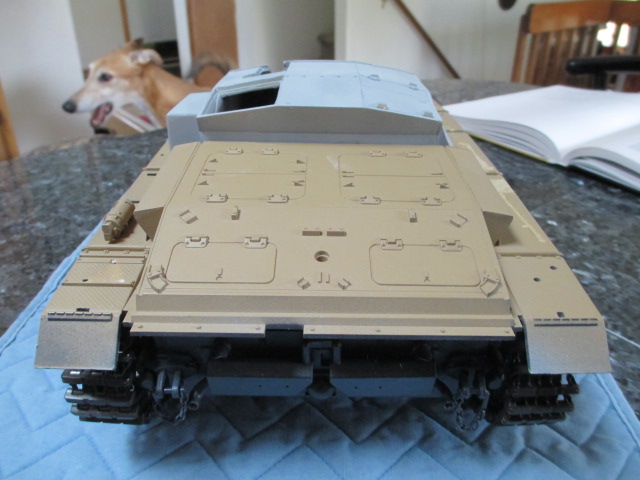

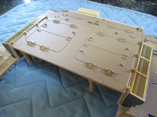

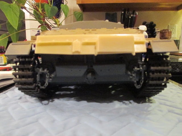

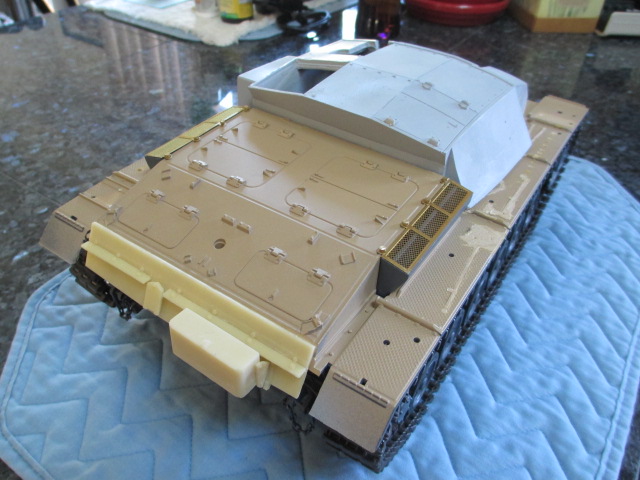

As promised, a little more work on the rear Deck along with some pondering on that full width air grill under the rear armor plate. Pics:
Really starting to match up with the Tamiya model.
Satisfied with the progress made today

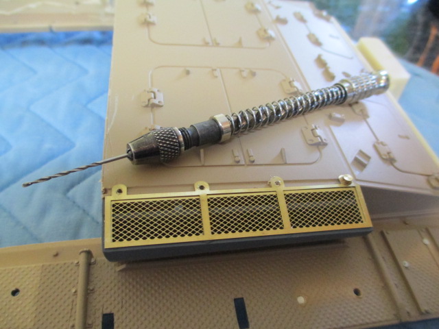

Using my Yankee Drill, holes are prepared for the bolts that add to the appearance and mounting of the PE brass screens and grills.
A huge improvement already...
A huge improvement already....JPG (97.42 KiB) Viewed 4321 times
The replacement Taigen upgrades are a very nice recreation of the real thing and snap into place just like the originals.
The replacement Taigen upgrades are a very nice recreation of the real thing and snap into place just like the originals..JPG (96.55 KiB) Viewed 4321 times

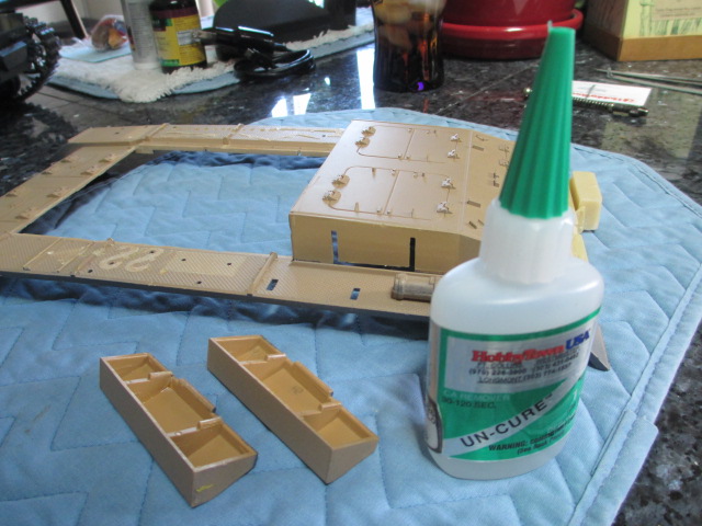

A couple of drops of 'Uncure' help make the removal of the stock HL airboxes a snap (no pun intended)

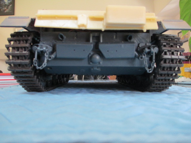

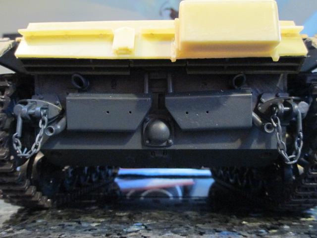

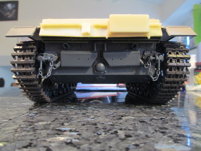

Beginning work on the 14th, we have a fine early StuG 'B' rear bulkhead to admire.
Beginning work on the 14th, we have a fine early StuG 'B' rear bulkhead to admire..JPG (86.6 KiB) Viewed 4321 times

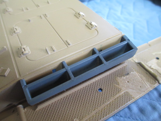

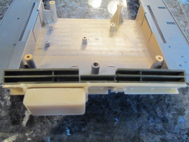

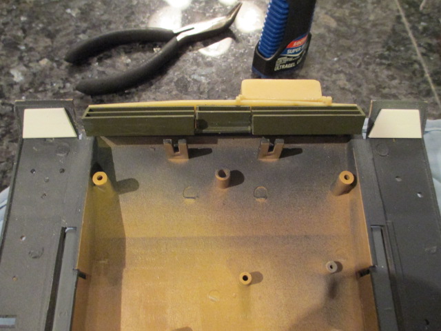

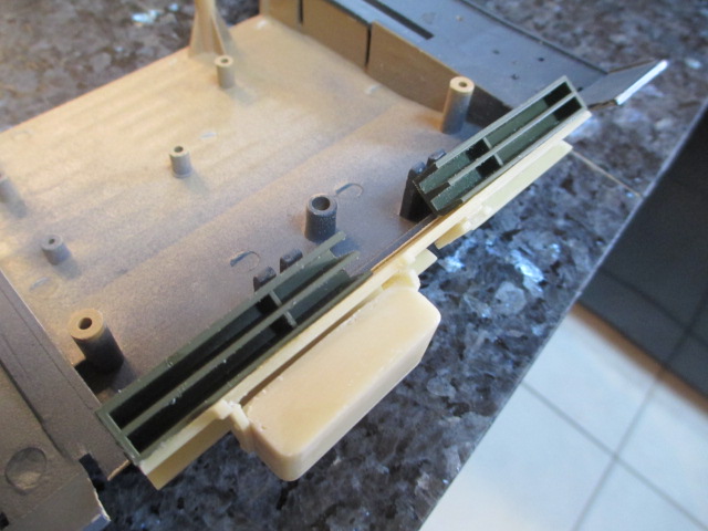

The spare Sherman Exhaust deflector worked out very well as raw material for the StuG's exhaust deflector\air vent\?. Not without a boatload of cutting, filing and gluing tho'. The end result is a solid mount and looks almost exactly like the real article. Pics:
Closeup.  The grill matches the StuG book illustration very closely.
Not too shabby
Not too shabby
Center two louver box that fits over the exhaust pipes to the mufflers.
Parts left over after cutting out and filing down the main three louver airboxes.
Initial right and left boxes
(Repeat to give an idea of what I started with)

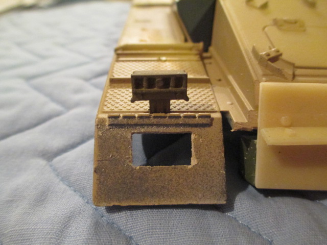

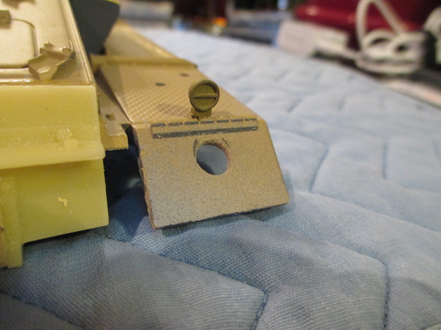

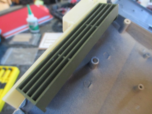

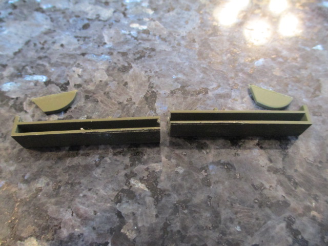

Back from an extended holiday weekend, I wanted to pick up work on the StuG again. Tonight's work seems small scale ( pardon the pun ) but it is critical to the appearance of these early StuGs. Pics:
I ran out of time to do the fine detail on these and will complete the next session..JPG
The StuG look regained
These braces were created from two pieces of styrene glued together then cut to shape.  50 or 60 strokes of a medium file thinned them down to proper  (HL scale ) thickness
Per the StuG book
Per the StuG book
Per the StuG book.JPG (98.47 KiB) Viewed 4266 times
These cut outs were done by drilling then connecting the holes.  Final appearance used a small dressing file.
These cut outs were done by drilling then connecting the holes. Final appearance used a small dressing file..JPG (98.83 KiB) Viewed 4266 times
Plain Jane HL Right
Plain Jane HL Right
Plain Jane HL Right.JPG (92.31 KiB) Viewed 4266 times
Plain Jane HL Left
Plain Jane HL Left
Plain Jane HL Left.JPG (98.81 KiB) Viewed 4266 times
