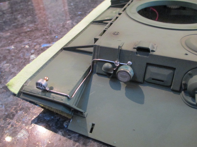

Billpe, you would be well served by one. ;o) Not much going on tonight, hands are still recovering. I did the faux electrical wiring from the one siren over to the horn and headlight. Tomorrow I need to add the real wiring of the NOTEK light and then finish the siren on that side. Pics:
- Another view showing the junctions added at the original horn and headlight.
- Another view showing the junctions added at the original horn and headlight..JPG (90.93 KiB) Viewed 4355 times

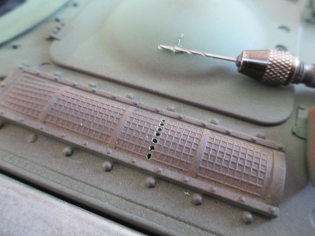

*chuckles* I have a nice Tamiya horn on the sprue but this horn is metal so I left it alone. Looks reasonably good. The wiring junctions will look better under paint as well. Today I have to tape or find plastic tubing thin enough to mimic the solder I am using for the faux wiring so that I can run the wires for the NOTEK light through it. Or run the wires under the fender for a very short stretch into the deck section, etc. That might be better, it would allow me to run fake wiring for that light into the other for the siren on that side. I will have to see. I love problem solving ;o) I see your point on the plastic vents. A couple hundred quick drills with the yankee drill and they could be made functional. It would weaken the structure of them a little since they are hollow backed but I could strengthen the plastic ribbing with spring steel rod or strip. More to think about. Thanks for the ideas, my friend.
Edit: I used a #63 drill on the yankee drill and opened up a row on the plastic grill. It's doable but it doesn't have the appearance I am looking for ( round vs square holes ). I think it would make the grill super fragile to open up all those holes as well. I am probably going to salvage the surrounds or order a set from An-Bri-RC-Modellbau.de and use them in concert with the Tamiya photoetched grills. Pic:

- Not quite what I am looking for and hard to keep in line as well
- Not quite what I am looking for and hard to keep in line as well.JPG (92.34 KiB) Viewed 4339 times

You tried drilling out the grill!!!!!!!!!!!!!!!!!!!!
... That's crazy!!!!!!!
...........I drilled a hole in each corner also between the "frets" then one in the middle and just ground it all out with the ol' dremel ...put two brass rods on the underside...built up the tapered end so it was square like the rest of the "frets" and covered it with mesh...used household mesh as they were the most similar to what is shown in photos
But I have a strange feeling you are going to order the metal vent covers

Yessir, I could have done it but it wouldn't look right and a hard breath would break it so yep, ordered the Tamiya grills for the tank this afternoon.

I don't know.... that first hole looks a tad on the linePainlessWolf wrote:Alpha,
Regards,
I give you cred for getting that far
