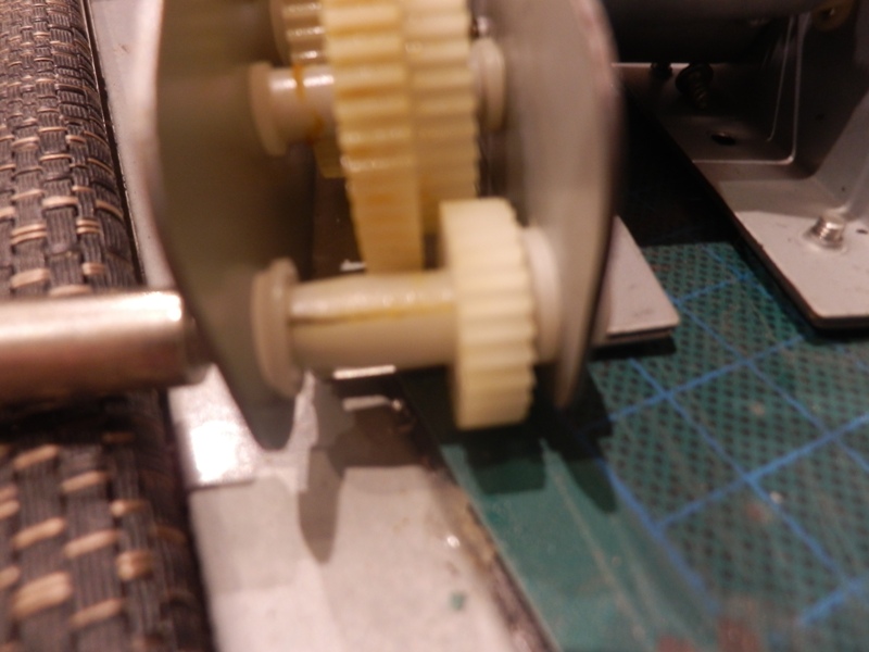

I remember back to when I put this to the test, and the nasty squark that I got as I turned it.
Plastic gears cannot cope with metal running gear.
My pinion shaft split !, that was the noise of gears spinning on each other going nowhere
Sorted now with Taigen black steel gears.

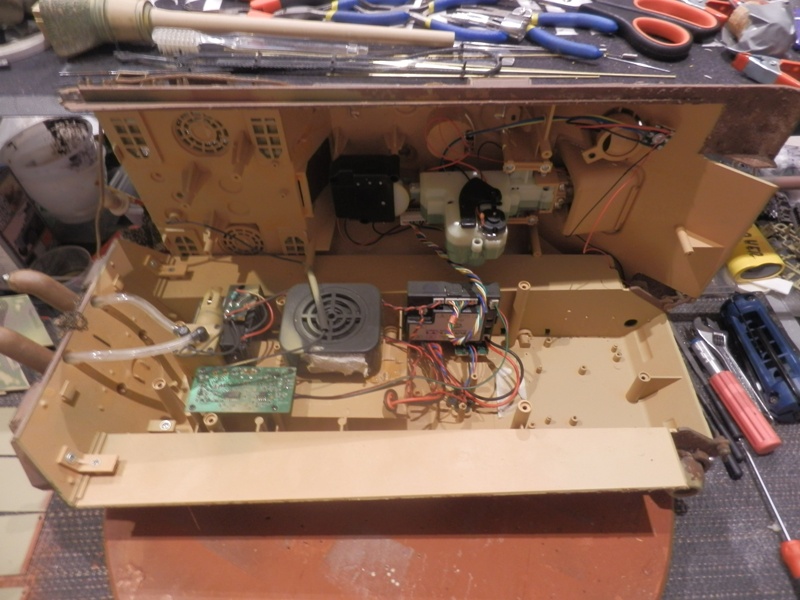

I will order a 2.4Gig radio set for it as well, while Im in there.

Yip, it is that, and unused to failure of the shaft as I am
, this was quite the thing
Ive got a 2.4Gig set in the shopping cart from Tank Army, but wont get that until I secure my crew men that a rather inconvenient car rego put the brake on
Once the radio is in, I can complete the new suspension install and get the schurzen mounts & plates done.

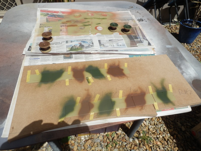

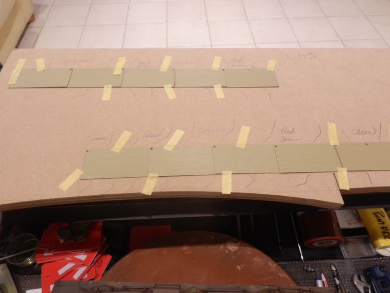

Figured out a way of matching the new camo on the schurzen to the existing pattern.
Taped the plates to a board & lined the tank up next to them. Shot reference points from the camo lines down onto the plates & marked them accordingly.
I should be able to get a near enough match that will be ok to the eye once all the weathering & dirt goes on.
Made the new brass mounts too, these schurzen plates will simply hang in place, so might be some interesting moments when the tank is out in field.

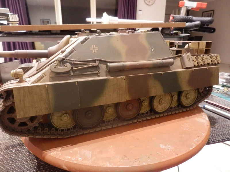

Got the camo on the 'bag-tags' just now.
The plan of pre marking seems to have worked, now its a case of wait for the radio gear to arrive, secure the upper & lower hull, then reinstate all the running gear.
Then place the schurzen mounts & wash it all in.

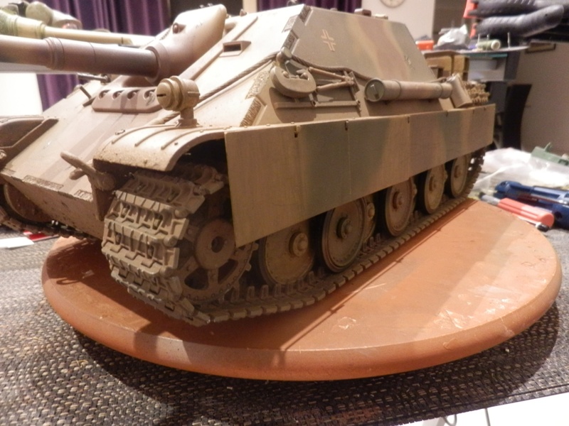

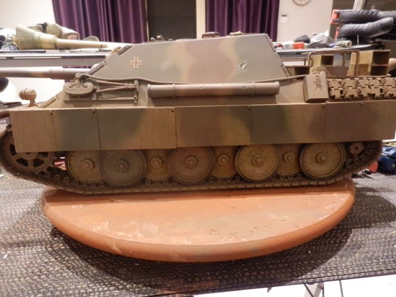

Fitted the metal running gear, and skirt hangers, got frustrated at waiting to get the radio gear so just pushed on with finishing the upgrade.
Dusted over the new paint with a thinned XF-52 over the top of a wash of MIG 1000 Brown for German Dark Yellow and it seems to have bought the old and new together pretty well.
All I need to do now is talk 'Von Runstedt' from Hobby Havoc/NBRCTC into airbrushing the crosses on instead of the decals I used.
The "bag-tag" schurzen turned out ok

You've done excellent work here and it really shows. The stand out armor plates are marvels! I didn't think that you could make this build improve to this degree and I am pleased to be wrong. I'm also glad that you got rid of the HL frogeye led. You sanded the led down before you installed the cover, right? The reason I ask is I see two mounting rings there and they should be right up against each other. Following along, my friend.
