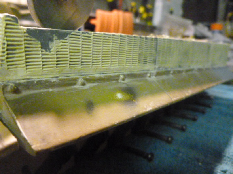

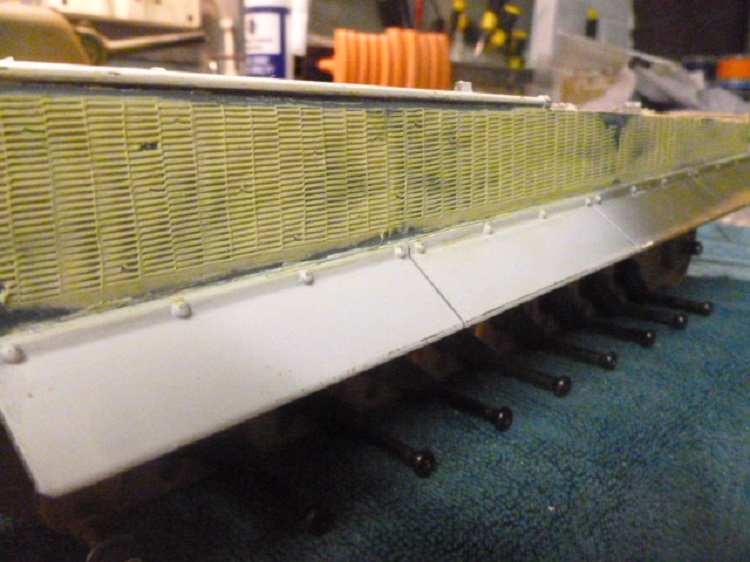

Zimmerit applied to sides
Back onto my build over the last week off work , first on the list of jobs was Zimmerit for the hull sides , although not correct following the original photo of Tiger 131 I decided to add some damage to the zimmerit in selected places .
Milliput Zimmerit right side with some damage
Zimmerit to left side

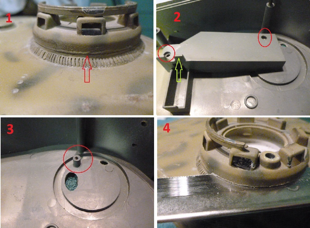

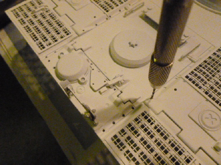

Using a pin drill, I ran around the features and restored a little detail as this Hull has had several coats of paint
Hull top bolts holes relieved with pin drill
Front mudguard bolt holes restored

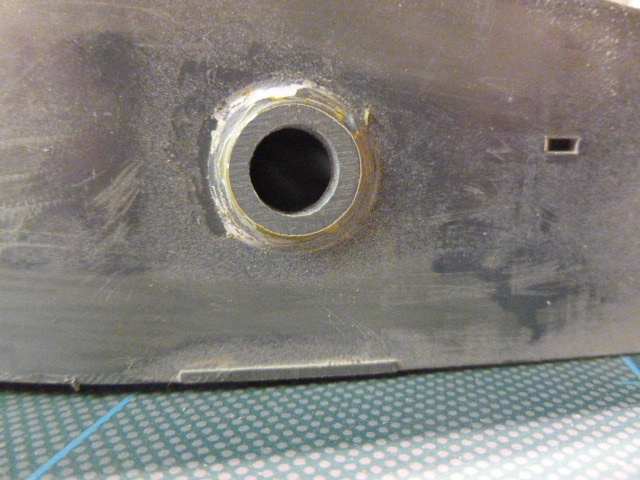

Some changes are simple once you know what they are, 1st example is these moulded engine stop "catchs" on the rear Hull. These needed removing with a file and a more accurate versions built from styrene added to both sides of Hull
These HL profiled stops need to be removed and replaced with correct shaped replacements in styrene ( Click for larger image )

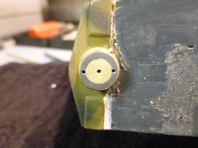

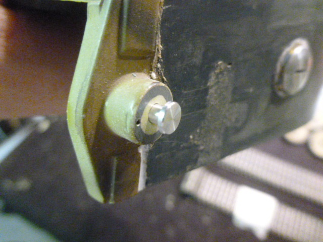

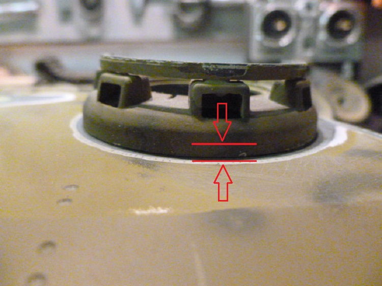

Another feature is the tightening lug on the forged engine intake cap was removed toward the Autumn of 1943 once the deep wading requirement was dropped earlier that year. The stud in the centre is the head of a dress making pin cut to length and inserted into small hole drilled into cap.
Deep wading tightening lug filed off and replaced with stud (Click for larger image )

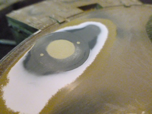

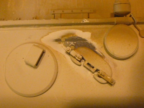

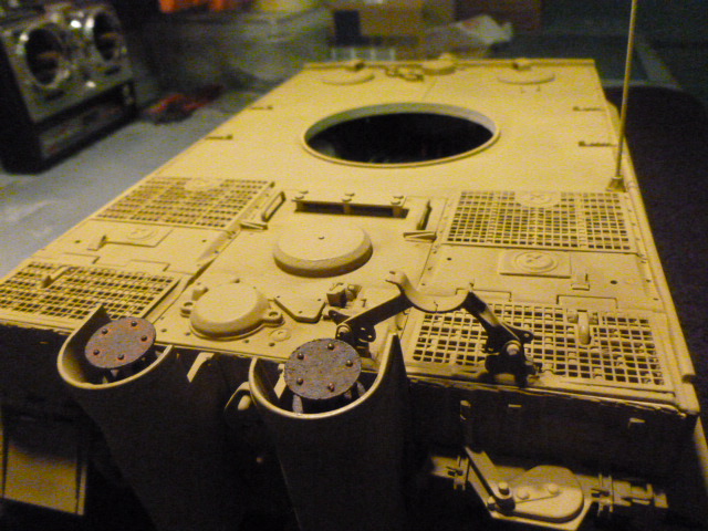

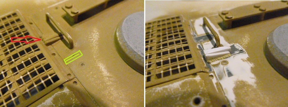

Toward October of 1943, the locking latches under the engine main hatch lifting handles were moved further rearward to behind the lifting handles.I removed the copper handles and with a combination of a sharp knife/file/rubbing block removed it and made 1.0mm styrene replacements for each side.
Corrected location of engine main hatch locks (Click for larger image )

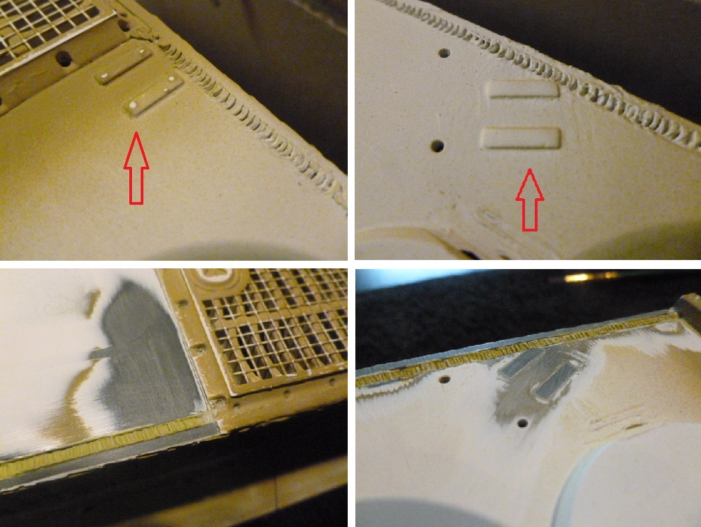

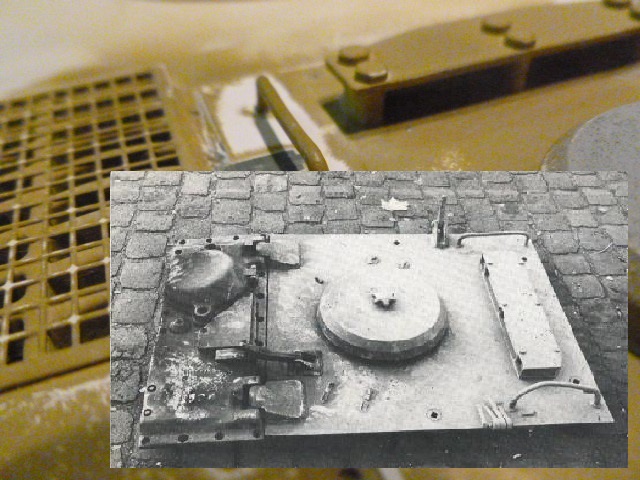

Also around the Autumn of 1943, the S-mine mounting plates that were fitted from December 1942 were no longer welded to the Hull. These were filled off from my Hull and at the same time I decided to rework the weld lines again with milliput but using a fine watch makers screwdriver to simulate weld.
S-Mine plates removed from Hull as these were deleted after October 1943<br />also weld lines reworked. (Click for larger image )

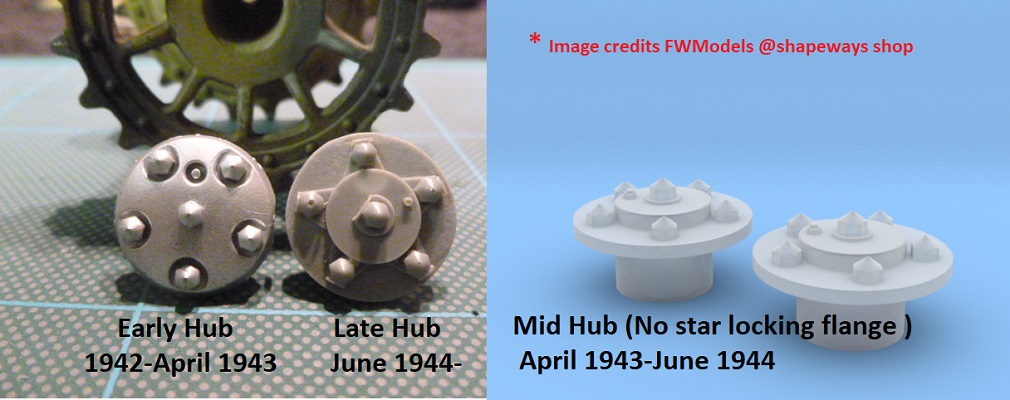

At the time this build was starting, a common addition for any Mid/Late production conversion were the replacing of the domed sprocket hubs with the late "flat" style. Only upon reading the book did I realise there was a specific version for Mid Production Tiger's. The one's I had purchased(Schumo)were period incorrect and meant for Late production.I decided at the time to scratch build them nearer the time.Good job a few years on and with the advent of the 3D printer we can now (2019) have an accurate copy of the real thing :thumbup:
Early, Late and Mid Production Drive Hub centre caps (Click for larger image )

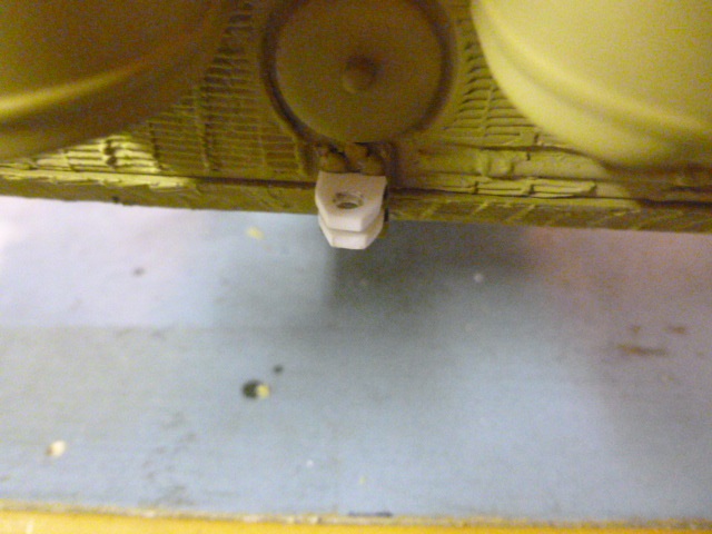

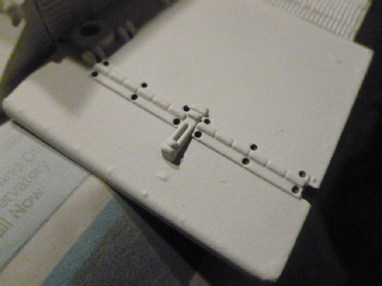

At the time of correcting the rear panel to remove the tell tale HL joint line I had failed to notice the missing tow hitch plates.These were added in styrene made from 2.0mm sheet and bonded in.
missing tow hitch fabricated from styrene.

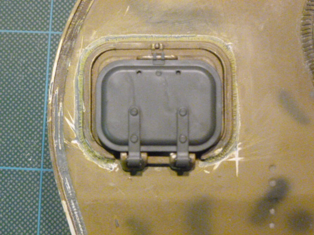

18-Addition of a correct flat bezel, working opening escape hatch on the right hand side of the Turret.

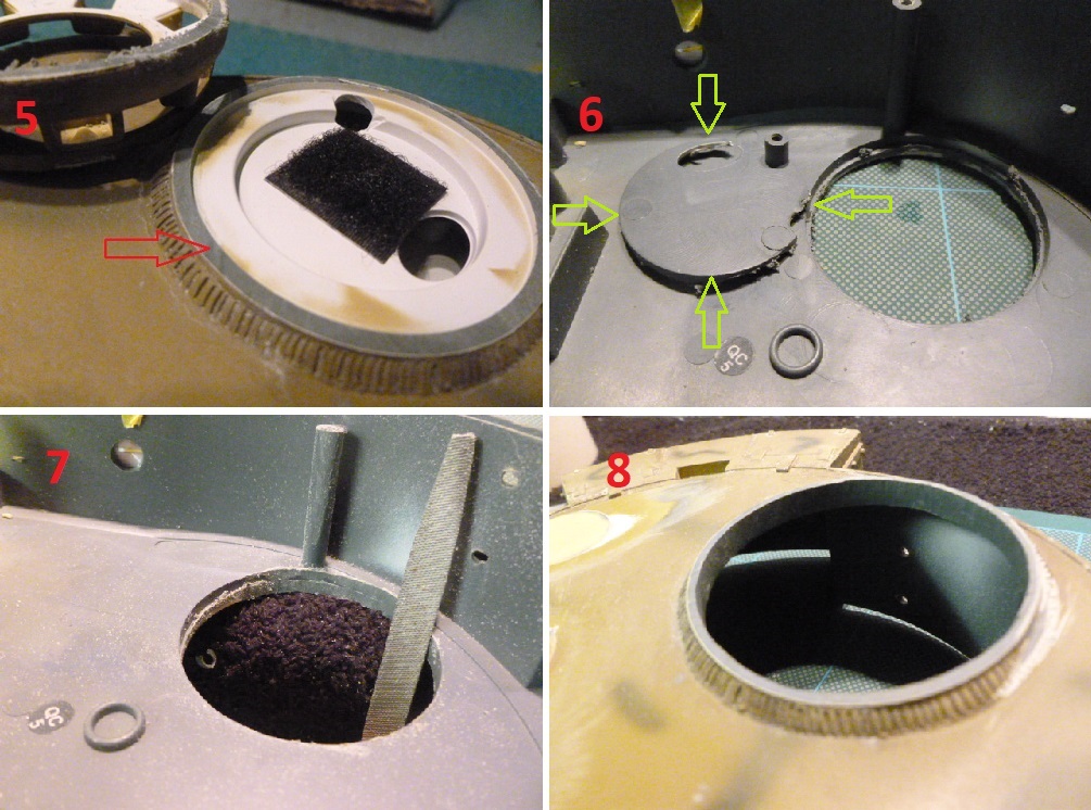

19-Replacing the Asiatam metal Mid cupola with a more accurate profiled Mid/Late Hachette example with Periscopes and detailed with PE and styrene.
20-Cutting out the HL loaders hatch and grafting in a Tamiya version (hatch and lid) which is more to scale. Detailing these with PE and styrene.

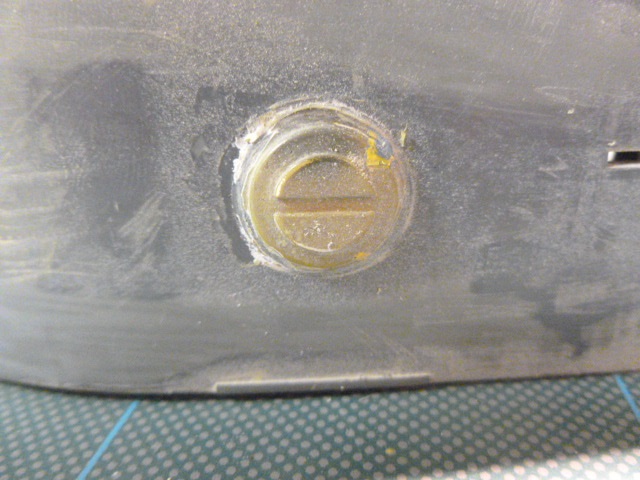

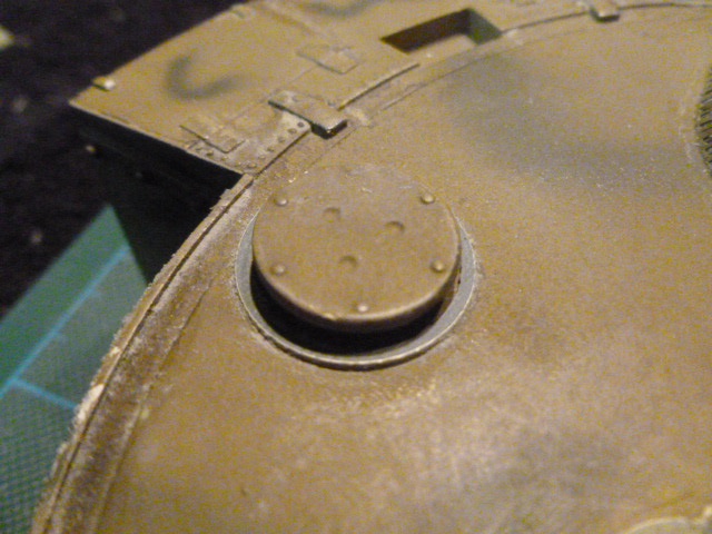

First on the list was some easy jobs, this Turret ventilator was moved to a more central position after July 1943, so it was carefully removed .The replacement vent will be added at a later date. The small ridge was filed off and after plugging the base with styrene the hole was restored with Milliput.
Original location of Turret vent moved to central location beginning July 1943
After prizing off original cover, filing of raised lip, the hole was plugged with a styrene blank and filled with milliput.

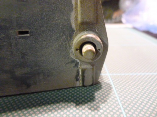

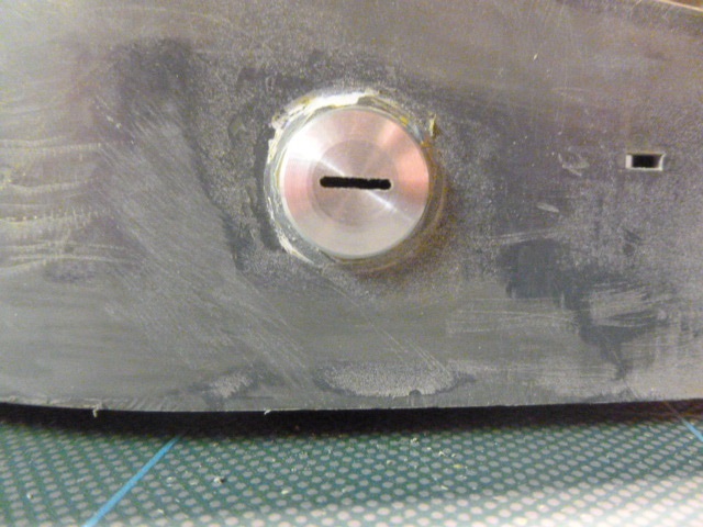

Next on the list were the front pair of " Pilze" lifting lugs. These are the wrong hollow shape and size on original HL Tiger turrets,its a simple fix thankfully .
Incorrect profile to Turret lifting lugs (Pilze)
After drilling out the plastic centre pin, I then filled to void with Milliput and carefully restored the two outer drill marks as well as a centre for the replacement Pilze.
Hollow centre of lug filled and drill markings restored.
These replacement Pilze from Tank Modellbau come as a 3 part set, one for each side and one for the rear of the turret. After a suitable size drill was used they were set in using two part epoxy resin .
Correct profile lifting lugs from Tank.modellbau.de bonded onto re-profiled base

The Mid-Late Production Cupola. Lowering the upstand on a HL Turret for correct Height
Probably one of the top 5 things to do to a Heng Long Tiger1 is to change out the Early High Commander's Cupola for the lower "Mid-Late”-version. I did this originally to this tank not because I was seeking to put this Panzer into any particular vintage or year but more to do with the fact it was an "upgrade" and that's what you do ? don't you ? Same reason the stuck on Zimmerit and single headlight was installed,metal gearboxes and tracks added and a lick of paint. At some point later this tank ceases from being a "toy" and it develop’s into a "model",by then it is too late and the obsession monster has taken hold. Just like lemmings eh !
So this is how it all started off, you begin with prising off the Early Cupola and pop on an Asiatam/Taigen metal Mid-Late version, it is a simple fix, you just glue the metal one down to the original upstand and your off. I think the newer version of this by Taigen is lower but this is how this Asiatam version (2013) looked once fitted.
Original HL Turret Cupola changed for a Mid-Late Metal version when re-modelled this Tiger in 2011.  Click for larger image
This was Ok for a long time and to be honest it's not too bad really, until you learn to look a lot closer at photo's and develope that keen eye for detail (the obsession is coming!). Then you understand that the Cupola in real terms is a lot lower and flatter than the one I fitted.
Tiger 1 Mid-Late Cupola close up. Notice how small the periscope lenses are inside the casings Click for larger image.
So part of the re-build was to lower the Cupola, some of this can be acheived by grinding off some of the base from the Asiatam/Taigen metal Cupola but that will still leave it sitting a little to proud for my choice. Eventually I discovered you need to remove all the plastic collar.
However, these are the issues you will face when removing this feature.
1-This is the collar the original and my metal replacement are located on.
2-This is the ridge on the upstand that limits how low I could place the metal version. Ideal was to have the Cupola flat to the surface of the Turret Top. This meant grinding the upstand down which meant losing it.
3-The trouble is with doing this is the underside of this upstand locates the peg that retains the BB Schute and also helps retain the BB Gun swivel mount.
Understanding what happens if you grind off the upstand. click for larger image
After a bit of examination and thought I found a way to retain the original fixings and support for the BB Schute and BB Barrel swivel and still take away all the surplus upstand that will allow the metal Mid-Late Cupola to be fixed flat the the surface.
1- This is the joint line between the upstand and the fitted Asiatam/Taigen cupola
2- Remove the screws for the BB Schute. Note the left pivot for the BB Gun barrel upper swivel is fixed to side of schute
3- This is the peg you are going to cut out and keep for re-use.
4- Being well an truly bonded on, a razor saw was used to cut the cupola off just below the metal through the plastic upstand.
Removing the Cupola and the peg you will need to retain. Click for larger image
5- This is as low as you can get the upstand by cutting off the plastic part.
6- With a pin drill and sharp knife from INSIDE remove the peg and base complete around the arrowed circle.
7 -File the edges back to the outer most circle to that they are flush with no steps in the ridges.
8- This is what is left on the outside. Dremel/file this collar down until flush.
Taking out the centre peg and opening up the upstand. Click for larger image

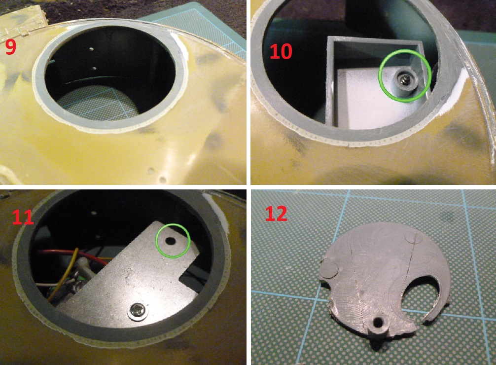

9- Once you have Dremel/filed off the upstand it should look like this.
10-As you can see the screw from the BB schute has no where to fix too.
11-Same goes for the base plate of a IR/Recoil unit.
12-This is the saved peg in its cut out, scribe these lines along as marked and cut the rest off.
The problem and the Solution. Click for larger image
13-Once you have cut the peg to shape it should look like this.
14-Screw the peg base back to the BB Schute and screw the unit complete back inside the Turret. Mark the location of the peg base with a scribe/marker. Dis-assemble and epoxy bond in the peg base to the underside of Turret top in the marked position.
15-Now the BB Schute is secure in the Turret.
16-Or the IR/Recoil base plate (This is being retro fitted converting this BB tank to a recoil/IR version)
The post mount restored once you have removed the upstand. Click for larger image.
