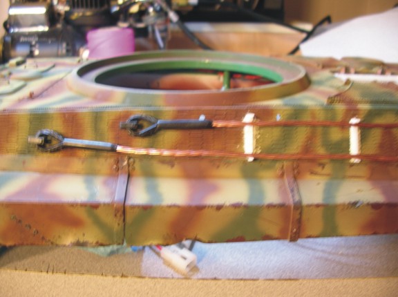

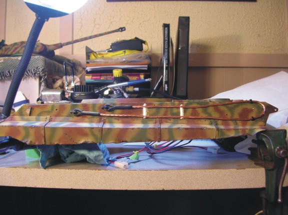

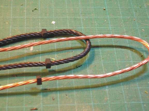

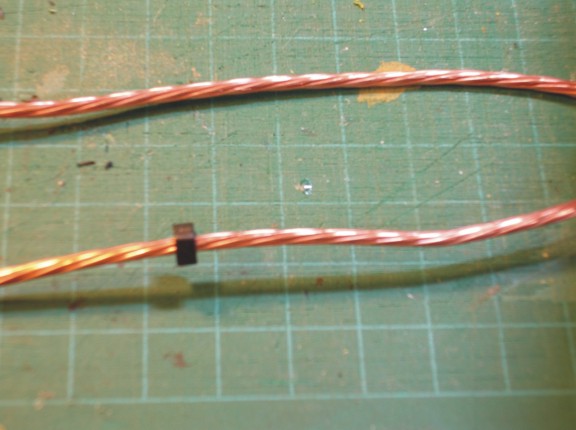

O.K. my $0.63 cent tow ropes!
I have been hunting for a solution to those godawful plastic tow ropes that come with the kits. I HATE the look and feel of them. So I have been trying various things. Picture frame wire, twine, different types of aircraft wire, twist some together, unravel some...
I have been back and forth on the tow rope thread (I will post this there too) and really it was MichaelC (thanks Mike) that sparked me to look at copper electrical cable. Copper made sense. Relatively soft so you can position it well, has some heft to it so it will lay better than some other types. The issue was to get the right thickness and not too many strands in the twist. So I went to my local RONA (Canadian version of Home Depot) and a nice young kid (surprise!) actually took the time to listen to what I was looking for and for what purpose I was going to use it. I had brought along a small piece of the plastic so we could spec it out and I think I found as good a match as you are ever going to find. 12 guage wire with a 7 strand twist. 1 metre $0.63 cents! I was VERY exited by this find finally and rushed home stripped it down and rough fitted it to see how it looked. The kid and I had discussed twisting it a little tighter to closer match the real thing and I will try this next but it looks pretty good to my eye.
So backing up a little, as you can see I carefully cut the supplied tow rope apart. Took the ends and drilled them out. I even kept the little square mounts and drilled them out to use. Of course I will add little fiddlebits to them to simulate the latches, wingnuts, etc... for the smaller tow rope I am going to do the same thing but use a nylon twine for it. I am going to try and paint and weather these up this weekend.

Nice looking tow rope there Dean (and it is not because of the credit !

Hi dgsselkirk ,
A brilliant looking King Tiger ! The old skills are very clearly returning to you quickly....
Just as a couple of suggestions...
The tow rope cable can also be made by getting strands of wire of the correct thickness. Putting one end in a vice or a clamp and then putting the other end in the chuck jaws of an electric drill. Just operate the drill and let it twist the wires until they match the twist pattern on the actual tank. Remember that as you twist the wire it will 'shorten' so be sure to make the start length too long.

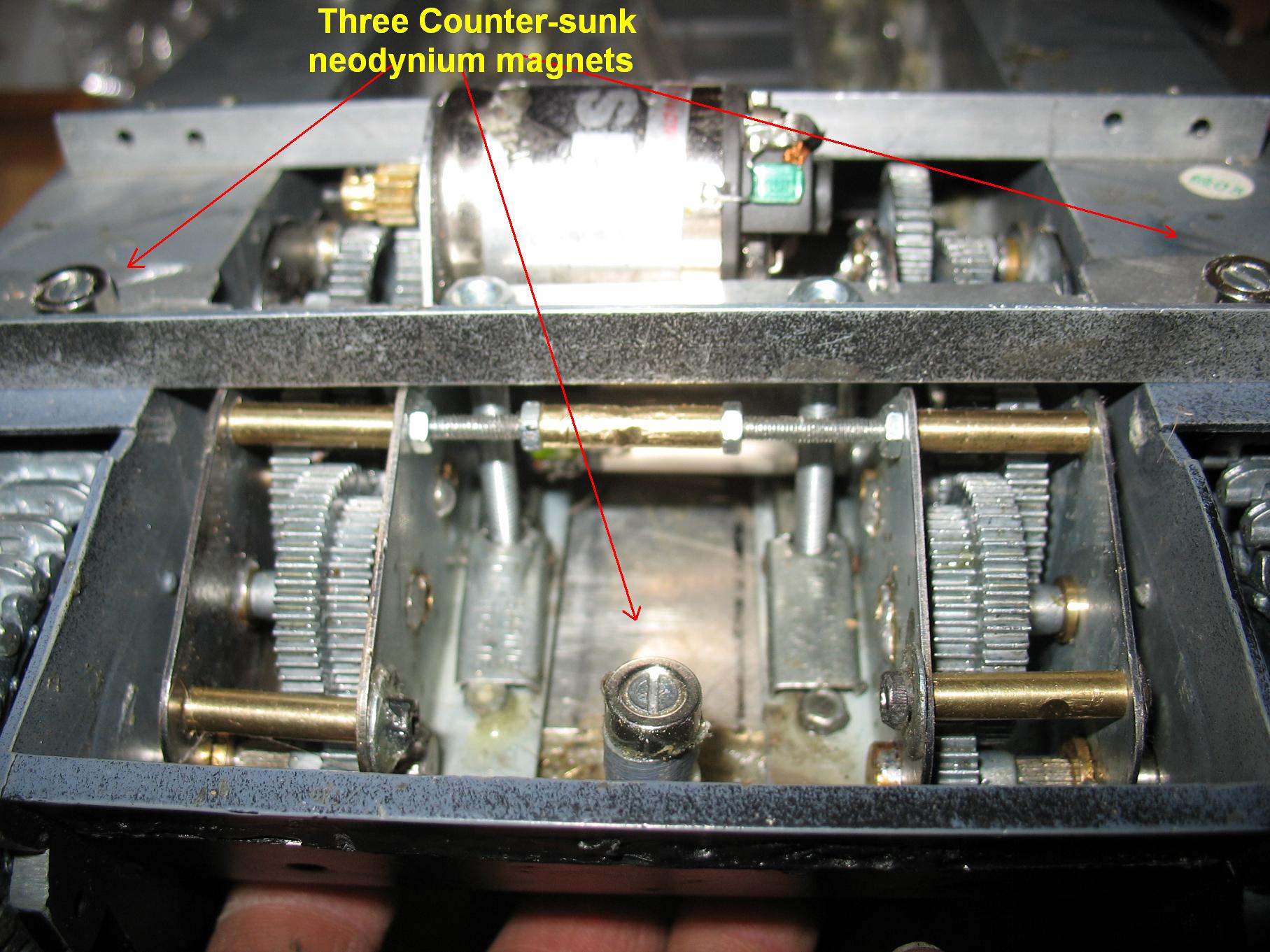

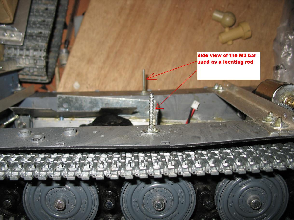

To add to the use of the Neodynium magnets to hold the two halves of the hull together, personally I like to use the ones with the counter-sunk hole in the middle. This way you can actually put a screw through its centre to secure the magnet to the posts. Over rough terrain I have found that on my Tiger 1 the magnets can 'slip' a bit sideways. To prevent that I always add two central metal rods to the lower hull, that are usually made of 3mm threaded bar. These then go up into the hull upper screw posts that I drill out with a 3mm drill bit. This way the hull always slides down the locating rods into the correct position and it cannot then come loose if it gets jolted or I drive into anything.
