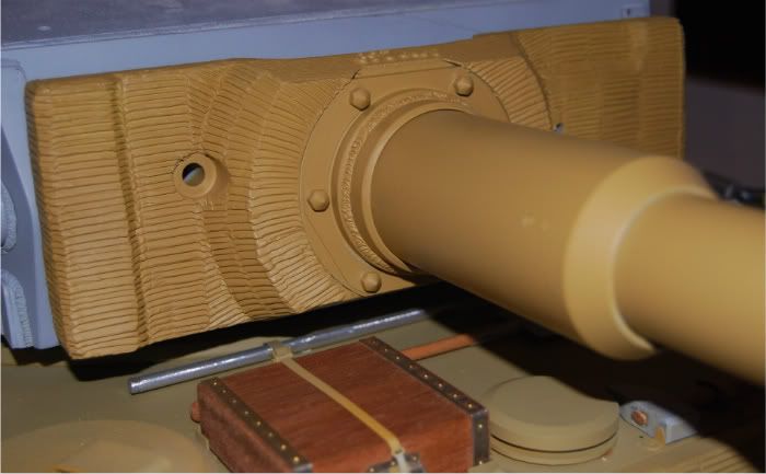

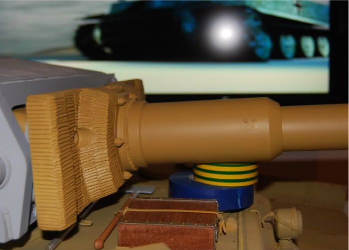

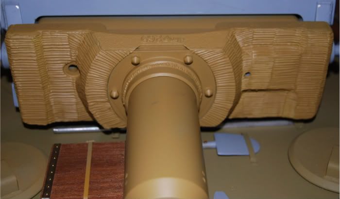

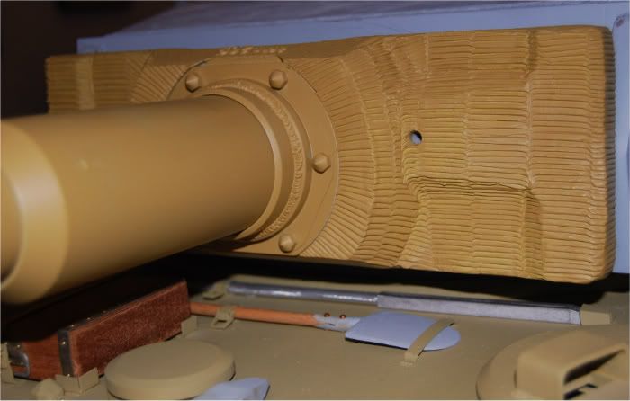

I was planning on trying a few tests on zimmerit for the turret but got impatient and decided to just go for it. I'm using milliput so no going back.
