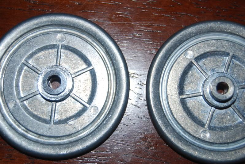

The sprockets and tracks are not Impacts, but Asiatam.
Regarding the roadwheels from Asiatam they could fairly easy be modified to accept two ballbearings in each wheel, I did that on my tamiya KT.
You just have to drill out the inner half to 3,5mm or so and grind down a bit on the inner wheel.
I had to grind off/drill out some on the covers to keep clear the buttonhead on the shaft.
The stock Tamiya spacers also had to be shortened and every second swing arm had to be grinded off a bit. All in all it's well worth to put in the extra effort. Now it's no wobbling at all.
Modified vs. stock Asiatam inner.
Simple drawing of how I did it. Sorry about the text, it's Norwegian....
