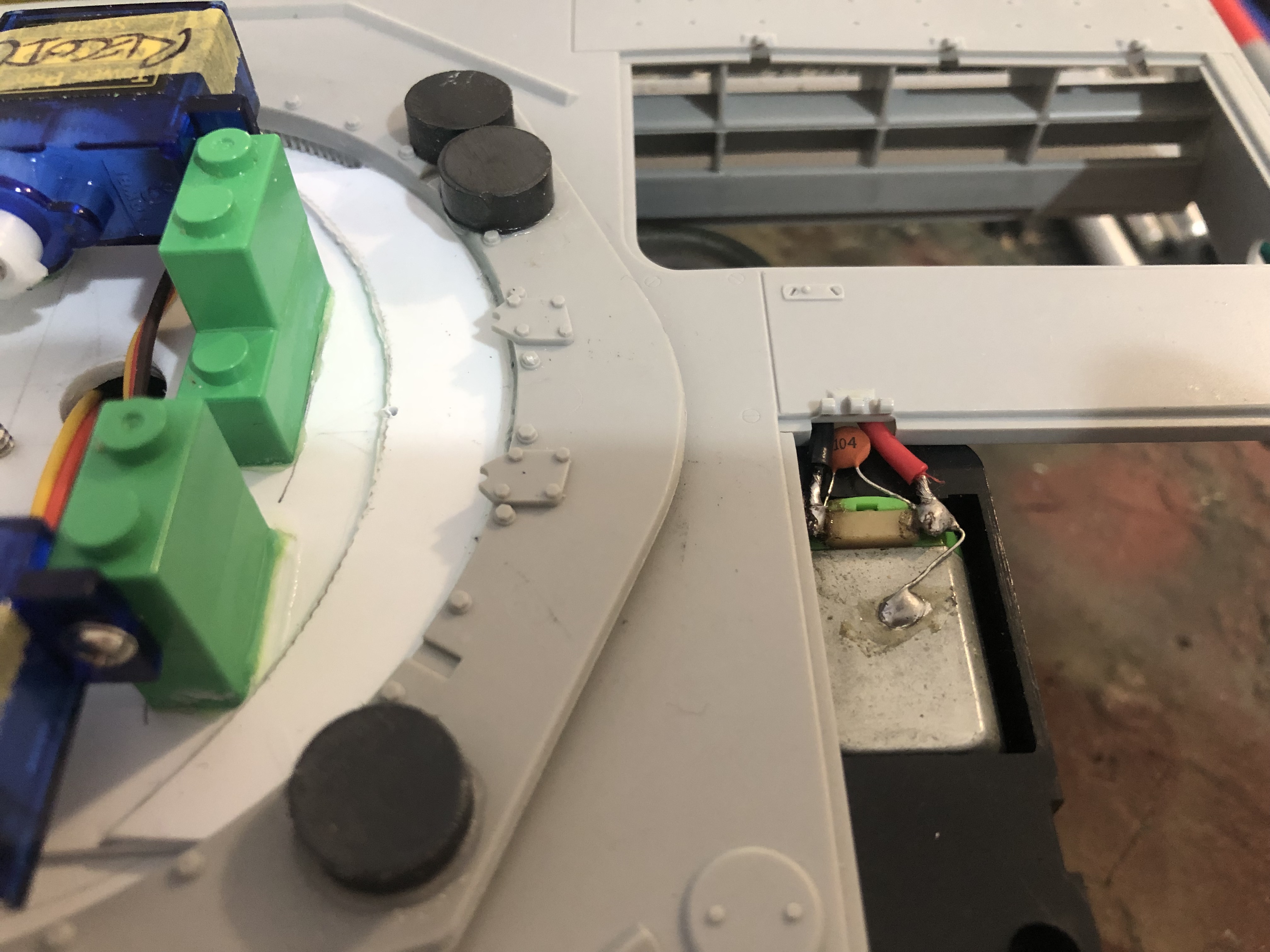

Well, dont want to underwhelm you but its a much straighter link that is now crossing both sides of the barrel sleeve tube at a higher than mid point so it supports the entire barrel to stay in line with the muzzle brake.
Im all about simple & repeatable = maintainable so the system & hardware used reflects that.
Also, to some degree I need to leave some aspects not entirely finished or permanent so the owner can alter or adjust things to his ideal need.
Plus hes a mad painter so removing parts to get an optimum paint outcome is highly likely.
Got the turret rotation drive in place, again a good ole cheap & replaceable H/L unit.
Mounted on some harvested mounting pegs off an old hull.
This might need further support though, but the engine deck door is not fitted & the hull slopes back as it should so getting the unit in the ideal spot was a challenge.
The turret shell was secured by using the Trumpeter lugs at the top-front plate to locate it, and button magnets glued to the turret floor picking up steel strips also glued in place to the inside of the turret shell.
I used 2 magnets on each side so if it needs more oommph down the track it is easy enough to do.
Not a perfect fit but so close its not worth stressing over.

:D Hello Mr. Bix,
in this photo, are the black dots counterweights for the turret?
Re: A LEAP OF FAITH
Posted: Sat Feb 07, 2026 2:45 pm
by MrChef
Jofaur86 wrote: Sat Feb 07, 2026 11:17 am :D Hello Mr. Bix,
Magnets
