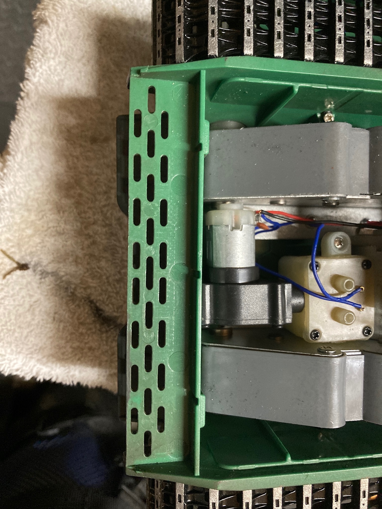

This area of the RTR HAYA Centurion is unpainted, and the Kermit Green coloured plastic shows through the grills on the rear deck and needs painting to improve it. I will make sure this area is painted when I build my Centurion KIT chassis tub.
When I strip out the gearboxes to up-rate the motor I think I will spray the rear inside area of the tub as it looks so much better on the Centurion KIT that I am building at the moment (now sprayed inside the tub!).

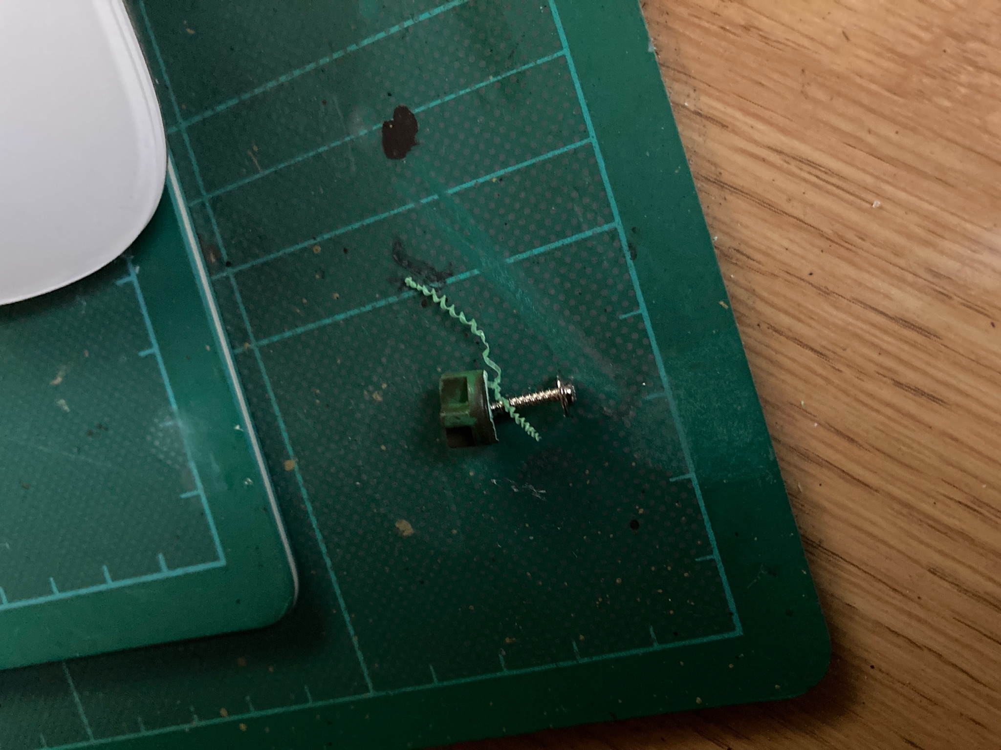

HAYA Centurion Mk3. Replacing Bazooka Plate Struts
Post by zooma »
The side struts that support the "bazooka plates" (side armour that protects the tracks and running gear) tend to snap off at the root on the HAYA Centurion leaving the "plug-in" base firmly stuck in the chassis tub.
Removing this snapped-off part is not so easy as it leaves nothing that can be gripped to pull it out.
Assuming that the part has just been push-fitted into the chassis tub (no glue) it can be extracted by drilling a 1.5mm hole in the centre of the stub and screwing a small self tapping screw into the hole.
I have found that most radio control modellers have a small excess stock of the self taping screws that are supplied to mount servos. These are thin enough to screw into the 1.5mm drilled hole leaving a long enough shaft sticking out to get a grip on.
It is important not to screw through the broken stub into the chassis tub as well - only the broken-off stub should be screwed into!!!!
The screw shaft can be gripped with a pair of pliers and pulled out reasonably easily.
I would strongly advise NOT to glue these side struts in because if they should snap-off, they may prove impossible to remove.
If these side struts have been glued in with super glue, then they may not come out - but the same process can be tried - with the addition of some de-bonder.
Once the screw is inserted use some de-bonder can be carefully poured around the bonded area as the screw shaft is agitated gently to help it soak in around the plastic stub until it feels like it has been loosened. Small repeated applications may be necessary to achieve this.
The de-bonder that I have used (Bob Smith UN-CURE) flows like water and so needs to be applied with some care to stop it running everywhere as it can remove paint and even burn into the plastic surface wherever it flows.
Patience is needed to give repeated applications and gentle agitation to persuade this stub to eventually be pulled-out (like a tooth!).
Stump removed with STS still attached
This is what mine looked like when they snapped off
Screw driven in ready to extract the stump
